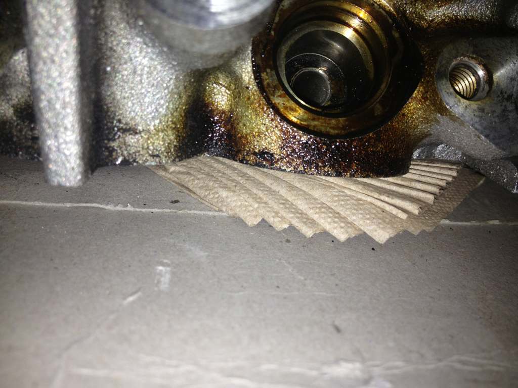

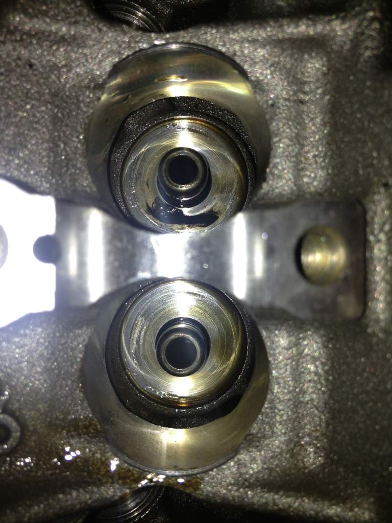

I first placed some napkins under the seals/valves I was going to be playing with like so:

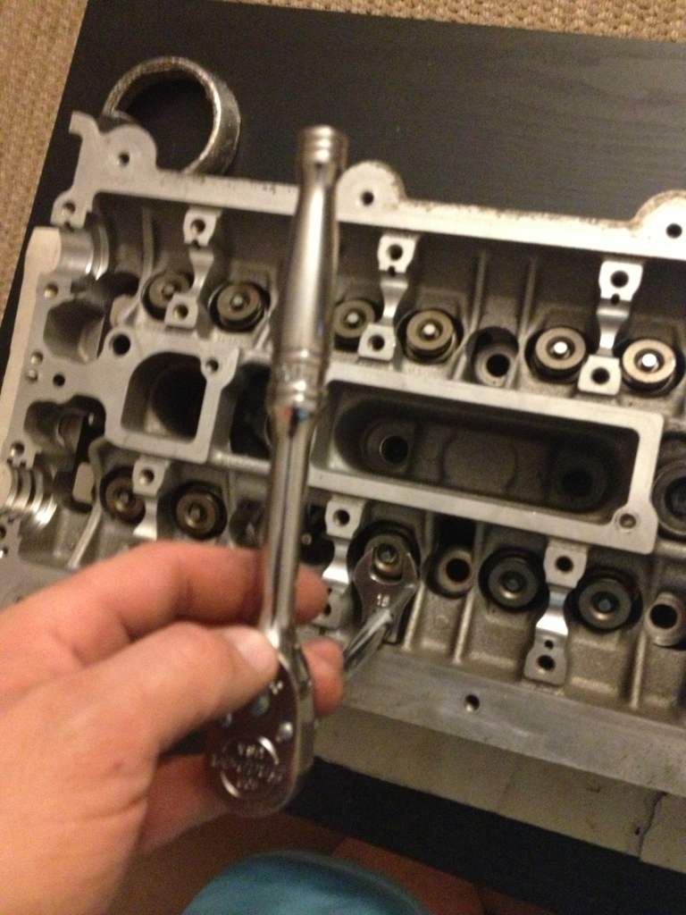

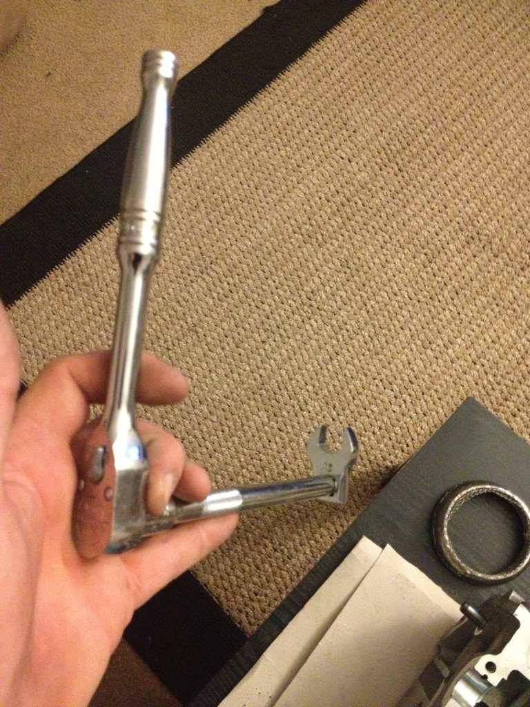

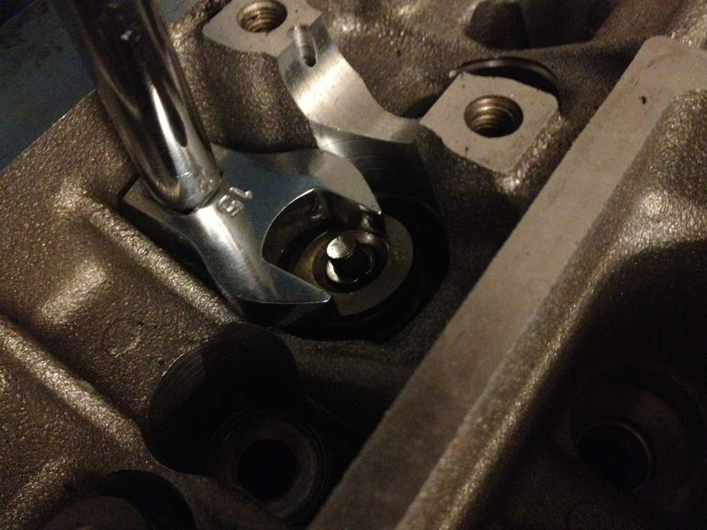

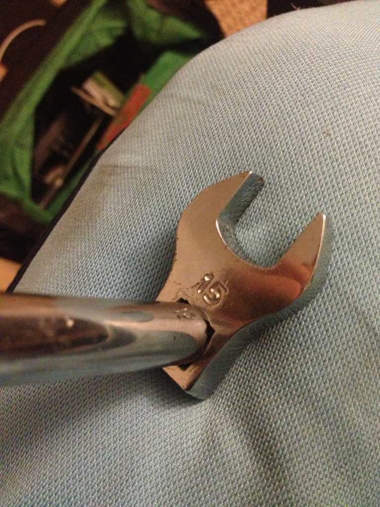

From there I grabbed a 3/8's ratchet with a 6" extension and a 15mm crows foot and set it up like so:

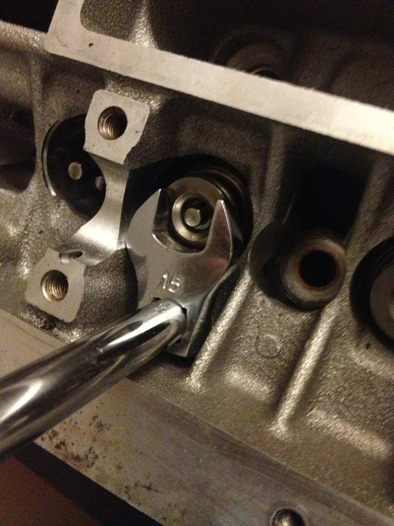

Then I placed the crows foot on top of the retainer (correct me if I'm wrong in the names) like this:

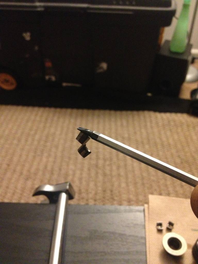

I then used the ratchet crows foot combo to compress the spring and retainer and used a small magnetic flat head to grab the keepers like so:
In this step above be sure that the keepers are spun so the halves face are perpendicular to how the cams sit otherwise the one closest to the ratchet will get stuck and you might just have it pop out and smack you in the face as I did... Soo keep that in mind.

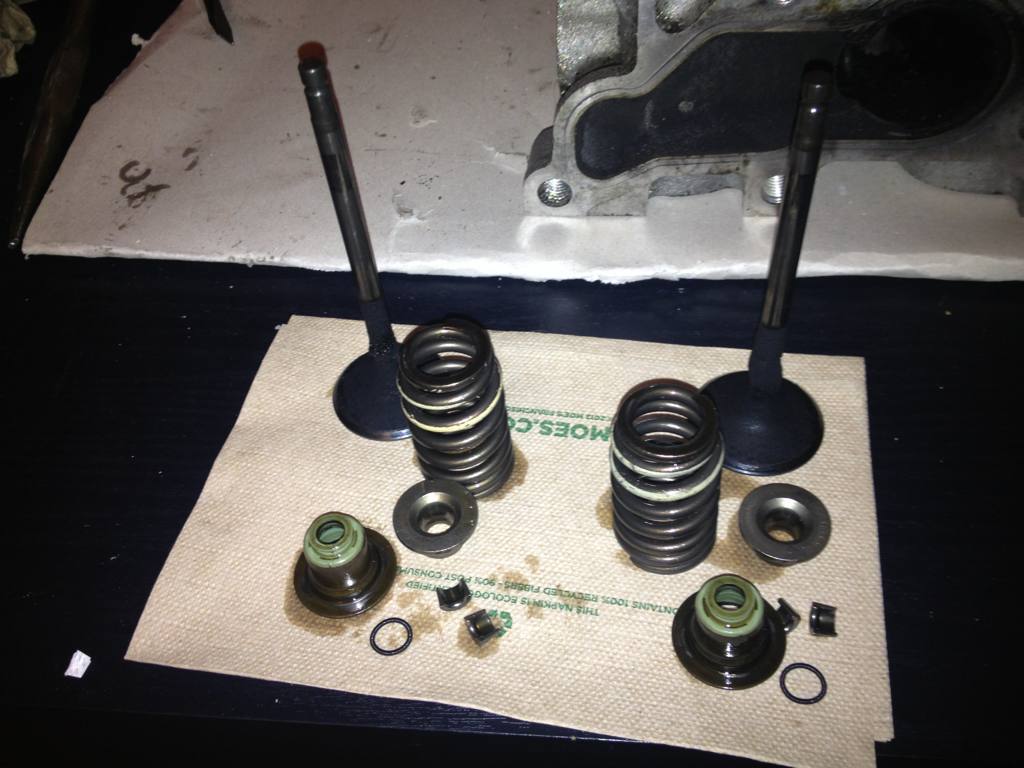

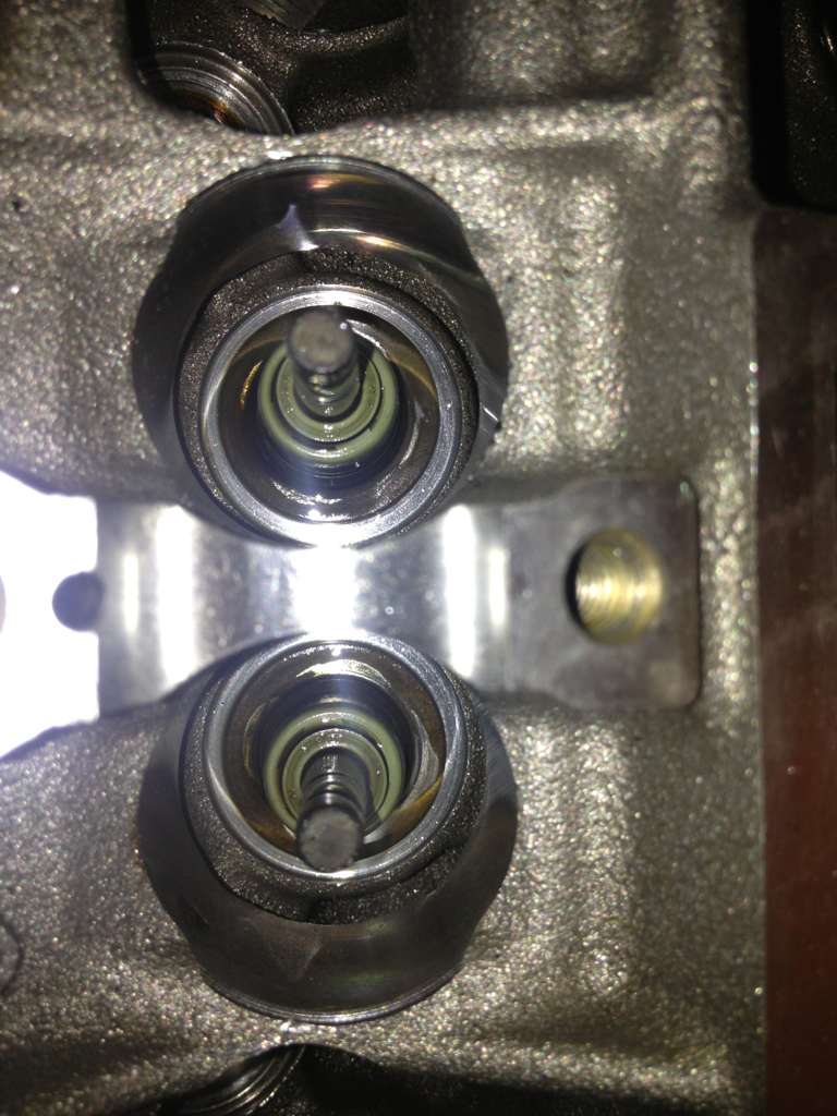

I then pulled out the retainer and the spring and you'll have just the seal left to remove:

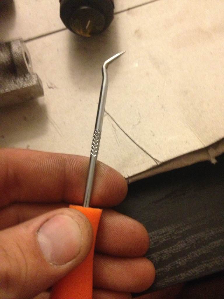

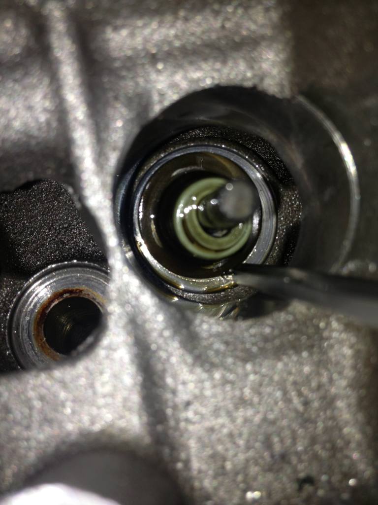

Next I took a small 45* angled hook and pulled off the spring around the top of the seal to allow the seal to come out easier:
NOTE:
I usually dont remove the spring around the seal because I am always afraid that I am going to lose it in the head somewhere. Usually after the seal has worn some it isnt really very tight at all.

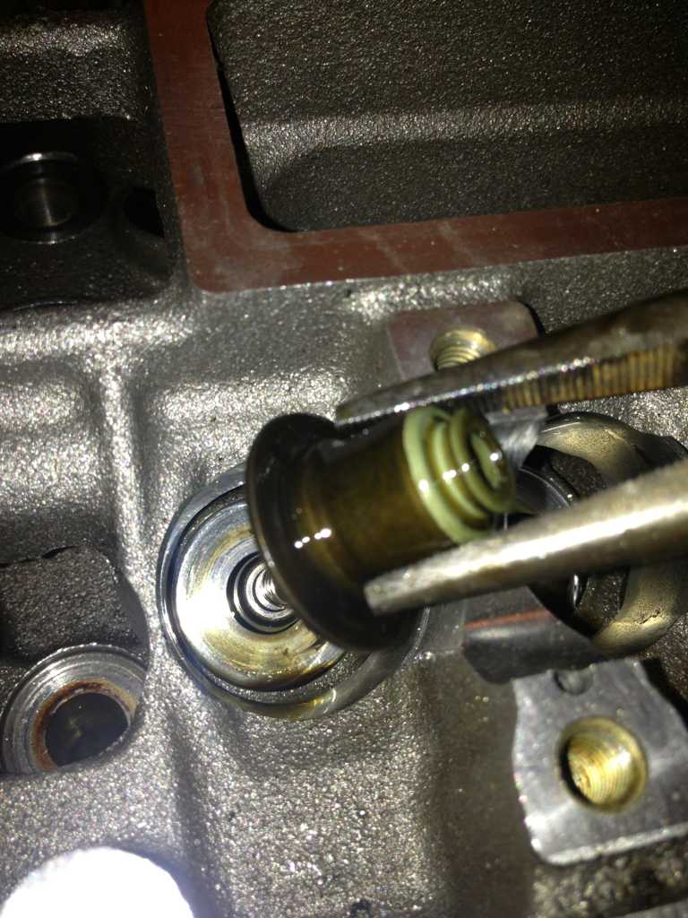

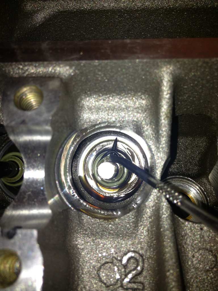

From there I took my small magnetic flat head and placed it between the lip of the seal and the lip on the machined surface where the seal sits and twisted to help free the seal and make for an easy removal:

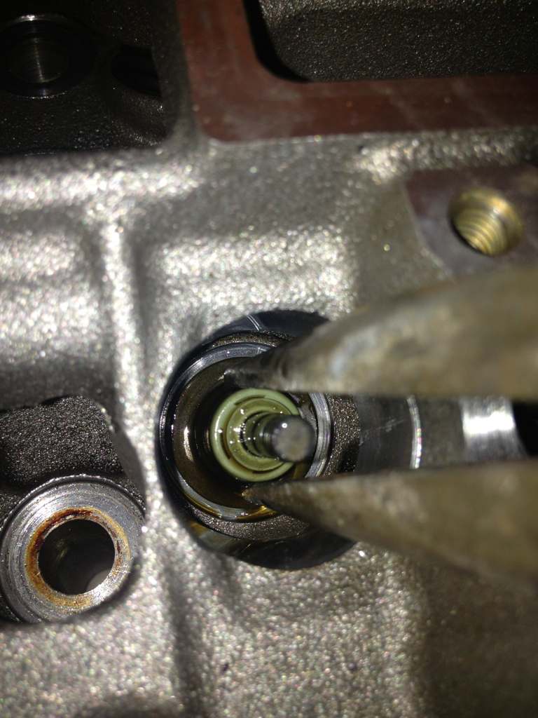

I then used a long set of needle nose to remove the seal completely:

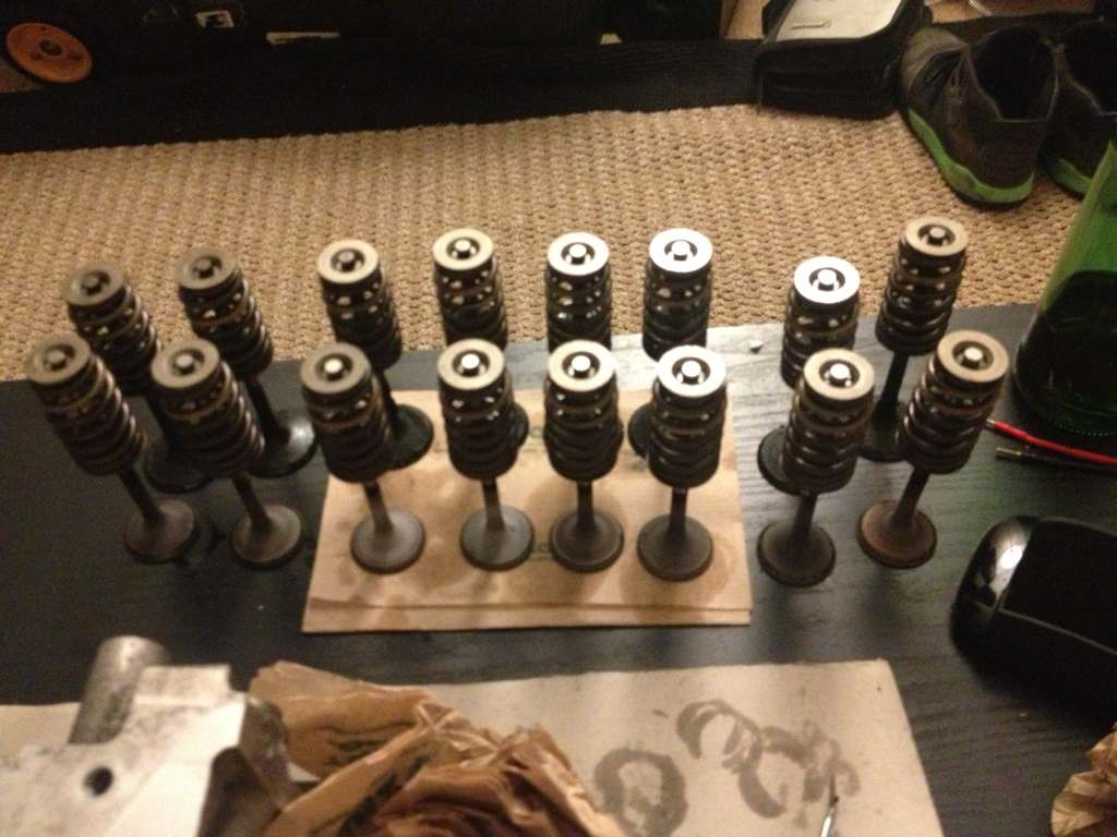

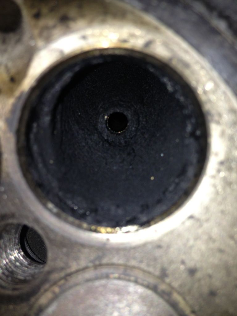

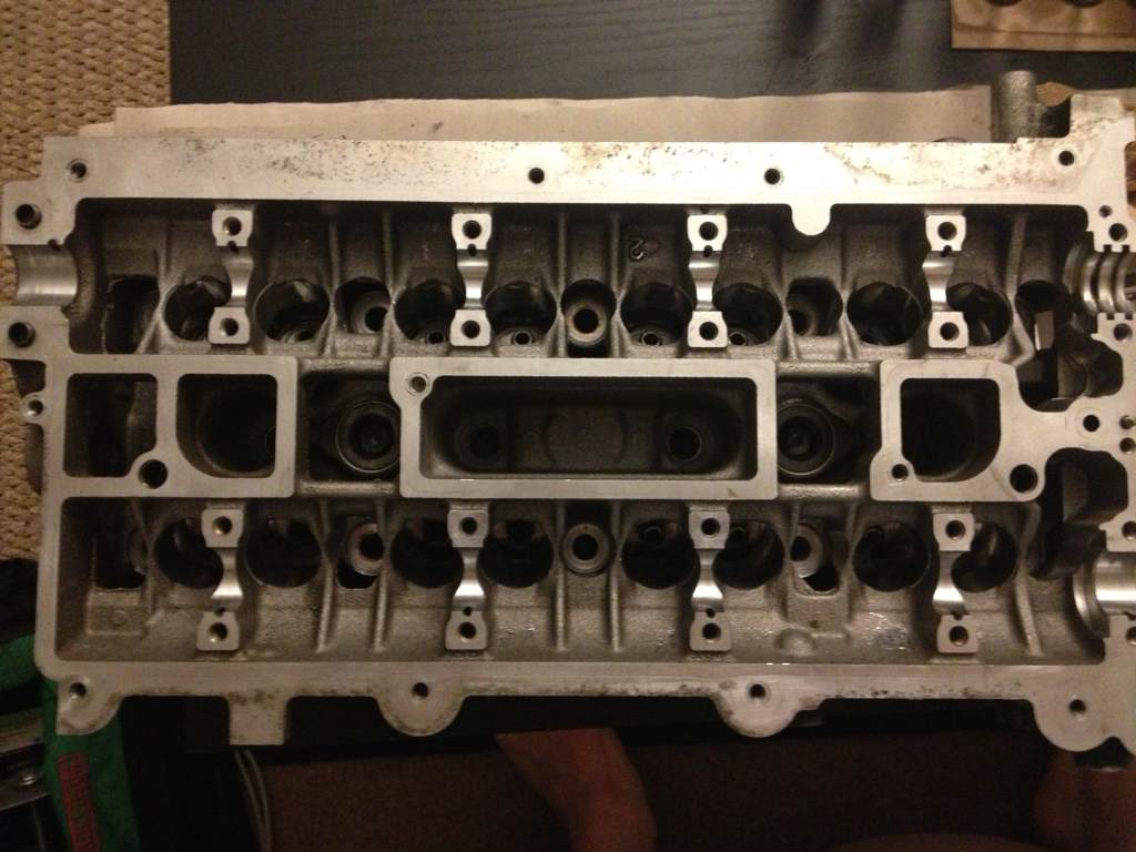

I then simply slid the valves out of the guides and this is what you have left over:
Now this was super easy with the head sitting on my coffee table, if it where still in the car there is one of three ways that I have read to keep the valves in place while you do this.

When you say "runner" I'm not sure I know what you mean. Do you mean the ports where the valves are visible when the IM is removed. 8 of them IIRC. I've attached a pic of what "I" am talking about - the channels leading from the IM mating surface down to the valves, are they the runners you talk about ?
Mandinca is offline   Reply With Quote
 Old 10-08-2013, 01:50 PM   #30
Rokusek's Avatar
Posts: 5,551   (View Stats)
Rep Power: 3957
Thanks: 9,694
Yes, those are called runners. and if they look as wet as those two its most likely a valve seal. If all your runners look like that then it is probably something else.
