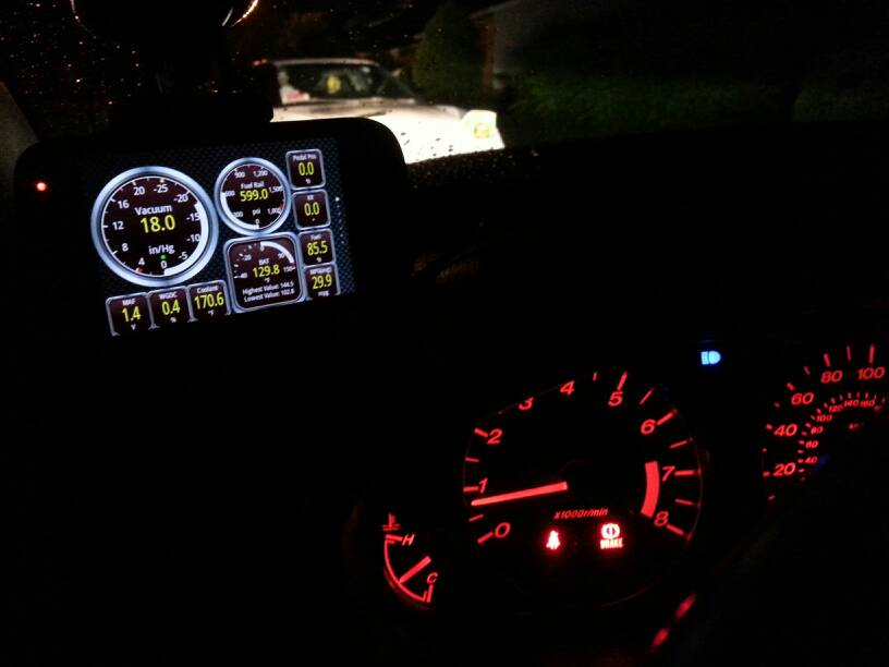

got installed on a old android phone and a dongle...not as fast as the AP buuut you can live monitor so many parameters at the same time its a useful tool... a better dongle will give faster PID's though, I got mine set to monitor = boost, fp, kr, bat, fuel economy, fuel level engine temp, wgdc, pedal position, and map voltage all at the same time... only drawback with the mazdaspeed plugin is that if you turn the car off and back on mine stops reading pedal position, BAT, and KR until i restart the app.. i found out if you leave the dongle plugged in and leave the car parked for a week it will kill the battery lol

Default How to manually start/stop datalogging?
Does anybody know how to manually start/stop datalogging? The only way I've found to log is to enable the following setting:
Settings > Data Logging & Upload > Log when Torque is started
For my setup, I'm using:
- Nexus 4 (running CyanogenMod 10.1)
- Mountek nGroove Universal CD Slot Mount
- AGPtek® Super Mini ELM327 V1.5 Bluetooth OBD2 OBD-II CAN-BUS Auto Diagnostic Scanner Tool (works flawlessly)
Originally Posted by ajkulish View Post
how do you get fuel pressure?
Fuel pressure is avaliavble under Realtime Information > Add Display (tap & hold on a blank area) > Fuel Rail Pressure.
This is available even if you haven't purchased the Mazdaspeed plugin, and it works great!

My torque setup
tapatapa zoom
In dashboard view while monitoring >> press and hold on screen >> start/stop logging.
