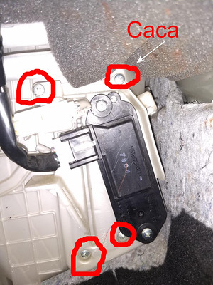

I just did this and it was a huge PITA. While I was down there I took some close-up pics of the inside of the air box so you can see the grooves where the top air filter slides up into.
wished i'd seen this photos before the job, but felt around in there while all tangled up in the box and could sort of feel what it looked like....thanks!

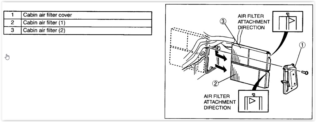

This video helps as well as it shows filter orientation: https://www.youtube.com/watch?v=Bh0ygdeDvPc
I used a $8.50 (delivered) ULTRA-POWER 24482 from Rockauto. Seems like decent quality but no instructions.
First filter change at 150k miles.
This is a bizarre design with one filter sitting on another. What?
Have a scanner to clear the CEL P606 if you dont wanna disconnect the battery before doing this.
Have a vacuum to suck out leaves from filter compartment.
Change the certainly-dead-by-now light bulb in the glove box while you're at it.
For me the worst part was figuring out how to align these filters in the box and getting the screw at 2 o'clock on the access door. Its hard to see where it goes. Dropped that bastard behind the carpet 4 times.
Here is a pic of the door with the 4 screws installed.
mazda cabin airfilter door
I think this is how it fits back in...
https://youtu.be/qniekFZ3D-U
MAZDA instructional drawing:
