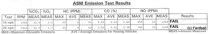

I tried to get smogged today. If you're in CA, then you'd better take off your downpipe before even trying. Yes, they'll notice.
Besides that, I didn't pass the emissions part of the test. It looks like my cat went bad. I've had this on for about 4 years now. Is this normal?

Okay, maybe. But I'm 100x above average in NO (PPM). I think there is a hole where my cat used to be. Going to have to stock out. I'll see if I can get a good picture.
 Old 12-13-2012, 11:16 PM   #5
The CPE cat and aftermarket 2way cats don't do much for NOx. You need a 3 way cat for that which the OEM is.
Also high combustion temperatures lead to high NOx emissions.

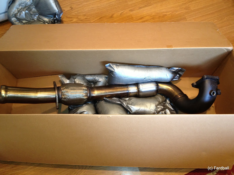

I am the original owner, but I bought from dabears2k.com (Matt Kreigsfeld). I don't remember if he gave me an invoice or not. He gave me a discount for a cash deal.
Would it help if I could find a new picture of it before it was installed?

I asked you a question on Saturday. Would a picture of it new be of any value?
If you need proof that I got this new, I wonder if this would suffice?

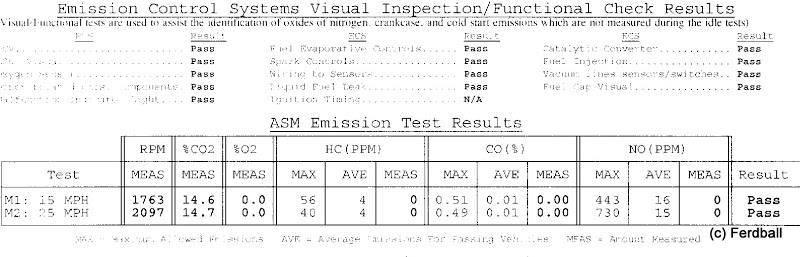

So, you're saying this is normal? Here is a pre-test that I had to get done, about a year and a half after it was installed.
https://docs.google.com/spreadsheet/...nZ0U1E4WW1ETmc

The high flow cats do catalyze Co into co2 but they lose efficiency over time and contain a lot less catalyst than an oem cat so they will not pass emissions after a few years and need to be replaced.
The oems build the calibration of the vehicle around maintaining cat life and this is one of the reasons the disi falls on its face after 5500rpm on the stock tune.

Man, these OEM cats are super clean!
The Following 2 Users Say Thank You to Ferdball For This Useful Post:
Celestspeed3 (12-28-2012), sidekick (02-18-2013)
 Old 12-28-2012, 07:08 PM   #30
Celestspeed3's Avatar
Posts: 1,136   (View Stats)
Rep Power: 1135
Thanks: 977
You sure they even ran the car, LOL
That's a big improvement.

Okay, I went by the shop and asked them about it. They said that the numbers are correct. I thought that maybe if a car was passing, that they would just fill the fields with zeroes because it didn't matter. But they said that the numbers are provided by the machine, and there's nothing they can do to change it. So this myth is BUSTED. The smog check numbers are VERIFIED.
P.S.: I'm going to clean my tailpipe and see how long that lasts.
P.S.S.: I still haven't heard from CP-e. I wonder if they're still on vaca.

$ 85 - Replace Cat
$150- Cat Spun Stainless Steel, 200 Cell MET Core High Load USA
$ 50 - S&H
$285 - 100% Covered under warranty
Can't complain about CP-e. Thanks Chunie
