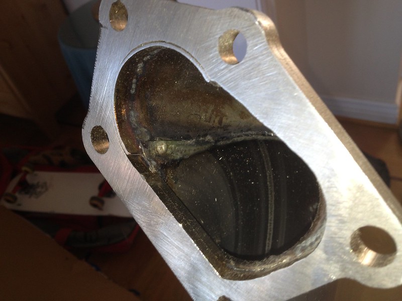

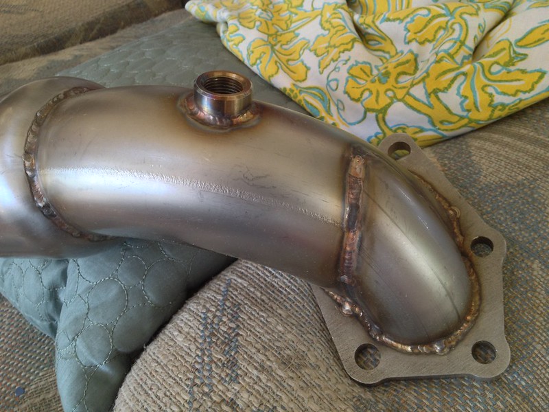

I just bought a catted downpipe about a week ago (of course before the presidents day sale ). I don't want this to come off as me bashing CP-E, because you guys do make nice products and my cat-back looks solid, but I'm a little disappointed by the quality of my downpipe.
First off, the welds on the flex section are horrendous. There is porosity and the welds are just plain UGLY. I'd expect better from a $650 dollar piece of pipe... Anyways, I'm more concerned about the function of the welds. I was told that the porosity could lead to leaks. Is this how all of the flex sections look when they leave your facility?
Then there is the "bellmouth", if you want to call it that. It looks fine from the outside, but the inside is pretty bad... There are built up welds, no clean-up, sharp edges everywhere, a flap of sheet metal, and overall, it just isn't smooth. Also, are your 5 bolt flanges ground, cast, or machined? They look similar to the flanges used on ebay downpipes..
Then, there is just an overall lack of consistency in the welds.

Man that sucks. Hopefully they will chime in and resolve this. Looks like they are making the dp's by quanity not quality.

just curious..why? I paid 1/5th the price and have better welds to boot!

that looks horrible and i wouldn't install it. hopefully they can exchange it for you without hassle. good luck.

really? Cause the way I see it you could have 5 of them fail on you and still come out even on your one DP. Not trying to bash you or cp-e, and I am all about classy parts for a classy bitch, but I am here to tell you there is nothing wrong with an eBay DP and the welds are solid as ever after 1.5 years.

That is the worst welding job I have seen on this forum so far. My 3 year old daughter could weld better than that for a piece of candy, let alone a paycheck the person that did this, earned. I know its a long shot but sometimes new workers practicing on stuff could get mixed in to parts on the shelf by accident? Right?

That is some awful welding. It's amazing to see a company try and turn their act around and then something like this shows up. Hopefully they'll use this as a way to show that they are changing for the better. I personally would have gone with the Corksport DP. It's less expensive, has a cat if you need it, and bolts up to 3" setups.

for sure those welds look like they have holes in it....my COBB downpipe was flawless btw...shit CNT had much better welds...wtf cpe
It also necks down to 2.5 inches though. Not a full 3" pipe.

Those are by far the sloppiest welds I've ever seen from Cp-e. That is not normal for them at all.
Don't worry, man. I'm sure they'll take care of you.
true but the welds are flawless tapering down or not.

Who cares if your down pipe tapers to 2.5". Go to a muffler shop with two 3" vband flanges and have them cut and weld for $20/$30. For two flanges and a band maybe another $25?
The welds might not be glorious but they'll work.

I like how you say you wouldn't be caught dead with the Ebay downpipe but my Ebay downpipe has nicer welds than that.

Hang on a second. You said that is a Cpe DP?
Since when was the bellmouth on Cpe DP's welded? For years now they have been a cast bellmouth.
That thing looks like a cheap pos compared to the Cpe DP I bought a couple of years ago.

Alright, clearly people here need to learn how to read. I HAVE A FUCKING CATBACK THAT ALREADY HAS A 3" FLANGE SO IM NOT GOING TO HACK UP BRAND NEW PARTS AND MAKE THEM PERFORM WORSE THAN WHEN I BOUGHT THEM. Shut the fuck up and get the fuck out of my thread faggot. This issue doesn't concern you. Why would I buy a 3" exhaust only to have it neck down to 2.5"? That defeats the purpose of having a 3" exhaust and I might as well just stick to stock if I'm going to do that dumb shit.
Yeah, most of the time really nice welds do this:
Will that shut you eBay downpipe dick riding faggots up? God damn. I'm not buying an eBay downpipe, so you can all stop suggesting it and telling me how amazing it is. I DON'T GIVE A FUCK.
I'll say it one last fucking time. I don't want any fucking advice on what downpipe I should buy and I don't want to fucking hear about how nice the welds are on your sweatshop downpipe. I'm trying to contact a vendor on here to see what they think of this situation. If you are not from CP-E and have nothing useful to say, then please see your way out. @Raider;
The MS6 uses that bellmouth rather than a cast one for whatever reason.
