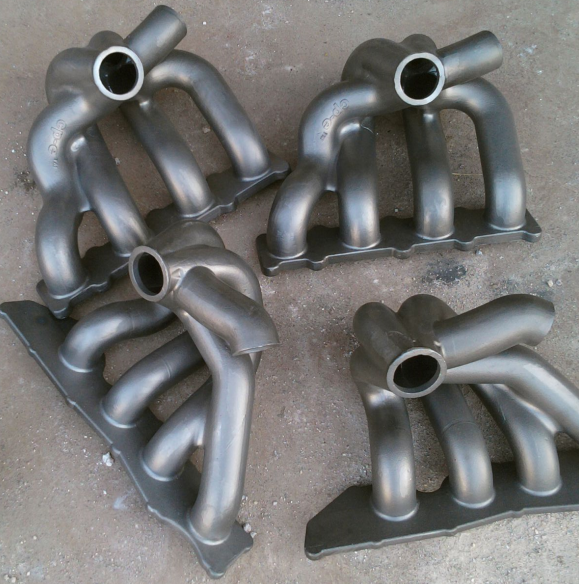

Just saw this on cp-e's blog.
cp-e
There's a picture of the cast tubular exhaust mani. Not quite what I was envisioning and don't see how it will flow so much better than any other mani on the market. Cast is nice though since you don't have to worry about welds cracking. Anyways, that is some good news and can't wait to see the turbo kits and standalone ECU's

i like the looks of it. curious to see how it performs

sickk!! Finally a high quality company building manis for us.

Looks pretty awesome..
Slightly concerned about there not being a support bracket from the flange to the collector.. Hope these don't crack....

Come on Austin this is cp-e were talking about! I doubt there not going to have any support.

manis look good. will the cast still change color from high temps?

looks great, but i wonder if it is going to really out perform the steedspeed and the medievil design.
that's the best part about cast pieces: no welds to crack. so even if they didn't add a support bracket, the pipe would probably have to snap for there could be cracks.

From personal experience with my SRT-4, cast pieces are nice BUT you have to constantly check the studs and nuts that hold it to the head. With all the weight of a cast mani, turbo, wastegate/dumptube and the exhaust, the studs break REALLY easily.
A support bracket might not be needed to save a weld from cracking, but it would be great to save the studs from shearing off.

I agree that is a lot of weigh to be hanging from those little studs in a aluminum head,but I really think that applies to all the manifolds out there . I also don't think it will really flow better that a full tube equal length manifold with a merge collector imo anyhow.

correct me if i'm wrong. is'nt there a support bracket that mounts from the block to the turbo?
either way i agree there needs to be a support bracket for the weight hanging from the studs.

There is a bracket on the factory turbo,but as for big turbos something would defiantly need to be made .I think that applies to all big turbo and manifold setups.

Is it just me or do those look like more plastic mock ups to sit in their waiting area along with the mock up of the intake mani....
I'd like to see finished product on a test vehicle...

exhaust manifold is something your car already comes with, after the combustion gases exit through the exhaust valve, runner..they dump into a manifold....from there it goes into the turbine inlet of the turbo to actually make the turbo spin its shaft and in term suck in more air on the compressor side of it....
an "exhaust mani" is just the same piece you have except each runner from the exhaust port to the collector is more uniform in length, dimension (rounder like a tube inside) and usually larger in tube volume ....making it easier for the exhaust to flow out of the cylinder head.....
any engine can always benefit from an after market "header" as they are usually called since the oem cast manifold usually isn't the best flowing piece. (most of the time for heat and noise issues they are made beefy and meh flowing)

The runners looks very very similar to my manifold.

other than to facilitate mass production i dont see the point of a cast header...
theaders been around for a loooooooooooooong time.... best ones have and always will be made from welded piping....if the dimensions inside are equal the non cast will always be lighter anyways....
not sure what is trying to be accomplished here
