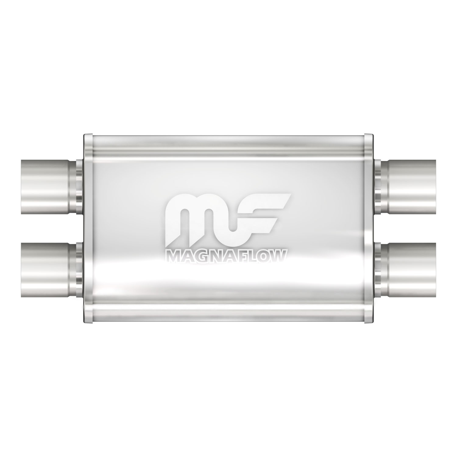

I'm wondering if this would fit... I measured the resonators (i think that's what they are) They are about 12 inches long. So i'm thinking if one were to cut the pipes off of this magna flow muffler so that you only have a half inch of pipe on either end total length would be 12 inches. I should be able the have the resonators cut out and slip this muffler in and have it clamped or welded. Actually now that i think about it they could probably just flare the pipe and slip it over instead of cutting it .. That way they could just use clamps cause on one side it looks almost too tight to weld.
http://images.magnaflow.com/02product/parts/11378.jpg
I think this would be best solution and it should fit... I think... Comments?

MagnaFlow Exhaust Products - For Trucks, Suv's, American Muscle, Diesel, & Sport Compact Vehicles
Look for 5in. Round, Center/Center, 3in. in/out. This will 100% definitely fit because I managed to fit the Vibrant 1119 right above the mid chassis brace (the black steel plate with an oval cutout). My exhaust guy (AR Padua Motorsports - Toronto) was a beast and knew exactly what to do to in order to reposition the piping in such a way as to allow the Vibrant 1119 to fit. However, the 5" round Magnaflow would fit MUCH better in that space above the chassis brace, and cause way less hassle in terms of fitment.
