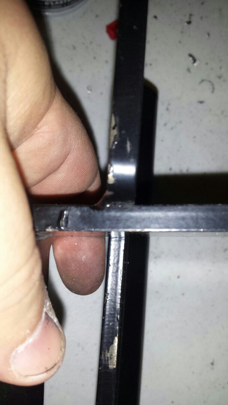

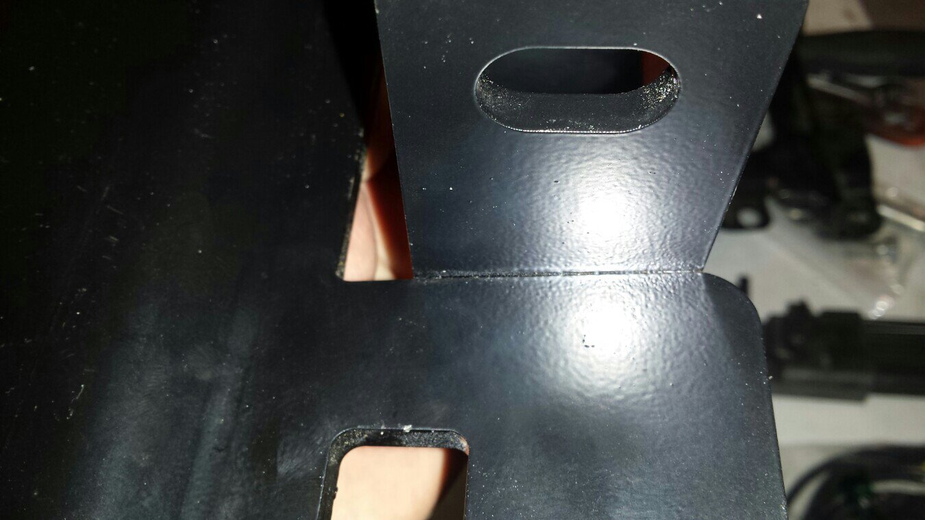

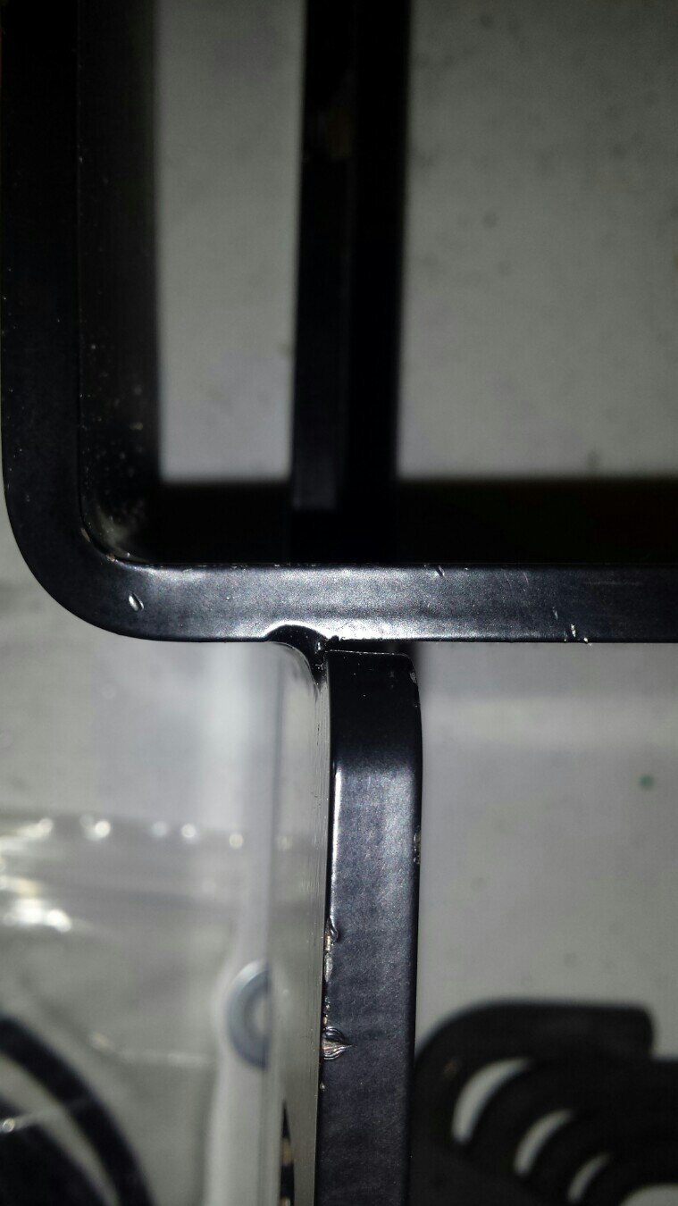

Did you by chance snap some pics of your tmm? I bought one recently and I was a little on the ropes about how this is welded only on one side, in two places. I would think both sides is what you want. This is top and bottom shots. Everyone else's look like this?
Contact cp-e, I have had all 3 mounts for over 2 years and do not remember what it looked like.
I emailed pics to support like 2 or 3 days ago. Usually I'm more patient but, I'd like to go to the track tonight. unless I get an answer I can't. Not trying to launch my ride and then drive 110 OK OK 108 mph down the track if it might bust on me.
Call them. I have some photos, but unfortunately I am not home.
