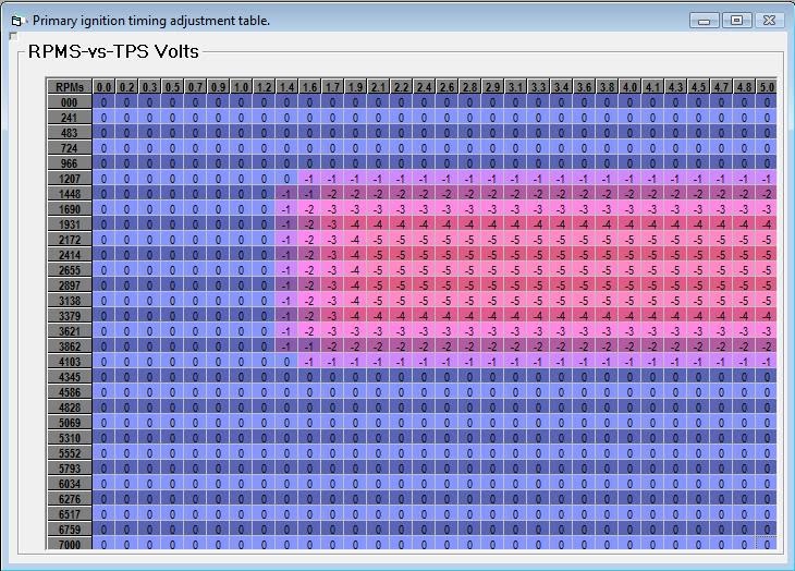

As I mentioned above, I pulled a good deal of timing between 2-4k rpms at anything over 30% throttle. I did this b/c my car would have AUDIBLE knock anytime I went >50% throttle in 4th gear or above. In order to get rid of it, I had to pull about 5 degrees, and to pull that much you have to pull a little extra to "step down" to it so you don't throw a CEL.
Well the side effect of this is a very noticeable lack in power down low. Does it knock? no way. Is it fun to drive and does it drive well? Not really. I put this map on so that I could do some WOT pulls without the car puking everywhere and then gradually pull timing where appropriate, as opposed to running with it knocking and trying to remove timing to fix the problem.
I don't consider this a solution, more of just a temporary fix. I'll upload my "pussy tune" for you guys to take a peek at this afternoon. You may not need anything as drastic as I've done, maybe pull 1-2 degrees in midrange - part throttle and see if it helps you too.

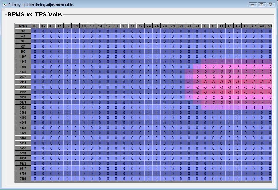

Again.... this is overkill and it will make the car feel like crap and be super slow, but it will cure your knock
Thats what I started with and after some driving and logs I ended up with something a bit more aggressive:
The aggressive map still has a teensy bit of partial throttle knock, nothing over 1.5 KR which I'm not too worried about, but it cures all my issues with >50% throttle issues I saw down low.
