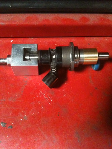

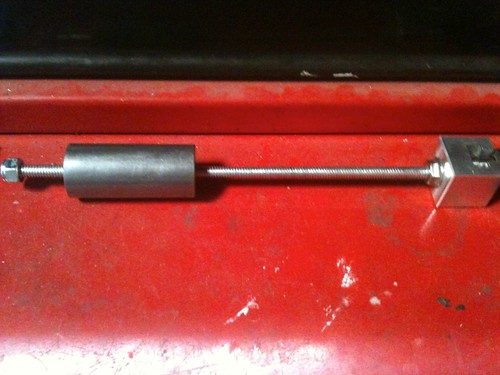

I kind of forgot that you were the first person to ever try out the removal tool... On your recommendations, I did make a tweak to the final design, which helped out greatly when I used the tool to remove my injectors last month.
Before anyone asks, yes CP-E has the updated design of the removal tool....
Scott, what exactly is this tool? Is this the tool you need when the injectors get stucked?
Do you have a pic I can see of it?
You have an e-mail....
Yes, this is the tool to remove stuck injectors

Originally Posted by essejkcamraw View Post
is it a flathead screw driver?
No, it's a chisel

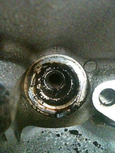

holy blasted injector seals batman!

Yup. Guy definitely needs new seals

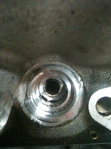

here is a poster child pic for your marketing team. These are jimmers crows feet
Caption: Do your crows feet look like this? Well you need the new Mazda MZR injector seals from CP-e

Pics of the Injectors & seals...

Jimmer... what cyl's were those out of?
Looks like motivation to play with the cylinder specific spark timing

The one with half left was cylinder 2... The other was cylinder 4...
I am AMAZED with how shitty these look... THat is 40k miles worth, imagine what someone who has 60k's looks like LOL

will blown injector seals always show the nasty fuel seepage around the injectors?
There will always be something showing but not always fuel.
I think when you see fuel your seals have been blown for awhile and you're prolly looking at head damage.
If you just see exhaust around the injectors then you caught it in time.

So anyway...
This car was running "fine" by the way...

Is that the removal tool in the last pic?

This may be a bit more clear.
It is a specifically designed slide hammer essentially. The cylinder at the end is steel with enough effective weight to make it useful. It worked great on the engine we have here for our new project.

you bet it is ....it is a completely different way of thinking on how to remove the injectors.

body shop dent puller FTW!

Oh and that's a pic of the tool AND seal. Nice work Scott & CPE.
