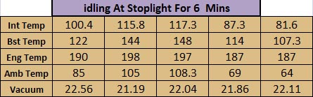

Temperatures flat plummet while driving. Sitting at stoplights over the last 11 days has shown that although temp creep is there, just like a TMIC, its not as high depending on the ambient temperature outside. Below, you will see a chart of the Cobb FMIC sitting at various stoplights for over 6 mins. Note the different temps seen in different ambient temp conditions.
During all of the above conditions, the slightest forward movement showed temperatures immediately drop, and quickly. If you truly are concerned at all with heatsoak because you're a diehard racer, you have two really good options at your disposal. You can either run methanol/water injection which may keep you a few degrees above ambient, or design and install a intercooler water sprayer. Over the next month, we are going to do both.
