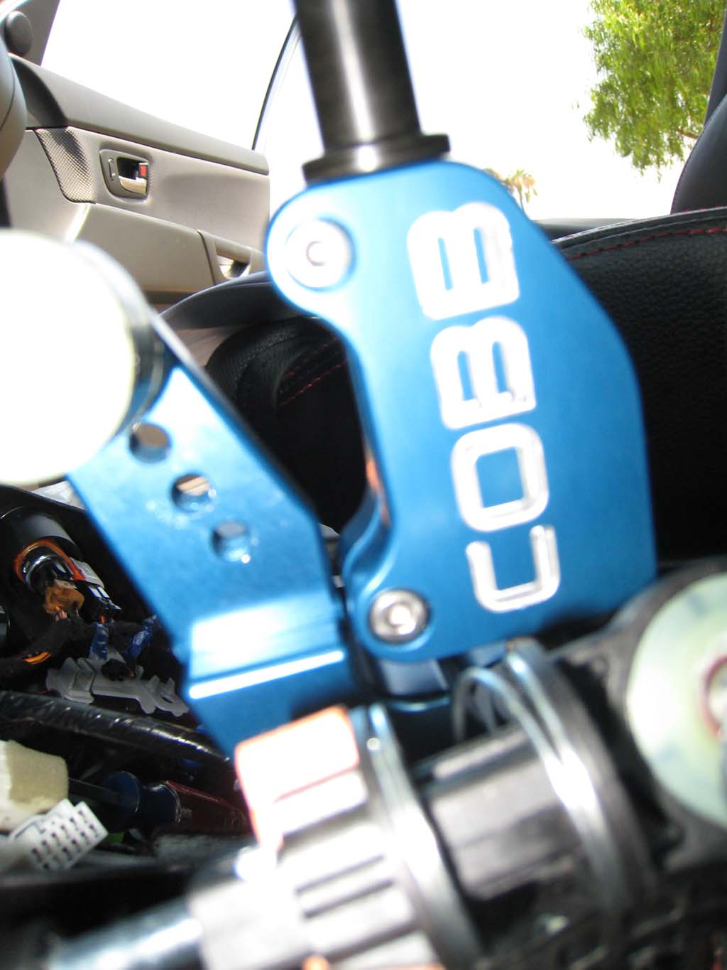

The Cobb unit is probably one of the most attractive shifters I've personally installed. Its such a shame to see something this attractive, covered by a shift boot. Its constructed out of Billet aluminum with a billet steel shaft and comes anodized blue with a nice engraved Cobb logo. The first section of the billet body is the adjustable throw mechanism located on the lower part of the shifter. By moving the ball from it's lowest point, to the highest point on the unit, you can reduce your throws from as small as 10%,15%, to a medium of 20%, and a max of 25% or 30%. The second section of the billet body is the shaft height adjustment mechanism. This controls how low or high you want your shift knob to sit. It has 2 stainless 3mm allen bolts that secures the knob shaft to the shifter itself. This allows greater adjustment for height, without disturbing the selected reduction of throw you want. TWM's approach is much different. They reduced the height of their shifter by 1.75" based off their own preferences. Not everyone will feel comfortable with such a low sitting shifter. They do however, offer the same reduction of 30% from shift throws, but that's it. The first thing you notice with larger reduction of throws, is more notchiness during shifting. If you are annoyed by this, the Cobb unit gives you the option to tune it out by changing the throw reduction. With the TWM unit, You cannot adjust the throw ratio, its fixed. Both shifters retain the reverse lockout feature, which is why both of these shifters are more expensive than what you see on other makes out there.
The Cobb DA-STS has some weight behind it. Its definitely not a light billet shifter. The billet steel upper shaft and lower billet steel pivot ball provide some nice weight to make this shifter very solid and provide you, with great shifting precision. The TWM on the other hand is much lighter, but can offset the light weight if you option up for a new weighted shift knob. Their knobs run you anywhere from $69 to $249, so keep that mind when you are trying to decide which shifter fits in your price range.

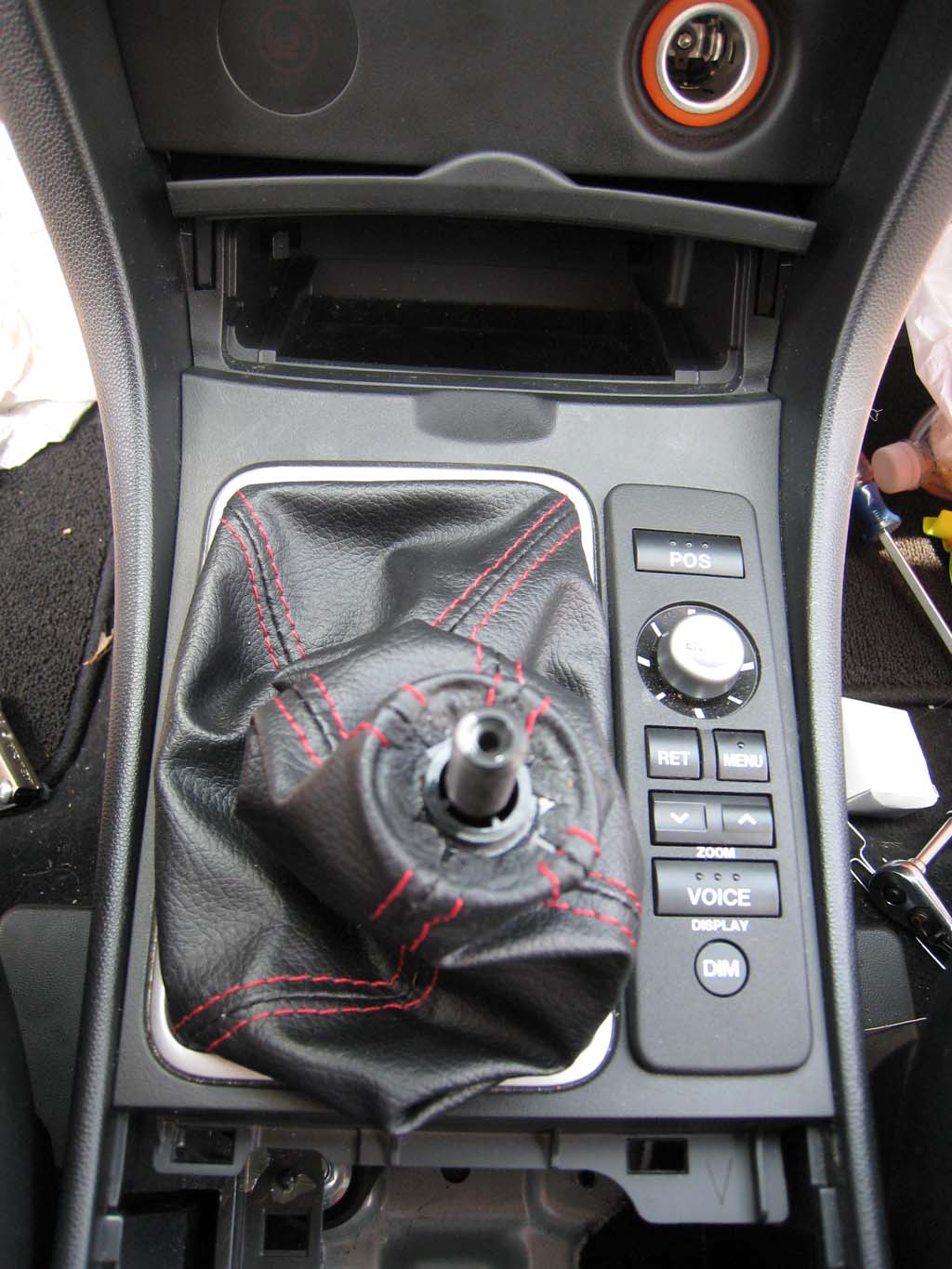

Start by removing the shift knob from shifter. Counter clockwise to remove.

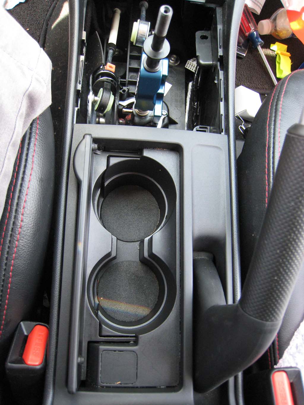

While lifting the rear section of the boot plate, disengage the cup holder section.

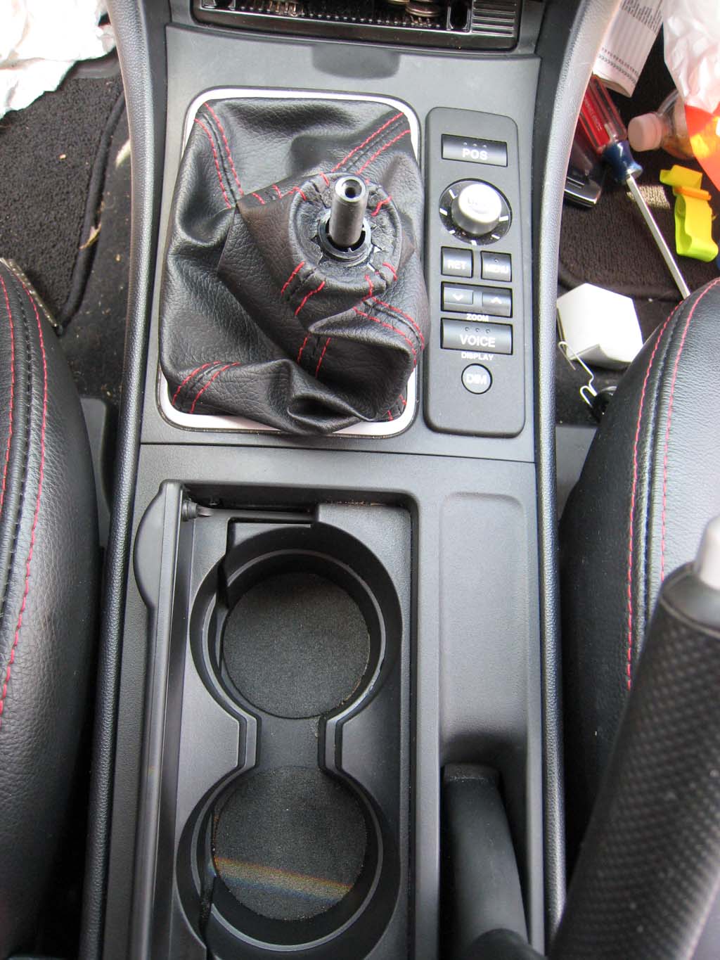

With the 8mm socket, remove these 2 bolts securing the center console to the front dash piece. Also, open up the rear console and remove the two 8mm bolts securing it to the floor. Once removed, Pull the console out and stick in the back seat to give you some room to work with.
http://www.mazdaspeedforum.org/forum/pics...obb sts/14.jpg
Here is what you should be seeing now. The stock shifter assembly. Pay attention to the orientation of the cables and hardware.

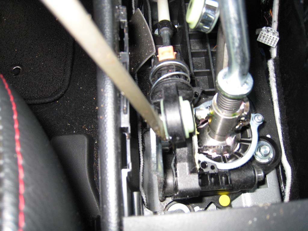

Insert your large flat head screw driver like the above picture. Use the factory plate on the left to support the driver and provide leverage. Push the screw driver towards the passenger side to pop off the cable from the shifter socket. You will repeat this for the other cable as well.
http://www.mazdaspeedforum.org/forum/pics...obb sts/18.jpg

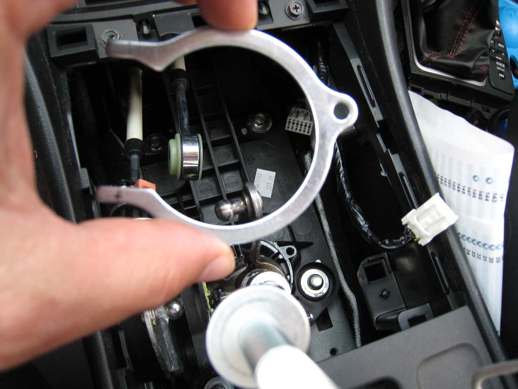

Using the T-20 Torx bit, remove the torx head screw securing the ring in place.
http://www.mazdaspeedforum.org/forum/pics...obb sts/19.jpg
remove the ring and place it to the side.

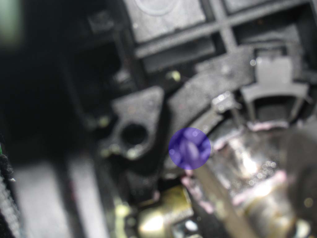

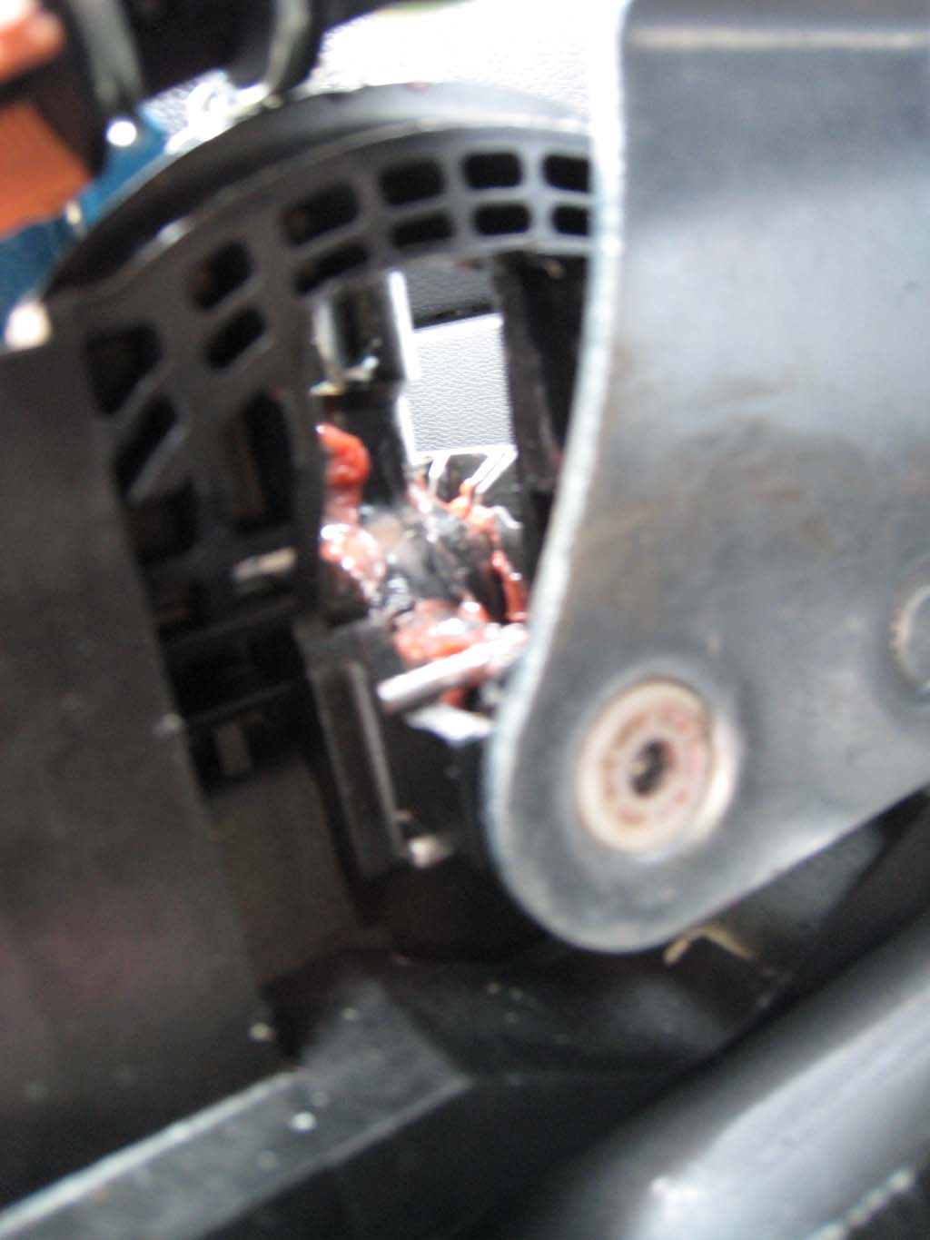

Ok, we are now going to need a 3 paperclips and a small flat blade screwdriver for the next steps. There are two ways you want to depress the 3 retaining clips that hold the shifter base. You can insert the flat head into the slot and push the tabs in, or work the tabs from the side. The idea is to get the retaining clips pushed inward towards the shifter, while hold the clips forward using the paperclips. Once you push the tab in, slide the paperclip behind it to keep it from locking back in. Do all 3 tabs as shown below:

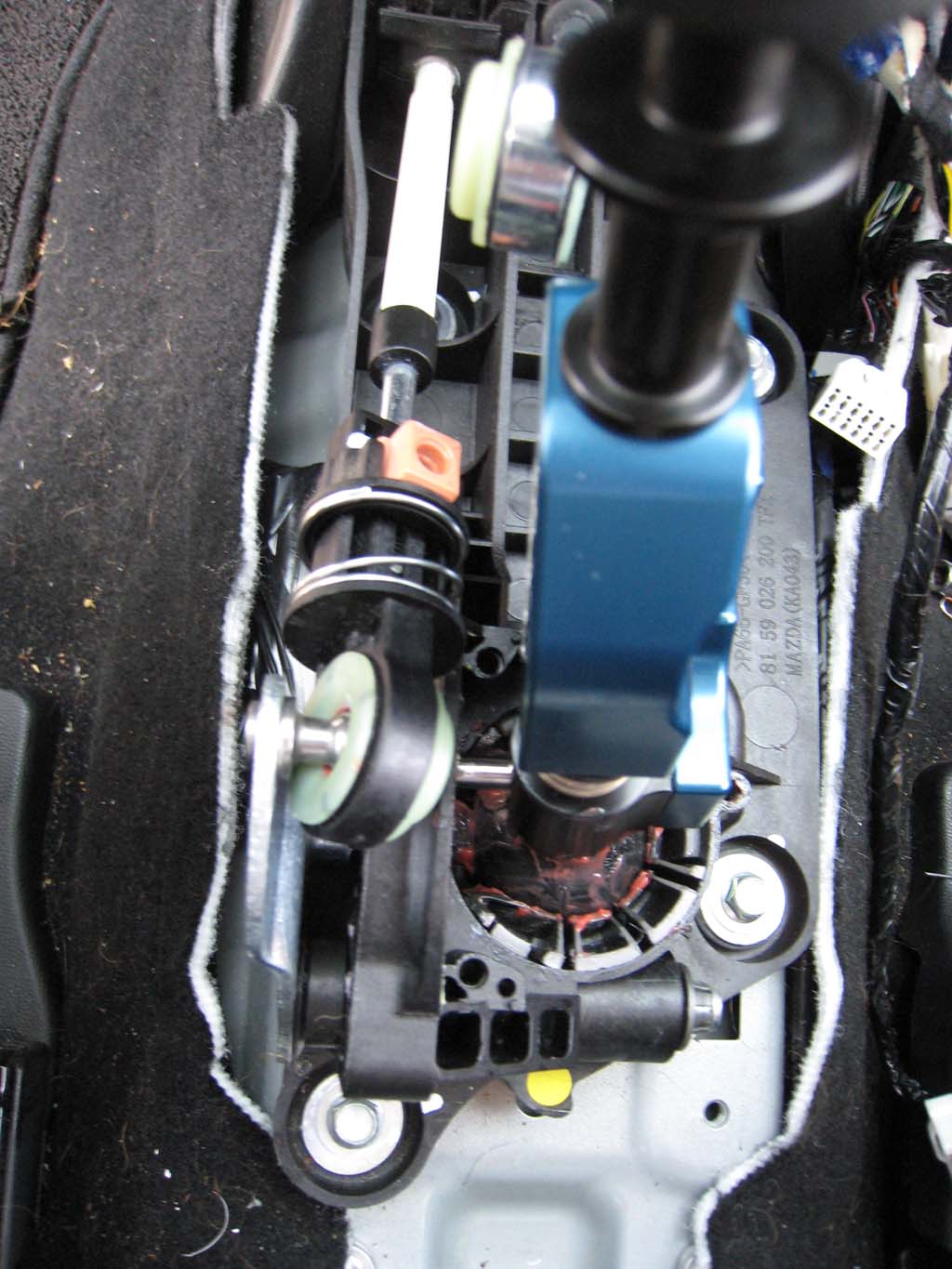

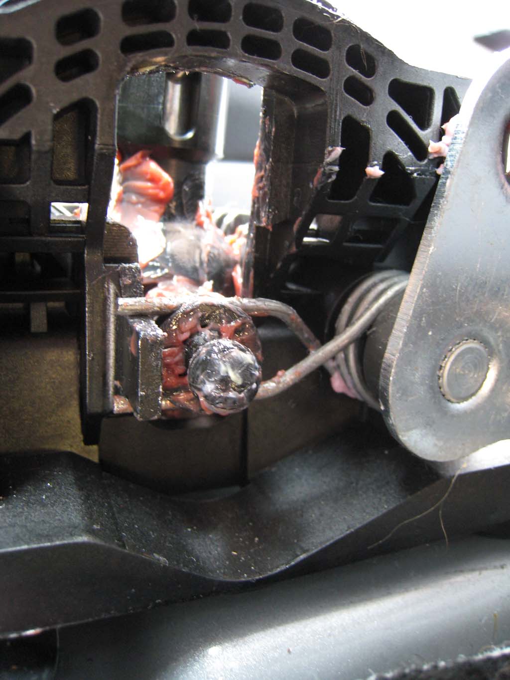

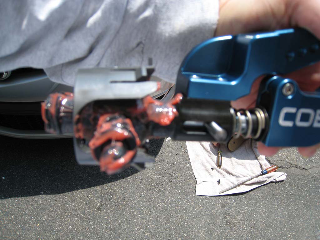

Here is the spring that is talked about in the instructions. What you want to do is get someone in the car with you. Have them pull upwards on the shifter once you get a firm grip on the upper part of the spring using needle nose pliers. Grab the tip of the spring and pull up. Once you have the spring pulled upwards, out of the groove channel of the shifter, tell your partner to yank the shifter up to remove it.
http://www.mazdaspeedforum.org/forum/pics...obb sts/23.jpg
http://www.mazdaspeedforum.org/forum/pics...obb sts/24.jpg

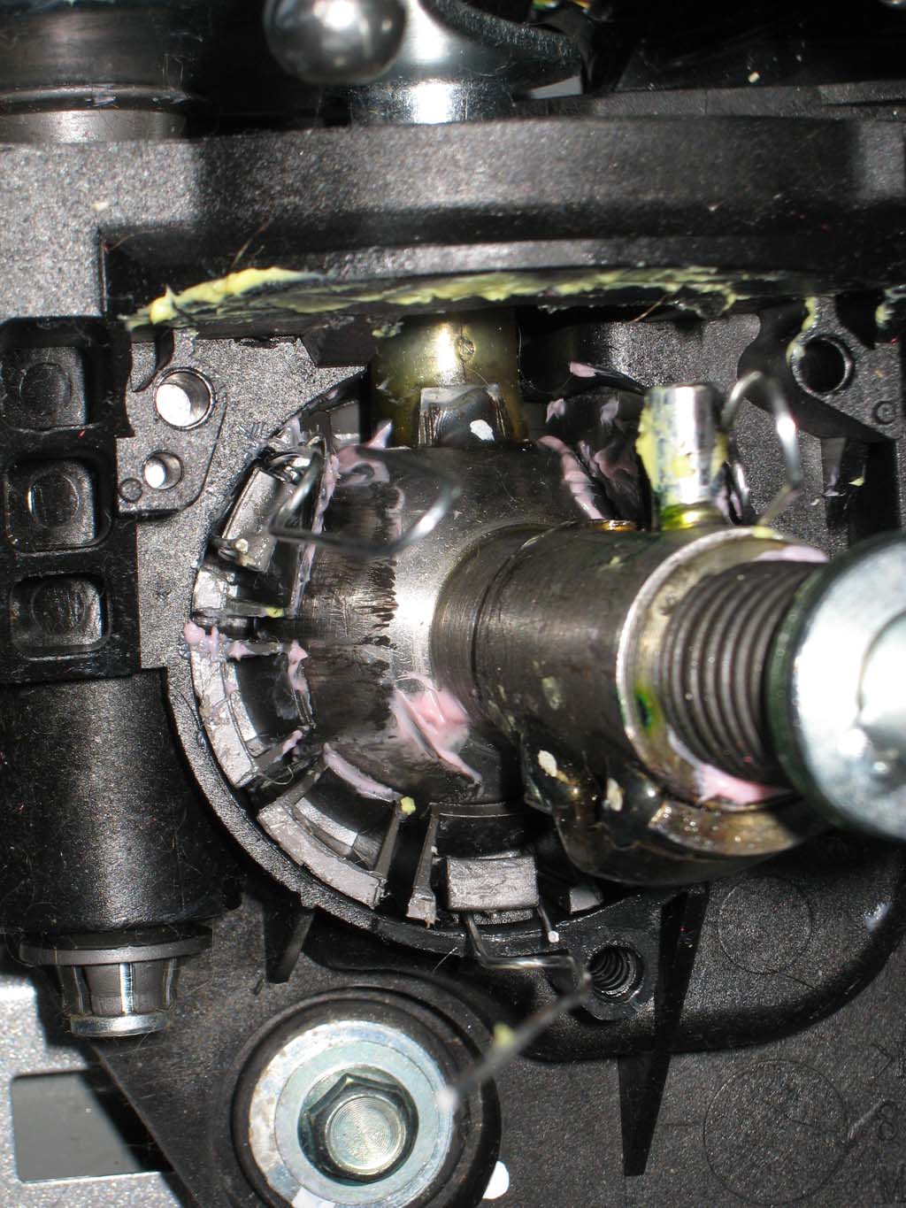

It's time to bust out some moly grease of white lithium grease. You want to liberally coat the base pivot ball and the small pivot balls. Don't be greedy, use a lot.
Once completed, take the rubber o-ring off the stock shifter and xfer it to your Cobb STS. Also, the gray plastic pivot cup needs to be removed and attached to the Cobb STS large pivot ball as well.
http://www.mazdaspeedforum.org/forum/pics...obb sts/25.jpg

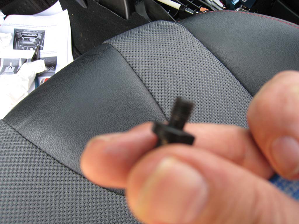

Now here is the painful part... putting the STS in while attaching the spring. The best tip i can give you here is working with someone else. The first thing you should do is remove the small white/blue bushing from the side arm and attach it to the small pivot ball. This will save you some frustrations while installing the unit back in the car.
Using your assistant, insert the STS, lining up the small pivot ball with the side arm, while you are pulling up on the spring. When you have it lined up, secure the shifter into the base. You should here the tabs click as the base engages. At this time take a small rubber mallet and whack the white bushing inwards to the direction of the passenger side to get it to seat. Double check the spring to make sure both the bottom and top are lined up inside the channel groove. Believe it, this sounds much easier in writing than actually doing it. The bottom picture will show you the white bushing that gets whacked by the mallet.

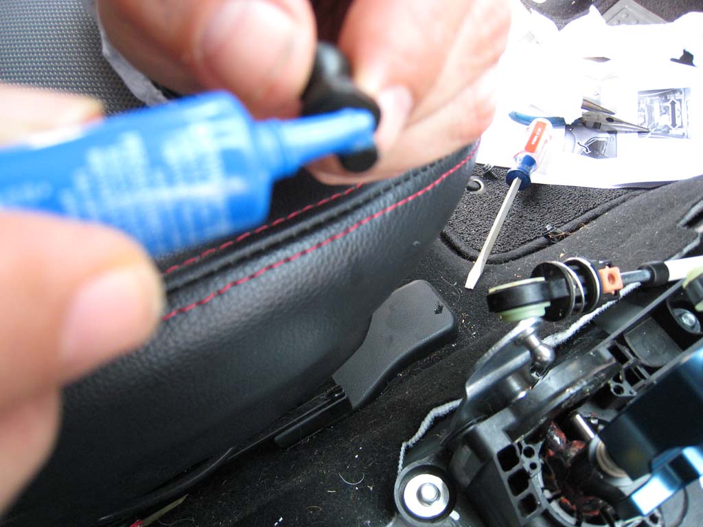

Now its time to select your short throw shift ratio. Choose which hole you want to install the pivot ball in. The top is 30% reduction while the last hole towards the bottom is 10%. I used a little locktite blue on the threads.

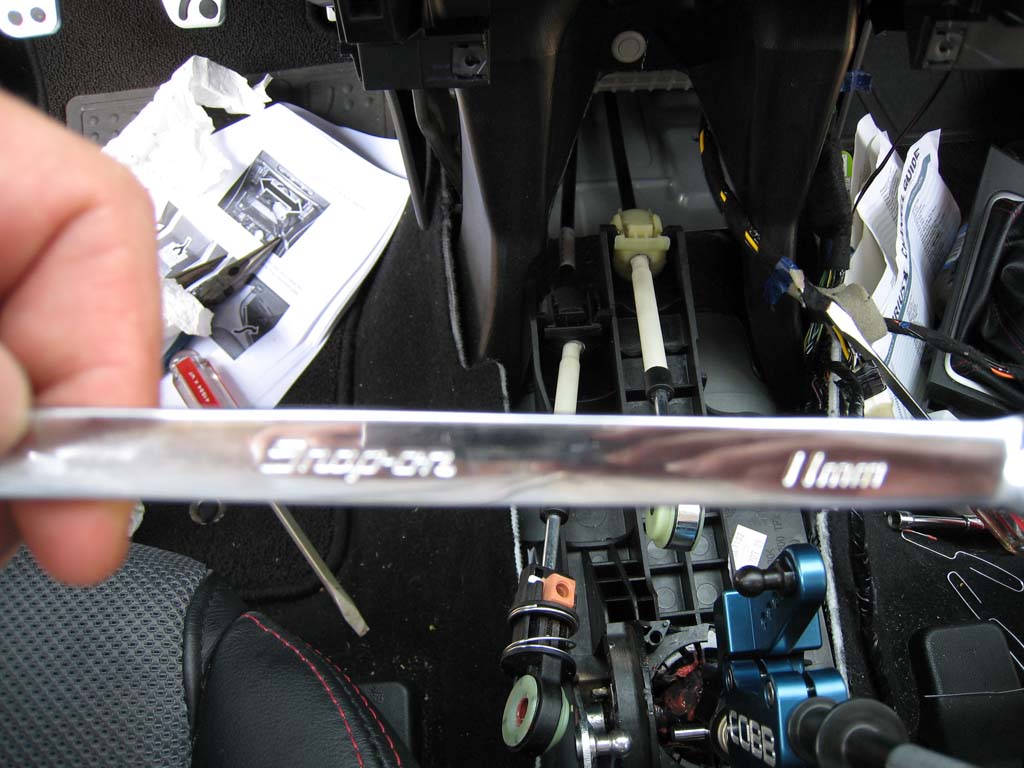

http://www.mazdaspeedforum.org/forum/pics...obb sts/32.jpg
Tighten the pivot ball using an 11mm wrench.

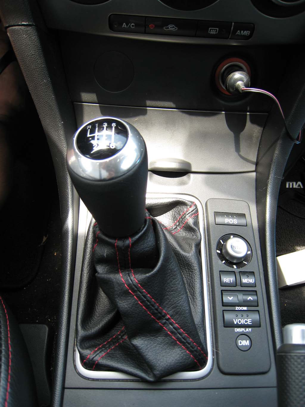

If all went well, your install should look like the above pictures. Now, lets get the console and its associated parts reinstalled.

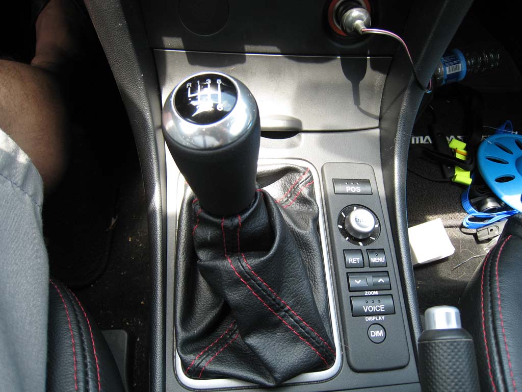

Conclusion, Impressions & Recommendations:
Well, aside from the nasty spring, the install isn't all to difficult. The end result makes it worth it. Prior to the install, i had the TWM Bushings installed in my car. With the addition of the Cobb DA-STS, they made no difference to how the shifter felt. So, i removed the bushings and gave them to my friend who has a TWM STS... He needs them more than i do :)
The best impression i can give while driving the car now, is it feels like we have a very expensive, well built transmission. If any of you have ever driven a mustang that had a pro 5.0 power tower or Steeda Tri-Ax shifter installed, that's the best comparison i can make to it. The shifting is with precision now. All of the slop is eliminated, gear shifts are quick and positive. The additional weight of the Cobb DA-STS adds to how well the car shifts now. Rowing through the gears has never been more fun. This shifter compliments the additional power we have added to our car. Those of you who drag and road race, will enjoy this shifter as well. I ended up raising my shifter about 1 inch as i felt it to be more comfortable to me. You could further enhance the Cobb DA-STS by adding a new weighted shift knob if you prefer.
How does it compare to the TWM STS? Its a night and day difference. The weight that Cobb added to this shifter has paid off and can be even further enhanced by adding a weighted shift knob.
