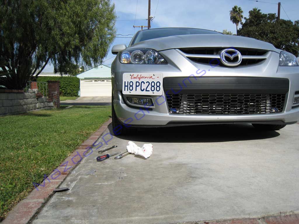

Tools:
Loctite
Flathead screwdriver
Phillips screwdriver
3/8ths allen wrench (common tool for american brake caliper replacement)
3/4 open/box wrench
Original towhook located inside your trunk
and a little thing we like to call common sense.
http://www.mazdaspeedforum.org/forum/pics...towplate/2.jpg
Start by popping the tow hook cover on your bumper using a flat blade screwdriver as shown below:

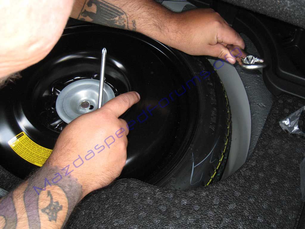

Now, take your stock towhook located in the trunk of your car and thread it into the CPe towplate shaft. You are using this an extension, therefore, no bumper removal is necessary in this step. Thanks Lenny!

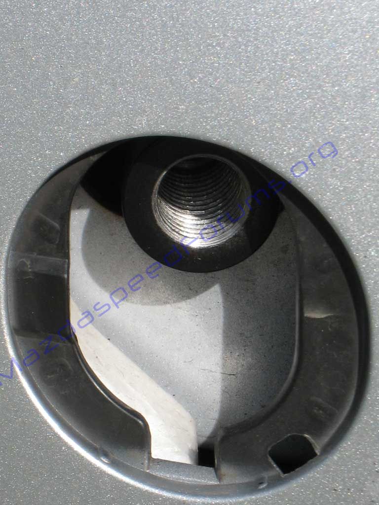

Now, thread the piece into the tow hook hole
http://www.mazdaspeedforum.org/forum/pics...towplate/7.jpg
http://www.mazdaspeedforum.org/forum/pics...towplate/8.jpg
http://www.mazdaspeedforum.org/forum/pics...towplate/9.jpg

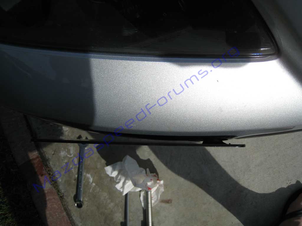

Now, you will need to separate the original tow hook from the shaft (this is why only finger tightening is required) As you start unthreading the tow hook from the CPE shaft you might want to apply pressure to the shaft with a finger to keep it from spinning itself out of the threads)
http://www.mazdaspeedforum.org/forum/pics...owplate/10.jpg
http://www.mazdaspeedforum.org/forum/pics...owplate/11.jpg

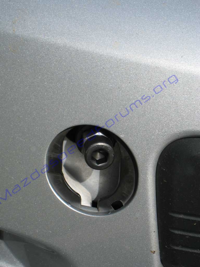

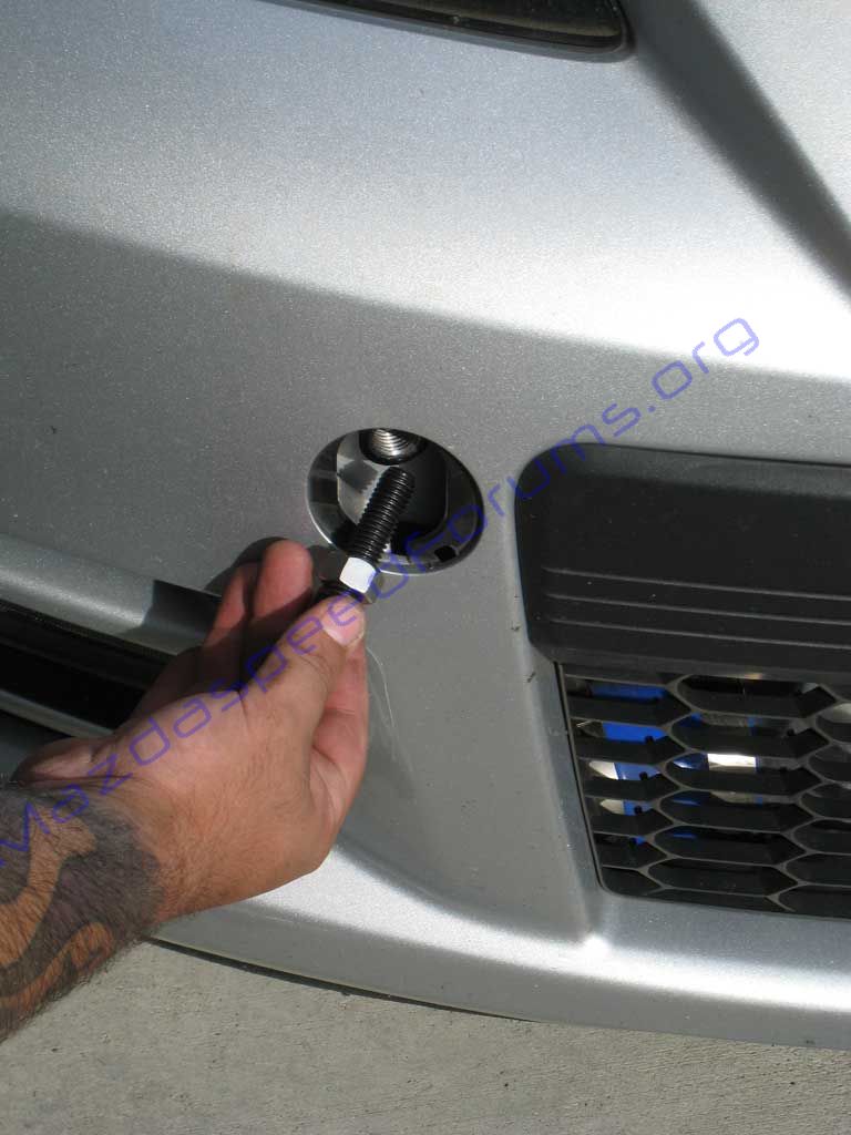

Here is the CP-e shaft installed in the hole.
http://www.mazdaspeedforum.org/forum/pics...owplate/12.jpg

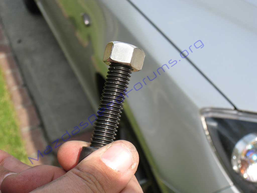

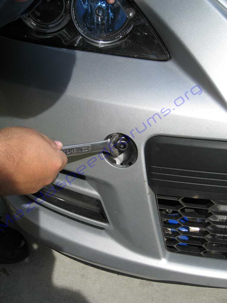

thread in the 3/4 inch nut to the allen bolt (both provided by CPE), please thread the nut in all the way.
http://www.mazdaspeedforum.org/forum/pics...owplate/13.jpg

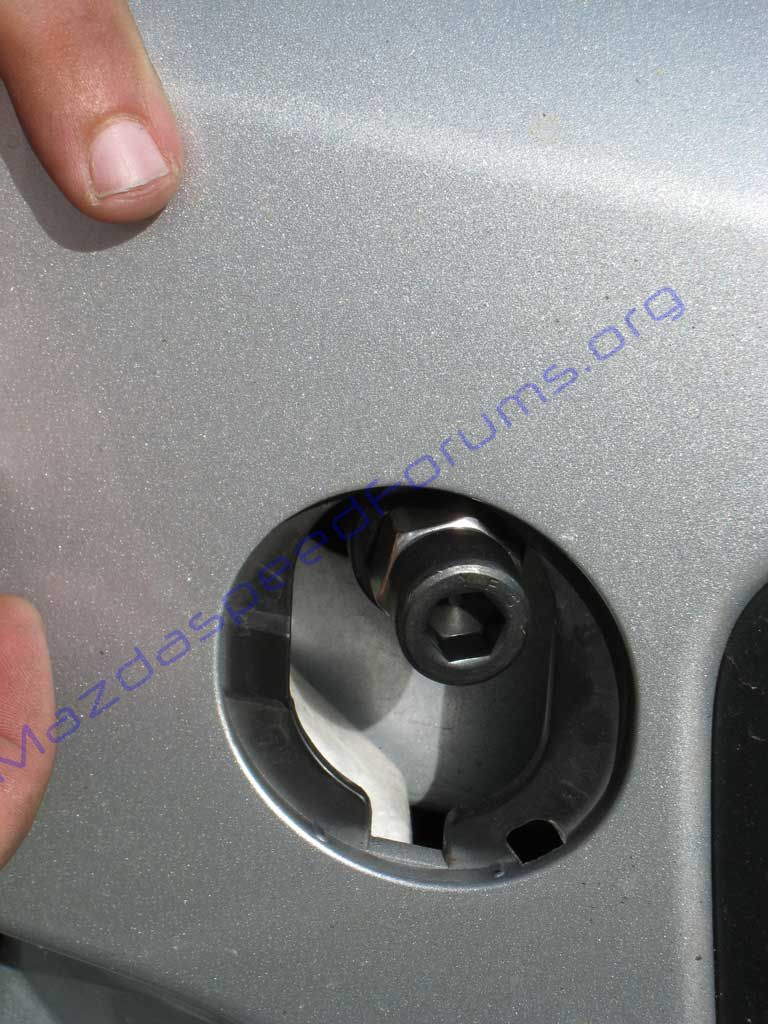

Follow this by now threading in the allen bolt to the female end of the CPE shaft (that is already 90% threaded into the bumper hole) Make sure there are enough threads mating.
http://www.mazdaspeedforum.org/forum/pics...owplate/14.jpg
http://www.mazdaspeedforum.org/forum/pics...owplate/15.jpg

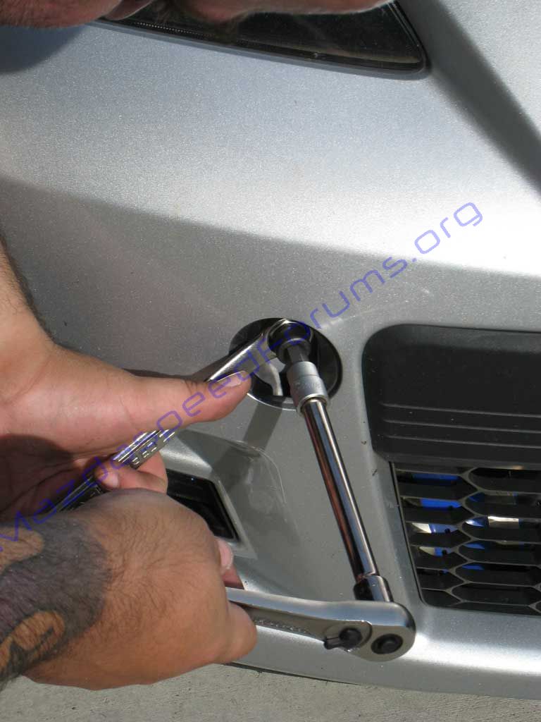

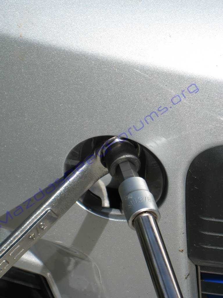

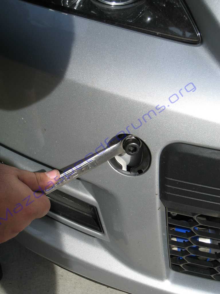

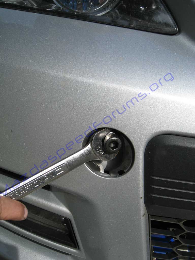

You will notice that the 3/4 inch nut prevents the allen bolt from being threaded in all the way, take the box end of a 3/4 inch wrench and start tightening clockwise. Since the nut cannot thread in any further it forces the CPE shaft to be able to be tightened all the way now without the necessity of removing the bumper. (I would not recommend using an adjustable wrench for they are bulkier and you may not be able to fully tighten the nut without scratching the bumper, but that's why the RIGHT tool needs to be used.)
http://www.mazdaspeedforum.org/forum/pics...owplate/16.jpg
http://www.mazdaspeedforum.org/forum/pics...owplate/17.jpg
http://www.mazdaspeedforum.org/forum/pics...owplate/18.jpg
Remove allen bolt from CPE shaft while holding the 3/4 inch nut and then remove the nut from the bolt. (the nut will not be used for this install any further)

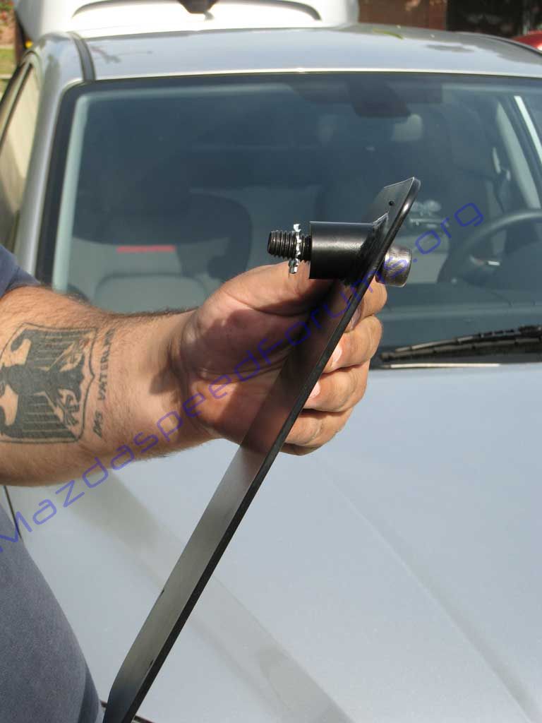

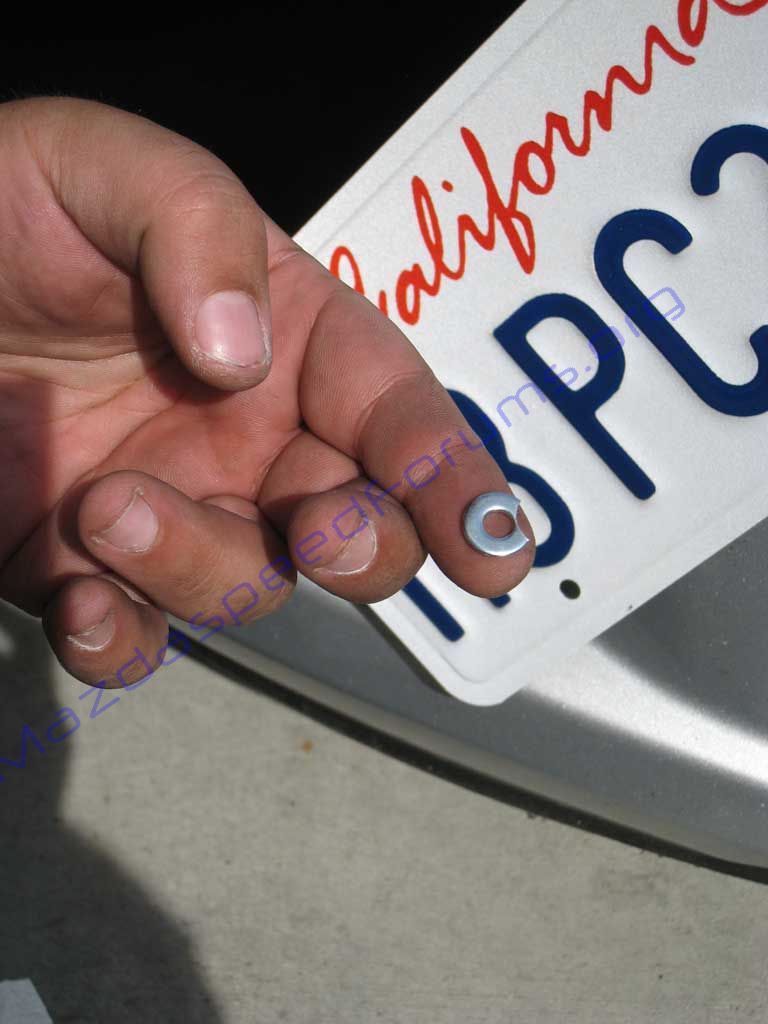

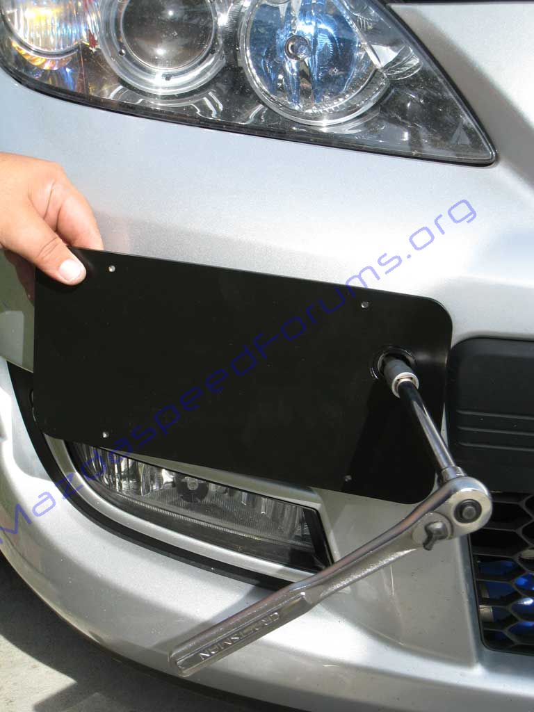

Place one of the larger washers in between the back of the CPE plate mount and the exposed end of the CPE shaft and with the allen bolt tighten them up. (as you are tightening you will need to keep an eye on the plate mount for it to stay leveled.
http://www.mazdaspeedforum.org/forum/pics...owplate/22.jpg
http://www.mazdaspeedforum.org/forum/pics...owplate/23.jpg
http://www.mazdaspeedforum.org/forum/pics...owplate/24.jpg

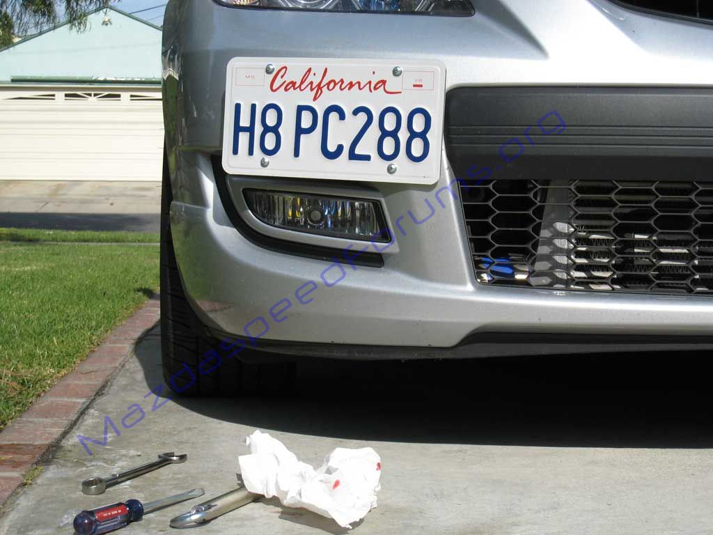

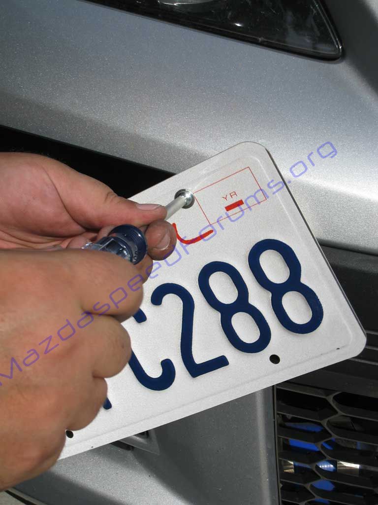

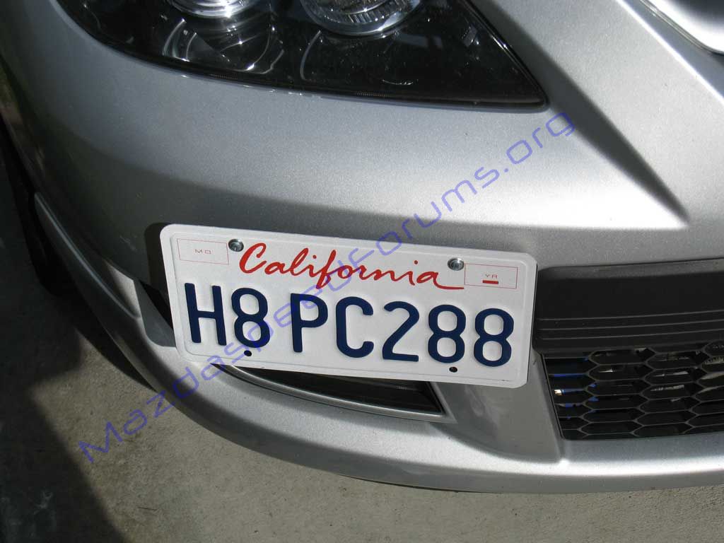

Once the complete assembly is tight and leveled proceed to mount the front license plate with the 4 screws and washers CPE provided. (yeah , even this washer too)
http://www.mazdaspeedforum.org/forum/pics...owplate/25.jpg
http://www.mazdaspeedforum.org/forum/pics...owplate/26.jpg
http://www.mazdaspeedforum.org/forum/pics...owplate/27.jpg
When tightening license plate do not use excessive force as you will find that it will warp the plate.
http://www.mazdaspeedforum.org/forum/pics...owplate/28.jpg
http://www.mazdaspeedforum.org/forum/pics...owplate/29.jpg
http://www.mazdaspeedforum.org/forum/pics...owplate/30.jpg
Don't forget to place your stock tow hook in the back of the spare tire area again!
http://www.mazdaspeedforum.org/forum/pics...owplate/31.jpg

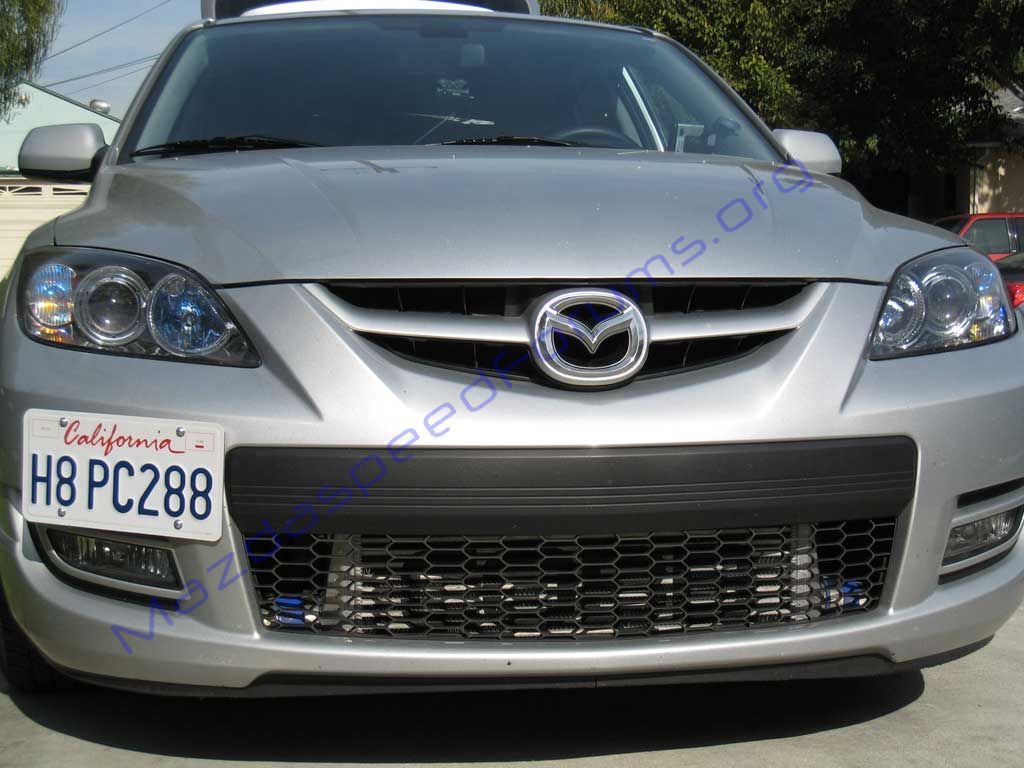

Conclusion:
Definitely a simple and fine product by CP-e. The only thing we could recommend is the fact that the bumper does not have to be dropped to pull off this installation, so CP-e should be able to omit this step in their instructions.
As said earlier, this piece of extremely solid, so don't fear your plate flopping around or falling off with this piece, It's not going to happen. It's also, easy to remove for track events with the use of the allen. There is really no reason why people should not purchase this piece as many states have a front license plate requirement.
