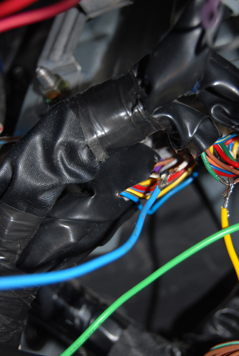

3: Slide the driver's seat all the way back, or remove it referring to a workshop manual for instructions. Lay down on the floorboard under the dash, looking up behind the dash. On your right-hand side (closest to the driver's side door), you will find the ECU. As you lay there, you will notice there are four connectors plugged into the ECU. We will be working with the connectors 1, 2, and 3 (the three closest to the passenger's side). They are labeled from left to right (passenger's side to driver's side)

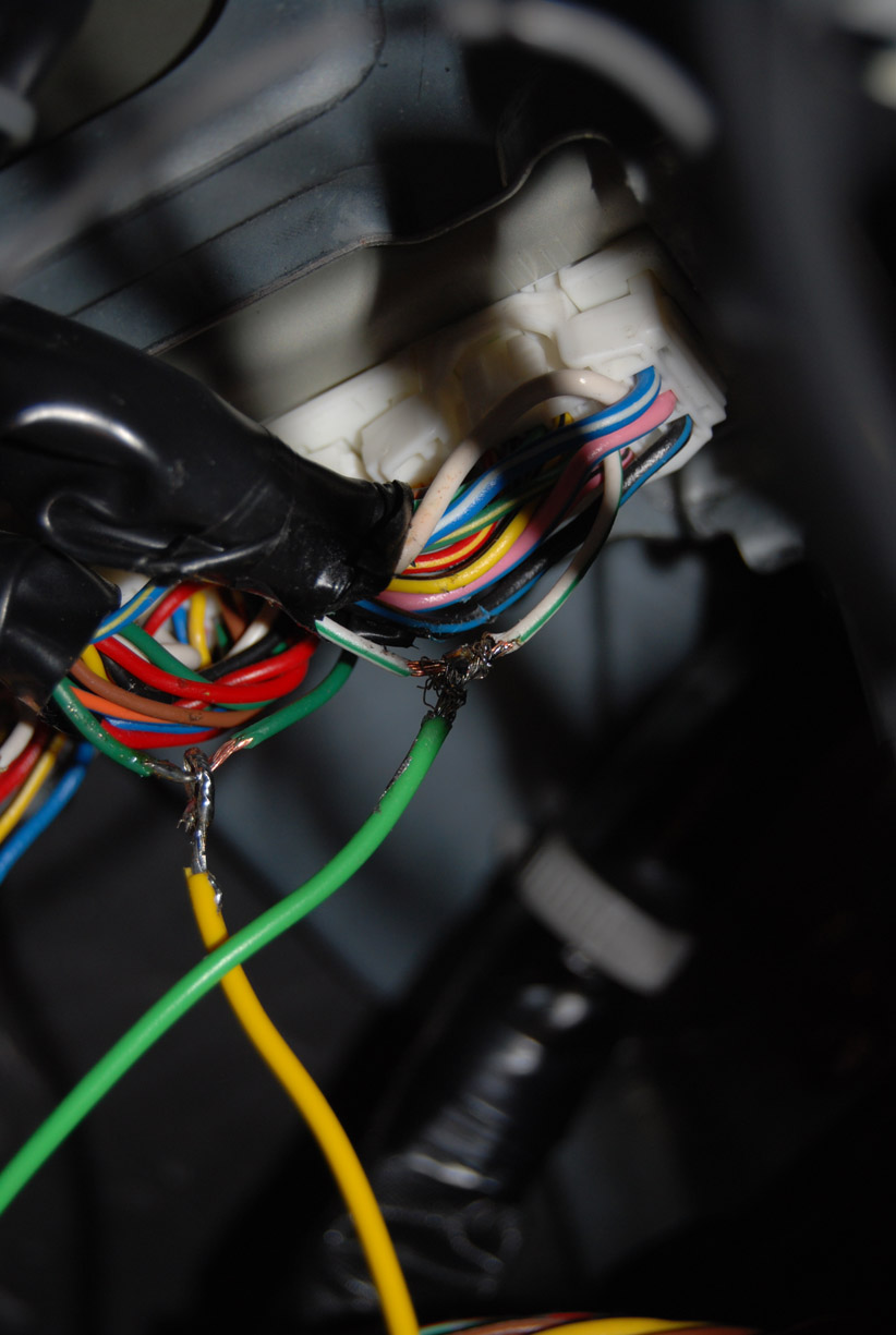

4: On the first connector, locate the 1H WHITE / GREEN Clutch Pedal Position Switch wire and carefully strip back some of its insulation. See the attached ECU pinout diagrams for more information. Be sure not to break the wire. Connect the 18 AWG GREEN wire from the WOT Box to the 1H WHITE / GREEN Clutch Pedal Position Switch wire. Solder the connection and cover with electrical tape. Be careful not to solder over your head and always wear safety glasses while soldering!
5: On the second connector, locate the 2C GREEN Crankshaft Position sensor wire and carefully strip back some of its insulation. Be sure not to break the wire. Connect the 18 AWG YELLOW wire from the WOT Box to the 2C GREEN Crankshaft Position sensor wire. Solder the connection and cover with electrical tape.
6: On the third connector, locate the 3D WHITE Accelerator Pedal Position wire and carefully strip back some of its insulation. Be sure not to break the wire. Connect the 18 AWG BLUE wire from the WOT Box to the 3D WHITE Accelerator Pedal Position sensor wire. Solder the connection and cover with electrical tape.

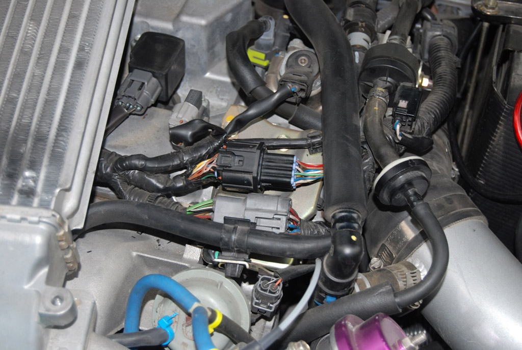

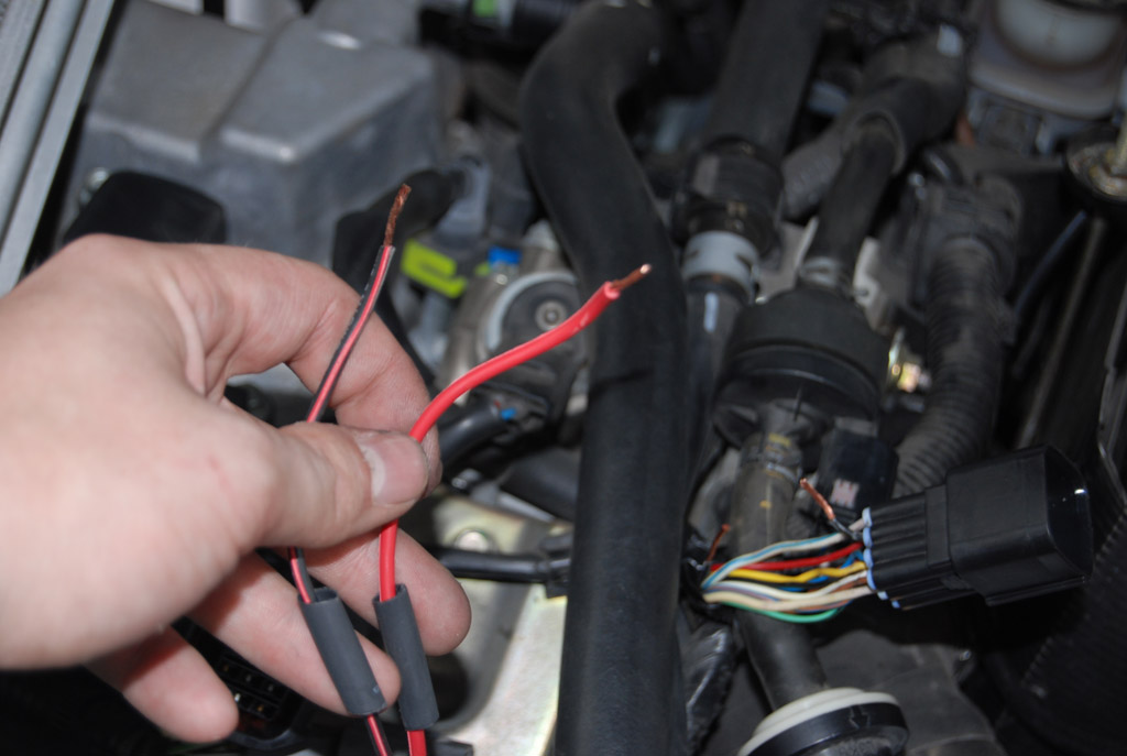

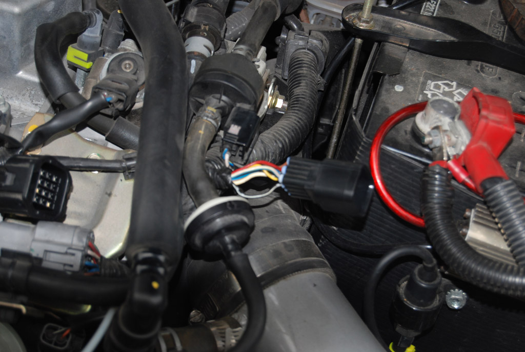

8: Now, back in the engine bay, remove the top mount intercooler shroud using the 10mm socket. Next to the intercooler, where the shroud's 'flap' was at, you will see a grey and a black connector shown below.

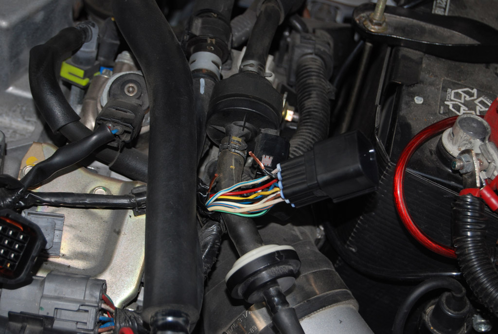

We are interested in the black one. Disconnect the connector, and pull the driver's side portion under all the evap components to better access the harness. On the bottom side of the clip, there is a BLACK/WHITE/GREY SPOTTED wire that corresponds to a GREEN wire on the other connector. This is the ignition power wire. Cut that wire and strip back each end about 5/8".

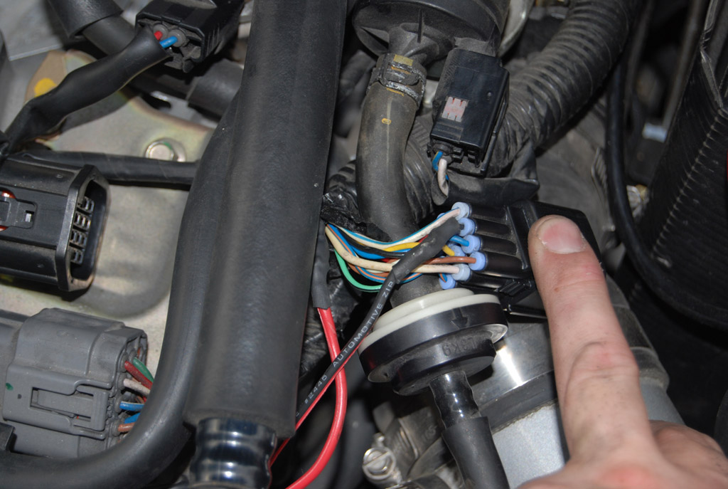

Route the 16 AWG RED / BLACK double-wire to this location. Split apart about 6" of the 16 AWG RED / BLACK wire from the WOT Box. Strip the ends of the wire and slide two pieces of provided heat shrink tubing over the wires.
Connect the 16 AWG RED wire to the side of the BLACK/WHITE/GREY SPOTTED wire that is going away from the connector. Connect the 16 AWG BLACK wire to the side of the BLACK/WHITE/GREY SPOTTED wire that is going towards the connector as shown. Solder the connection and use the provided heat shrink tubing to cover the connection. Tape up the harness and reconnect the connector.

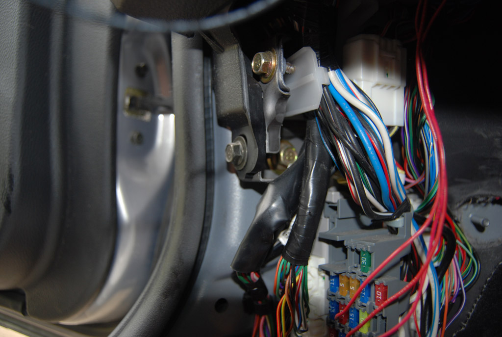

9: Back in the passenger compartment; remove the whole interior panel covering the interior fuse box (not just the insert). Looking at the lower portion, you will see a bolt that holds the bracket to the frame (the fuzzy one behind the looms in the pic below).
We will be using this as the grounding location. Using the provided ring terminal, attach the 18 AWG BLACK wire from the WOT Box to this ground connection. You can cut the black wire to about 18", but be sure to leave enough wire so that the harness will have enough slack to make the WOT Box accessible in the knee compartment once reinstalled. Be sure to crimp the ring terminal connection solidly and solder if possible. Use the 12mm socket to remove the bolt, and replace with the terminal connector in place.

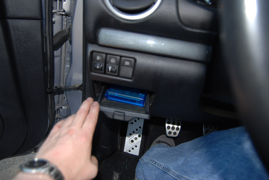

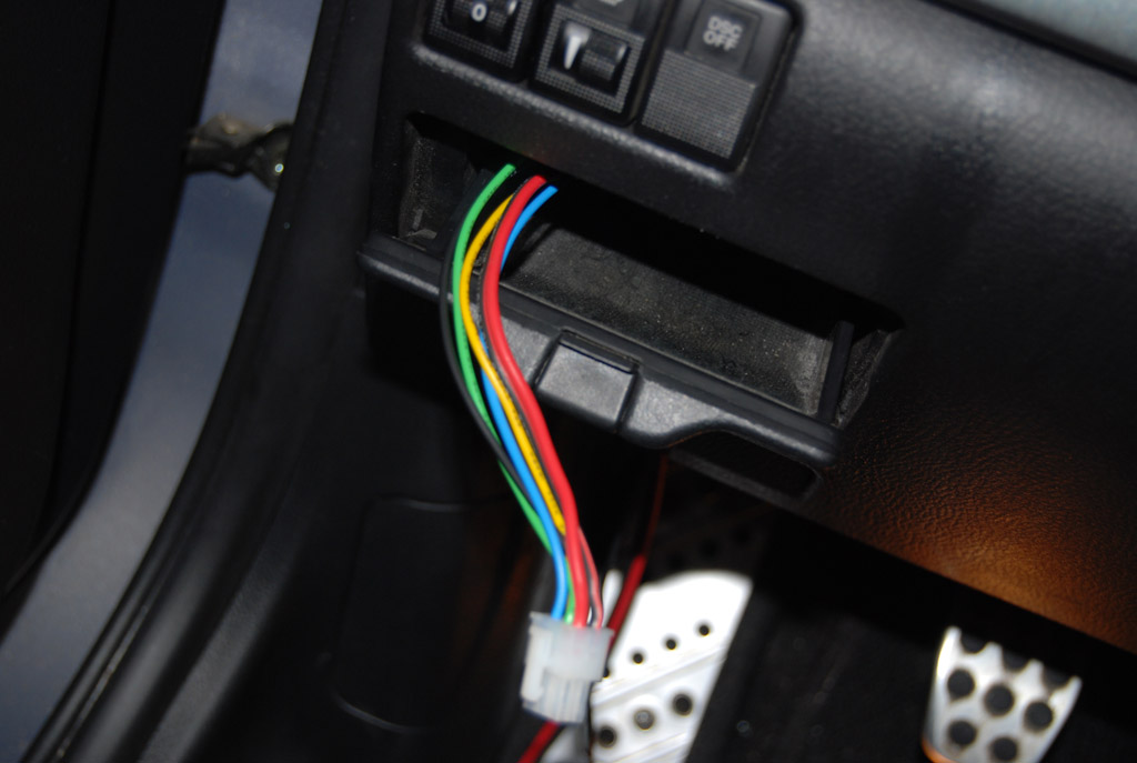

9: Next, you will need to drill a 3/4" hole in the right/back of the knee compartment pocket (the moving peice). Don't worry, it will be out of sight. Run the WOT Box wiring harness connector through this hole, into the compartment.
Connect the WOT Box to the connector.

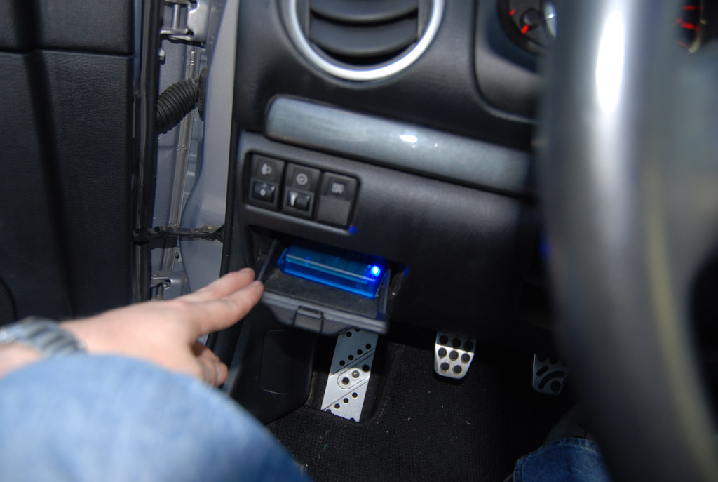

Before taping everything up, key the car "ON" to ensure everything is working properly.
Once you verify proper operation, tape up all connections, bundle all associated wires, and clean up any messes.
