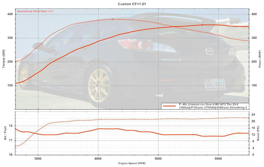

Here is my most recent vdyno. I have a gt2871r so it's pretty similar to the s3. This is on 93 only.
FREEKTUNE FTW!

Something must be seriously wrong with my car because on 93 pump gas I'm only making 300whp on a gtx2867 cf1.01 at 22psi and 13.5 timing at redline/11.5* at 6k. This is in Florida at sea level. You're making 50+whp more than me. I'm also tuned by freek. I'll post up a recent VD as soon as I get home. I think it was 294whp/335wtq at 78 degrees and semi high humidity today.
What other mods do you have? I have a 3.5" intake, 3" single exit catless exhaust and a custom exhaust manifold.

Mods are in my sig. I'm still on the stock exhaust manifold and I have the stock catback with a catted CPE downpipe. Here's a recent graph and log.

Yea sorry no sigs on Tapatalk. I'm just flowing a lot more air. Nothing is wrong with your car.

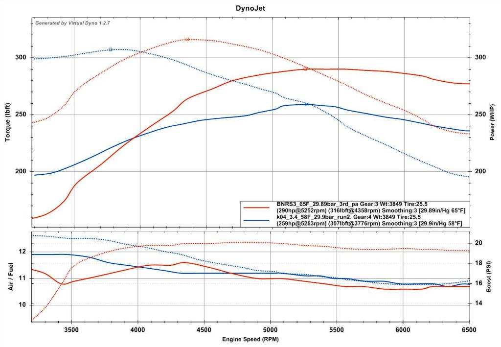

Damn, here I am having a problem pushing into 300WHP on BNRS3/brand new motor with full intake/exhaust flow mods on 91 pump gas. @ 20psi, we are already seeing 1-2kr from 5500+ with ~9 degrees advance @ 6500.
I have no clue how @boostdmazda3; put down this on California pump gas alone:
Im at 21 psi with 12 degrees of timing made 334whp 370tq running at 100% injector duty cycle.
I would like to know this myself ...

ACN91 is just terrible fuel. Though some cars do seem more octane sensitive then others, maybe try to wring out some lower BATs with TIGs/TB coolant bypass. Remember that 300whp on an MS6 is different than 300whp on an MS3.

I am actually kind of shocked this is about as far as the BNR + 91 goes for my base tune. Unless someone has really good pump gas, my suggestion at this time would be to keep k04 and get WMI or E85 + tune instead and not dump $1200 on a turbo that really doesn't do a whole lot on 91 pump gas. That's a lot of money for not a lot of return IMO.
If you have really good 93, well there's an argument for that.

In Florida here on 93 I made 294whp on 93 and just about 350 on e85 here is my results.E85/93 compare to just 93

Here you guys go, my current BNR tune on new engine vs. Stratified tuned k04 on old engine on crappy 91 pump gas, SAE corrected. The BNR setup on 91 is still getting some kr (1-1.5) north of 5k so ignition/advance and boost needs to come down a bit north of 5500.
I thought it was pretty cool how the curves aligned from two different motors, 1.5 years apart with 2 different turbos. I love this graph.
Pump gas for pump gas, the BNR still outflows the k04 and holds power to redline. You can see how the torque peak hit is about 500RPM later and the BNR setup holds the power curve a lot flatter north of 5k. This graph perfectly illustrates what the BNR does for a k04 car.

Great comparison. I just can't wait to get some wmi in the mix as I am sure you feel the same.
