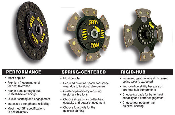

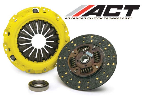

So during my bt build I found out I needed a new clutch. As we all know the factory clutch is stupid expensive. Most times you have to get a new fly wheel cause most places do not have the means to resurface the dual mass flywheel. So a new one cost around $1000 just for the fly wheel.
So I went with the act 6 puck sprung with the pro light fly wheel. First thing is do not attempt to install this with out being very mechanically inclined or have a group of friends that do know what they are doing.
First impressions is the clamping power of this clutch is great and can handle most abuse that you throw at it. Also if you flat foot shift this thing handles that great with no issues.
Now as far as noise goes there is added noise.You especially hear it if you have a transmount. I am running a jbr 70 duro trans mount so if you have anything harder then that you for sure hear it.
If you have any more questions about this clutch or is interested in purchasing this clutch or act clutch please hit me up so I can get you the best price and availability.

which disc did you used ?

I love this clutch. Works great. Never had an issue with slipping. Little tricky to get used to. I recently replaced the disc and pressure plate. The last disc lasted 32k before it needed to be replaced the buttons were starting to dig into the fly wheel. It probably would have made it longer miles if I did not change jobs and have to sit in traffic constantly.
Great clutch for the money. If you want some more longevity go for the full disc. There are guys running the full disc with 500hp with no slipping/issues.

you mean the black organic one rated at 415 lbs of torque that handle 500 ?

as far as pedal feel goes it is noticeably harder then stock. But over time I have gotten use to it. The hardest part about getting use to this clutch is at stop lights just trying to mach the revs right off the bat with out slipping the clutch. If I get 30-40 out of this clutch that will be fine with me.
If I where to do this again I would probably go with the street disk, just for the ease of having a easier daily driver transmission.
But either way this clutch has been great it has handle all the abuse I have put to it, and it has handle the gt2871 r turbo great with my e85 freek tune. Next part will be adding water meth to the part and we will see how it does then.
