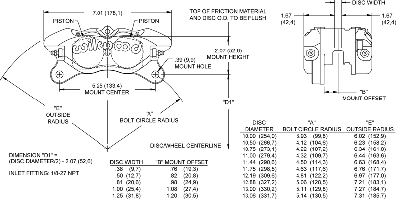

Do you have the part number for the actual caliper used? so I can get measurements off their website.
thanks
The part number for the caliper used in the MS3 4-pot kit is 120-9692. Here's the drawing:
The part number for the caliper used in the MS6 4-pot kit is 120-11132.
