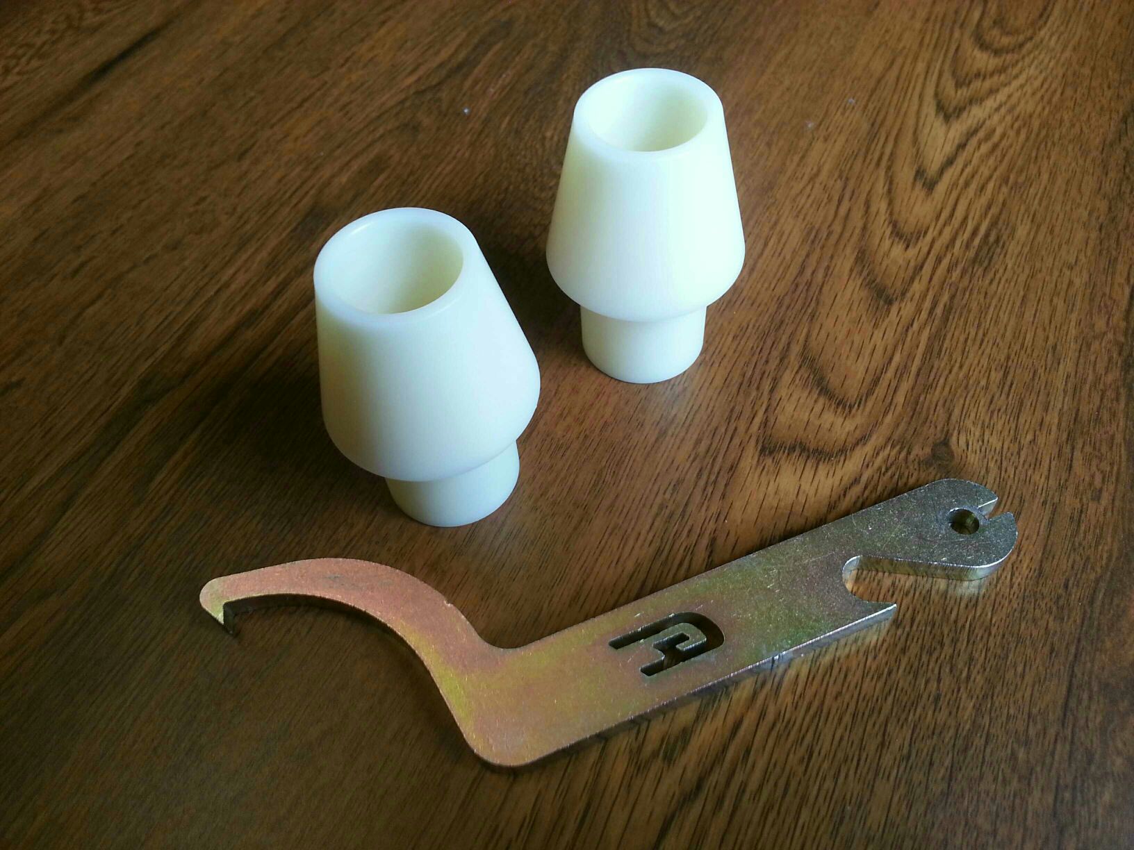

Hear anything else from GC on the spring cups? I was 4th on the list and still haven't received mine.
Donovan said they all went out. If you don't have it by the end of next week, either let us know or give GC a call and ask for Donovan.
Will do. Thank you for the update.

Had mine show up Thursday.
