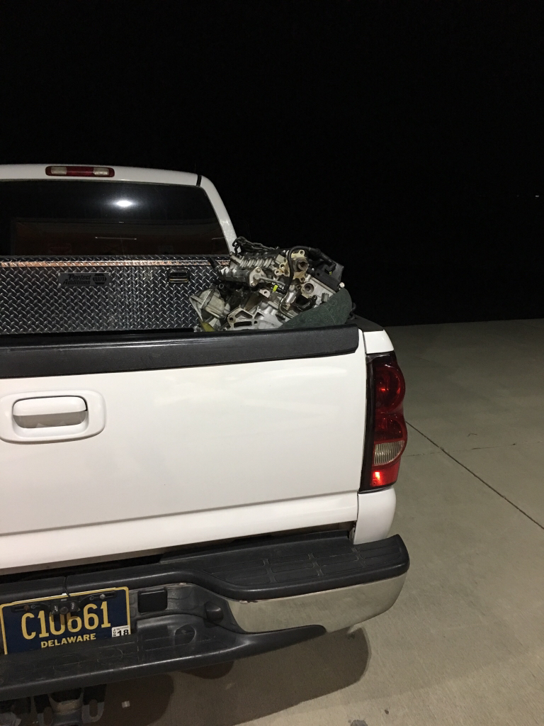

Heading to South Jersey tomorrow to pick up a Gen4 4.8 and a TH400, give me some options to play with.

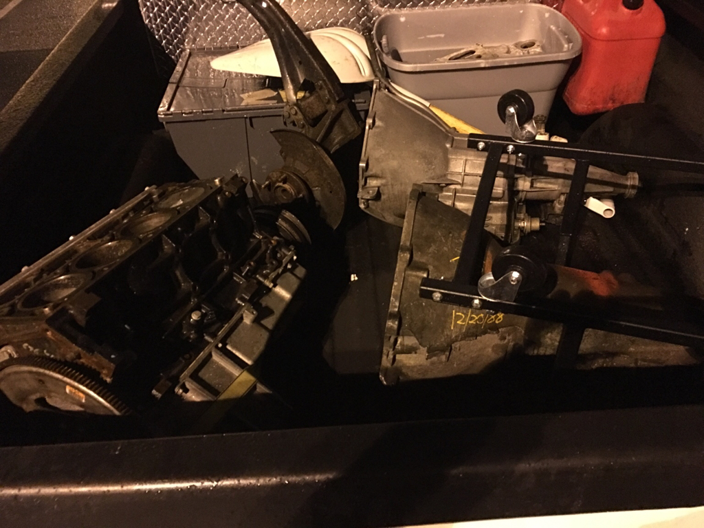

$250 for a GEN4 4.8L short block, TH400, and Powerglide.

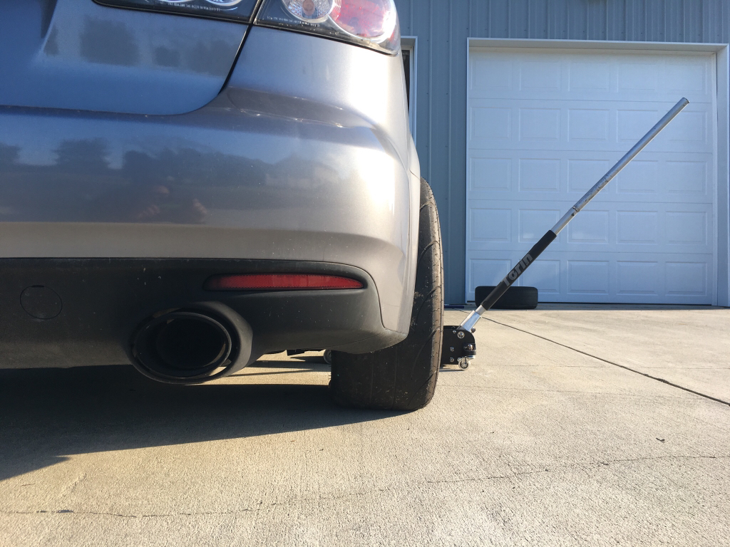

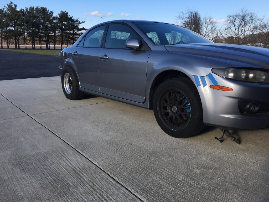

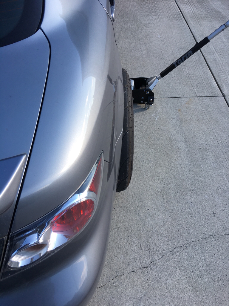

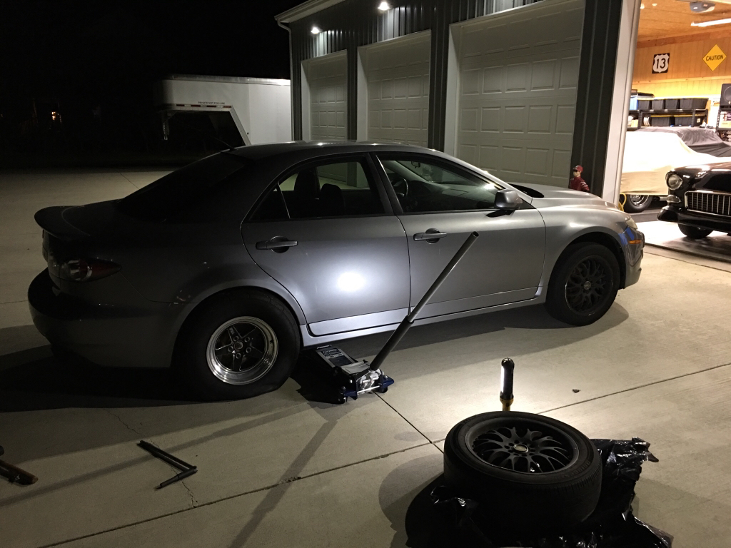

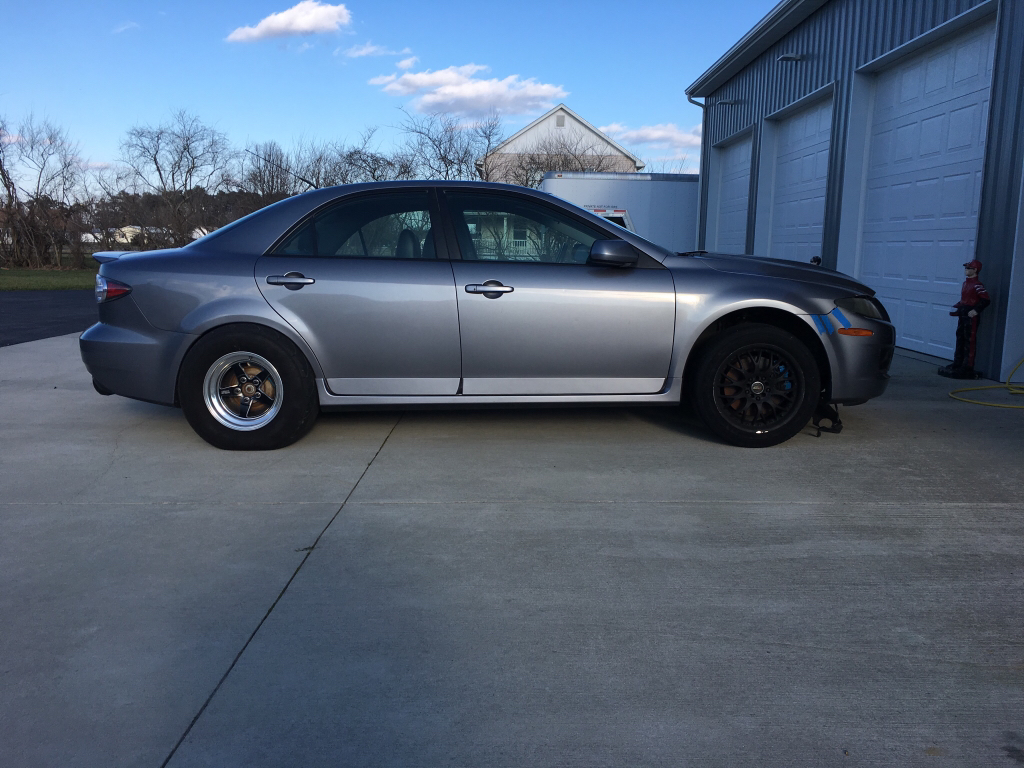

Little teaser. Friend let me borrow one of his Welds to test fit.
This is a 15x8 5.5"BS (21mm offset) with a 275/60 (28") I'll be doing a 26" tall but tire width is unknown. Also the wheel hit the caliper on the face of all places. So a little spacer will solve that issue or shaving the caliper down. Right where the barrel dips to meet the spokes. I'll probably order a set of 15x8 6.5"BS (51mm offset)

 Old 01-28-2017, 07:19 PM   #45
BigRed06's Avatar
Location: sanford, fl
Posts: 96   (View Stats)
BigRed06 is a name known to allBigRed06 is a name known to allBigRed06 is a name known to allBigRed06 is a name known to allBigRed06 is a name known to allBigRed06 is a name known to all
Thanked 12 Times in 12 Posts
Subbing to this so I can follow along even more, I'll continue to help where I can. Glad someone is making my dream come true, I'll be planning out my swap along the way of urs

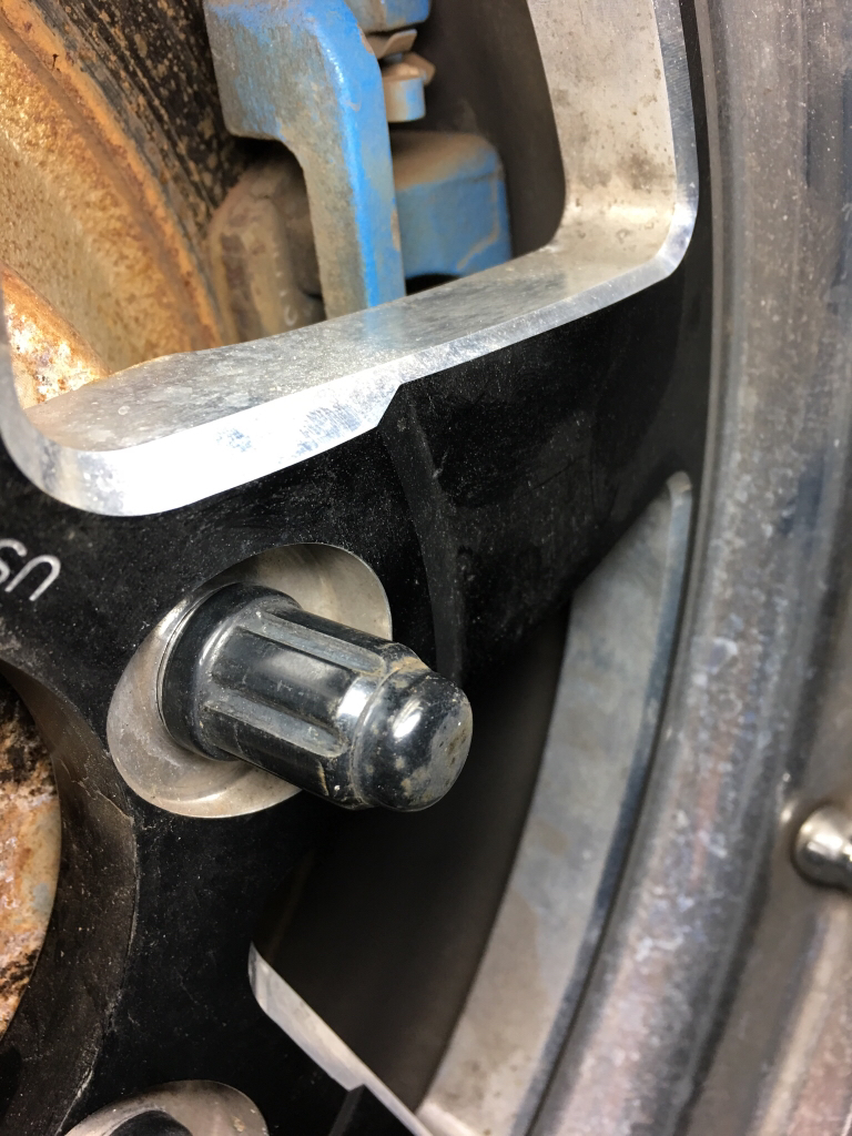

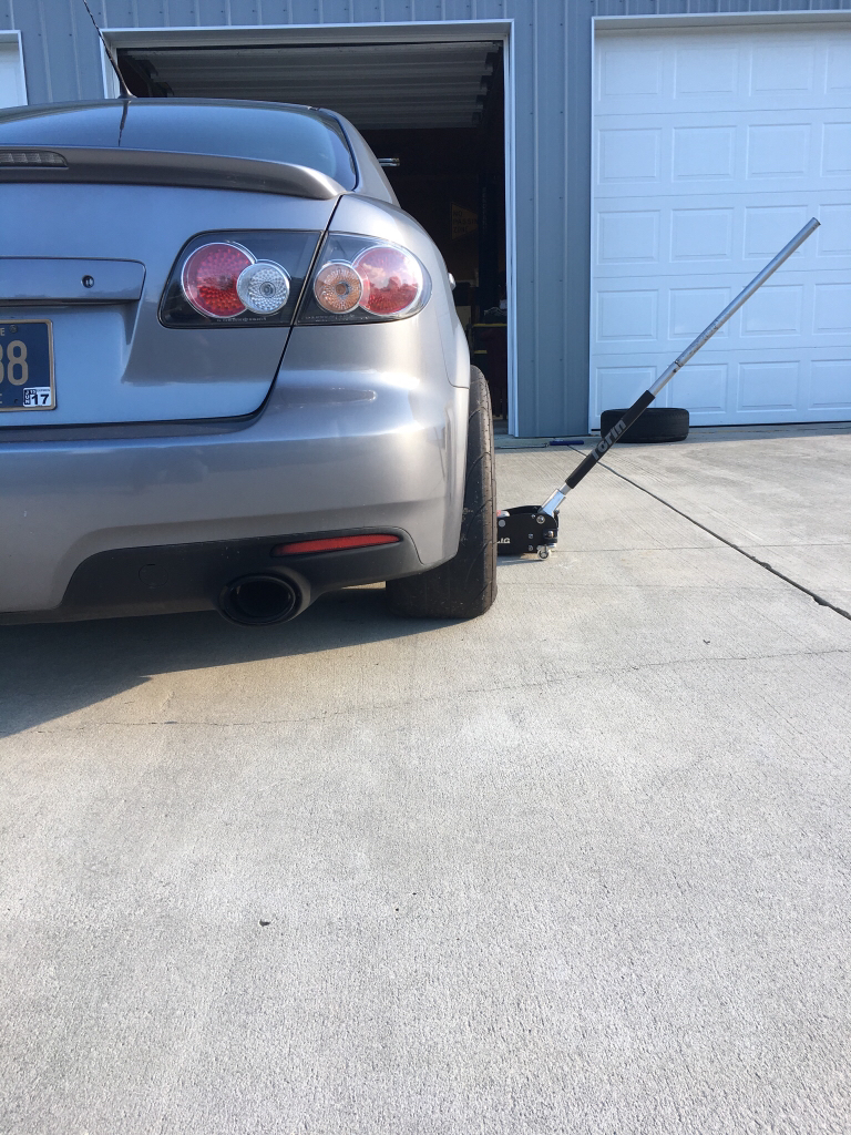

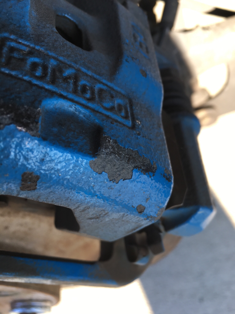

More pics
Where it nicks the caliper.
I know the poke is corny. It'll tuck nicely inside the car on the finished product. Thank you to @BigRed06; for getting me straight on what brakes to use in the rear to eliminate the contact issue all together.

Good to know that 15s will work. What brakes are you gonna use in the rear?
Also, I know fender flares are sorta corny but they would cover the poke.

03-05 Mazda6 rears. They should be considerably smaller. A set of good rotors and pads and I should be fine.
I really do want them to tuck. And I'm sure the 6.5"BS (51mm offset) will be nice and flush. I also decided to run 245/55/15 M&H radials. Equivalent to a 26x9. I've had good luck with M&H on my Chevelle (325/45/17) and my Nova (390/45/15). This makes it easier for me on the front tires as well. I can do a 17 in the front with Evo calipers and 245/45/17

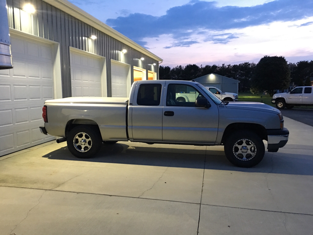

Little update. Finally sold the motor out of the speed! No more 4cyl in my life.

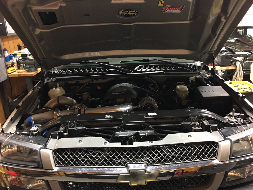

Also wrapped up a single turbo Silverado build for a friend of mine.
My first order of business is to finish my Nova before May 18th and have Nishan tune it so I can go to the Cruisin' in Ocean City. Then the Mazda will be focused on. But I did purchase a motor plate and heads for it so it's not on the back burner by any means. I also sold the Powerglide today and am going to cut to make this TH400 fit. Look for mockup pics soon.

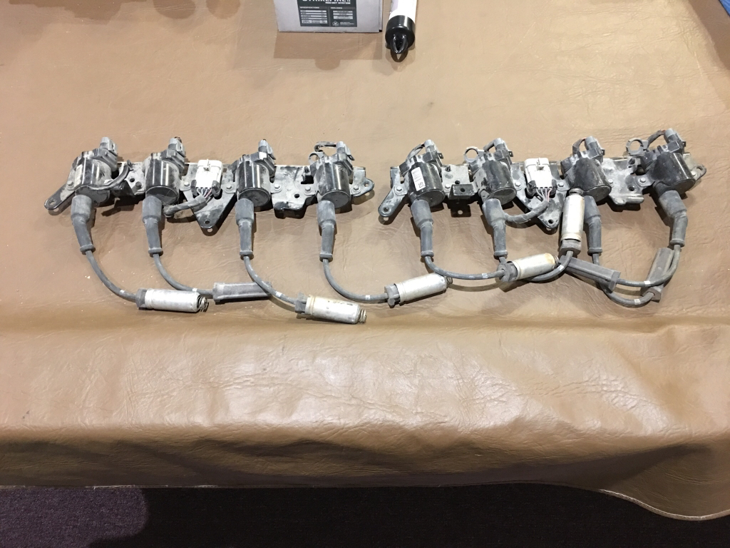

Picked up some coils for the 6 today

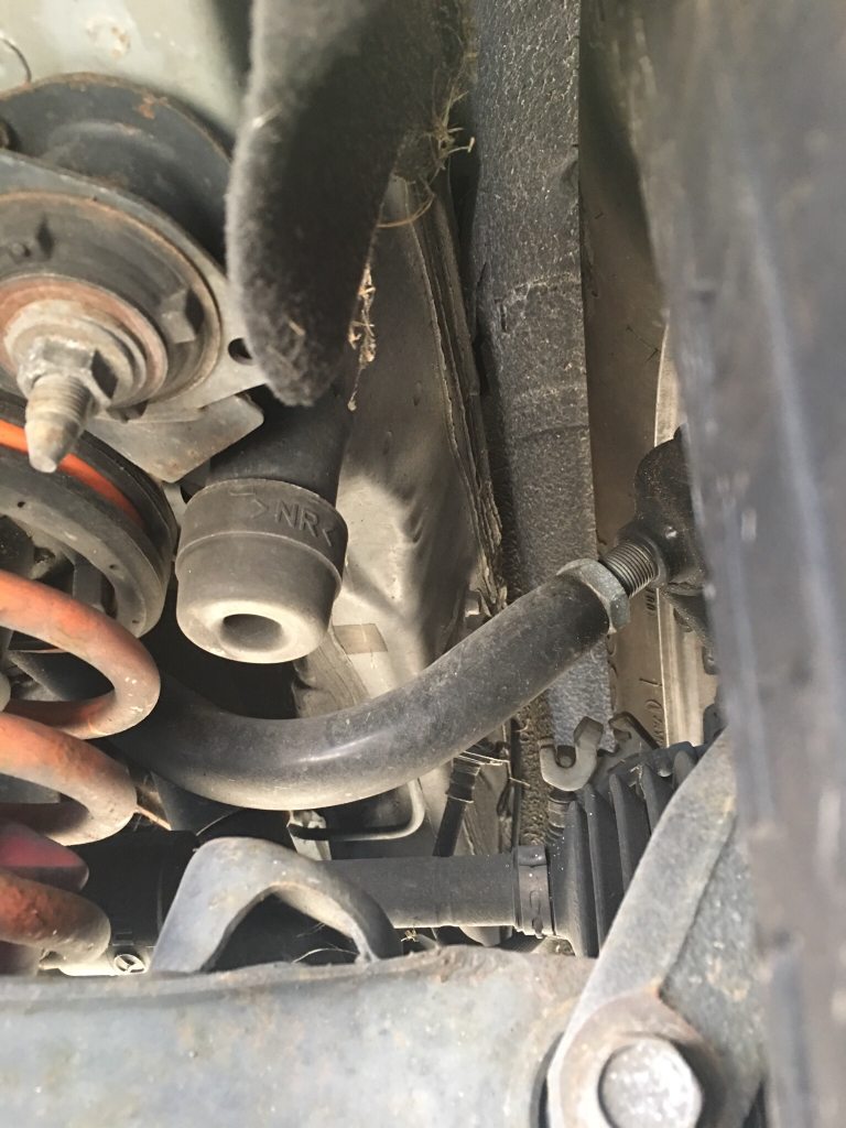

Hey guys. I’m in need of some measurements of the Rear Subframe mounts. My subframe is 4.5hours away and I haven’t been able to pick it up so I need some help.
Here’s what I’m looking for.
Distance left to right and front to back of the mounting holes in the subframe.
Thanks in Advance.
