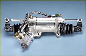

A few things that will be need to be addressed to get a drivable car:
Steering
Trans Tunnel
Rear Diff in stock sub frame
clearancing the front sub frame some
The setup is going to be a 4.8L truck LS (LR4) twin Borg S366's and a POWERGLIDE. yeah you read that right an auto. Cobra 8.8 IRS. Purpose of the car is to have the outward appearance of any other BT ms6.

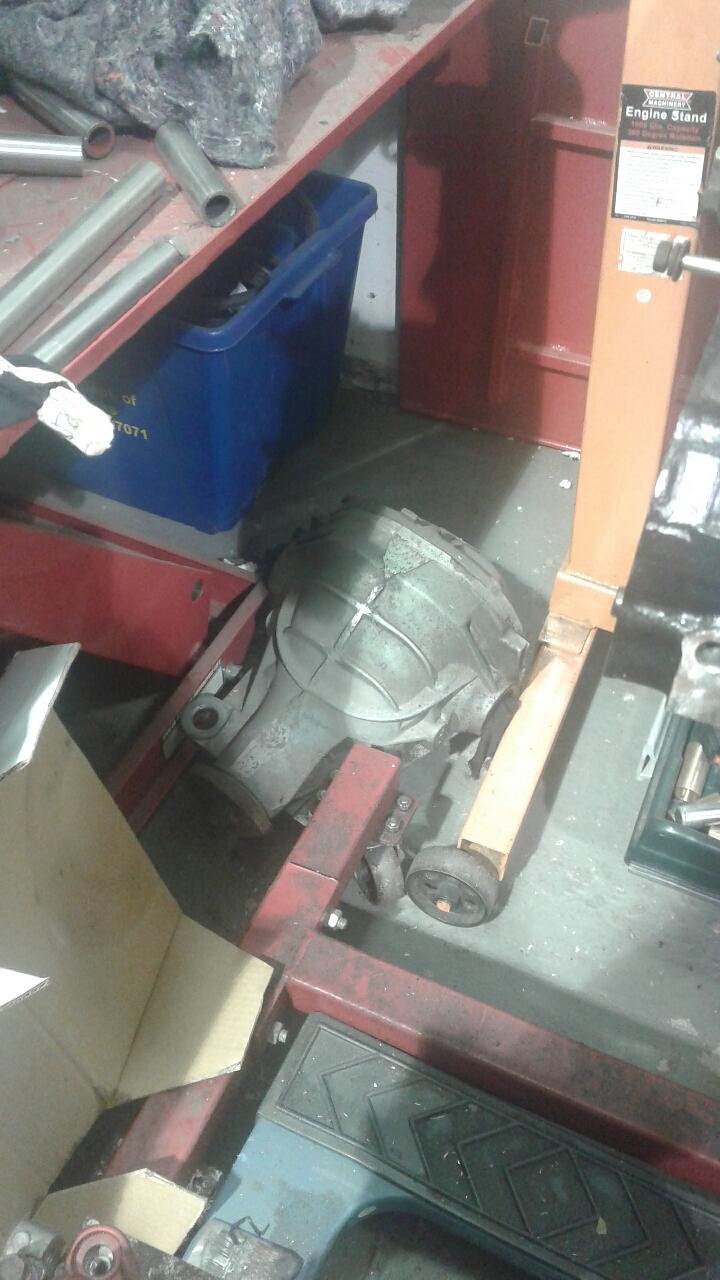

Anthony at 16W already had a cobra 8.8 in his shop so I need to send him a rear subframe so he can make me some billet mounts to fix the 8.8 in the stock subframe.
Once I acquire the 4.8L I'll get my motor plates coming so I can mount it in the chassis. Then I can figure out steering. I have an idea to use a rack common in dirt track measures about 16-18" in length. If I can get it offset enough I should be able to make a passenger side tierod with enough bend in it to clear the oilpan/flexplate/converter lock to lock.

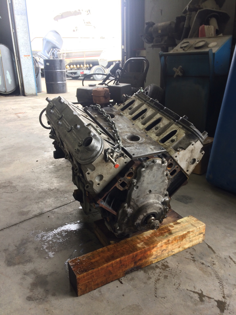

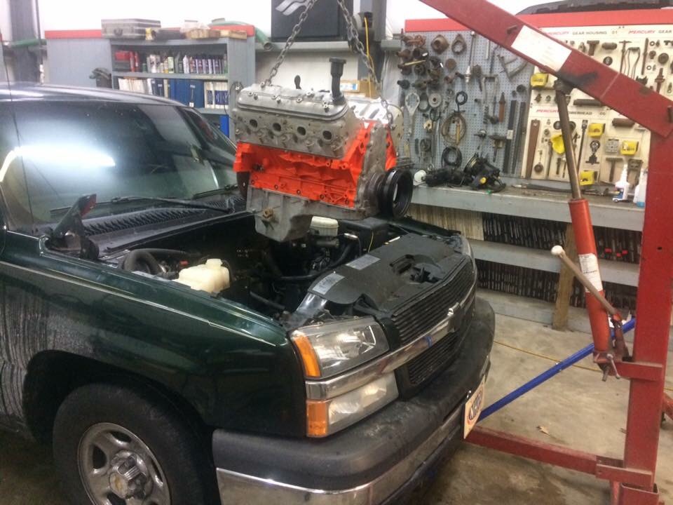

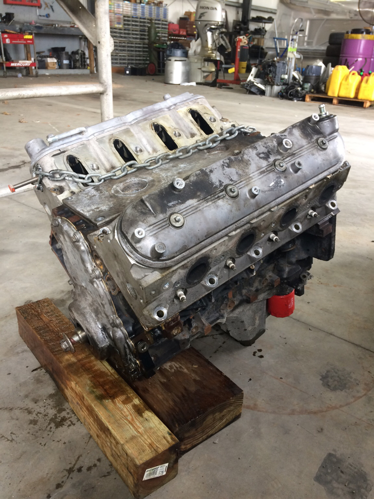

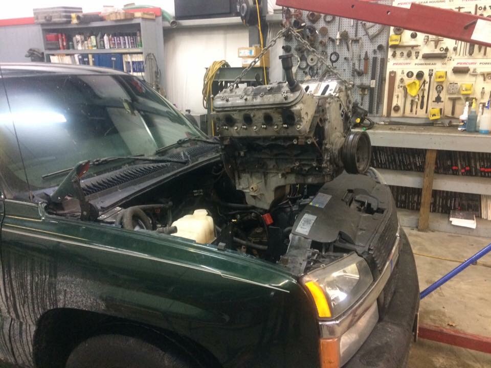

Keep in mind this is just mock up stuff until my friend pulls the LS from his truck. I had a bellhousing laying around to simulate the powerglide I can get my measurements so start cutting the firewall.

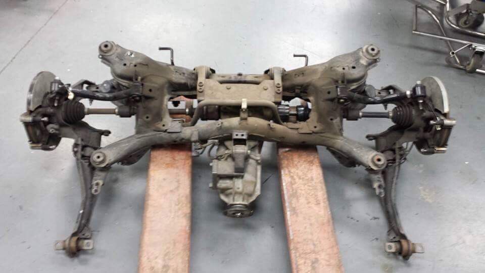

Had a collaboration on FB really quick with a few friends about CV axles. I called Mark Williams Ent. Friday and thy basically told me if I wasn't using Porsche 911 CV's I was wasting my time with a 1200hp IRS car. Then they proceeded to tell me a custom set of axles would cost me $5500. Decided to look elsewhere. Found a set of DSS cobra pro level axles that I think I can make work. I'll have to talk to DSS when they are open from their holiday leave.
http://www.driveshaftshop.com/domest...l-axle-hub-kit
Another friend mentioned someone else that I'll talk to at some point this week.
Just so everyone knows this project will move pretty quickly then slow down for a while. I need to finish my Nova and test with that for the good weather that's coming. But I rest assured that the LS and glide will be put in before I store the car and continue on the Nova.
Got in contact with G force sooner than I thought. They are gonna make something work for me. I'll probably have to send in my hubs to get them resplined to 31.
https://gforce1320.com/product/99-04...1-spline-diff/

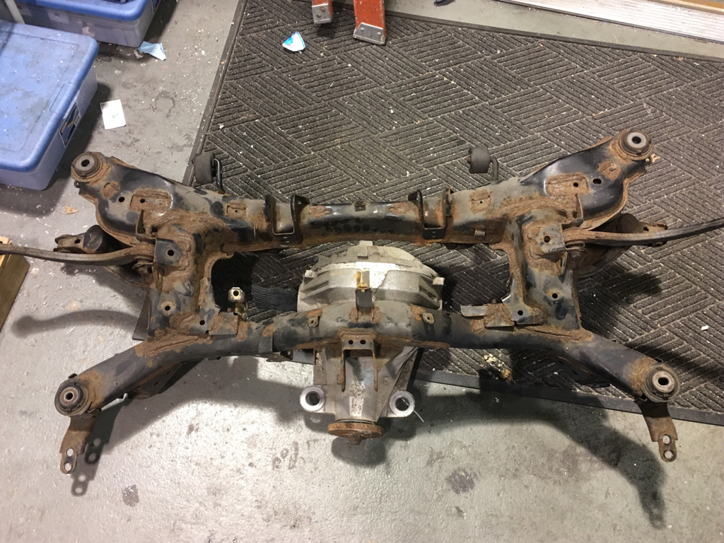

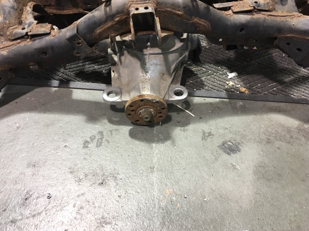

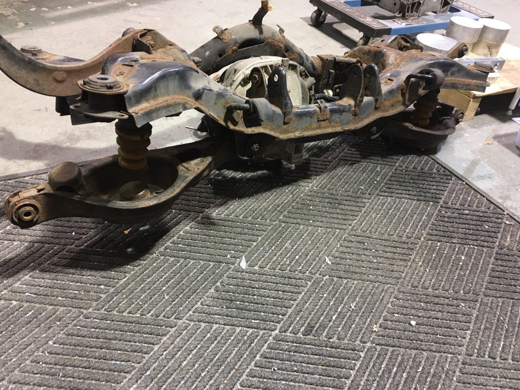

Ran up to Lancaster today to pick up a subframe and shot over to 16W so Anthony can work his magic on some mounts and a cover. He's got his work cut out for him. What seems to be a major weakness in the Cobra IRS is the rear cover mounting point, Anthony is gonna address that and maybe we can get a mounting solution figured out for others that want to do the swap.
I just plopped the subframe on the rear to get an idea of the size difference.
Now I've talked to a few interested in the swap and those who don't exactly have the same power goals as mine. I will try to see if it's a viable option to maybe utilize the stock rear by eliminating the viscous coupler in the snout. It's a consideration, not a promise. The factory rear is small and I don't know what kinda of torque it can take as a single unit.
[IMG][/IMG]
[IMG][/IMG]
[IMG][/IMG]
[IMG][/IMG]
I was planning on picking up a Cobra IRS subframe and seeing what it would take to retrofit it. Theres an entire rear end on eBay for $1300 but I can't justify snagging it with all the house mods I have taking priority.
I don't have nearly your power goals with my swap (I'd be happy with 450rwhp in my gutted shell) so I was also gonna see what it would take to ghettofab an 8.8 Explorer LSD into the MS6 subframe and look into getting custom axles made, but some breathing room would be nice.
I was also really debating just trying out the stock unit, but had the same reservations with what it could hold not being supplemented with AWD.
Def want to see what your guy can come up with.
Yeah I new for even my SBE(stock bottom end) power goals the factory diff wouldn't hold up. Especially on a trans brake. I figured if a speed 6 was making 1000wtq the most the rear would see is 500wtq and that's your average cammed V8 lol so who knows what borrowed time it would be on. I thought about buying the whole cobra subframe just to see if it would come remotely close to fitting but $1300 could be spent else where at the moment. If I happen to come across one closer to me I'll measure it up.

Aye!!! My motor finally got pulled from the truck.
And his new one got put in
