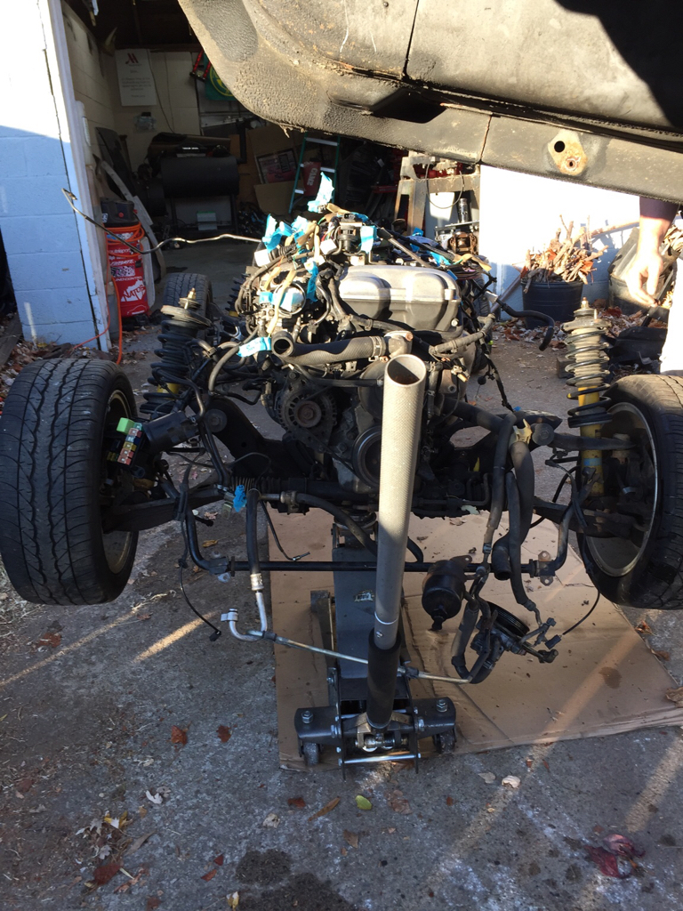

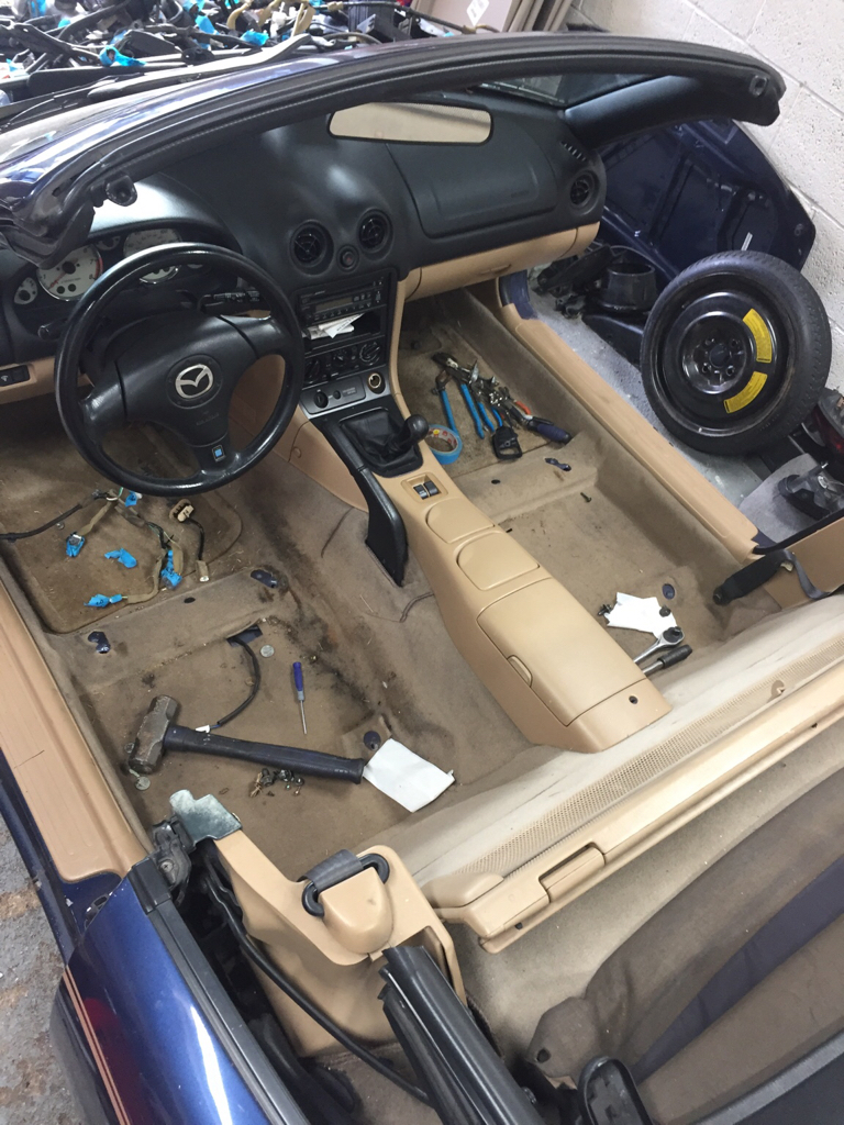

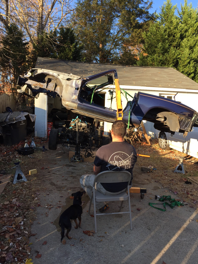

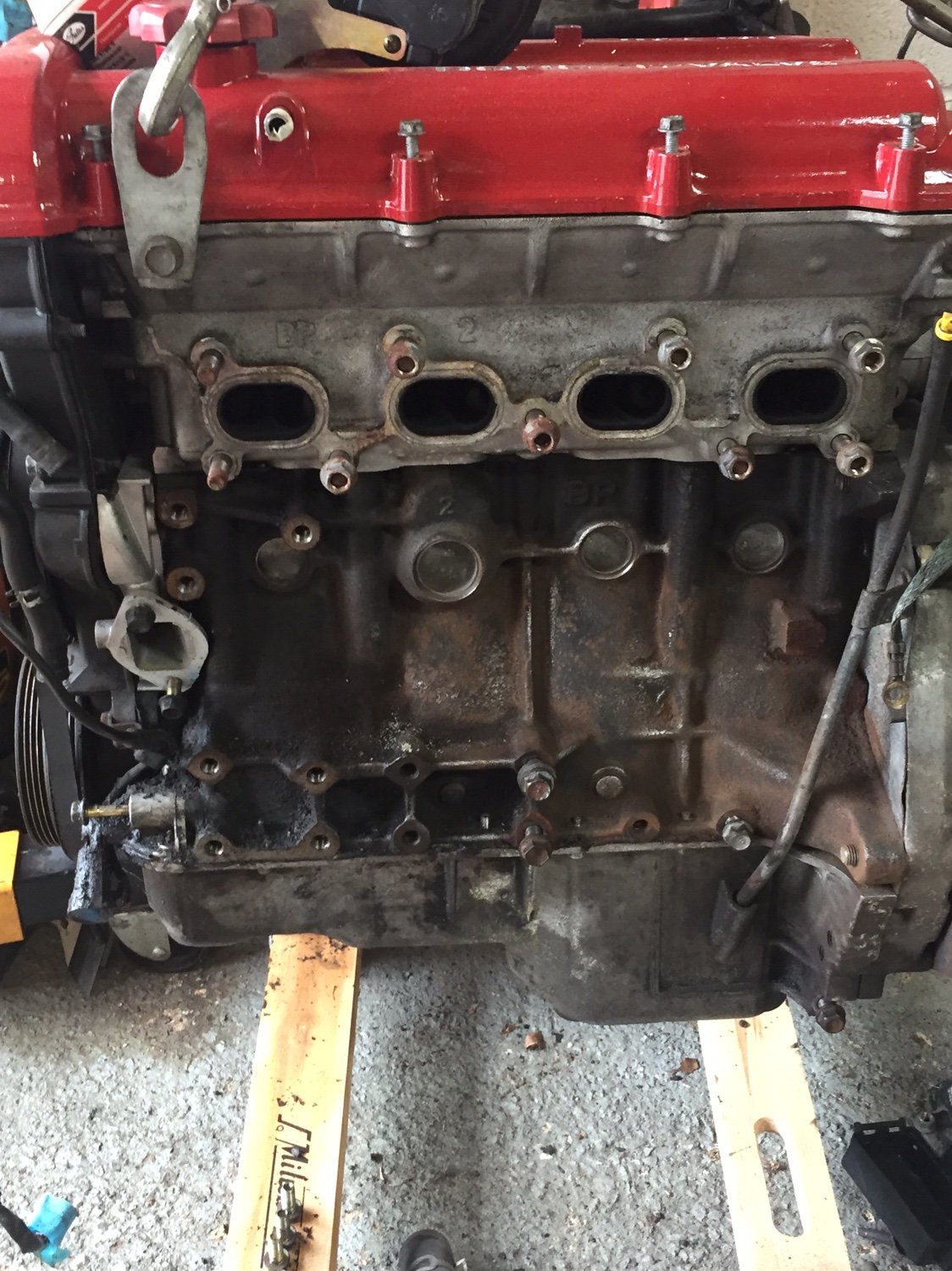

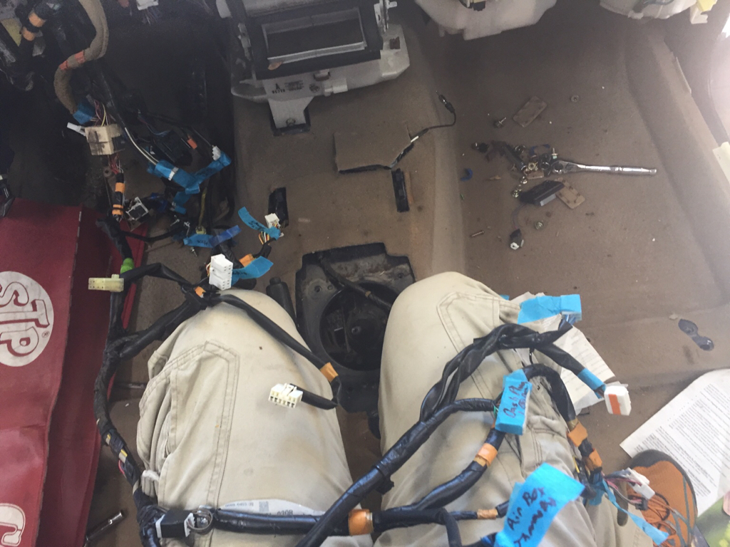

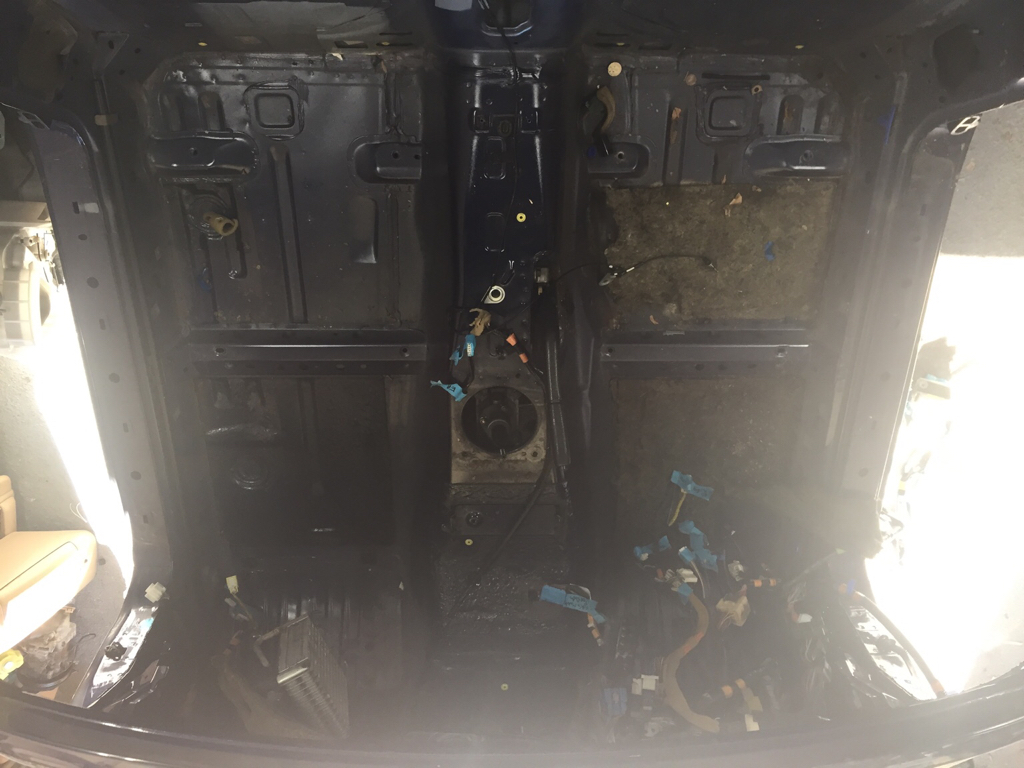

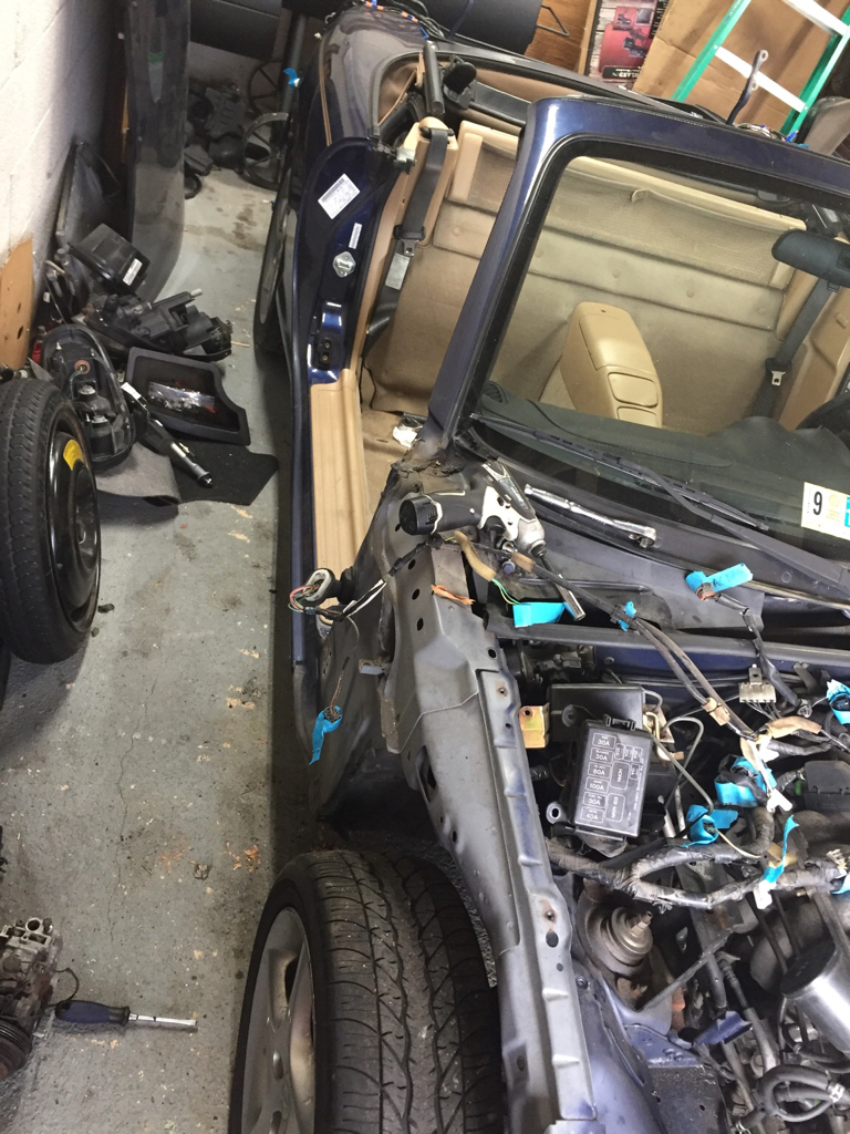

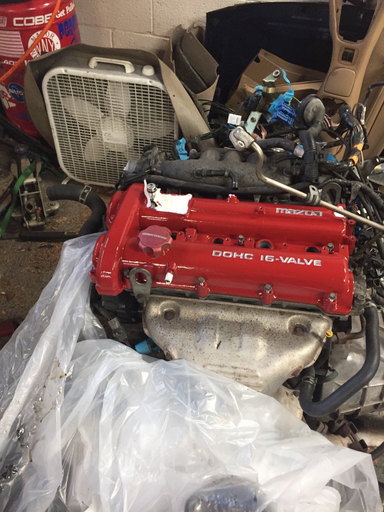

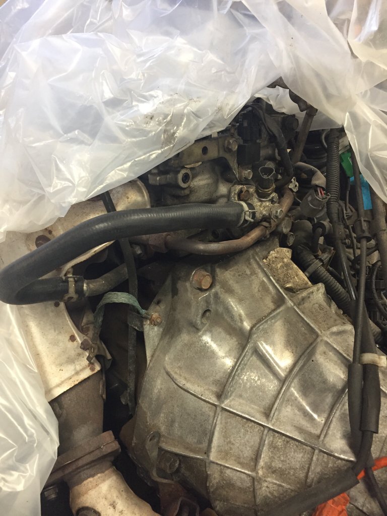

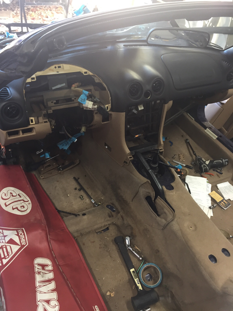

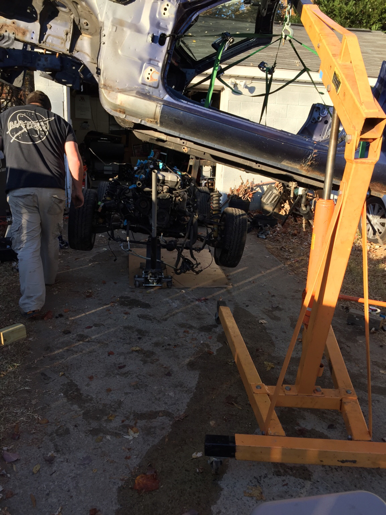

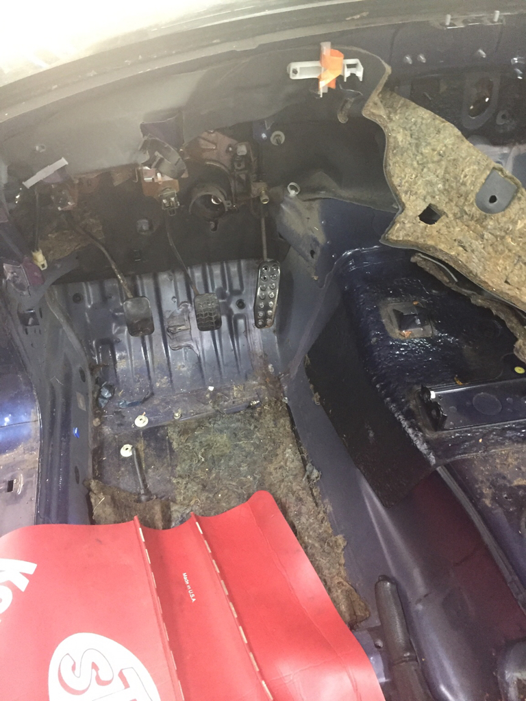

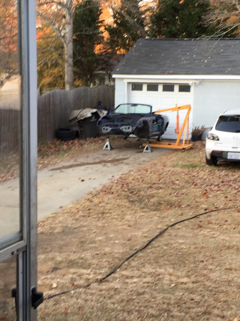

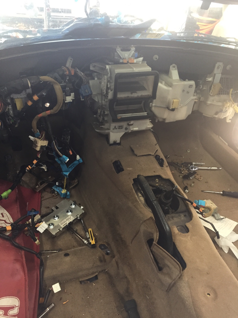

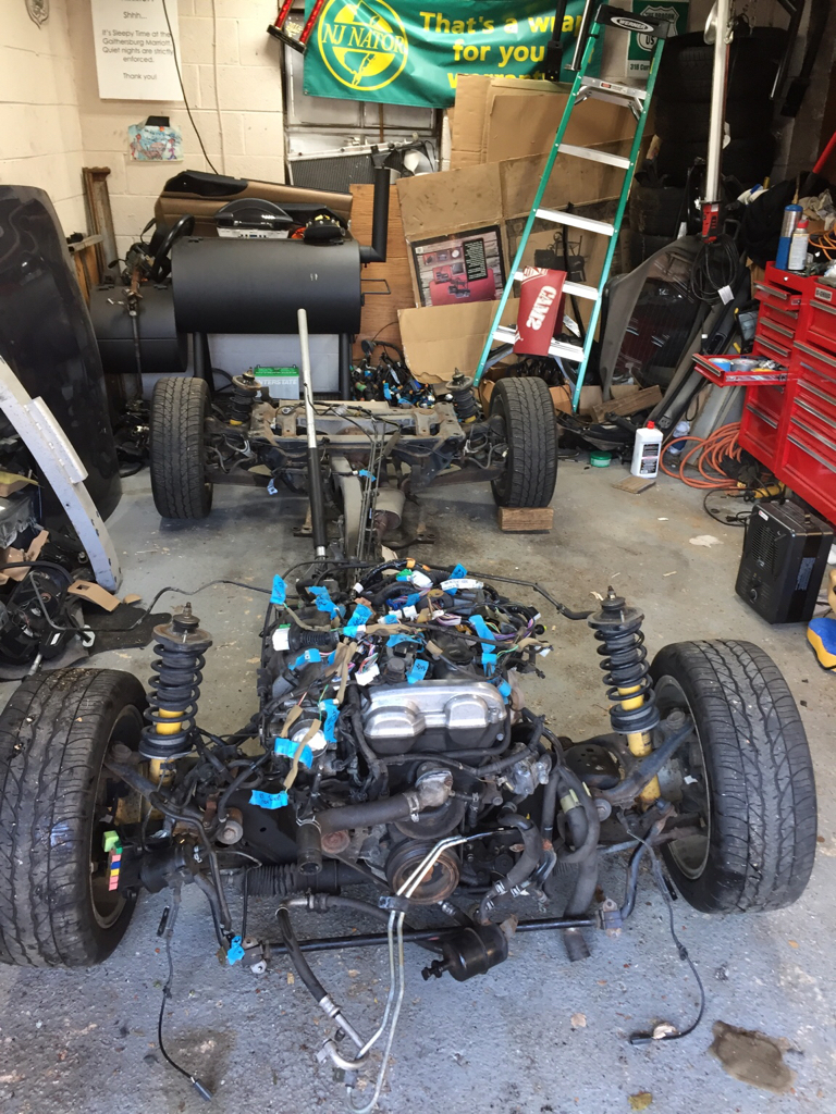

Well... I need a new hobby. I have had the speed 7 years + and I ready to try something different. I have always wanted to build a car from the ground up, but not have to reinvent the wheel. I also am always in search of a more "pure" driving experience, so I decided a while back I was gonna try this. I started sourcing a donor back in august and grabbed up a wrecked 2001 with 102k. 6 speed with the 4.30 torsen lsd. It will be a slow process as I have kids who break shit faster than I can fix them and will be selling parts as I go, but I will update pictures as I get through the process.
Phase I: Disassemble, Scrap unused, Sell off usable parts.
Phase II: Clean, service, paint, prep roller skate.
Phase III: Install Exocet Chassis, Make Road legal.
Pre work... I had to put the car back together enough to drive it and make sure everything worked as needed. I put about 400 miles on the miata before parking it for disassembly

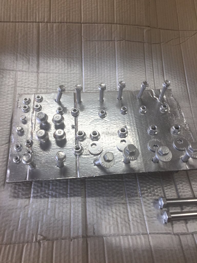

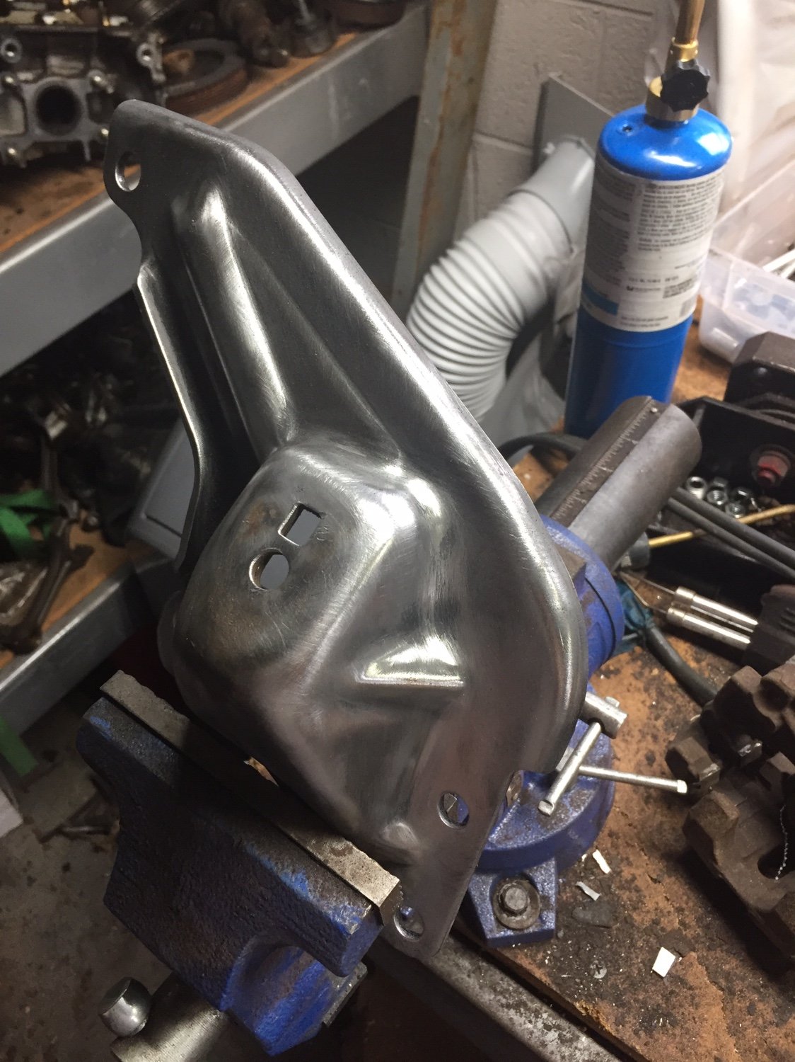

Sweet project!
What paint are you using for suspensions parts?
Have you considered a tumbler and anodizing for bolts? I was thinking about cleaning up my suspension and bolts.
 Old 02-26-2017, 07:18 PM   #18
mzr0818's Avatar
Location: Winston-Salem, NC
Posts: 4,112
Rep Power: 3104
Thanks: 7,046
Groans: 221
Magnetic self leveling chassis paint on the sub frames

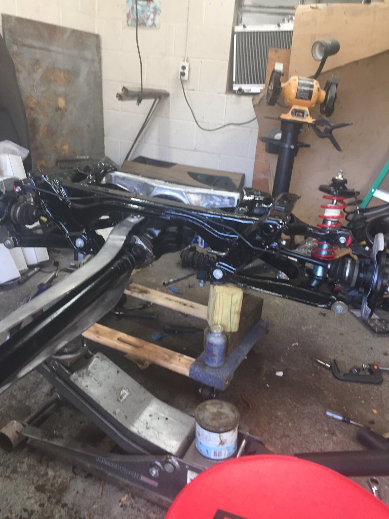

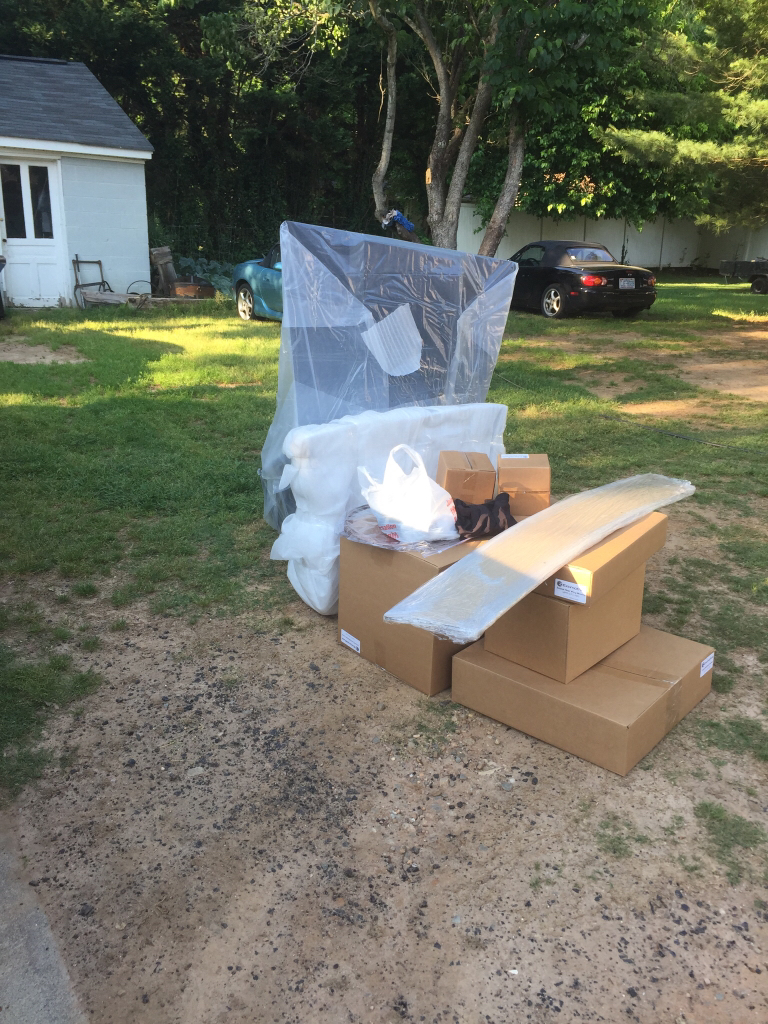

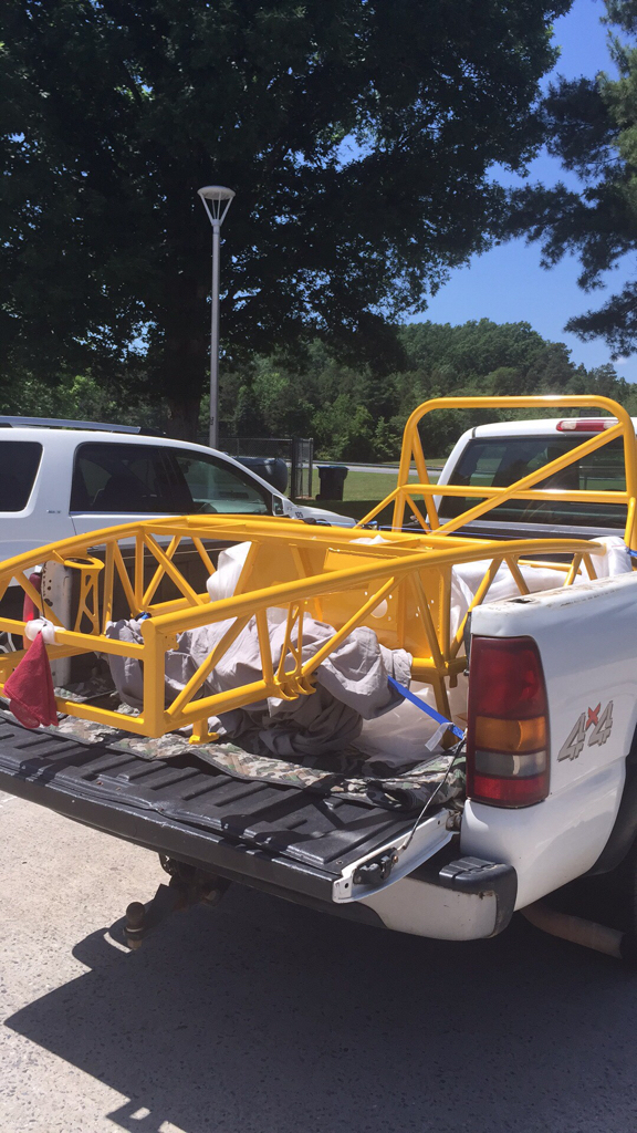

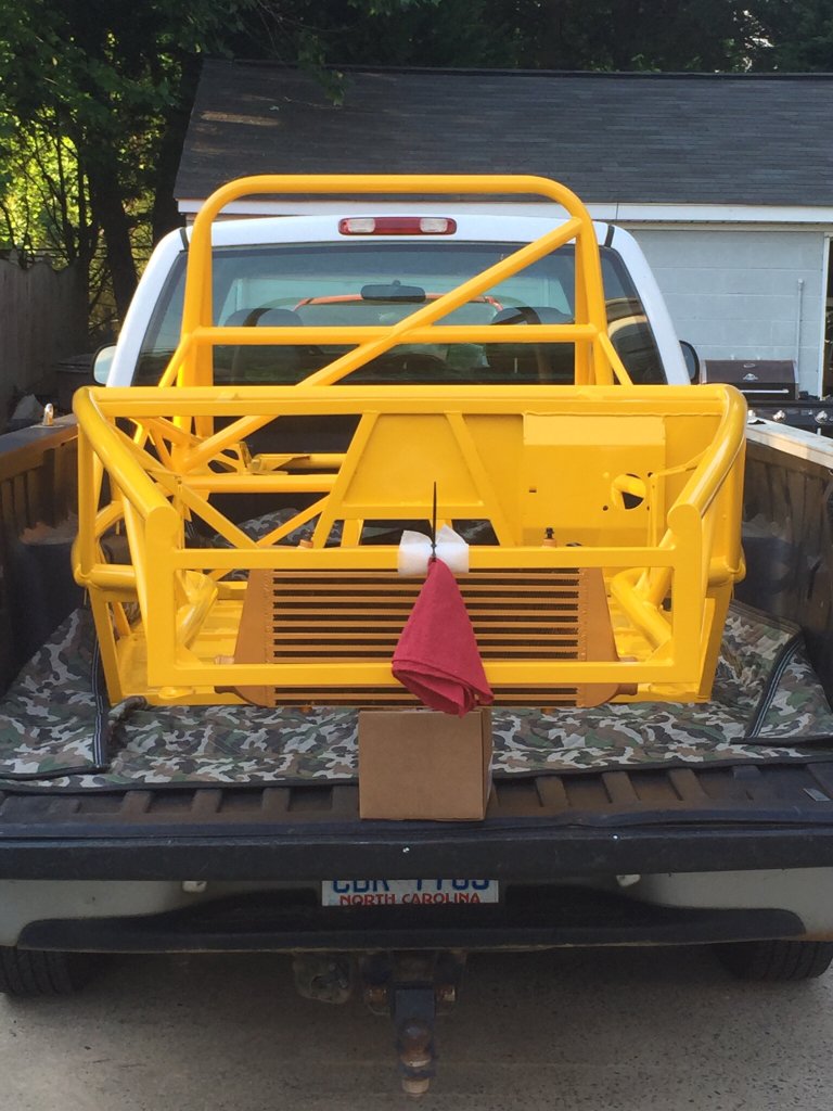

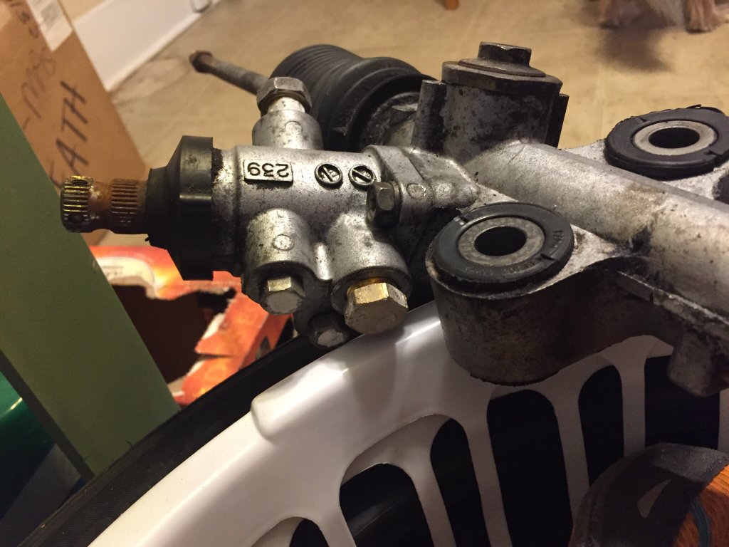

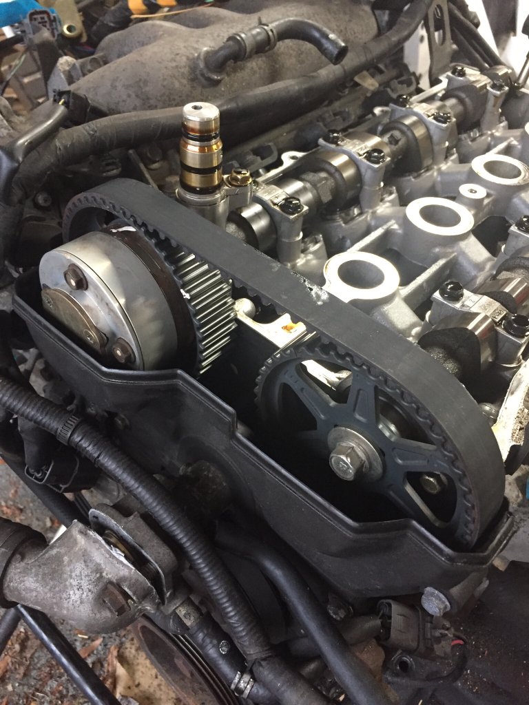

Ok I picked up the chassis so it's time for a photo update I guess.

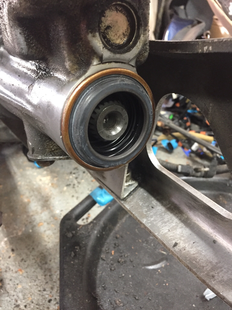

Depowering the steering rack
Before
After

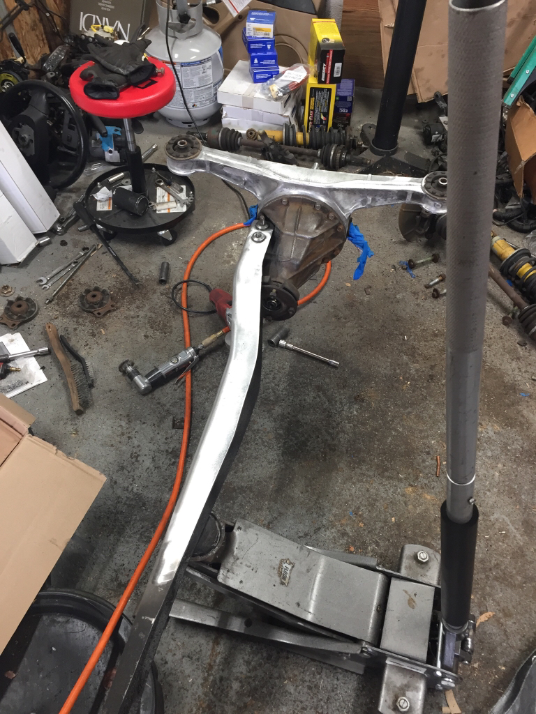

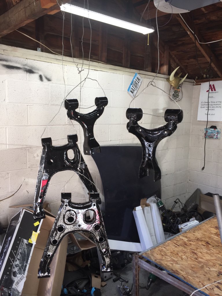

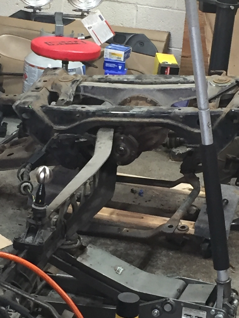

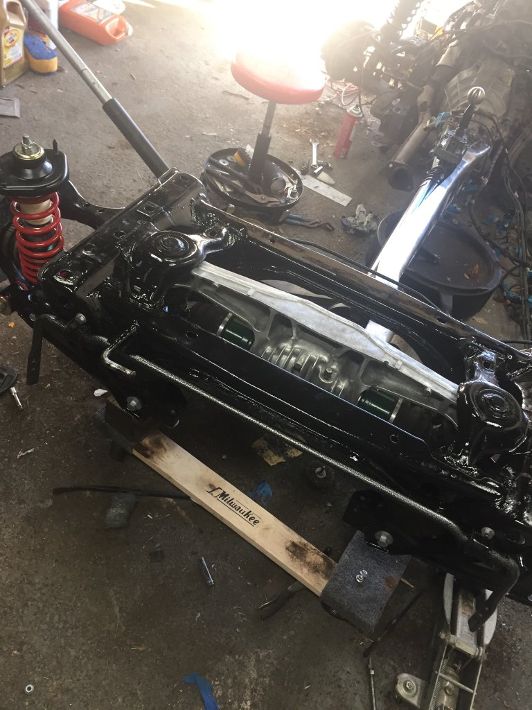

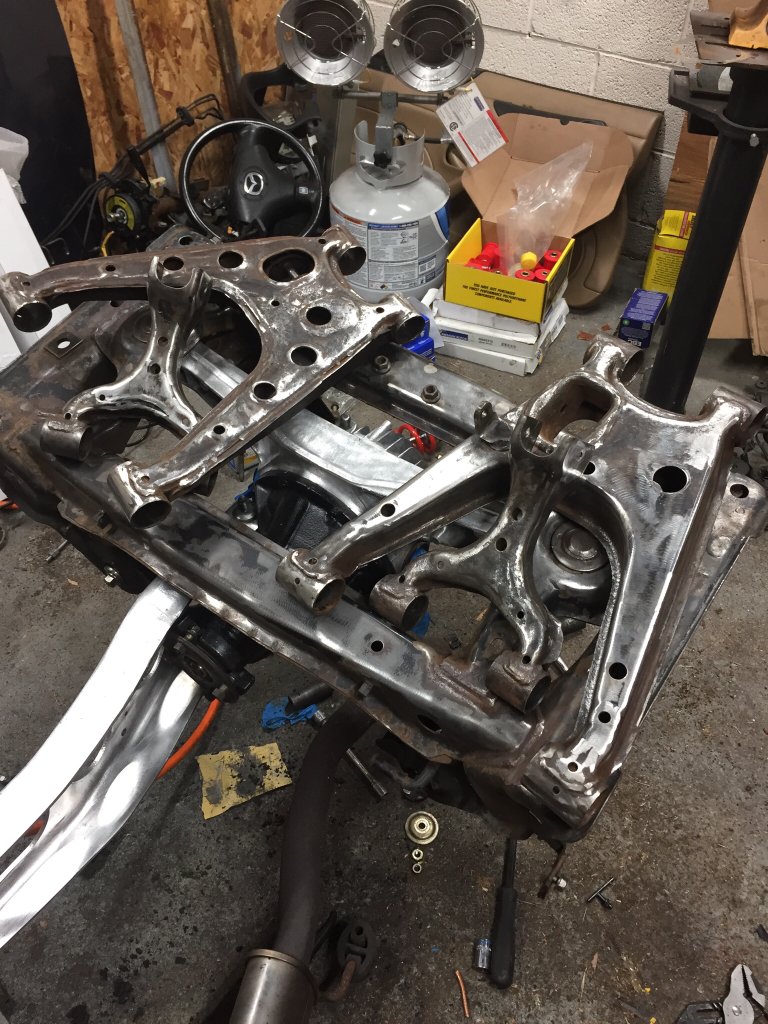

I was slowed over the summer due to life things, but have picked back up and will post all the updated pictures soon.

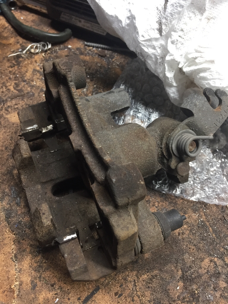

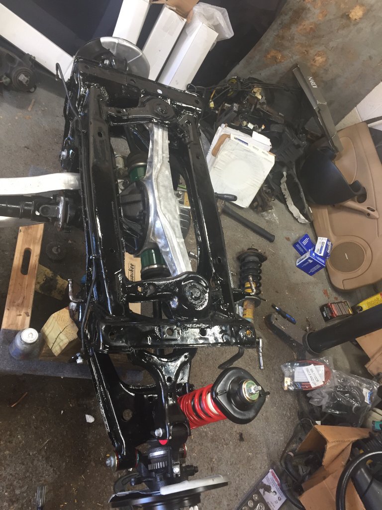

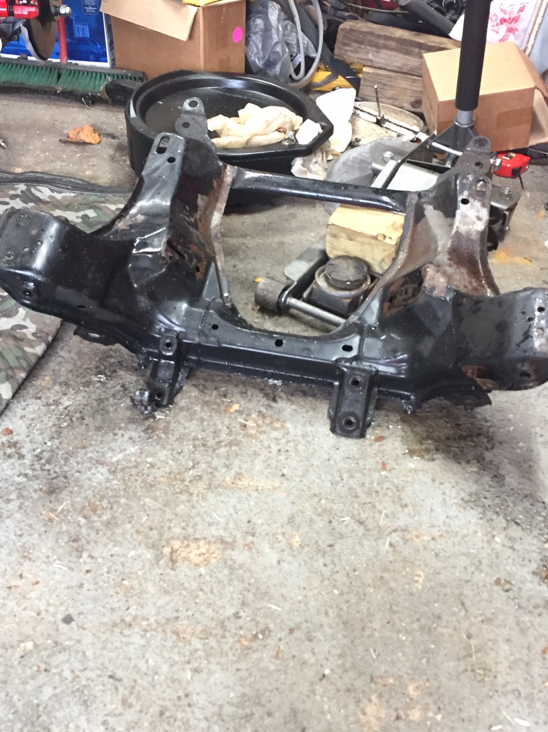

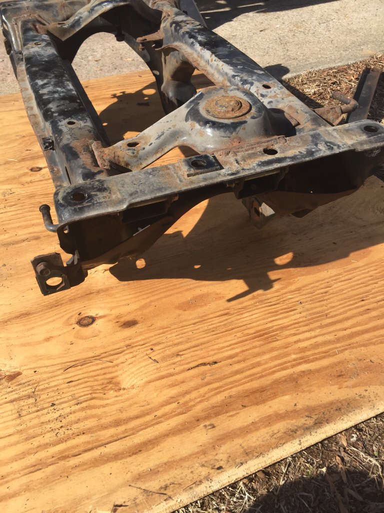

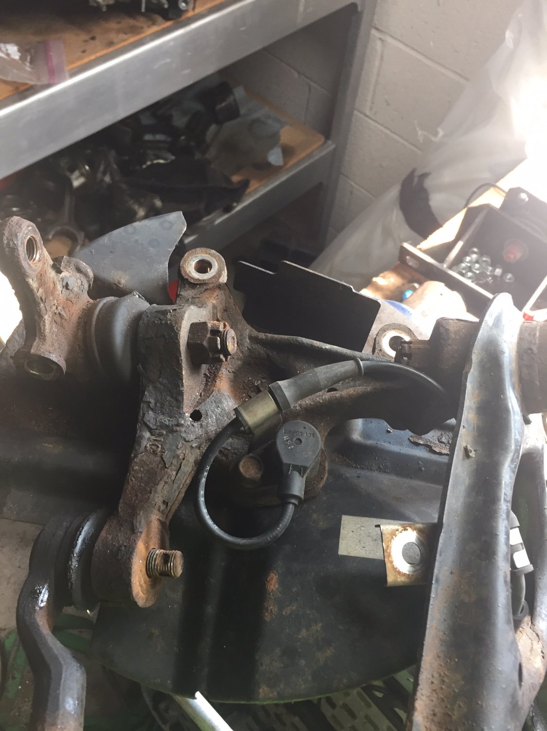

So the rear sub-frame is completely restored. New bushings, SS brakelines, new calipers, rotors, sanded, primed, and painted.
The power steering rack has been de-powered, new inner TRE, New outer TRE, cleaned and sealed
Front suspension is off, stripped and ready to be cleaned.
I have new UCA with ball joints coming in a couple days and new 75D motor mounts.
This week I will pop off the Front sub-frame. Sand and clean all the frame and spindles and get them ready to paint.
Next week I will paint everything and touch up anything needed.
By the end of the month I will reinstall everything and check the entire roller skate again; ie re-torque all the things.
At that point all that is left for restore is basic engine maint. Timing belt, VC, belts, fluids, exhaust gaskets and Water pump.
Then the chassis gets mated and the fun starts.
