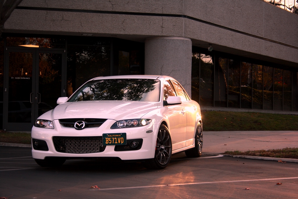

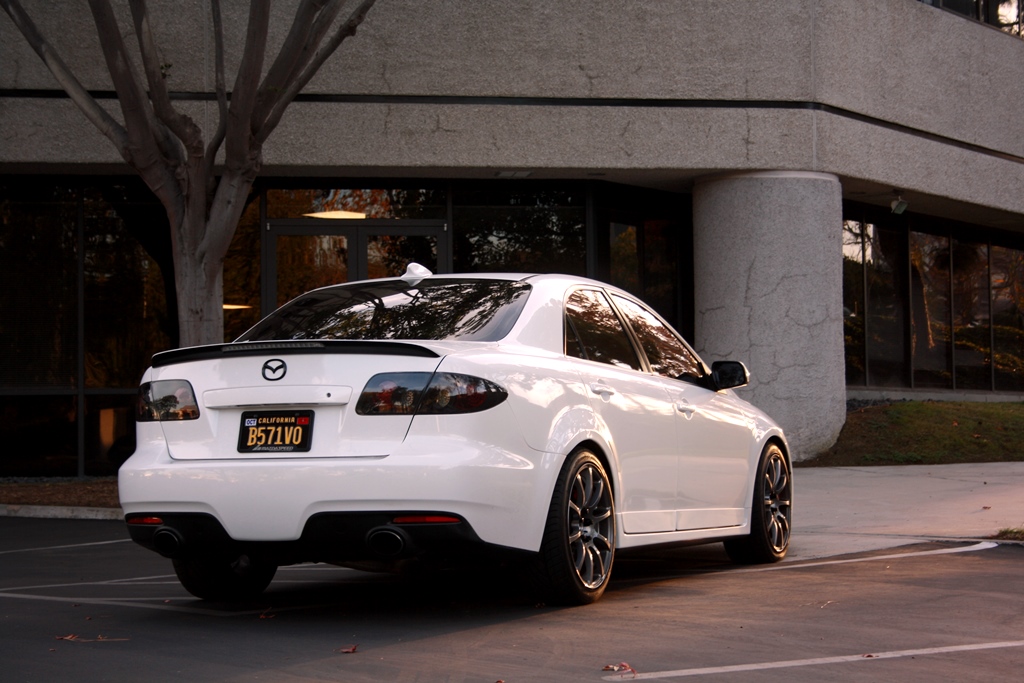

Got a few pics showing off the new limited edition CA vintage black/yellow plates. Kind of looks cool I think.

We get it, your car is prettier than ours...
Diggin the plates

Look very clean.

Beautiful car man.

The black rear plate looks freaking TITS. The front one looks green?

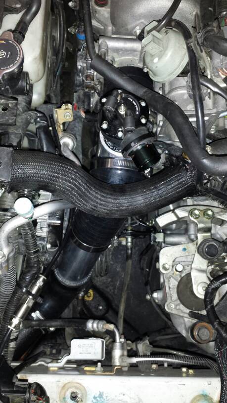

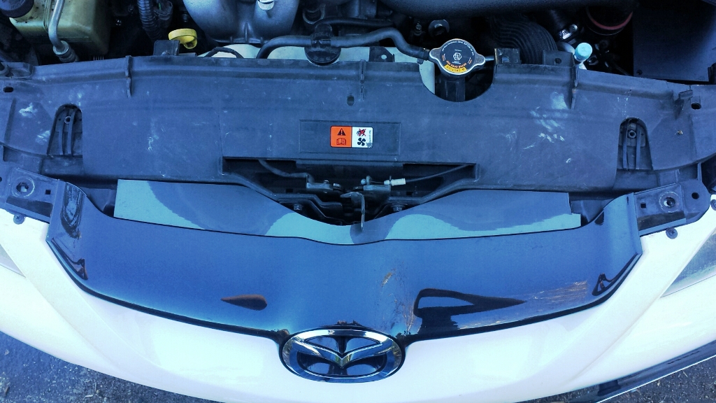

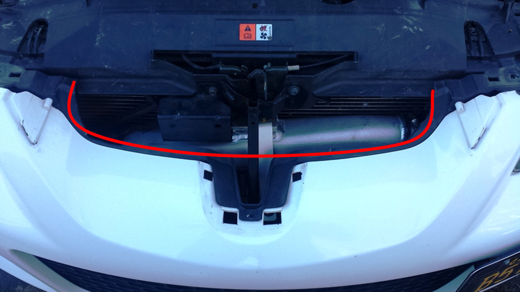

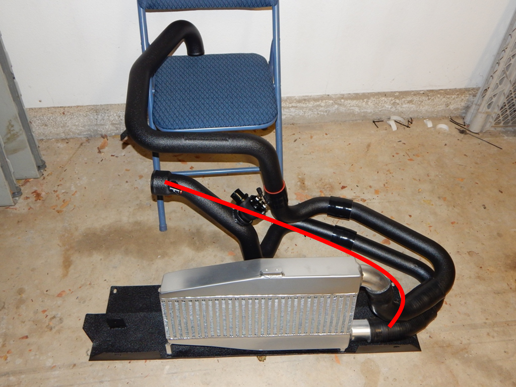

After putting the CP-E FMIC on and getting pretty shitty results from a BAT improvement perspective, I updated the intercooler to a real intercooler, a treadstone TRV1859. I had a welder weld the same mounting locations on the treadstone as were on the CP-E FMIC and it plopped right on. Performance increased significantly as a result, I think I saw a 20whp/20wtq improvement on account of lower BATs and being able to push timing up.
I am now moving onto my next optimization for the CP-E kit. I hate the routing of the CP-E cold side. It's ridiculous. It's long, and it basically contacts the hot side where the bpv is. You can see the cold side here.

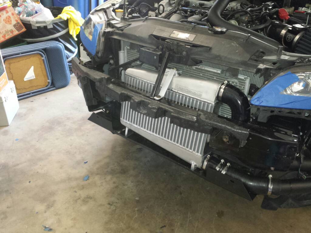

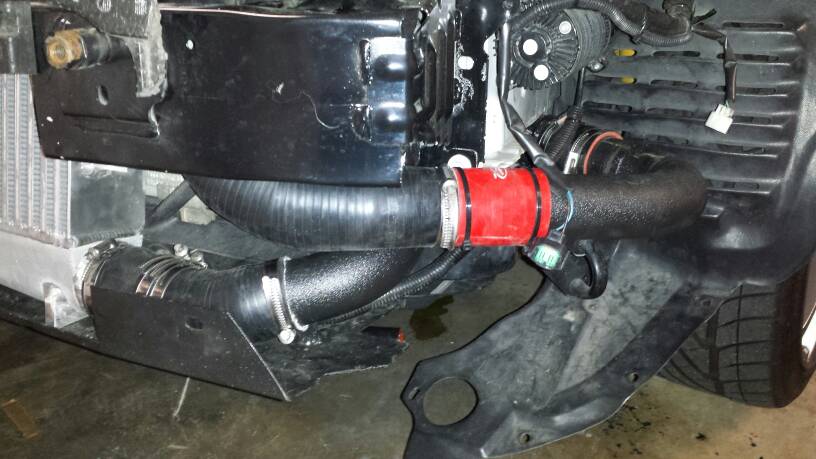

The CX Racing and similar FMIC kits have a much smarter routing idea on the cold side. Instead of mirroring the hot side and coming around and up, they just go between the frame and radiator support for almost a straight shot into the throttle body, like this.
Examples from @TiGraySpeed6;
I am also going to open up the cold side a little per what I have read on a few sites (and also what Corksport did on their latest kit). Instead of the 2.25" pipe, I am going to step up to 2.5" and then 3" right before throttle body. Also, I am going to add the DM throttle body spacer and put 2 x D03s behind the throttle body spraying into the plenum instead of a big D07 in front of the throttle body spraying into the 2.25" pipe.
So, that's the next project.

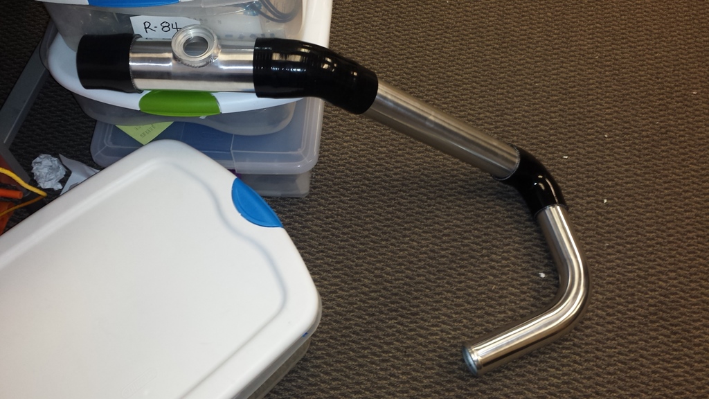

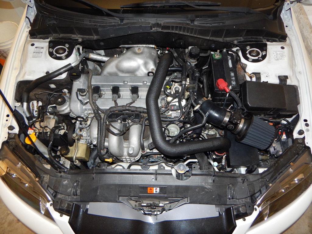

Here's my parts list; you can see how I use the pipe/couplers to step up to 3" before throttle body.
(in order from cold site outlet to throttle body)
CX Racing 2.25" 75 Degree Mandrel Bent Polished Aluminum Pipe, 2.0mm Thick Tube, 18" Length
Silicone Intakes Silicone Reducer, 90° bend - 2.5" to 2.25" - Black
CX Racing 2.5" Straight Aluminum Pipe, Mandrel Bent Polished, 2.0mm Thick Tube, 18" Length
Silicone Intakes Silicone Reducer, 45° bend - 3.0" to 2.5" - Black
CX Racing 3" O.D. BOV FLANGE PIPE, Polished Aluminum, 9" long, for HKS SSQV/SQV Blow Off Valves
Silicone Intakes Silicone Reducer, 3.0" to 2.75" - Black

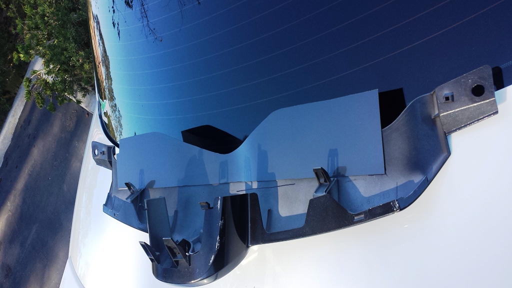

This is a little mod I did to get more air to radiator since there isn't a top mount anymore. First, hack the air guide behind the grille as shown. I did this with the bumper OFF the car and with the air guide OFF the bumper. I wouldn't do this on the car I don't think.
I mocked up an air diverter from cardboard (my favorite prototyping tool), and then cut out from 1/8" plastic using the cardboard template. I double sided taped it to the grille with that really good 3m automotive tape.
reattach grille with diverter and voila. I know it's doing some good, because when the fans are on, I can put my hand in front of the grille there and fill the air sucking past my hand.

But seriously, that new core looks massive. Sounds like the new core performed hand over fist better (not surprised given the size of that thing). Makes my cobb core look puny. I need more rice. I will not be outdone!

New coldside is in (not cut to size yet). You can see size progression from 2.25" to 2.5" to 3" at BPV tube. Silicone intakes size change couplers are great, and the CX racing pipe is nice too. You can see how much cleaner the routing is this way compared to the CP-E cold side in the pic above.
Damond throttle adapter and Devil's own nozzle/holders didn't make it in tho, so I guess next weekend for this project.

Cold side routing ended up being a PITA. Got it done and outcome is good but it is tight everywhere. Bpv hose is right next to coolant hose, coolant hose is close to 3" housing, the cold side barely squeezes by the hot side and radiator support. Whew...
So, next is the Damond wmi nozzle plate.
I also pulled throttle body and was surprised to find the IM it coated in a light mixture of oil and water/meth mixture. I'm running occ that is working well and not burning a lick of oil, so it has to be egr. I put the JBR EGR block kit on.

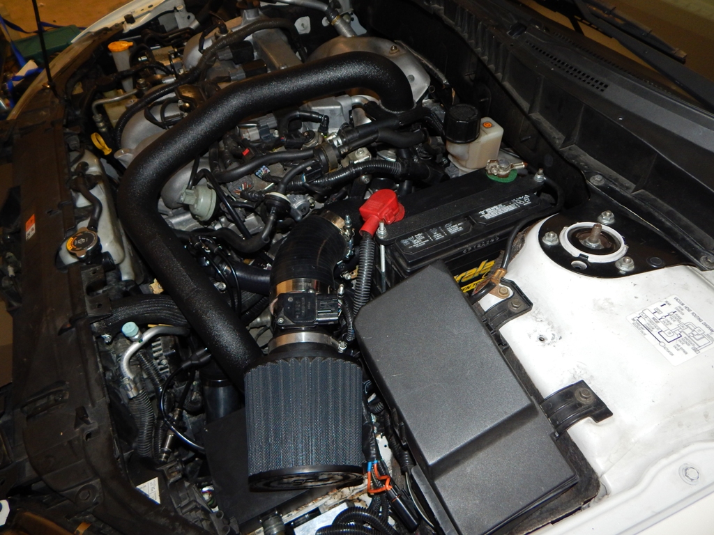

Here's an updated engine bay. Pretty boring for 400+bhp. Not very exciting for everything that's there.

Looks fantastic.

You need turbo Steve's valve cover and fuel pump covers. Considered?

Ya, when he's in production I think I will actually.
