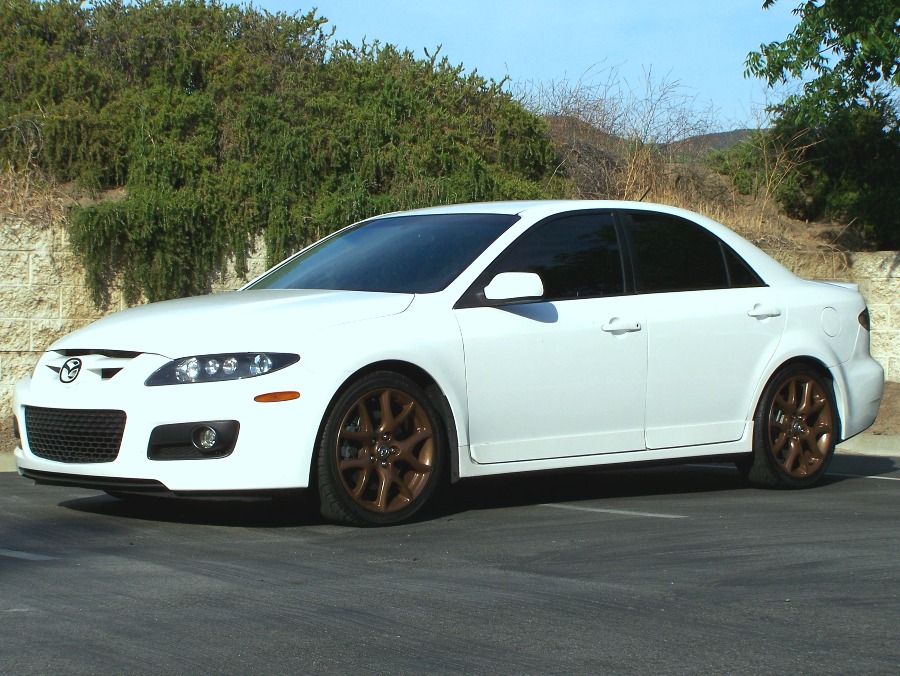

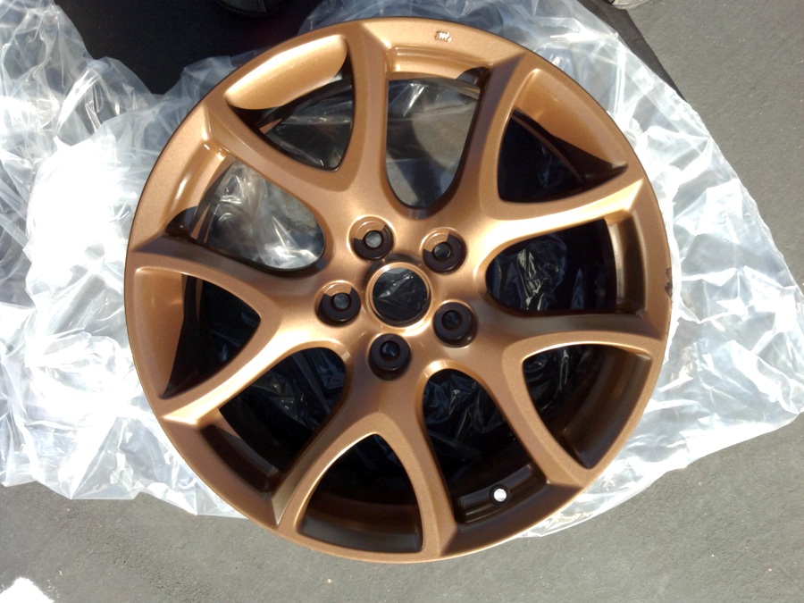

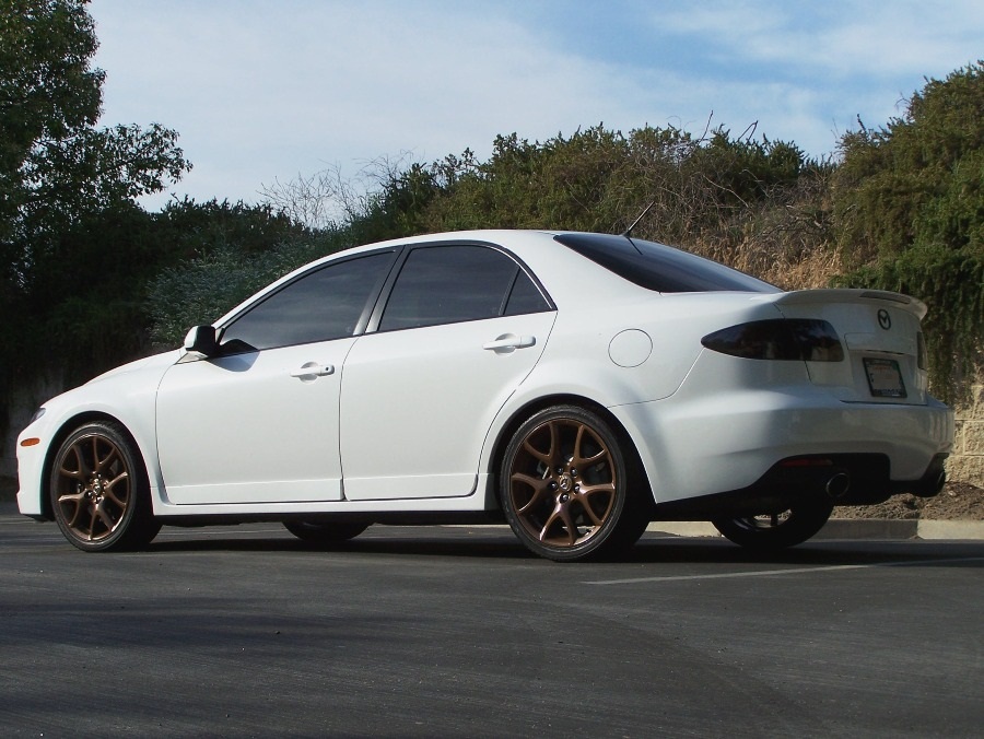

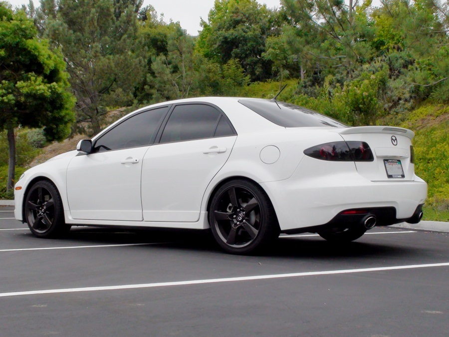

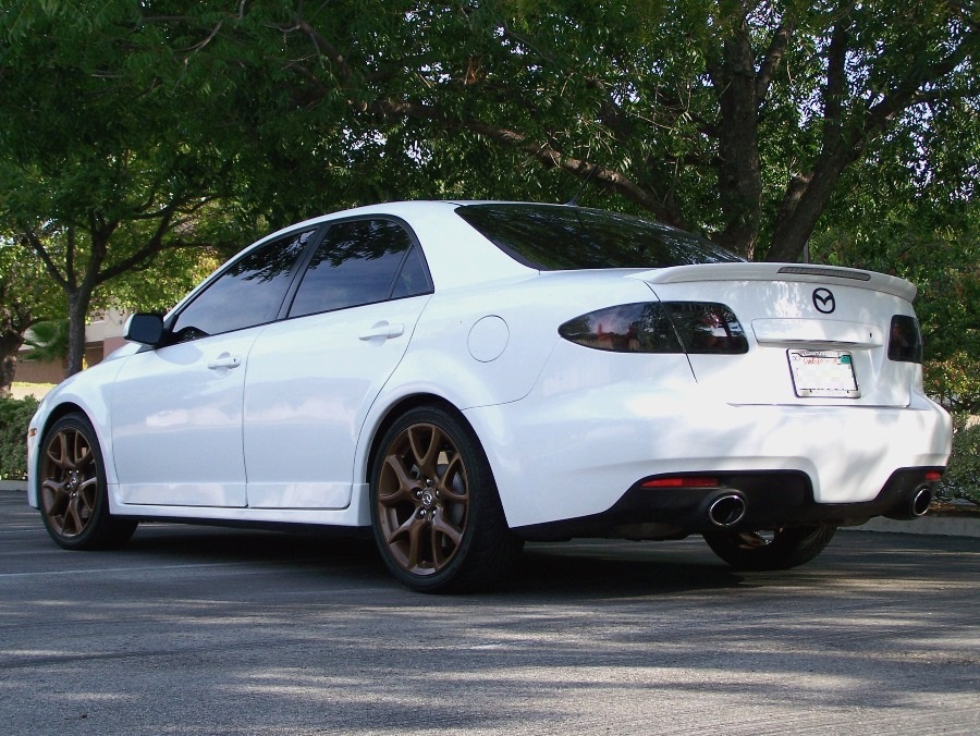

Couple pics with the RX8s I got with the car. They are powdercoated like a very, very dark bronze. I just slapped these on until my P-Coated wheels arrive. I called the shop, it sounds like they won't be done until Monday. These will be for sale soon if someone is interested. The dark looks good, but these are too dark for me. I am out of my black wheel phase. plus I ran RX8s for YEARS so I am kind of over them.
On another note, you can see that I painted my emblems.

I like em- it's a good look on the WWP
Thanks. The color isn't really coming through the camera that well. They have a lot more metallic look in person that is lost on the camera shots.
I warmed up to the color; I wasn't immediately excited. I knew black would have been safer but these are looking better to me as I stare at them from my office more.

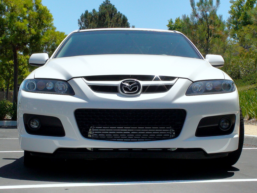

I got the car back together. I will say that this CX Racing FMIC is not just a bolt on. It takes quite a bit of work to get fitted. Just don't do what I did and hit the radiator when you are cutting the shroud on the driver side. Also, the hood's ducting for the stock TMIC cannot stay on; it won't clear the hot side tubing down to the front of the car. The tubing barely clears the headlight; I actually had to massage everything for a good while (when I say massage I mean dremel) to get the RH headlight to fit well again. You have to pretty much decimate the lower bumper air diverter panel.
I broke the damn front bumper guide on the RH side- the little white plastic piece.
I didn't see any loss of boost, I am still around 21psi at wot, so I am not even sure I lost any boost at all. My BATs looked cooler and it seemed like the car cooled down a lot faster after idling at a stop light. I am going to run some logs and see where that takes me.
No way I was going to cut the crash bar like some people do to move the FMIC square in the lower grille opening. When I saw how flimsy that crash bar is to protect the people in a frontal impact, I didn't want to go near it.
