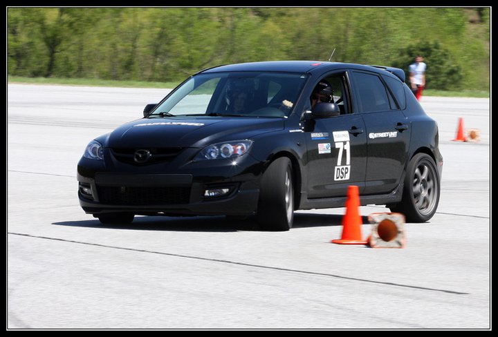

pstx_71_K44A3234 by Sir Turd Ferguson, on Flickr
Updated Photo as of March 2013

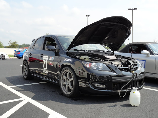

Current Engine Modifications
COBB Accessport
Mazdaspeed CAI w/ AEM Filter + Injen Pre-Filter
COBB Turbo Inlet
SURE Motorsports Recirculation Hose
StreetUnit Boost Tubes
Denso Iridium ITV22 Spark Plugs
COBB Short Throw Shifter
StreetUnit Aluminum Shifter Spacers
TRZ Dog-Bone Rear Engine Mount
cp-e Side Engine Mounts (Trans + Passenger)
Protege Garage Shifter Weight
cp-e Downpipe
Mazdaspeed CBE
Matt Damon Oil Catch Can
Current Suspension/Brake Modifications
K-Mac Camber Plates
AWR Strut Housing
Koni 8611-1256 Strut Inserts
Koni 8040 Revalved Rear Shocks
Hotchkis Rear Sway Bar (full stiff)
Custom Rear Spring Perch
800 lb. Hyperco Springs (Front & Rear)
SPC Rear Camber Arms
Stock OE Rotors
EBC YellowStuff Brake Pads
Current Wheel & Tire Set-Up
Street: 225/40R18 Michelin PE2's on 18x7.5" Enkei T-Fork Wheels
Race: 245/40R18 BFGoodrich Rival's on 18x8.5" TR Motorsport C2 Wheels

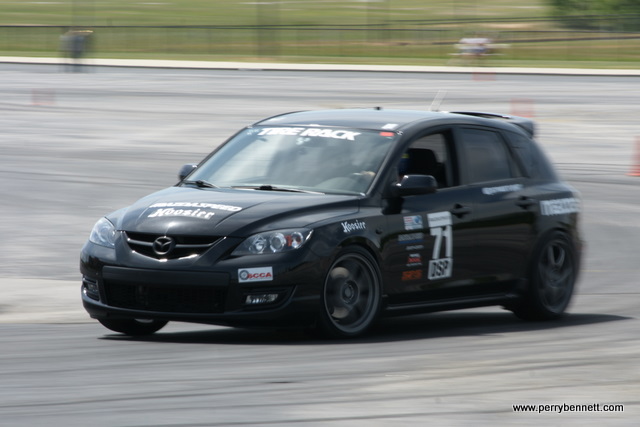

Setup for the NT event was...
New 255/35R18 Hoosier A6 tires on 18x8.5 TR Motorsport C2 wheels
BC Coil-Overs (shocks on stiffest compression setting possible)
7KG Front Springs / 6KG Rear Springs
0" Front Toe
Stage 2 + MSCAI2 93octane Engine Tune w/ COBB AP
SCCA National Tour - Atlanta Motor Speedway
For this event I had my friend Mike (a test driver who gets paid to AutoX for a living) as a co-driver along with his wife Amy running the car in DSPL. I made the trip down on Friday to get the car inspected and registered with the event running on Saturday / Sunday. There ended up being a total of six drivers in DSP for the weekend...

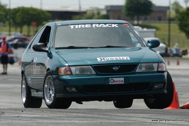

There were 2 drivers from Western PA in a 1993 BMW 325is (one driver finished 11/25 at the 2010 Nationals)
Another BMW (2000 BMW 328ci) with one driver from the Alabama Region
and joining the FWD club was one driver with a 1996 Nissan 200SX Se-R (finished 10th/32 at 2007 Nationals)
With a couple fast cars that have finished in the middle of the pack at Nationals, I was guessing the car would be around 1-2 seconds behind each day, but surprisingly Mike (a really good driver) was able to compete right up there with them while myself (and average driver) was around 0.5-0.7 seconds behind per day. The car handled awesome and probably was the fastest it has been since I started AutoX'ing with it. Set-up wise the car was left alone and no pressures / shocks / etc were changed on either day.
On Day 1 I ended up shaving time on each run to end up with a 40.6 fastest time, while Mike had a 39.7 that would have been good enough for 1st place but ended up clipping a cone. On his last run he made a conservative 40.3 while the BMW 325is drivers ended up with 39.8 and 40.0 respectively. Below are videos from my fastest run along with Mike's 39.7+1...
For Day 2 I had nothing to lose and went too aggressive on my first two runs of 39.9 and 39.5 while flattening a total of 4 cones (making up for my total of 0 from Day 1). My final run was clean and ended up as a 39.7 (video below...)
As for Mike his first run was clean (39.3) to temporarily move him up to 2nd place, while his second run was faster (39.0) but dirty. By the time of his last run we realized that a 38.9 or better was needed to finish in 2nd place and get one of those free Hoosier A6 tires. At the beginning he had issues getting the car from 1st-2nd gear and ended up losing some time, but still ended up with a 39.1 clean. After looking at the data we realized that he ended up losing around 0.4 seconds from that bad shift, but at least it's encouraging to know that we're on pace with some of the better DSP cars around. See photos and results below...

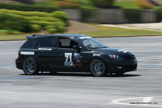

My car in the paddock

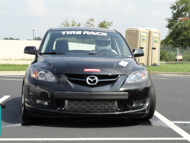

Another DSP 2009 Speed3 GT
SMF 2008 Speed3
South Carolina Points #6 - Florence
DSP: 1/2
PAX: 7/65
During the morning runs I kept clipping a cone through a high speed section where I tried to go flat-out even though you couldn't. Then in the afternoon while other cars were slowing down due to the higher track temps I was able to pick up the pace by adding more rear pressure and trying different lines through the course. My last run picked up a half-second over my best to put me 7th overall and into the Subaru Shootout. My first run in the Shootout was only three-tenths slower than my best, and since everyone else was slowing down this was good enough to be 4th out of 12 and into the 2nd round. For my 2nd round run the front tires just finally gave out as they had been starting to cord all day, and after suffering a few turns of massive understeer I knew that some time had to be made up and hit some cones on the 2nd half of the course.
Overall this event was a success as I can still feel the benefit of the Hotchkis RSB, but there is room for improvement through a softer front bar and fixing this boost leak. I'll also need to look at flipping / getting new tires since the Hoosier's are already looking pretty toast. Due to the short lifespan of the A6, I'll probably look into getting some BFG R1's through work.
Next Event: South Carolina Points #7 @ Michelin Proving Grounds. Sept 24th.
2008 Mazdaspeed 3
SCCA - Central Carolinas Region (DSP #71)
My DSP AutoX Build: Members Rides Gallery > Mr_Bill's DSP AutoX Build

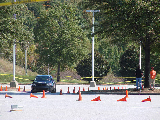

South Carolina / Central Carolina Points #8 - BMW Plant - Greer, SC
With the car running back at full power (a noticeable difference @ 20psi from 14) and the ALMS season over it was time to finish up the 2011 AutoX season, starting with the 8th points event of the season @ the BMW Plant in Greer, SC. This event is always held on the Sunday following the Eurofest Saturday car show/festival that takes place at the plant. To prep for this event I had the Hoosier A6's flipped to move the worn section of the tire to the inside and allow me to run these at the last few events of the year. There were no other major changes to the car although I swapped out the Mazdaspeed CAI filter for the AEM filter w/ Injen pre-filter and also installed the SURE Motorsports recirculation tube.
The course set-up was pretty short and bumpy for this event since the lot was not as ideal as the one used for last year's event at the plant. Times were in the 27-32 second range and the course had some pretty tight sections at the beginning that did not favor the MS3. The car felt really good, although the extra power made it tough to not spin up the fairly worn tires on corner exit. Starting pressures were 43F/47R and you could feel the car tighten up as the front pressures increased from run-to-run. During my first two runs I clipped some cones, but managed to make a clean 3rd run (which I didn't know was clean until after completing all my runs) for a decent enough time to win my class...
DSP: 1 / 5
PAX: 25 / 156
The car was not the limiting factor on this day as I could tell the driver was pretty rusty from not running much during the summer. The good news is I'll be able to start working on the driver mod soon as I'll be transitioning to a test driver job at work before the end of the year. I'm looking forward to seeing what a full year of car control training can do for my AutoX times. I was also able to get some good feedback at this event as another driver had issues with his Nationally prepped DSP Subaru Impreza and took me up on the offered co-drive. This was the first time he had driven the MS3 at an AutoX and was impressed with the straight line speed of the car, which is putting down ~150 more HP than his Impreza...if only it was coming from a different axle.
Looking forward I'm working on getting the MZ3 front sway bar installed before my last event of the year in November. I think this will really help the car on corner exit. I also plan to see if I can get those TopSpeed LCA bushings installed that have been laying around in the garage. Sometime this winter I also plan on getting a custom engine tune for the car, as the COBB template maps seem to run pretty rich with my current set-up. The only major winter project involves purchasing a 2nd set of front fenders for the car that are rolled to fit some ~285 wide front tires...hopefully very similar to the same modifications that Saitech made to fit his wider front tires.
Next Event: Central Carolina Points #9 @ Carowinds - November 5th (plan to have video footage from this event)

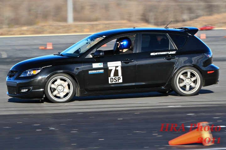

Been a while since I've posted up here so I figured it was time for an update. Winter projects are ongoing and over the past few weekends I have installed the oil catch can kit (from Performance Automotive Development...the same kit from the Grassroots Motorsports project cat) and swapped out the wheel studs (installed APR #070-100-7708 ) for the wider front wheels.
The oil catch can kit install took about 2 hours with some tight fits, and I haven't really had time to see how much crap it collects since the car has been in the garage since the install. Just trying to look out for the life of this engine as I plan on keeping this car for the forseeable future, and hopefully this will help out with the buildup of oil and gas that is common with our platform. The wheel studs were also a pretty easy swap, and were probably a good idea anyways with the amount of tire changing that this car has/will see.
Tires and wheels (285/30ZR18 g-Force R1's on 18x10" Enkei RPF1 wheels) have also showed up for the wider front set-up, and I plan on getting them mounted up tomorrow and start work on the fender swap & roll for fitment. It looks like I'll need about a 15mm spacer to clear the BC front struts, so I'll use the time before the first event of 2012 (Central Carolinas Region @ Z-Max Dragway in Charlotte on Feb 18th) to get everything figured out for this set-up.
New Tires & Wheels Ready to Go...
Spare Fenders (guarded by Al Bundy himself) ready for install along with new 245/40ZR18 g-Force R1's for the rear tires
Hopefully most of this work will be completed over the next week so I can get some driving in to make sure there are no issues with the fitment. I'm hoping to make some more National Tour events this year, but after looking at the schedule it looks like I'll have to wait until Blytheville or Peru for somewhat close events to SC since I'll be in Sebring getting ready for the 12Hr race during the Dixie NT weekend. 2012 Nationals in Lincoln also look doubtful due to conflicts from this year's ALMS schedule.
I'll be running in the "Pro" class at events this year (and probably get my ass kicked), and since I won't really be running for a regional championship this will give me the opportunity to pick and choose events between Atlanta, Central Carolina and South Carolina regions that fit my schedule. I'm really looking forward to getting the car ready and see how the new tire/wheel setup works.
