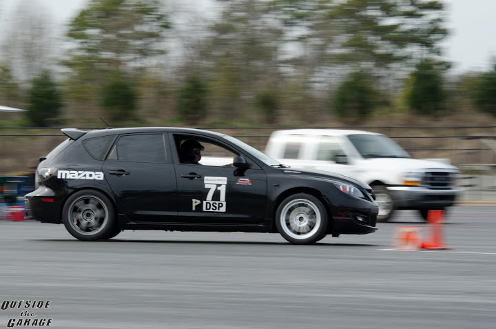

First event of 2012 is in the books, and I'm happy to say that project "Big Fat Fatty" w/ the 285/30R18 front tires has been a success. The fenders were cut & rolled last week leading up to the event and the only driving they had seen with the bigger tires had been around the neighborhood, so I had no idea what to expect once the car was under load. The finished fenders look pretty rough to the eye, but I wanted to make sure that the set-up could be functional before worrying about making the fenders more appealing to the eye...
Central Carolinas Region Event #1 - Z-Max Dragway in Charlotte

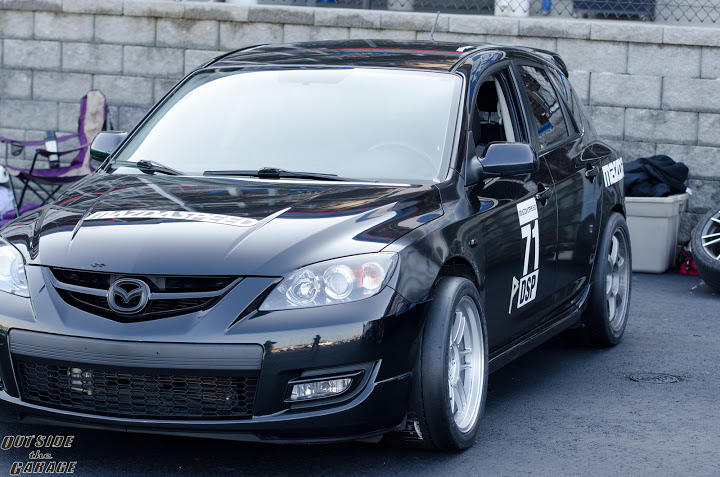

My suspension set-up for the first event of the year was as follows...
Front Tire/Wheel: 285/30R18 BFG R1 on 18x10" Enkei RPF1 wheels (w/ 30 mm spacer)
Rear Tire/Wheel: 245/40R18 BFG R1 on 18x8.5" TR Motorsport C2 wheels (no spacer)
BC Racing Coil-overs (7kg/mm front spring & 6 kg/mm rear spring)
Front Sway Bar: Mazdaspeed 3 OE (re-installed so I could evaluate tire/wheel change)
Rear Sway Bar: Hotchkis on stiffest setting
Front Camber: ~-2 to -2.5
Rear Camber: -1
Front Tire Pressure: 38 psi
Rear Tire Pressure: 40 psi

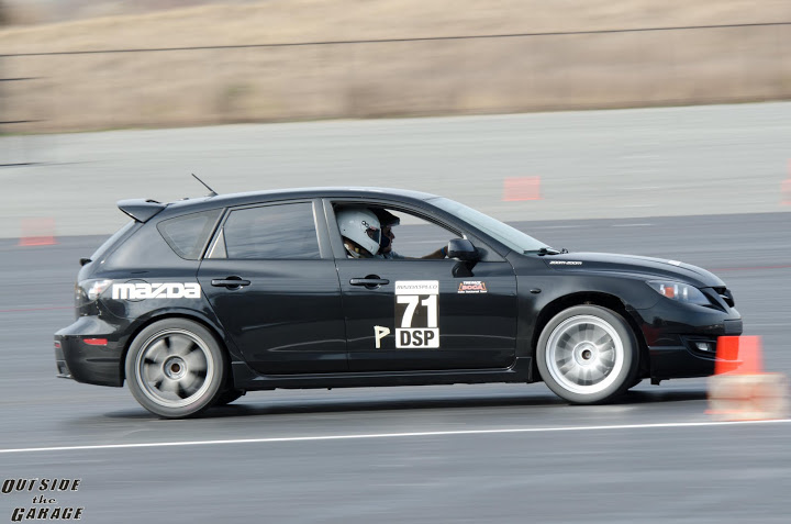

The course lay-out was designed by the reigning B-Stock National Champion (S2000 driver) so it was a little tighter compared to some other course designs on the Z-Max lot. This is an awesome site for AutoX events as it's almost perfectly smooth (minus one storm drainage dip) but the lot does suffer from a lack of grip. There were over 170 competitors on hand including multiple national champions, so this would be a good test to see where the new tire/wheel set-up stands. Also different from previous years was the fact that I decided to run in "Pro" class where I could get my ass handed to me for a while, but it was time to let somebody new compete and win in DSP. I would also have a co-driver for this event who typically drives a Mazda 3 in STF, but due to a blown RR shock he was left without a ride for this event. Turns out this was good help since the R1 would need all the heat possible for maximum grip in the mid-50's weather.
On the first run I had no idea what to expect, and right from the start the car was an oversteer machine from a combination of cold tires and different front-rear tire widths. After struggling through an out-of-control run (and bringing a cone home to the finish with me under the car) I was starting to question what I had done, but the bright side was the first opportunity to correct and oversteer condition with this car. After dropping 4psi out of the rear tires the car was a little more stable on the 2nd run, but it wasn't until halfway through my 3rd run (which was red flagged due to a mechanical failure on another car) that I could really begin to push it. After some pretty good 4th & 5th runs I was able to knock 6+ seconds off my starting time (not including penalties). The red flag really bailed me out this time as I could use the remaining course to put more heat in the tires and test the new limit. The co-driver was also able to see a big time improvement from start-to-finish, and maybe I was able to get him addicted to the fun of a turbo-powered engine.
Based on my previous experience with this car, the biggest change came in the form of corner rotation and off-throttle oversteer. In the past when I charged to hard into a corner I had no choice but to let off the gas and wait for recovery...with the wider front tires when I let off the gas the car has the perfect amount of lift-throttle oversteer which allows me to get back into the gas earlier on mid-to corner exit. It took a few runs to figure out the new front track width through the slalom, but overall the change helps in a big way. I was closer/beating some cars which had been faster than me in the past even with the disadvantage of tires which took a long time to heat up (and probably never actually reached the optimal heat range). On hotter summer days I think this will become less of an issue.
CCR Points #1 Results - ZMax Dragway
DSP - 1/6
Pro - 18/28
Pax - 22/173
After driving this event a few more weaknesses of the car became highlighted, and I feel that the biggest improvements could currently be made with reducing weight and some new coil-overs with stiffer springs...but for now I want to keep driving to get more seat time with this set-up. Now that I know the spare fenders will work, I'm hoping to add some fender flares & paint to make them more appealing to the eye.
