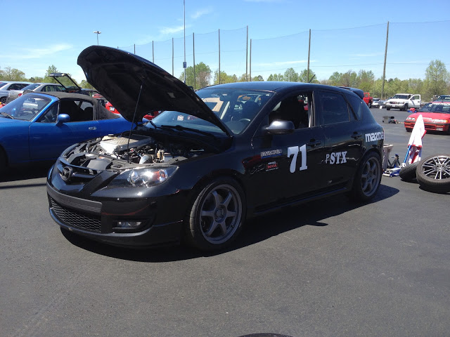

Highlands Sports Car Club Day AutoX - June 17th

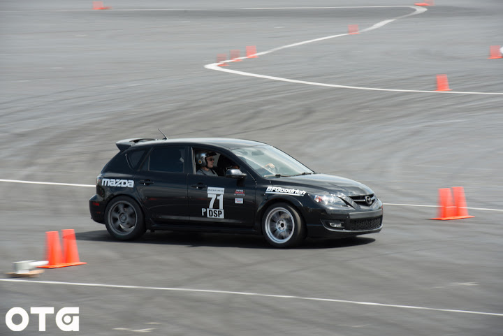

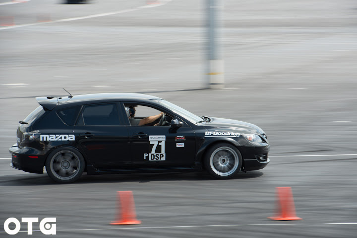

A few days late on posting this, but I was able to get some more seat time and practice last weekend with the Highland Sports Car Club near Asheville, NC. I enjoy running these events because it's only an hour drive from my house, plus you typically get 6-8 runs and the club does a really good job with course design on such a small lot. The only changes going into this event was the addition of the Schroth 4-point harness to help attach my ass to the car during all of this bumping & turning. I never really noticed it too much driving, but watching video you can see just how much I'm moving around in the car...so I figured a harness couldn't do anything but help out. Installation was fairly easy and straight forward (takes 1-2 hours to bolt everything in) and it did make a big difference in feeling more connected to the car and getting more feedback from the tires. I really wish this was something I had purchased earlier...

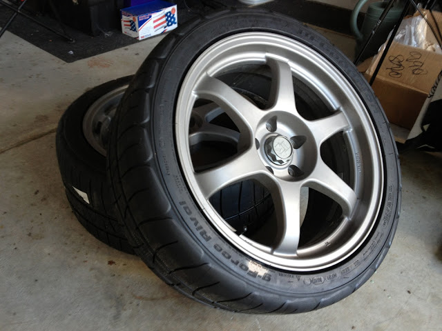

For this event I ended up trying a different tire combo with the 245/40R18 BFGoodrich R1-S up front and the same size, but older R1 compound on the rear axle. I knew this would result in some oversteer but really had no idea how much to expect. Starting pressures were 38 psi square...
My MS3 along with the CSP Miata
With the day series set-up you get 3 runs in the morning followed by 3 runs in the afternoon. On my first run I took it a little easy since I didn't know how much sliding to expect, but I was actually surprised that the cold R1's weren't as bad as I expected. Sure...there was some oversteer when driving hard on corner entry, but it was pretty progressive and easy to control, plus the different compound on the rear really helped out with corner rotation. With the way this course was set-up I was really able to take advantage of the faster straight sections since the R1-S is so good at putting the power down and it allows me to drive pretty hard into the corners with some late braking. For each run you could feel the rear of the car become slightly more stable, and after 3 morning runs I had the fastest raw time by almost a second. The biggest issue holding the car back was understeer on corner exit of the slower/tight corners which forced me to wait before getting the power down for the fast parts.
In the afternoon I drove pretty aggressive since I was just trying to better my fast time of the day. The first 2 runs I went a little overboard and took out some cones due to over-driving. I also made an adjustment to the front compression of the BC coil-overs by reducing it from the maximum of 30 (0 being the softest, 30 the stiffest) to 10 and you could feel an improvement regarding the corner exit understeer. With the ability to put the power down earlier I was able to pick up a half-second improvement on my previous best...only to be knocked out of 1st place on the very last run by the CSP Miata which saw him pick-up almost a second. The only good thing about it was that the car was driven by a fellow test driver at work who was also running the R1-S tires.
The 1-2 finish on the new BFGoodrich tires had some people talking, and I can say that my experience has been pretty good so far. The tire has a noticeable improvement in grip and also seems to wear better than the Hoosier A6 after 15 runs.
Highlands Sports Car Club - Day Series Event #3
PAX: 3 / 60 (2nd fastest RAW)
DSP: 1 / 1
PRO: 3 / 7
So after trying out the different tire compound set-up, and making some compression changes to the front struts, I would like to get a chance to run a test/tune event where I can try the older R1 compound with the 285mm wide R1-S tires and see how they handle on a faster course. Fortunately the Atlanta region will be hosting a few test & tune events coming up in preparation for the National Championships in NE, so hopefully I can take advantage of one of these events and experiment with the car set-up.
My next event will be with the Central Carolinas Region on July 14th...barring any 105 degree weather that makes me question my sanity about standing in a parking lot for 10 hours. After this my calender will be pretty much booked with the remainder of the American Le Mans Series beginning with the event at Lime Rock Park on July 7th. For the remaining races this season I'll be working with the new Dempsey Racing P2 Lola prototype that is driven by Joe Foster & Patrick Dempsey (pic below)...

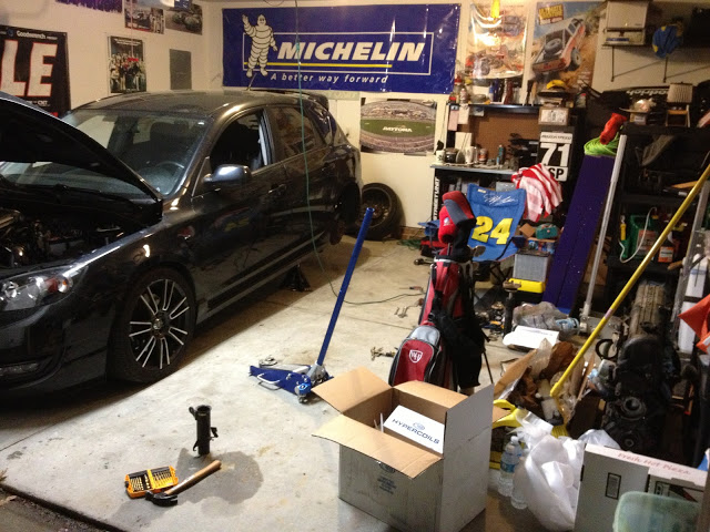

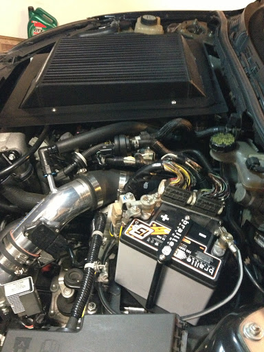

Finally got most of the photos back up so this thread remains active. This winter has been pretty quiet regarding upgrades and modifications...the only real change I've made is installing a Braille 15 lb. battery in place of the stock one after it died out around Thanksgiving.
I bought the Braille mounting stand that fit this spec battery (B2015) and also purchased a tender to keep it charged when I got a week or so without driving the car. Installation of the stand was pretty simple, and after removing all of the extra boxing and the stock battery itself I would guess this upgrade saved around 20 lbs.
Most of the schedules for the local SCCA regions are out for 2013, and it looks like I'll be able to make more events than 2012. The American Le Mans schedule really doens't pick up until late summer so my best chance to hit up some events will be in the early going. I was planning on heading up to Charlotte Motor Speedway tomorrow for the Central Carolina regions first event of the year, but a weather forecast of upper 30's with rain/snow mixture are making me second guess this decision and I'll probably stay home. After just getting back from a month of snow testing in the UP of Michigan I've had enough of that shit. The planned early part of my schedule this year looks something like this...
Feb 16 CCR AutoX #1 ZMax Dragway in Charlotte (Weather)
Feb 24 CCR AutoX #2 Metrolina in Charlotte
March 24 CCR AutoX #3 Michelin Proving Grounds in Laurens, SC
April 3 Highlands Night AutoX #1 Asheville, NC
April 13 CCR AutoX #4 ZMax Dragway in Charlotte
May 1 Highlands Night AutoX #2 Asheville, NC
May 27 CCR AutoX #5 Carolina Motorsports Park in Kershaw, SC
For the events at larger sites (ZMax, Michelin, CMP) I'll run the 285 front / 245 rear R1-S set-up with the modified fenders (which I'm hoping to paint this week so they at least look halfway decent). With the smaller sites I'll run the 245 R1-S front / 245 R1 on the rear as this helps with the extra rotation and saves wear on the larger tires.

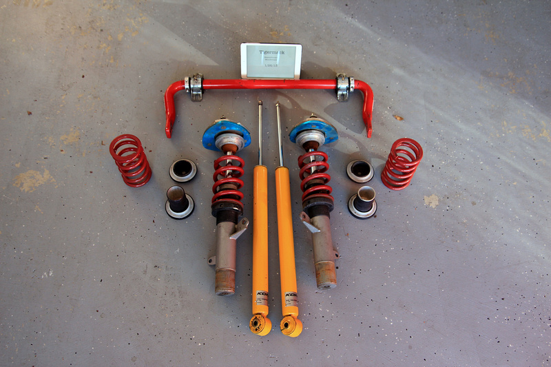

As for upgrades moving forward, the biggest things I'm working on right now is finding a way to install the Whiteline LCA bushings that were recently purchased along with researching options for upgraded suspension. After upgrading the tire situation to the wider fronts last season the car has become undersprung IMO...and I think an upgraded system (with better strut performance) would be the biggest way to improve the car along with an improved front LSD (not planning on upgrading this until down the road). An increase in spring stiffness would also allow me to completely remove the FSB. Ideally I would like a coil-over kit with ~600 lb. spring rates, but it doesn't appear that there are any "off the shelf" kits for our car in this range. Everything is much lower or a good bit higher (like the KSport kit with ~900 lb. springs).
If anyone would have any ideas or suggestions for the next suspension system feel free to post them up...always open to input and I don't pretend like I know everything there is to know about this car.
Regarding the horsepower front...I really need to do some maintenance and clean up the valves as I'm sure the are pretty gunked up by now (I only installed the OCC about 3k miles ago) and I've read where the carbon & crap on the back of the valves can affect the tuning...so I don't want to spend some money for a good professional engine tune before getting them cleaned. After getting this taken care of I would eventually like to get a good tune (this is the area of the car that I consider my weakest as far as knowledge) and also include a map for the e85 option (Spirry I'm sure I'll be in touch). Look forward to getting the new season started and hope to see some of you around at the events.

Sounds like another good season for you this year. Not sure how the whiteline bushings are packaged but the OEM lca bushings just needs a torch to blow them out. Anyone with a press should be able to press the new whiteline bushings in.
You may want to look at corksport or AST since they already make shock bodies for the speed3. AST support scca and I am sure they will make you whatever shock/spring combo...for a price. Corksport seem like it's an off-the-shelf package deal but if you can find out who their supplier is, they might be willing to build you a set.
My speed has been sitting idle for a while but I'll make slow upgrades over the next year or so. Until then, I'll probably run in you at tour/pro events with the shifter kart.

Looked into AST myself. Not cheap. Was also looking at the Ksport RR set up with the super stiff springs but decided to dabble in adjustability first with some new koni yellows instead of full bore with coilovers. Im still getting used to the BNR in autocross.
Clean valves does wonders Bill. Done mine twice so far.

Do the BC coilovers use a standard 2.5" perch? If so, you should be able to find any spring you'd need in the Eibach catalog.
Summit Racing selection, narrowed to 2.5" diameter, 6" free length
Eibach Coil-Over Springs - 2.500 in. Inside Diameter (in) - 6.000 in. Length (in) - SummitRacing.com

I have a set of Koni double adjustable fronts and yellows rear if you are interested. Those came off our FSP car.

PS, how much did you spend on the braille? Moty design made my 3.5 lb 16 cell LiPo 550 CCA battery for 200. They make a 20 cell battery that weighs < 5 lbs now too. I ran that one for a bit but sold it to a friend with a BP FD RX7 build to help him out.
Total cost for the 15 lb. Braille was $168 and so far it has worked with no issues. Whenever I park the car in the garage for a week or more I just hook it up to a tender. Sounds like you got a pretty good deal on yours...I just went with the Braille since a few other guys have had good results with them.

DSP to STX Conversion
With the launch of the BFG Rival and the continued uphill battle of running DSP with this platform (which has been made even worse now with the addition of RX-8's), I've decided to change directions with the AutoX build and see if the car can be more competitive in the STX class. My next event will be this weekend with the South Carolina region at the Michelin Proving Grounds so I'm planning to try out the following...
First to "de-tune" the car from DSP to STX I'll need to:
- Swap back to the OE intercooler
- Swap back to the OE BPV
- Re-install the OE fuel pump
- Detune the engine to a STX legal map with the AP. Thanks to @spirry for the offered help on this topic.
Next, it was time for a much needed suspension upgrade and thanks to @tigermack and @justint5387 I'll be using some of their older FSP & STX build suspension pieces which include the Koni Yellow struts combined with the AWR front housing & custom rear perch for 2.5" springs. For the springs I've ordered a set of 800 lb. front Hyperco's with a combination of 600, 800 and 1000 rear spring sets to allow for some testing & tuning. The plan is to install the new suspension this Friday and run the square 800 lb. set-up with the FSB disconnected as a baseline.
For tires I'll using my 18x8.5" TR Motorsport C2 wheels and mounting a set of 245/40R18 BFG Rivals. This weekend will provide a good test to see how the new STX set-up stands as the Michelin Proving ground events typically pull 200+ competitors from the southeast...and with the addition of the newly paved black lake (1400 x 400 asphalt pad) it could be even more. I've taken Friday off work to spend completing this conversion and I look forward to posting my findings...if anybody has any tips or suggestions for this STX build feel free to chime in.
Wish I could have gotten started on this conversion earlier, but things have been pretty busy at work lately as I just got back from the American Le Mans preseason testing and race week in Sebring. Not sure if many of you follow the series, but business has picked up this year for Michelin with the announced withdrawal by Dunlop, and as a result we have picked up the BMW - Rahal team who I'll be working with while they run the new Z4 GTE (pics below) for the full season. The car showed good potential at Sebring and was running 2-3 in GT with 4 hours to go before some issues (broken strut on the #56 and loss of power steering on the #55 ) would drop the cars to 4th & 7th in class. If any of you will be at any of the events this season be sure stop by...

Central Carolinas Event #3 - Michelin Proving Grounds
A couple of weeks ago was the most recent CCR region event at the Michelin Proving Grounds in Laurens, SC, where I was hoping to get a good read on the switch from DSP to STX with the BFG Rivals, but the weather didn't cooperate with temps in the low 40's and rain all day. The new suspension pieces from @tigermack and @justint5387 were picked up on Thursday before the event but I didn't have time to get them installed...plus I wanted to leave the older BC Racing coil-overs on to give me a better read on the change. Thanks to @Spirry for the help with the STX legal map...I ended up just running with the 93 oct map for this event and will experiment w/ the E85 mixture this summer. For the next event in April I would like to change only the suspension before tinkering with the engine map changes in May/June.
CCR Points Event #3 - Michelin Proving Grounds
PAX: 19 / 133
STX: 5 / 11
PRO: 11 / 27
The asphalt lake (400x1400 ft pad) that is used for these events was repaved in November, so the flat surface provided a decent amount of standing water along with the cold conditions for trying out the new Rival tires...not exactly ideal conditions for a summer tire. The tires were brand new at the start of the event, and they definitely took the first run to scrub off any mold release and begin to grip up towards the end. Overall I was pleased with how they did in the wet...it took a few runs to figure out the best way to drive and I was able to shave off 3 seconds from my first to last run. Can't really get a good read yet on how they will compete in the dry, but hopefully that will be coming in a couple of weeks.
For tire pressures I started w/ 40 F 45 R and ended up bleeding the fronts down quite a bit to get the proper amount of roll w/ the lack of lateral G's in the wet. By the end of the event I had bled around 4-5 psi out of the front tires. I never really a big issue with hydroplaning, but the front tires would definitely lose grip if you went too large with the SW angle...had to learn to drive within the limits, but it was still a fun time driving in the wet conditions.
Next event will be in 2 weeks w/ the CCR region at the Z-Max Dragway in Charlotte. The plan is to install the new suspension pieces this weekend and hopefully see how the Rivals compete in STX in the dry.

Default Upgraded Suspension
A few weekends ago I swapped out the BC Racing coil-overs for the new-to-me suspension that used to be ran by TigerMack & justint5387 with their STX MS3 & FSP MZ3 builds of the past few years. For springs I ordered a pair of 800 lb. 7" springs for the front (ID 2.5") with a set of 600, 800 & 1000lb. 6" springs for the rear...all from Hypercoil. The swap was pretty straight-forward, the only thing I had to watch were the rear springs to make sure they seated correctly due to their shorter length. After re-connecting the RSB and only jacking up 1 side at a time to change tires on-site the springs have stayed in place with no problems.
On top of the new suspension I would also get to tryout the new BFG Rivals in the dry...
So to update, my current STX suspension & tire set-up is below:
TIRES - 245/40ZR18 BFGoodrich Rival
WHEELS - 18x8.5" TR Motorsport C2
FRONT - Koni 8611-1256 Strut Inserts (set at full soft rebound & 5 clicks stiff for compression)
AWR Strut Housing
K-Mac Camber Plates
800 lb. Hypercoil springs (7" long)
MZ3 Stock FSB w/ Powergrid adjustable end-links (disconnected)
REAR - Koni 8040 Re-valved struts (set at 80% full stiff rebound)
800 lb. Hypercoil springs (6" long)
SPC Camber Arms
Hotchkis RSB (set at full stiff)
CCR AutoX #4 at Z-Max Dragway in Charlotte
Last weekend was Central Carolina's 4th event of the season, and their first day event at the big parking lot beside the Z-Max "4-wide" dragway beside Charlotte Motor Speedway. This event served as a great opportunity to try out the new suspension upgrades along with the BFG Rivals in the STX class. Overall there were 180 entries with a lot of fast cars, including the multi-time A-Modified National Champ to actually sets the PAX of 1.0. It was awesome getting to watch this car fly around 10 seconds faster than I could...
CCR Points #4
PAX: 35 / 180
PRO: 30 / 38
STX: 2 / 13
For tire pressures I started w/ 40F 45R and continued to bleed the front tires down to 40 psi between runs. This pressure seemed to get the right amount of sidewall roll without going too far. The course design and layout for this event was a blast and offered a good combination of fast & technical sections. For the tires they continued to gain a lot of grip with each run as they were still pretty much brand new...I'm new to the ST game but think this trend will continue over the next couple of events. I was really pleased with the progressivity and drivability of these tires on my car as they were very predictable with a lot of feedback and pretty slow breakaway when you did exceed the limit. With the large outside shoulder blocks the front firmness feels pretty strong through the slalom & fast transitions w/ the rear holding up pretty good for stability. Overall for this event the R-comps were the way to go with warmer temps and high grip level, but I'm looking forward to running these tires at some more sites to get more info on how they hold up vs. the competition.
The new suspension was also a huge gain and I pretty much spent the entire first run just driving in awe at the amount of rotation I was able to get. Disconnecting the FSB was a huge improvement as I was able to pick up the throttle a lot earlier for corner exit and actually never got the point where I was accelerating soon enough to be at the limit (this the biggest difference between my old suspension and will take some time to get re-adjusted). Each run improved by about a second and there was some more time to be had. Whenever I would get some understeer I was able to quickly blip the throttle and get some nice lift throttle oversteer as well. With the higher grip surface I could have used a little quicker turn-in (could be helped with more front rebound / compression) and some more entry / mid-corner rotation (could be helped with trying the 1000 lb rear springs) but I want to keep things the same for the next few events just to get used to driving this new STX set-up. I definitely left some time out there as the driver is the biggest limit right now.
Moving forward I'm pretty happy and look forward to playing around with this STX set-up and seeing how competitive it can become. The only major mod I could see saving up for in the future is an upgraded LSD w/ OS Giken, but that will not be coming until this winter at the earliest. Over the summer months I'm hoping to make at least 1 event a month to keep getting some more seat time and becoming re-acclimated to the car.

Also here is a good view of the course coming from a DSP RX-8 that finished 6 seconds faster than me (and 14th in STX at Nationals last year)...hence the reasoning of my bailing out on DSP and trying out this whole street tire deal. No way I could ever dump enough money into the car to make it this fast.
