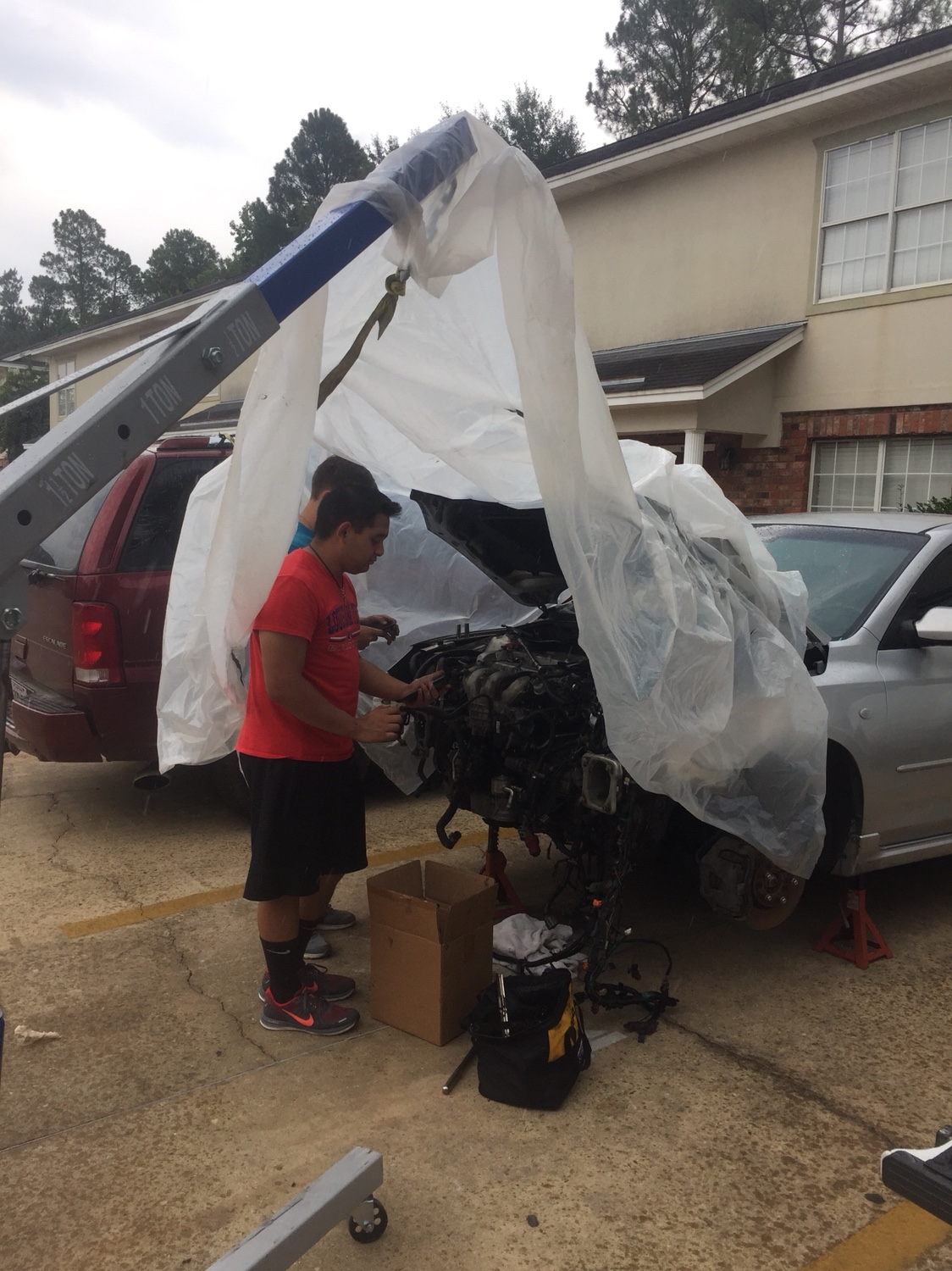

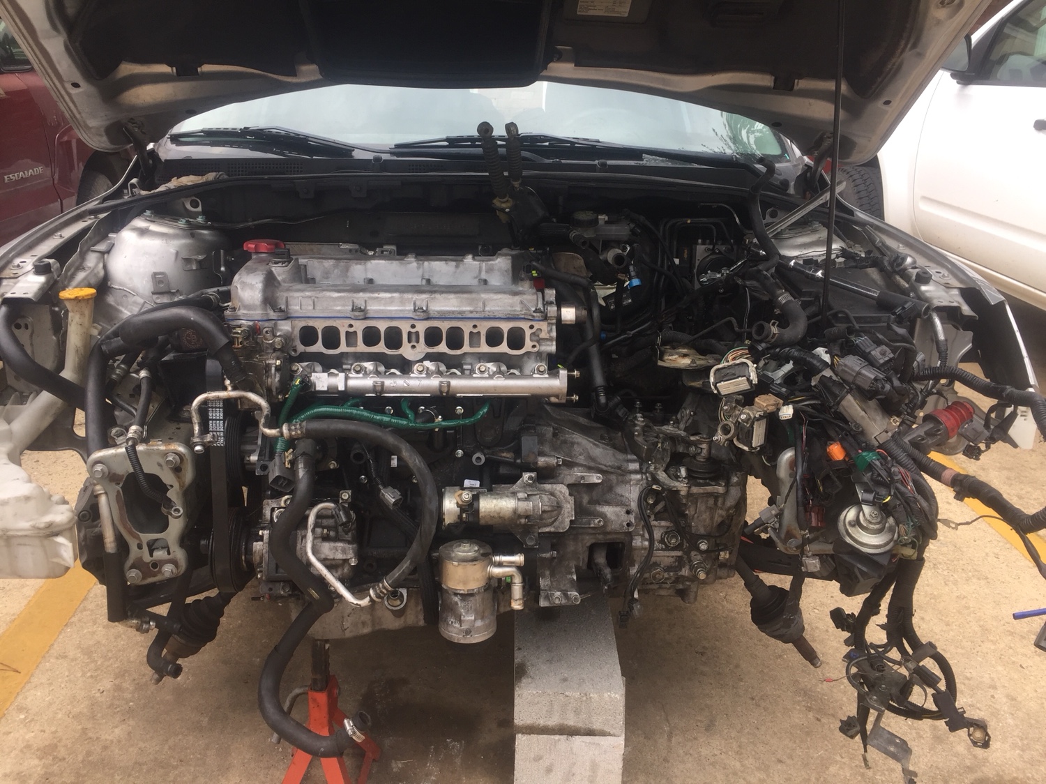

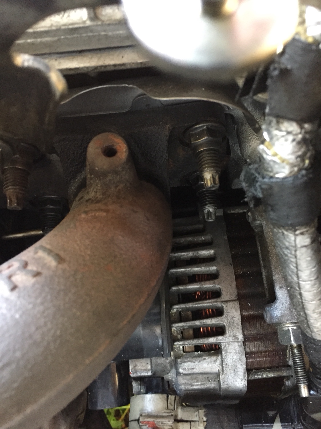

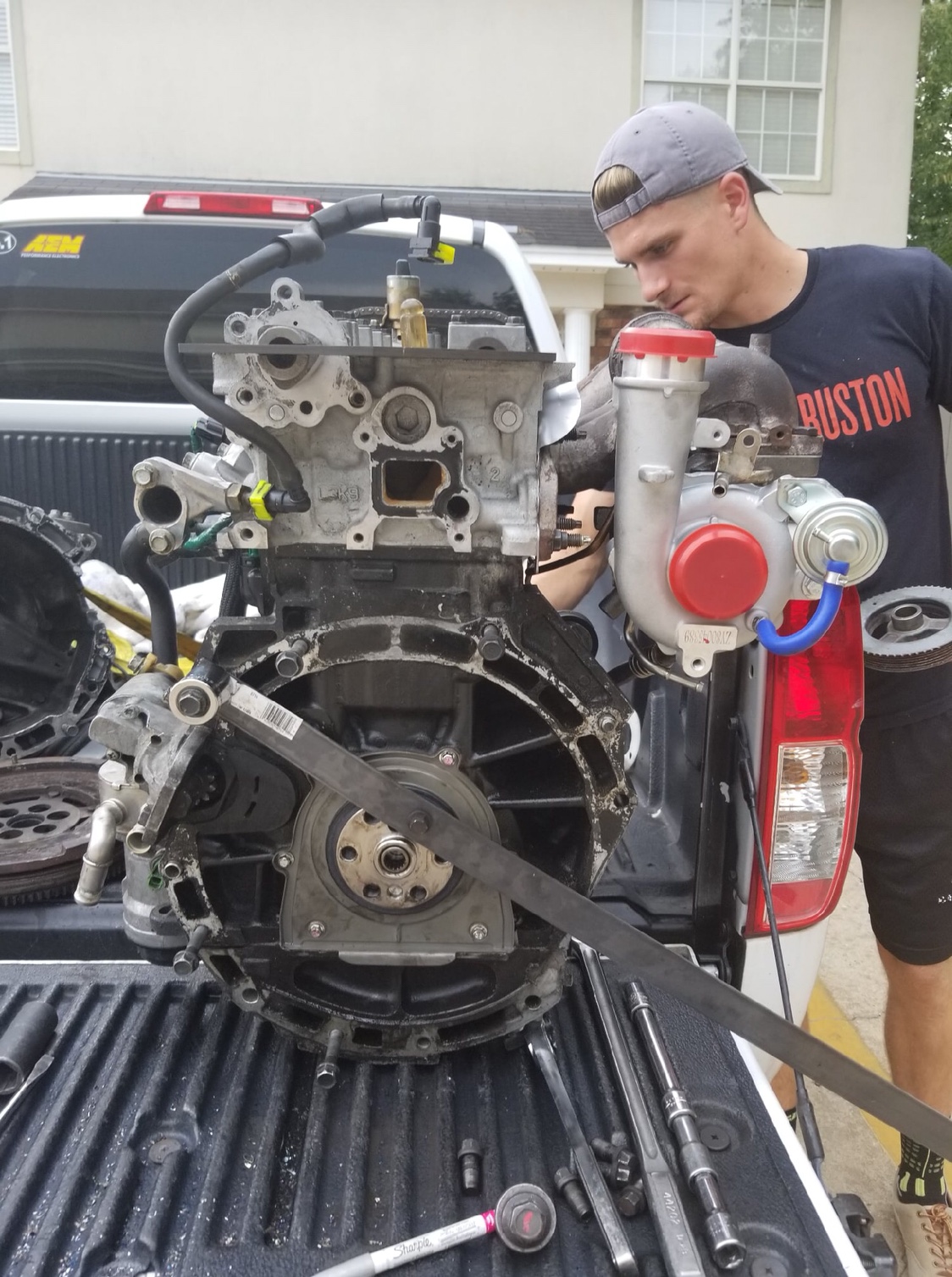

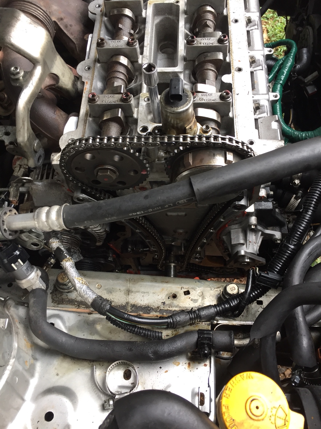

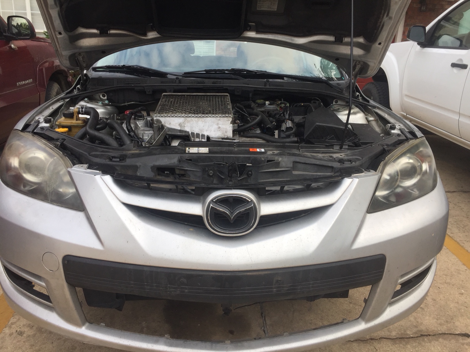

And here we go!
Okay so today had to do last minute shopping for a throw out bearing becuase somehow I lost the one that I bought, oh well. Got the motor buttoned up a little more and got the timing set dead on, went two full rotations and everything turned beautifully. Accessories and belt went on last and that was as much as I got to today, tomroow once I get the throw out bearing I most definitely will have the engine and trans mated and back in the car by Sundown. Then all of the wet systems and electrical work begins. More to come tomorrow!
in this picture that's the tool I made to keep the crank in place while I tightened the piss out of the crank bolt

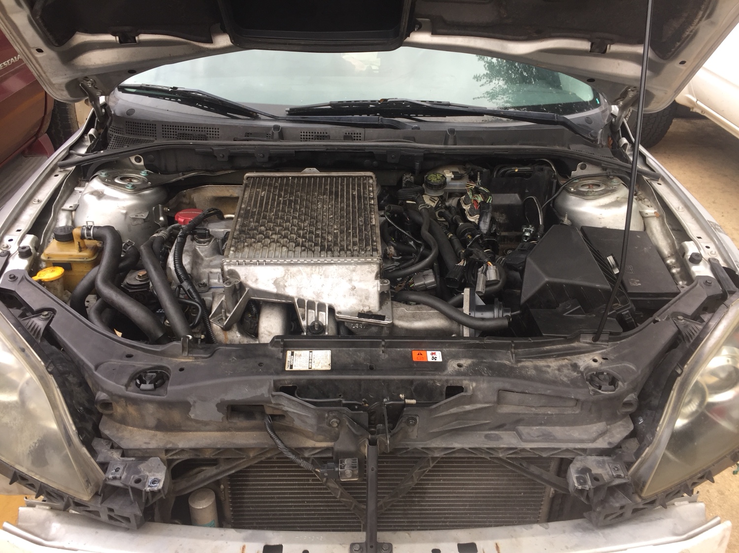

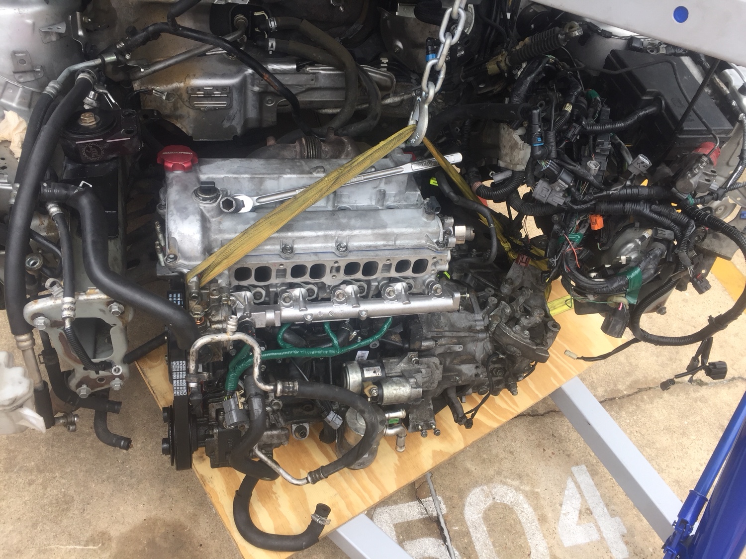

And she's in!

Alrighty well I got literally everything done yesterday except the fuel pump and getting the wheels and tires back on. So I present to you, with just hand tools, an apartment complex, an engine hoist, two friends, and a lot of know how. My car aurora

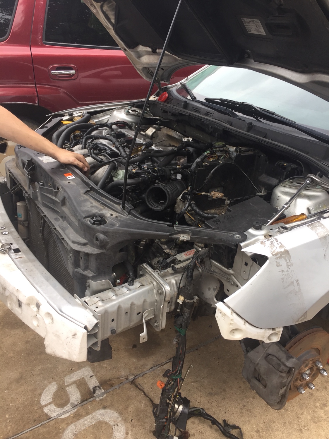

So got her washed up today and prepping her to move her over to a friends garage to do the rest of the work. Fuel pump will be in tomorrow morning so hopefully by tomorrow evening she'll be shooting flames out the tailpipe. In the mean time I made some aluminum brackets to hold the front bumper on since the factory clips are toast. I'll get some pics of that this evening. For now I just have a picture of what everyone I race will be looking at. More to come tomorrow!
Speed.mazda.3 is offline   Reply With Quote

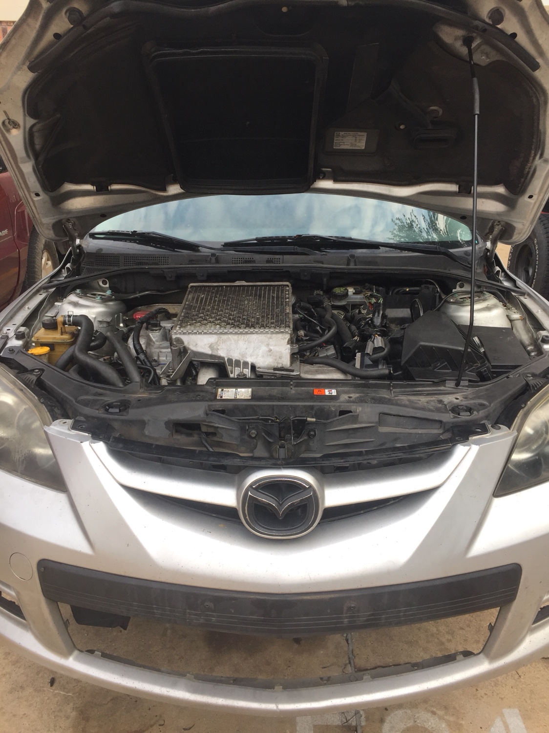

Just snapped a quick picture of my car and my truck outside my buddies garage before we get to work today with the little details

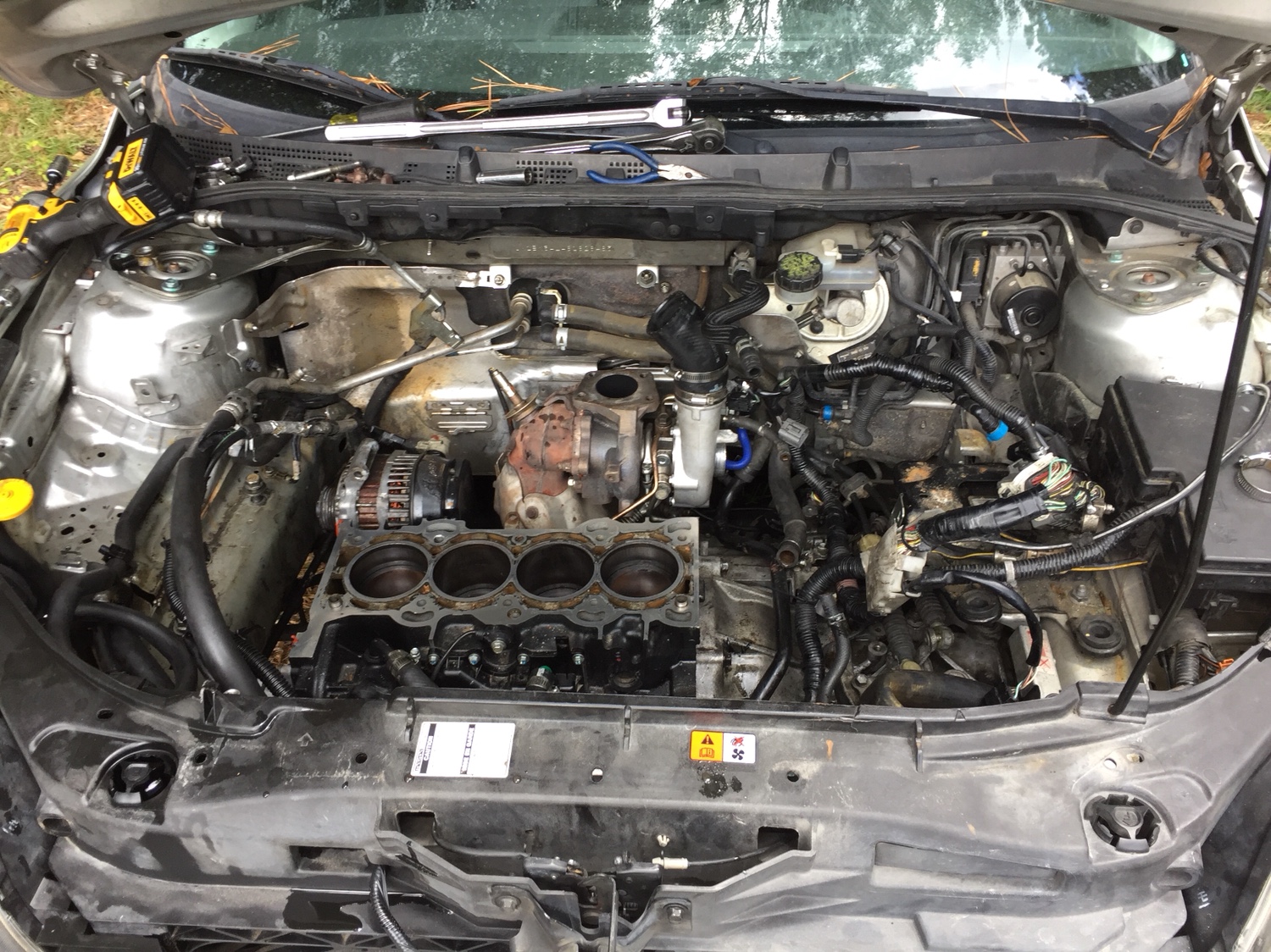

Well crap. Got the crank pulley placed correctly and got it started and got some bad news. Huge plumes of white smoke. So I guess it's going to be and engine part out and buy a used motor to swap out.

Alrighty well it's time to hear from you guys. Pretty sure it's the head gasket, pressurized the cooling system and it doesn't hold pressure, checked all connections and they're tight, checked turbo and it's not leaking, pretty sure water is leaking into the cylinders. So if anyone has any information, Tell me about cometic Head gaskets for these motors. Would a thicker gasket be better or is it smarter to roll will oem thickness. Pretty sure it's .030". I've searched some stuff around but can't find to many people running thicker than oem
 Old 08-02-2018, 08:14 AM   #63
Solarsurge's Avatar
Join Date: Apr 2016
Location: Richmond, VA
Posts: 577   (View Stats)
Thanks: 24
Thanked 120 Times in 95 Posts
Assuming your head/deck surfaces are perfectly square and flat, either gasket *should* be fine. I prefer the Cometic gasket, but many swear by the stock gasket including Speed Performance, who is probably the #1 engine builder on our platform. Stock thickness is .030”. Also, you also should NOT reuse head bolts, as they are torque to yield bolts.

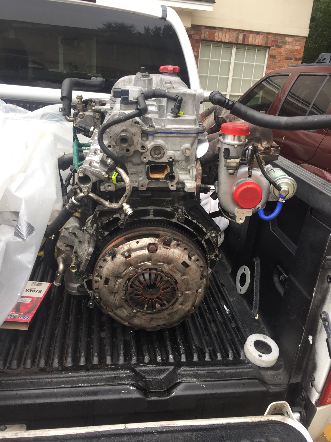

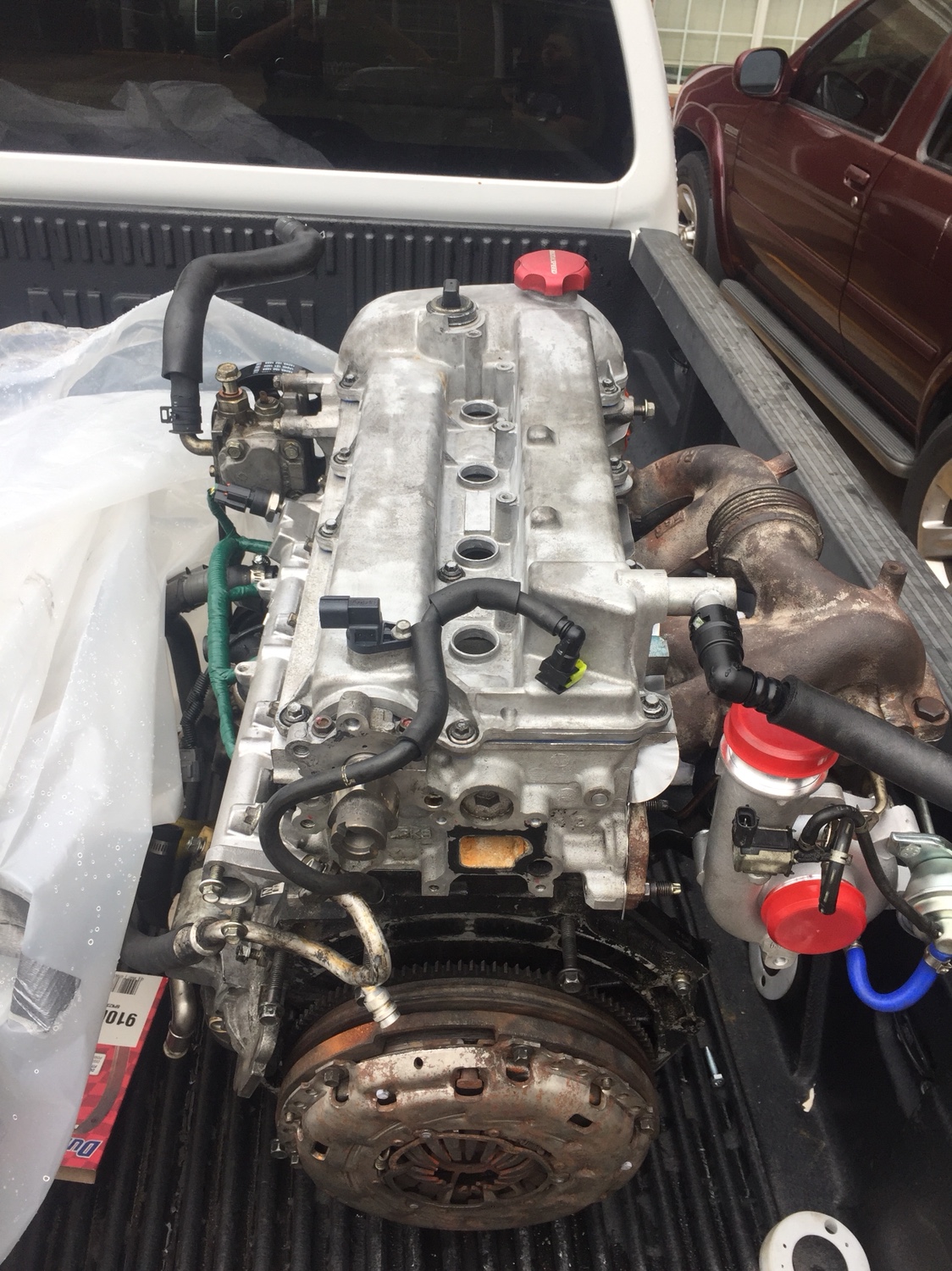

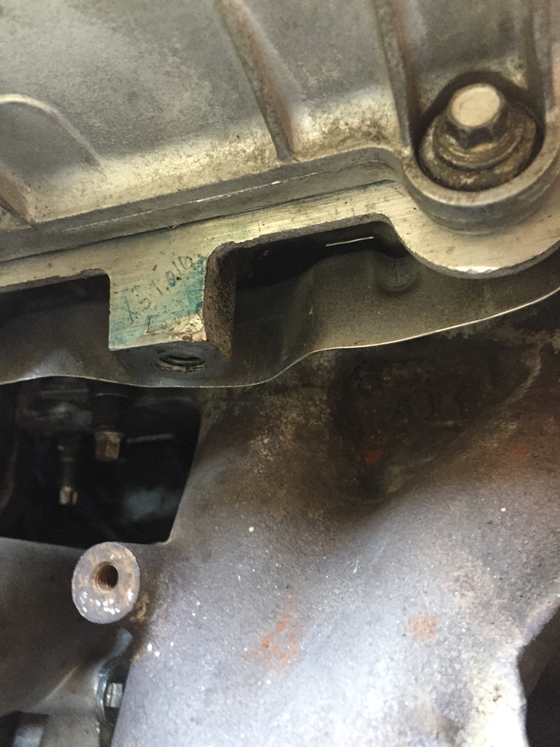

Well definitely found my problem
Oil all over the motor, so I guess I'm one of the very few people who had a failed head gasket on stock block, stock turbo. Oh well, I'll get a new one and a new set of head bolts and continue
Last edited by Speed.mazda.3; 08-02-2018 at 12:04 PM. Reason: MSF Database - Automerged Doublepost
Drain and refill your oil and coolant. If any of that shit mixed in the block you’ll be lubricating and cooling your block with milkshakes.
 Old 08-02-2018, 02:36 PM   #73
Fstrnyou's Avatar
Join Date: Jul 2016
Location: Near Charlotte NC
Posts: 2,498   (View Stats)
Thanks: 55
Don't just drain it. Flush them both.
A little oil in the coolant might not harm anything, but coolant in the oil can be terrible.
Solarsurge and Speed.mazda.3 like this.

Speed.mazda.3's Avatar
Join Date: Jul 2018
Location: Ruston, Louisiana
Posts: 47   (View Stats)
Speed.mazda.3 is a jewel in the roughSpeed.mazda.3 is a jewel in the roughSpeed.mazda.3 is a jewel in the rough
Thanked 5 Times in 5 Posts
Gonna flush both systems and I already ordered a new head gasket and head bolts. Hopefully with a few hours a day over the next week I can get this thing cleaned up, torn down and back together with a new gasket and hopefully won't run into this problem again

So in order to let out some of my frustration I decided to pack my truck up and take my girl down to Galveston for the weekend. As we were about to leave I decided I'd go and take a picture of my car just for fun. If I didn't know that it had mechanical problems I would be like "damn that's a nice car" but for now all I can say is "damn, that'll be a nice car"

Alright so took a few hours today to get the car torn down again to swap out the head gaskets and then get everything torqued down again. Got as far as putting the new head bolts into the holes and then I stopped for the day. More to come tomorrow

In the last two days I made slow progress, got the head on and torqued down with new bolts and a new gasket. Got the battery relocation kit halfway done, pulled the positive wire to the trunk and all that's left is to make the ground wire and and get it bolted down and that'll be that. Within the next few days ill get all of the small things done to finalize the rebuilding process hopefully for the last time. More to come
