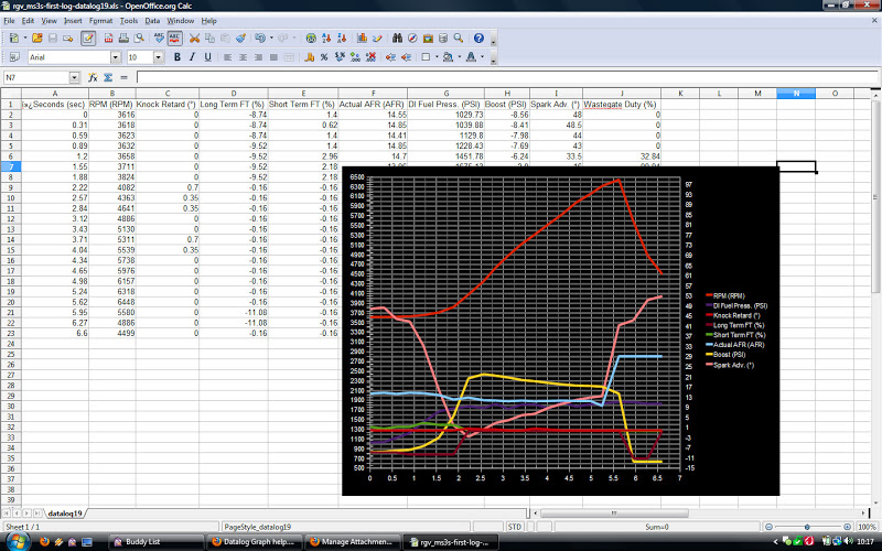

So I'm looking into doing my MAF calibration, now that the load cap fix seems to have messed up my stft & ltft's...
I'm wondering if someone has an excel spreadsheet that already has their datalog turned into a graph?
Although I'm not a newb to excel, I've never had to play with graphs and I'm hoping someone already has one they could send me, so I don't have to spend an hour or two reading up on it...
Or do you guys who've already calibrated your MAFs just do it from the raw data?

What version of office are you using? The main "trick" that took me a little bit to figure out is how to setup values on the 2nd axis.
In other words, the numbers that are super high (RPM, Fuel Pressure) need to go on the 2nd axis, otherwise you can't see what you're working with when looking at LTFT at values of -10 to +10.
If you have an older version of office, click on the little graph symbol, choose XY (Scatter), choose "Scatter with data points connected by smoothed lines without markers", then click finish. (The newer versions of office are similar as well, but you go to insert, then XY scatter).
Expand the graph to take up the full screen so you can see what you're doing, left click on the "highest" line in the graph (Should be RPM) then right click & say "format data series". The older versions of excel choose Axis-tab, then "secondary axis". The newer versions I think "secondary axis" is in the first tab that opens up.
Doing that will move the scale over to the right. Then your next highest value will be DI fuel pressure, do the same with that. Basically keep moving over the highest values to the 2nd axis (or just delete them if you don't care about them) until the ones you want to analyze are viewable.
I've seen some people do it where they get some of the values divided by 5 to scale down for readability, I'm not sure how they do that though. Maybe if someone knows how they could explain it here too.
HTH
You create a second column...then use a formula to assign the values in that column to equal the first column divided by five. Or whatever.
Example: Column A has values of 400, 300, and 200 in A1, A2, and A3. You then go over to column B, and use the formula
Code:
=A1/5
in cell B1. Cell B2 will have
Code:
=A2/5
, cell B3 will have
Code:
=A3/5
And so on.
Now column B has values of 80, 60, and 40 in cells B1, B2, and B3. Then simply use column B as the column the graph pulls its data points from.

Here you go...I made this for rgv_ms3...should still work for you
you can of course feel free to modify the graph in any way you want

Cataphract, how do I adjust the timescale on your graph?
My log is about 26 seconds, and if I just cut-n-paste my data over yours, it wasn't shown all 26 secs...
I went into the Select Data properties, but I didn't see the seconds/time in there...

Here's the info you need.
The Excel Chart and its Data Range
See the colored boxes? You want to drag & drop that little square in the bottom right hand corner of the colored box so that all your data is covered on the graph.
Example: You start out with this:
and end up with this:

wow awesome stuff again phate....sticky worthy?

Thanks a lot Phate... this should be a sticky in the CPU tuning section!
One thing that is helpful if you have data that needs to be scaled is to use a secondary axis.
After you have the data on the graph, right click on the line that needs to be scaled. Select format data series, then select secondary axis.
