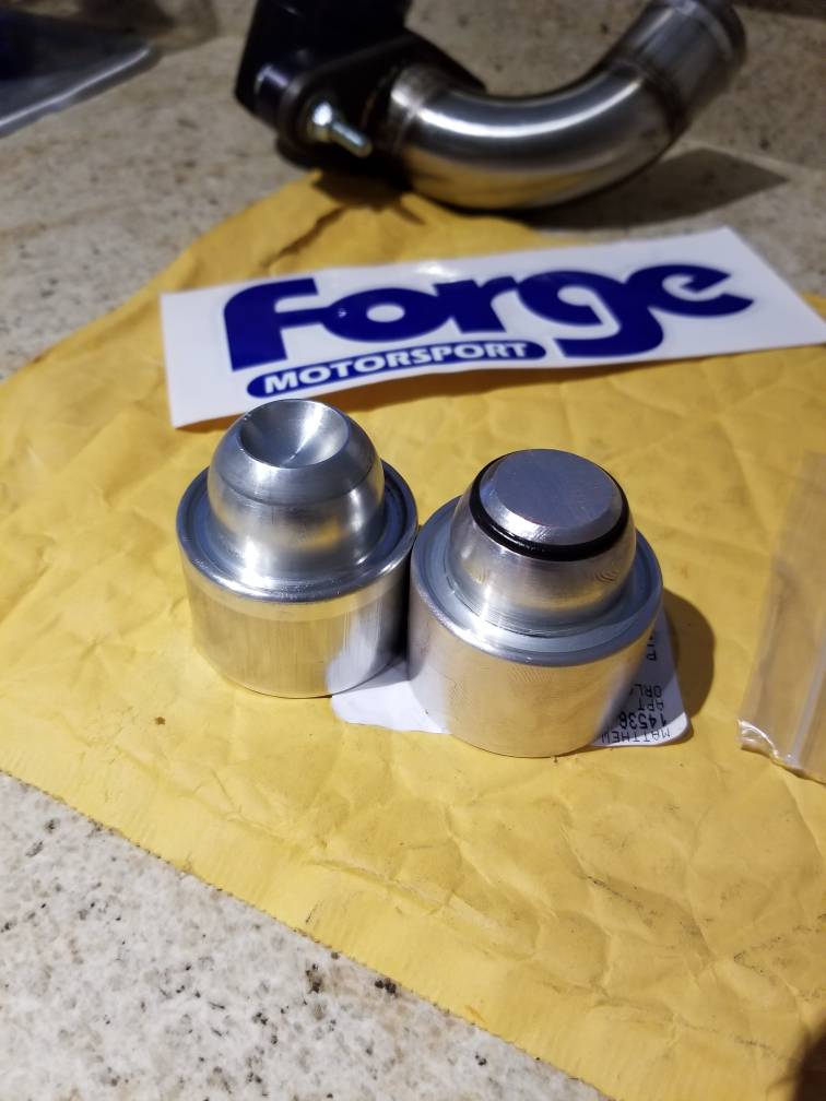

Let me ask those of you owners of this forge bpv, finally goy my bov and it came with blue spring installed, and it also came with 2 shims, is the blue spring sufficient or do you guys recommend installing the shims?

Blue spring 2 shims is the general answer you'll get but go with whatever works best with your setup. Also I'm curious what you piston looks like. I bought my bpv around 4 years ago and just recently got a rebuild kit for it and it looks like they changed a couple things about the piston.

Mine came with the yellow spring installed and no shims. I'm running the blue spring and no shims on 21-22 psi and works fine. The springs seem pretty underrated as the blue is rated 23-30 psi and fully opens under slight boost or almost vacuum.

My piston is the one on the right side in the picture, which i see it has better seal design than previous piston. What has me thinking is that the valve came with 2 shims and they told me on Forge that this was shipped in the old versions. I suppose that with the 2 shims the spring gets tighter but not like red spring.
Maybe this is why people use it with 2 shims.
