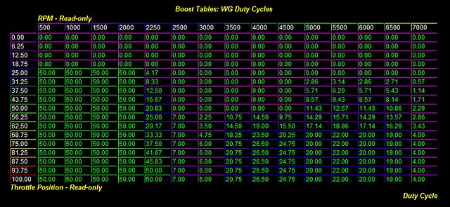

Can anyone enlighten me on how to change my wgdc if I'm not hitting boost targets in upper rpms?
I've asked @Fobio to come over to the thread and post his wastegate duty cycle map using the Grimmspeed 3 port bcs and a ptp wastegate actuator.

This is my last post in the my WGA/EBCS thread from Feb...as weather continues to warm, I continue to make minor changes to my WGDC...so the WGDC table is slightly different from my current:
It has been too cold to log for awhile, so eventho it was -8*C tonight, I had to go get some...
The last table from the post above gave my a bit of spikes into the 21.x @ 4000rpm...so I played with it a bit...and here's the table:
and here are the results...as close to what I'd like on the street as possible...there's still room for more tweaks...but I'm happy for now.
the is all under boost based tuning with 1.08.

Thanks @Fobio. It seems that gen2 ots tunes have been plagued with wgdc's pegged @ 100%, and from your chart, @ least we can be comforted that there exists a solution.
Extrapolating from @Dano2010 ' s 2x+10 theory on wgdc values vs logged wgdc, I'd say that 26.5(2)+10= 63 is a huge improvement. lol

You could do one of two things.
1) Tell @Amazon that you are worried about a pegged WGDC, and ask him to help you with your WGDC tables.
2) You could lower your wastegate duty cycles in small increments in the portion of the rev band you are uncomfortable with (at the expense of losing some psi) in ATR.
----you may also want to lower the boost target table in that same rpm range that corresponds with the pegged wgdc table by .5 pound while decreasing the above WGDC by small incerements.
FWIW, it seems that people are comfortable with 90-95% wastegate duty cycle for solenoid longevity sake.

 Old 04-12-2011, 11:04 PM   #115
Ckmazdaspeed3's Avatar
Location: St. Louis missouri
Posts: 2,077   (View Stats)
Rep Power: 1310
Thanks: 4,310
Groans: 134
Originally Posted by Nataphen View Post
The solenoid is the least of my worries. I don't care what is said or done on OTS maps, you won't convince me that 95-100% WGDC is safe for your turbo when you hit it and sustain it constantly at WOT. Whether our stock BCS is at fault or not, it doesn't change the fact that your turbo has 100% of the hot exhaust blowing through it.
If I constantly see over 90% sustained, I back off. You guys have to remember, this little turbo will only do so much. It is not efficient even at stock boost in high RPMs. After about 5k-5500RPM, unless you want to risk blowing the k04, you may as well be ready to back the boost off to 15-16.5psi. I'm going to switch to the Grimmspeed EBCS and see if that helps, but at 6k+ RPM, I seriously doubt it.
Here are the results of a semi-tuned grimmspeed ebcs. This fucker is a bitch to tune! I have tried Christian's suggestion of very small BD parameters, but I can not hit target boost with them. This is the only way I can hit target boost (see BD). Also, either way, I have some pretty noticeable boost oscillation... to the point where I am convinced I am getting mad KR (which is pulling timing and adding fuel), but it turns out KR is at 0, but boost is vacillating. I need help! Once I get this tune dialed in, I can dyno and be done with this fucking ko4!
The only other problem that I am having is that I am getting some boost spikes up to 22psi! They are very quick, and disappear within 1 to 2 cells of data (and they never produce any KR).
Anyway, on the plus side, I can hit higher psi with less WGDC throughout the power band, and over 19psi past 6k without 100%!
My mods (that matter) are fmic/ram air, pump, catted dp, ap (with ots tune that has only had fuel, boost, wgdc and bd adjusted) and of course, the ebcs.
Oh, and FOBIO, think you could post up a couple logs and maps of your wgdc, bd and boost targets? It would REALLY help me.
Last edited by Ckmazdaspeed3; 04-12-2011 at 11:15 PM. Reason: Get FOBIO'S attention!

 Old 04-13-2011, 06:59 AM   #117
@Ckmazdaspeed3 , you might try posting your situation in this thread...
The grimmspeed is too fast to let the BD table have a great deal of authority, and their a few guys in the thread with lots of 3 port experience.
Also, Fobio has a ptp wastegate actuator with a different spring pressure, so just keep his mods in mind when looking @ his tables.
http://www.mazdaspeedforum.org/forum/foru...tml#post804590
Ckmazdaspeed3 (04-13-2011), Nataphen (04-13-2011)

Ck, you should pm Dano, and look through his boost tuning thread, as I believe he has the 3 port also. He has his maps/logs posted throughout that thread.
http://www.mazdaspeedforum.org/forum/foru...-thread-75524/
Great news about the grimmspeed, ck. I was hoping that it would help, but I just wasn't expecting it to, LOL. I'm all over 19psi to redline at less than 90% WGDC!
Fucking awesome, right!
Could you post your wgdc and bd table? I want to see how your getting there. I'm guessing your boost is more steady than mine?
