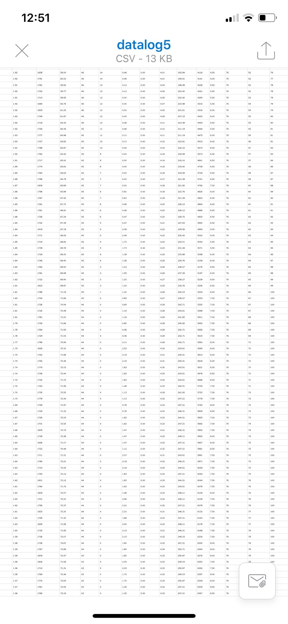

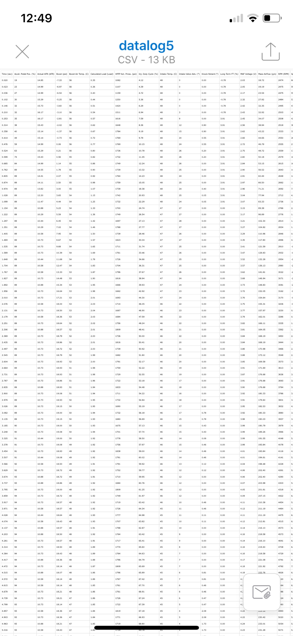

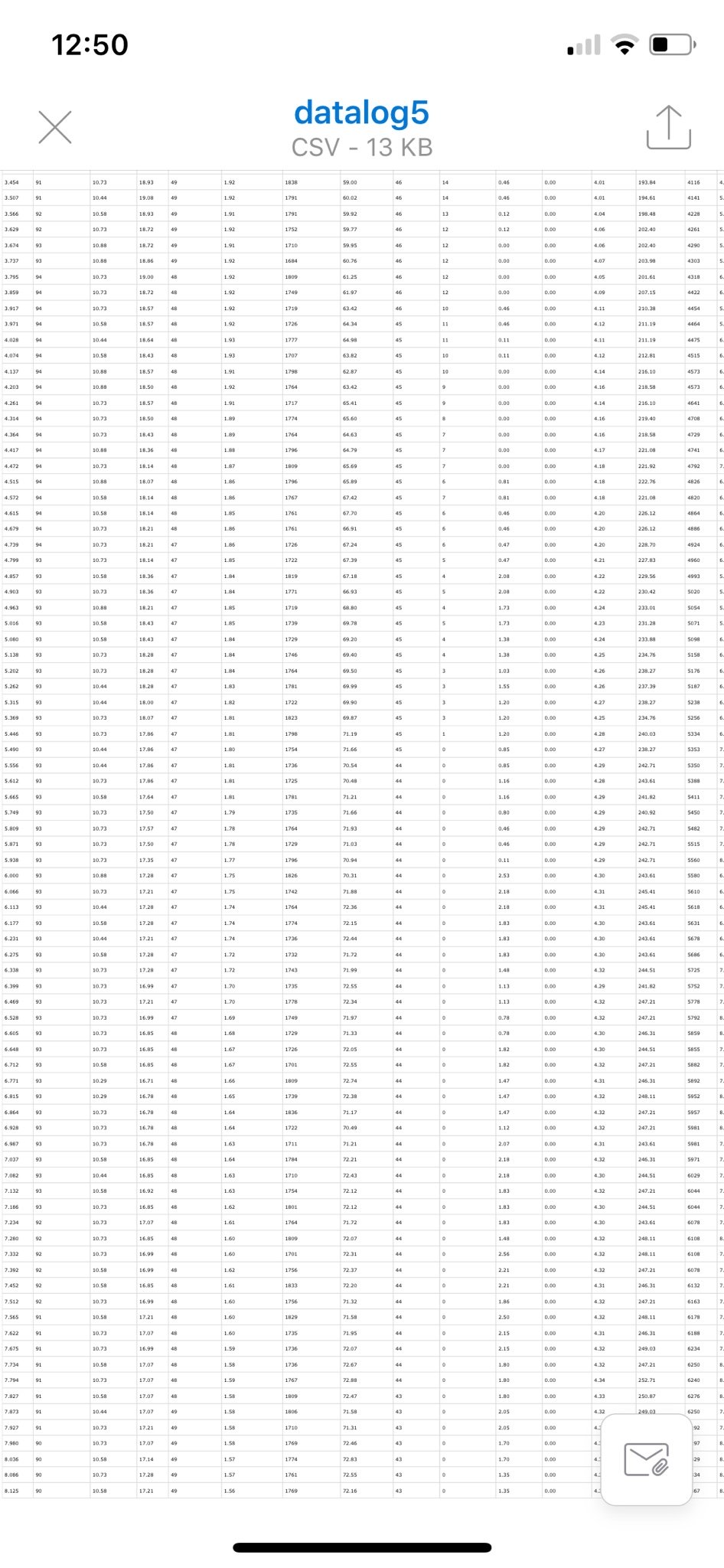

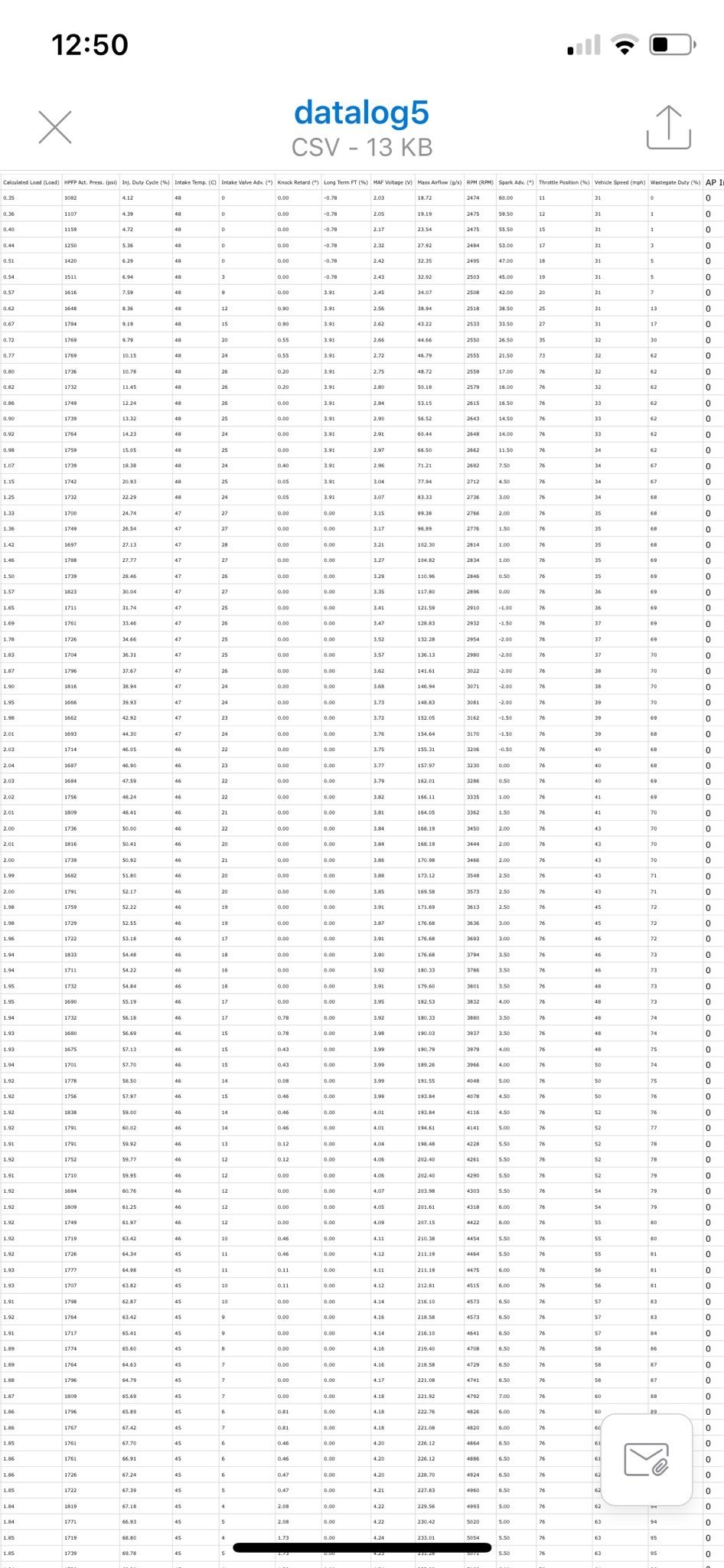

Hi I’m having an issue with high rpm knock retard I’m not sure what the issue is I’m currently being tuned by DizzyTuning and at first I was having a serious fuel cut issue at 5k rpm and that turned out to be my fuel pump internals were seized inside the pump so I order a brand new pump and brand new Autotech internals and swapped out the pump and fuel cut stopped.
Now my tuner is saying he’s seeing detonation up top which is hurting my power and also my boost is lower than he’s targeting (19.5psi) which could be due to a boost leak I recently installed XSPower turbo manifold and I checked it turned out 2 of the bolts were loose so I took them out put lock tight on them and tightened them they haven’t come loose again.
Anyways I have no idea what’s causing the problem I took some logs after I fixed the manifold on the latest revision from dizzy.
