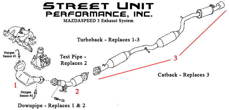

I'm probably going to get torn to pieces for this post since at some point in history it's been covered. Screw it, I'll ask again.
I'm new to the MS3 and am not familiar with turbo'd cars. What is a testpipe, racepipe and downpipe? Do you have/need all 3? Are all 3 street legal? I'm trying to gather my list of future mods for the '12 I picked up yesterday.

Test pipe and race pipe pretty much the same. Downpipe is from turbo to first cat, I think.
My test pipe replaced cat #2.

Test pipe/race pipe (replace 2nd cat) are used interchangeably and a downpipe is from turbo to cbe usually replacing stock dp and 2nd cat
1 thing to add, aftermarket dp's can come in short style(only replaces #1) or long style(replaces #1 & #2).
