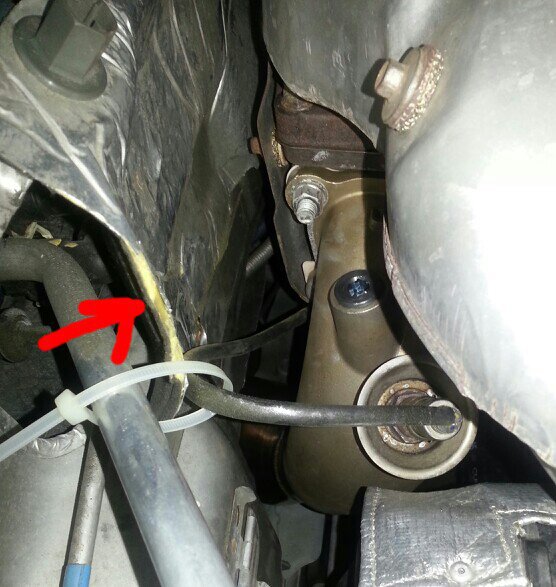

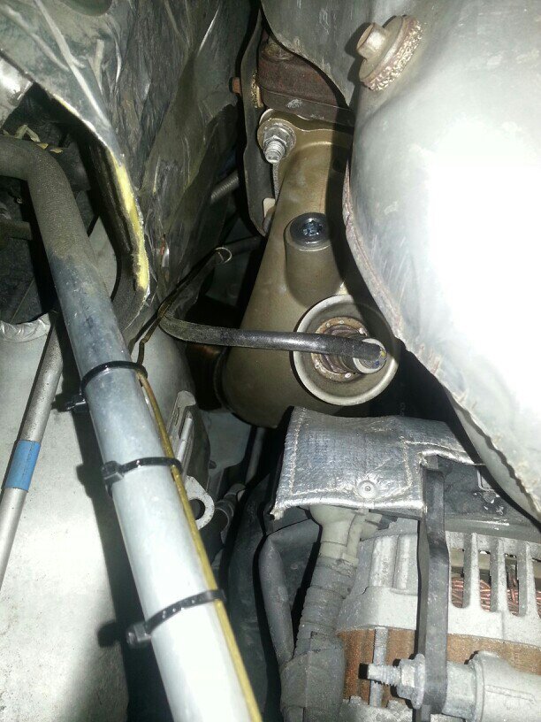

The downpipe is in now, I still havnt found a good way to keep the wire from the O2 sensor out of harms way. The zip tie I decided to use for now is tearing at the heat shield that sits behind the turbo, so this is the first thing I want to fix. I put a red arrow in the pic where its rubbing.
Whats the best way to have the primary O2 sensor cable routed to keep it from getting harmed?
Question 2 is, should I stop worrying about the under-belly heat shield I tore up removing the old downpipe? I'm worried it will get wet, retain water and dirt, start rotting and spread.
Last concern is the donut seal that mates with the catback, there is a gap between the flanges but it seems to be sealed properly. Does the cobb downpipe have too long of a dick for the donut gasket to sit on? I'm woried that its hitting the OEM catback and not allowing the flanges to meet.

Man. Should have made a little slit in the head shield to run the sensor through. Just my .02 cents

O2 wire looks fine , fuck the heat shield on the bottom ...and as long as downpipe seals who cares .... Enjoy
I'm more concerned the zip tie I'm using will scrape away the insulation shit and make a mess at this point, the wire seems out of the way. I guess I'll add more zip ties to keep the one holding the wire from being so close to the shield

Took a clothes hanger and made a small coil on one end that I fed the o2 cable through. Zip tied it to the AC line, it goes down a good foot and keeps the o2 wire well out of harms way. Will keep tabs on it after every drive to make sure its staying in place.

Or you could do what I did and take the two nuts off the heat shield and put the wire behind it.....

The one that is against the firewall (in my picture it would be to the left)? I didn't even look to see how easy it is to remove that. Thanks

Yeah that's what I did. There only 2 nuts holding it on
