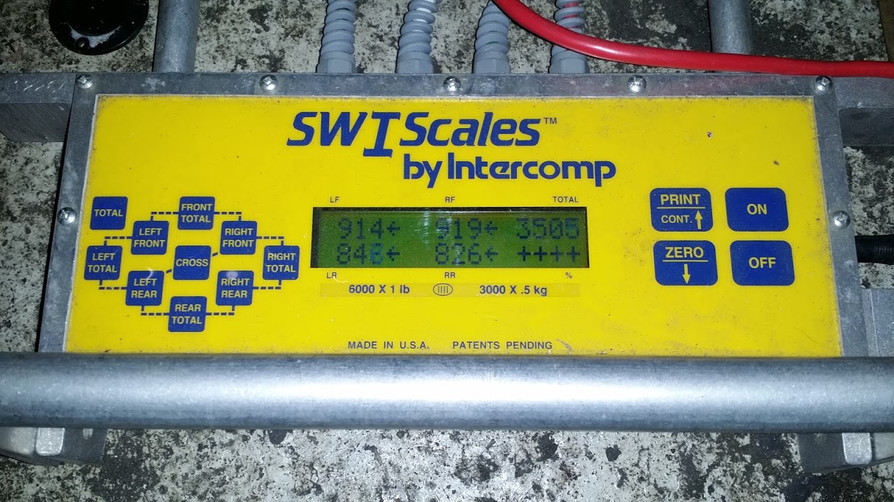

Bonus: Corner weighed stock genPu MS3, full tank of gas, TRMotorsports C3 17x9 wheels, Hankook V12 255/40-17 tires, and a small 8” ZoomBox-cased sub in the driver side trunk cavity + small 1ch amp in place of stock spare-mounted sub (both weigh 25lbs at best):
Without driver (3311 lbs): https://lh3.googleusercontent.com/-t...4_175351-1.jpg
With 194lbs fat ass driver (3505 lbs): https://lh3.googleusercontent.com/-f...024_175836.jpg
