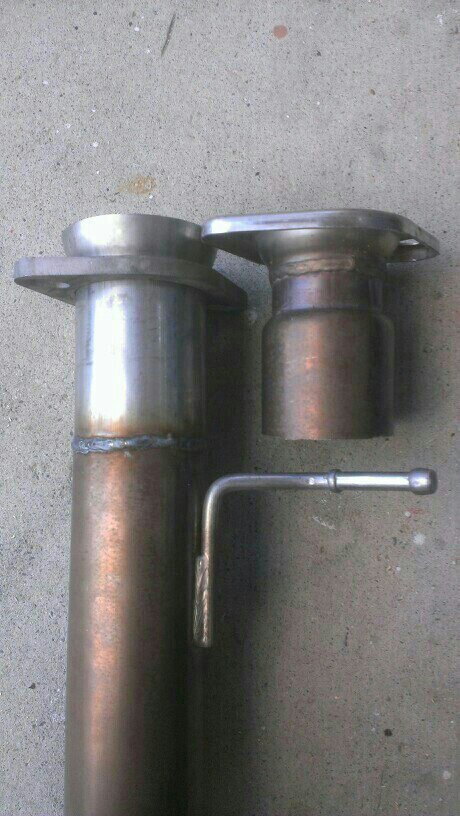

Many of you who own a Magnaflow know that the design has one big flaw. The flex pipe flange that connects the catback to the racepipe has an opening that is only 2.4 inches wide. This is smaller than the stock exhaust and causes an exhaust flow restriction on a pretty nice aftermarket exhaust that purrs like no other. Some maybe turned off by this since it's not a true 3" exhaust but I have discovered a piece that will fix this issue while remaining under $600 shipped.
This issue has become quite annoying to me so I took action and looked for a part that would fit the stock racepipe and an aftermarket pipe like my Ultimate Racing. My searches led me to this item in the link below. It's a 3" flange that welds perfectly to this magnaflow. It costs $38 shipped and includes a male flange that you really don't need but could be useful to some. This is the lowest priced high quality flange I could find. Magnaflow sells their own but it costs $119 for the same thing. For those who want more info the Manufacturer: Flangex and part: FX8054
3" ExhaustConnector
This is a picture of the new flange directly on top of the old flange. The red outline shows where the old flange opening begins.
Now for some of you like myself who don't have tools to cut and weld a pipe, shop around and find a good quality shop the labor should be cheap and easy. My guy did it for $30 dollars and it only took 10 mins. Here's the finished peice.
Here's pictures looking through the pipe at the openings at the other end (old vs new). The new one as you can see is straight through without restriction.

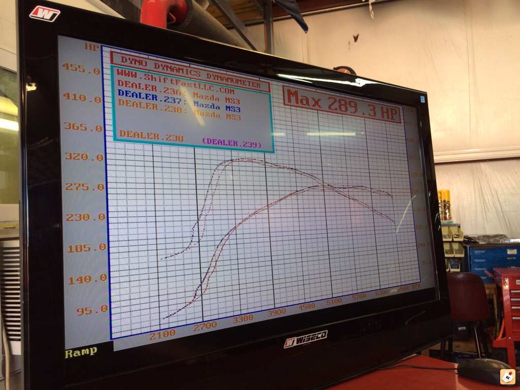

I was not expecting much of a difference between the two but I was wrong. I took some logs and can clearly see my cars is running better without that restrictive piece. The old piece appears to have been causing my car to miss its boost targets. I'm not running a downpipe so any back pressure relief helps a lot. Before this was installed I was hitting 17 max psi trickling down to 16, now I'm hitting 19 psi trickling down to 17. My VD is showing an increase in HP and torque. FYI, this is my absolute best VD out of 15 logs for my old Mangaflow vs my second run out of 2 on my new one, all logs show the same trend (so I'm not crazy). ALL WERE DONE ON THE SAME MAP, SAME ROAD, ETC. Also, for those that are curious about sound it is a small bit louder which is welcome from a relatively quiet exhaust.

Thanks for the thread @rustysurfsa; I didn't like the restriction either, I went about it a little differently. I went to a muffler shop and they heated the restricted spot of the pipe, and then threw it in a hydraulic pipe expander looked completely open after he was done, no cutting required, the shop owner didn't even charge me - he was like it was fun and it wasn't a big deal - Price = $0
Granted most people won't have access to a awesome shop like the one I went to but maybe this will help someone.

Didn't know that was possible. Any pics of the finished product?
No sorry I don't - I had some pics on my old phone, it had problems so I lost the pics :-(
I do have a dyno pic though after it was done and tuned though.
Tapatyped
Pretty awesome we have about the same power results with the same mods basically

Dizzy Tune in progress...
