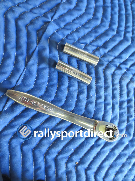

Here’s a list of the tools you’ll need to do this yourself:
3/8 ratchet
Sockets: 19mm, 17mm
Wrenches: 19mm
Torque Wrench
Jack, Jack stands, or lift

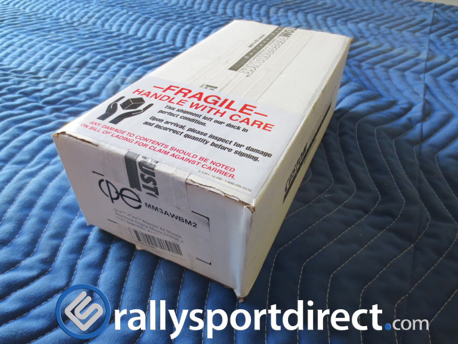

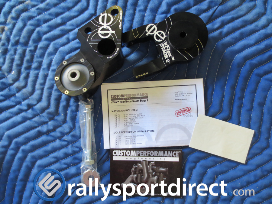

This is how your mount will come packaged. I am really impressed with CP-E and their attention to detail. Their product packaging is an obvious example of this. You know when a company takes time to package their products this well they really care about what's inside.

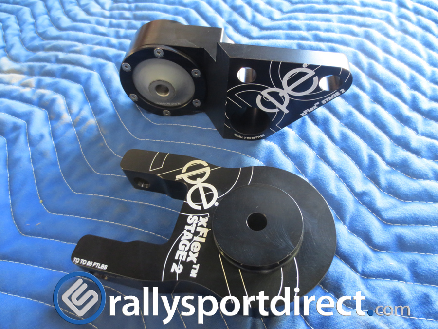

When you pull everything out of the box you will be in awe at how badass this mount is. Everyone here was thoroughly impressed when I was opening ours up for the install. CP-E includes awesome color instructions, hardware, a sticker, thank you card and they even have an employee check off each part that goes in the box and initials. I am very impressed with their attention to detail. No one likes being in the middle of a project to find out not everything was included in the package. You won't have to worry about that with CP-E.

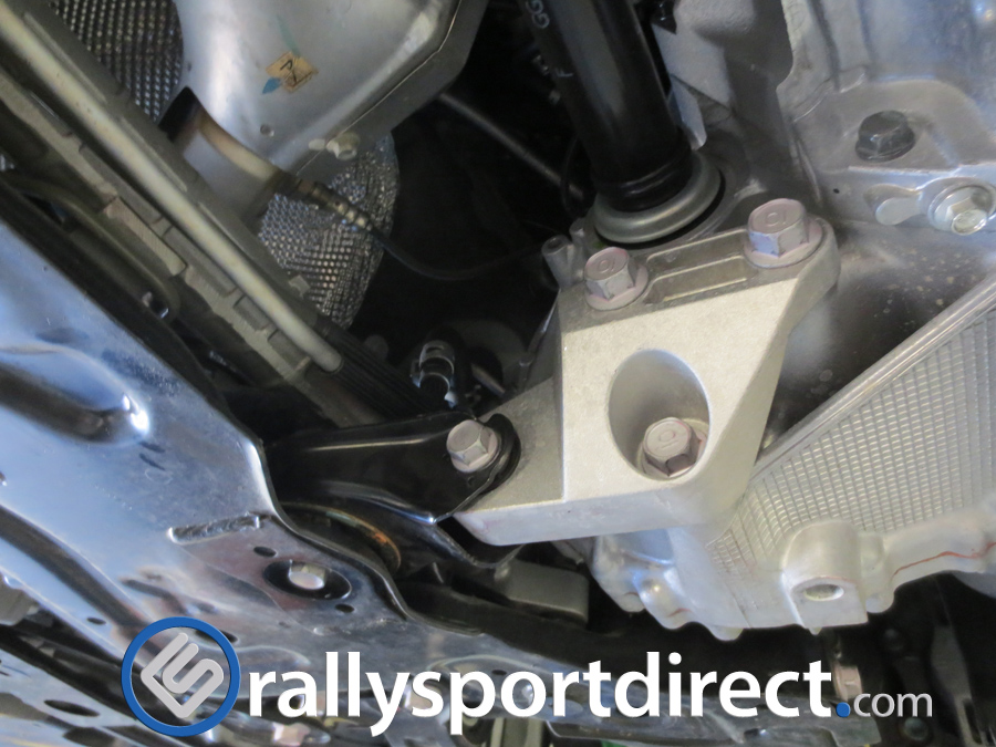

This install is very easy and anyone can do it in less than an hour if you include time to get the wheel ramps or jack stands out and the car up on those.
Pull out your sockets, ratchet wrench and box end wrench.

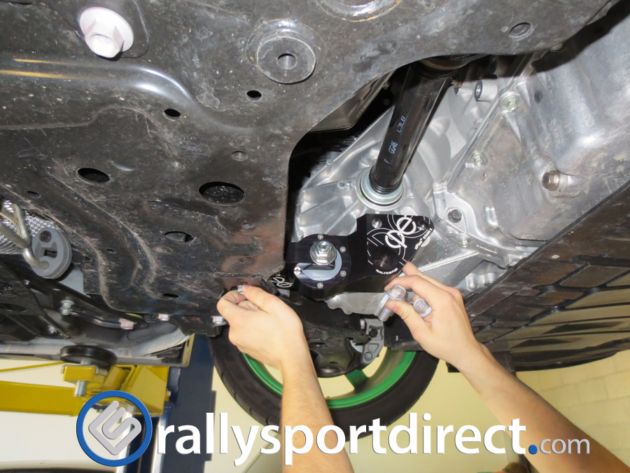

Here is a shot of the stock mount before being uninstalled. Very easy to access all the bolts and no need to worry about supporting the engine when removing this.
Go ahead and pull out the 3 19mm bolts holding the mount to the transmission and the 2 17mm bolts that are left. Set your stock mount in a dark corner of your garage because you will never want to install it after the new ones in.

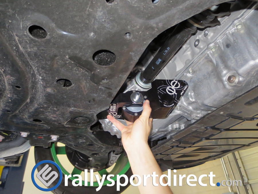

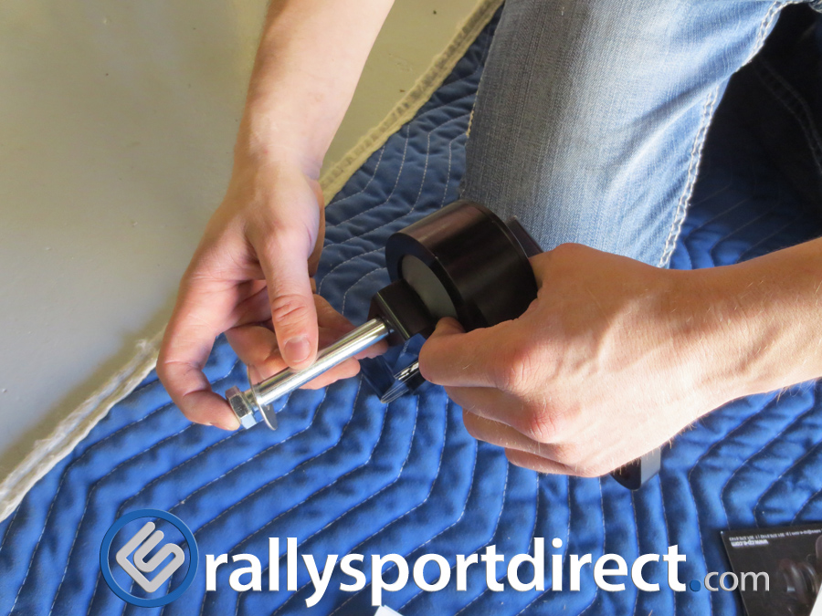

Prep the new mount by taking the long bolt and putting a washer on it before inserting it through the CP-E mounts.

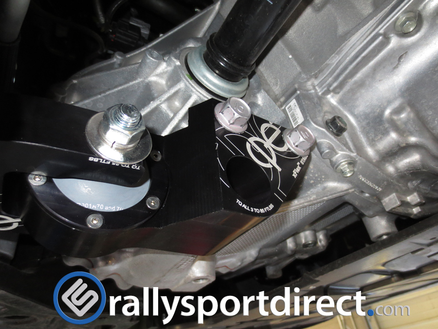

This part is pretty self explanatory but slide the rear portion of the mount into the crossmember.
Go ahead and toss 1 of the 17mm bolts you just pulled out of the stock unit back in and set the left over one with your factory mount. Install all 3 19mm bolts back into the front portion attaching the mount to the transmission.
The tolerances are very tight and didn't see starting with one bolt versus the other to really matter but you might have to put a little pressure up on the engine to line up a few of the holes before the bolts will go in.

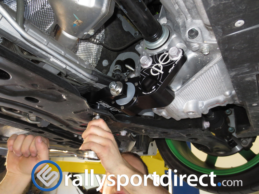

Ensure you take the 2nd washer CP-E includes and put it over the end of the bolt before installing the lock washer and bolt.
Snug up all the bolts.

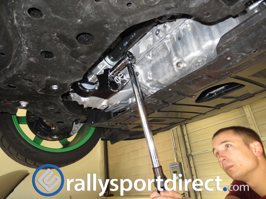

Grab your torque wrench and set it to 85ft/lbs and torque all 5 bolts down. You will need to grab your 19mm wrench and hold the head side of the bolt while you have the torque wrench on the nut side to get it to 85ft/lbs.

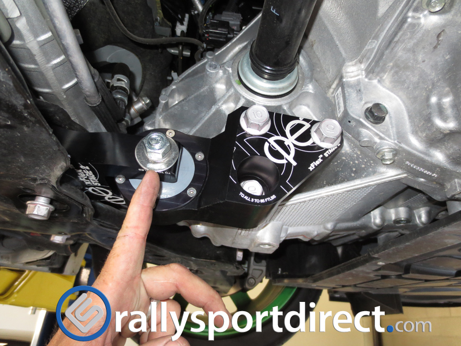

Here is the finished product. This mount looks amazing on the car!
