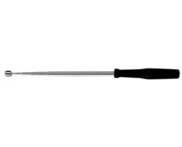

I forgot to mention I swapped the 4 10mm nuts with different ones that have a bit more locking power to them, almost like a lock nut. I'll use loctite for sure though.
Thanks for the idea about the magnet. I'll fish it out myself that way lol

Yup that was the tool I was thinking of. Ill need a trip to harbor freight lol
I was thinking of one that was a bit more "snake-ish" to get in there real deep like

I have a magnet like this and its too large to fit in the hatch.....Any other ideas ?
