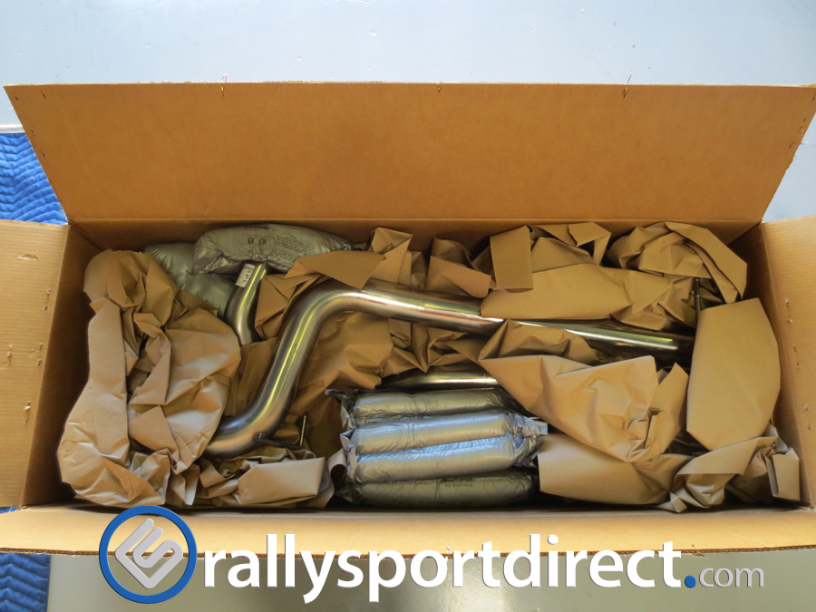

As always great packaging and presentation by CP-E.

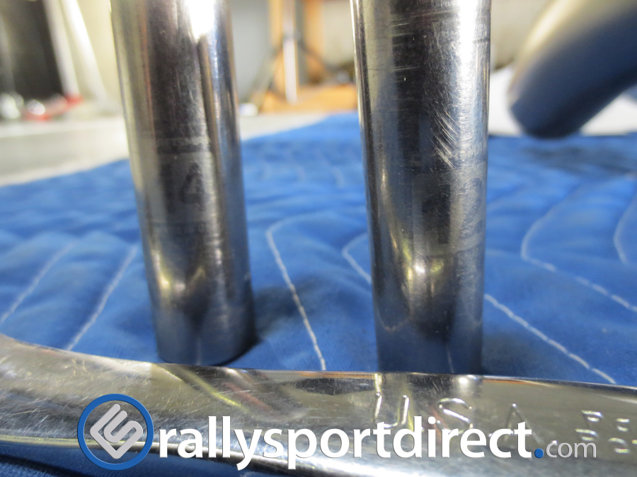

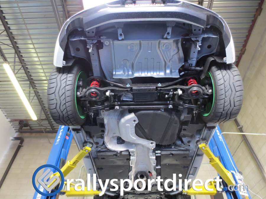

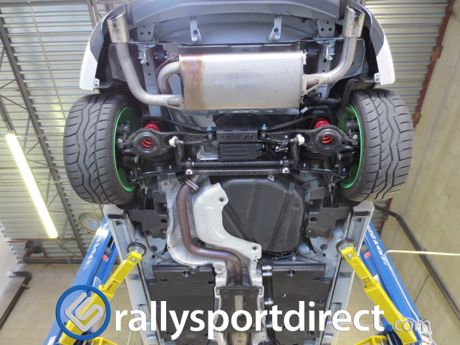

You can either do this installation on a lift or with jack stands. Luckily we have a lift here at work which always makes working on cars easier so I opted to take advantage of it for this install.

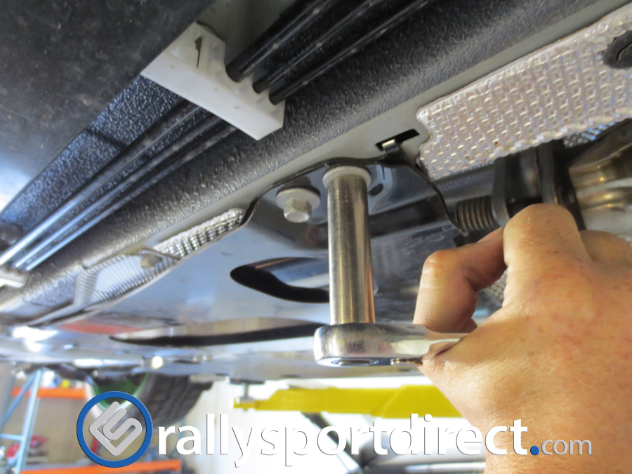

To remove the factory catback you'll basically only need a 12mm and 14mm socket and ratcheting wrench.

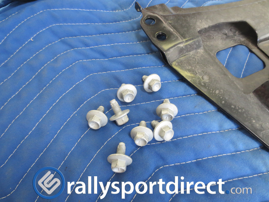

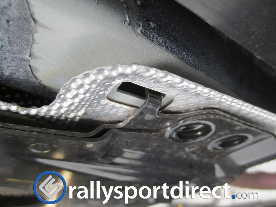

Start off by removing the mid chassis brace by removing the 8 12mm bolts. The brace has some hooks on it so you'll have to slide it back before it will drop down and off the car.

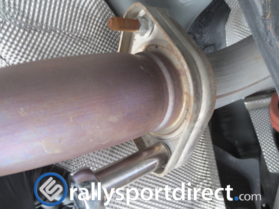

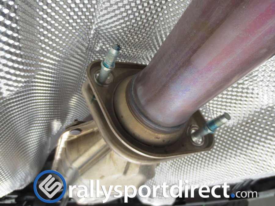

Use your 14mm to remove the nuts from both axleback and midpipe.

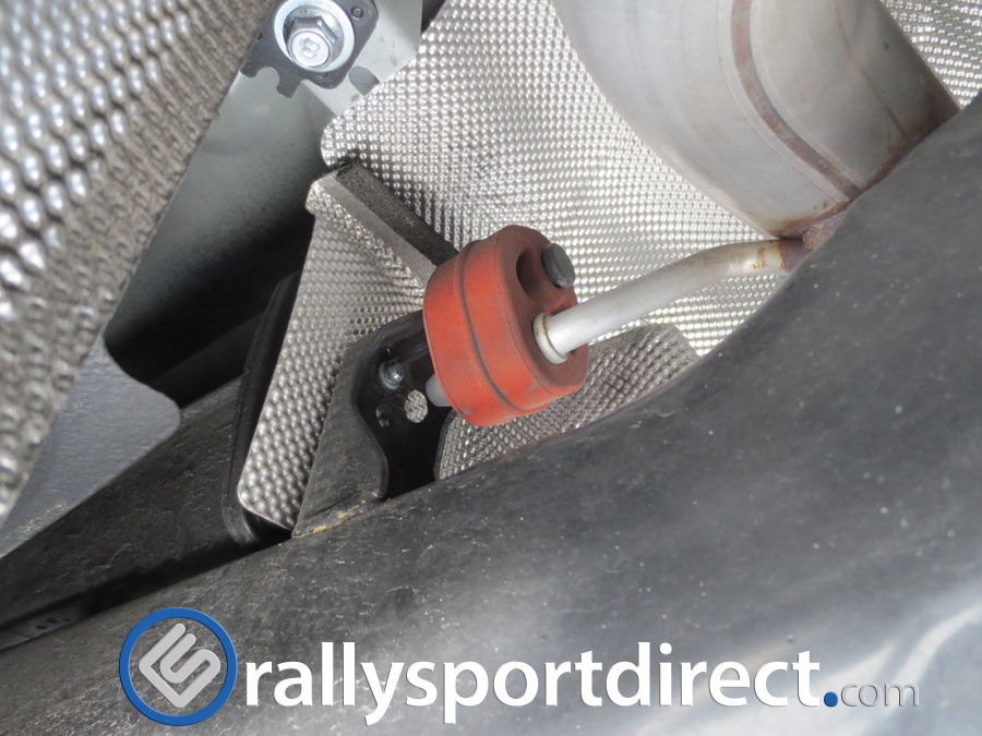

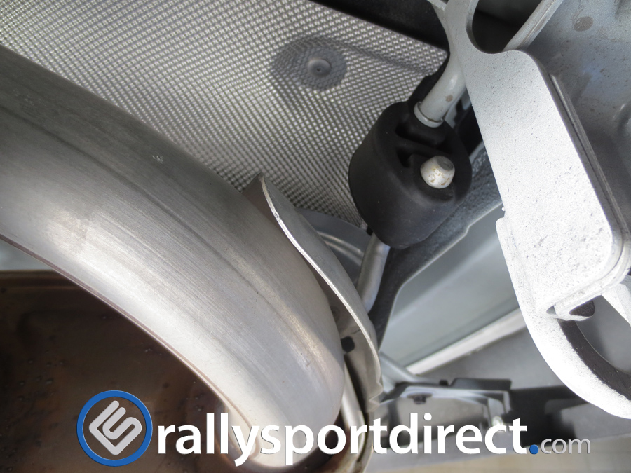

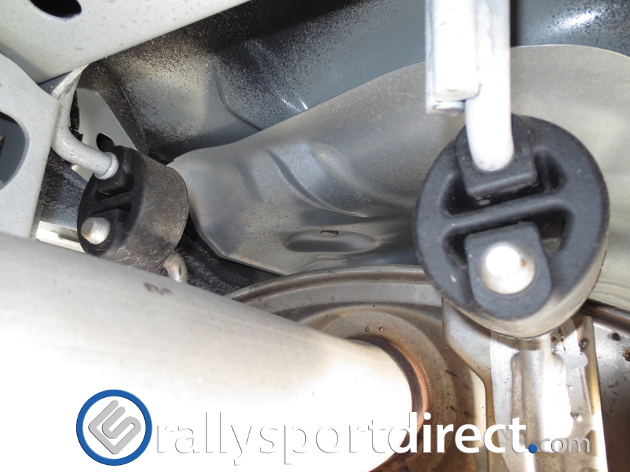

Next you'll disconnect the exhaust hangers and drop the factory system out of the way.
Here is the car with the factory catback uninstalled.

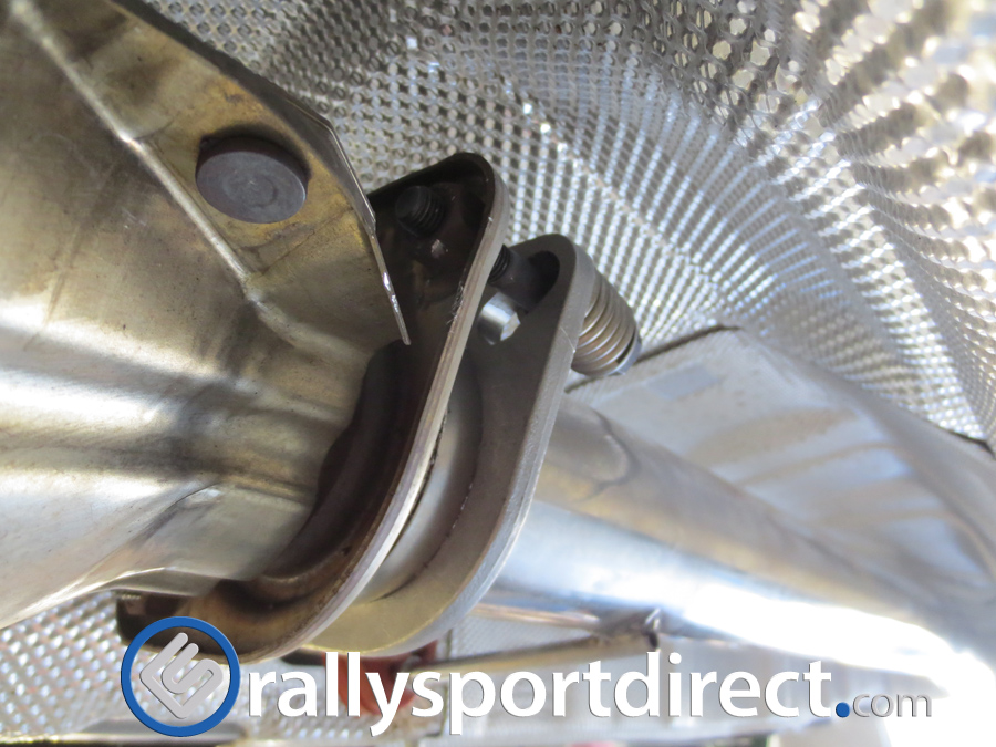

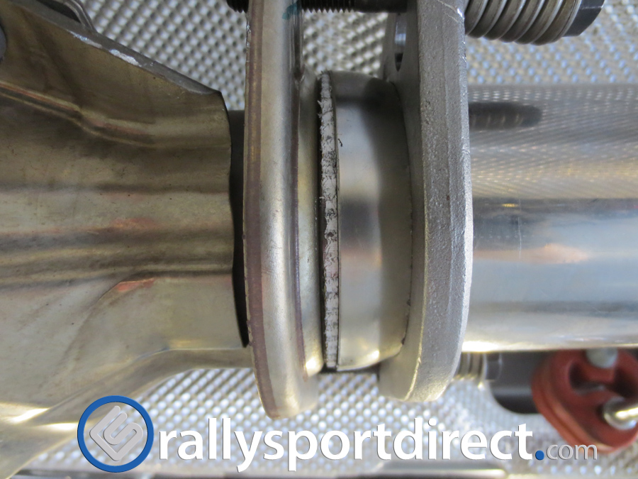

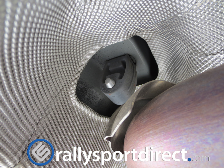

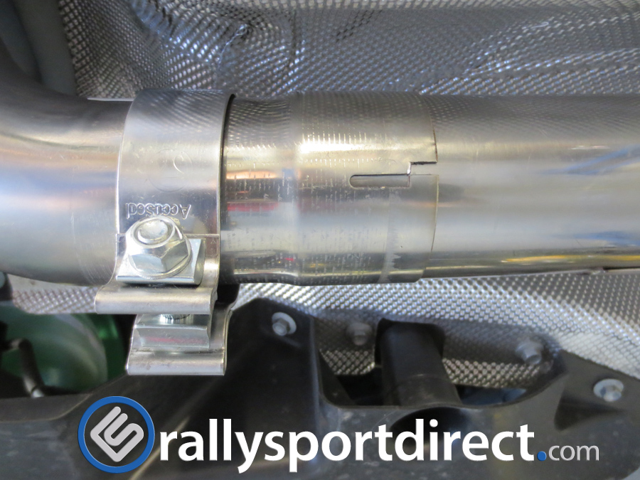

To install the midpipe, when connecting it to a factory downpipe or factory style you'll need to remove the stock studs and connect using the supplied bolts and washers and reuse the factory springs.
To connect the axle-back and midpipe you'll need to install the 3rd pipe in the kit that are slip fit connections with clamps.

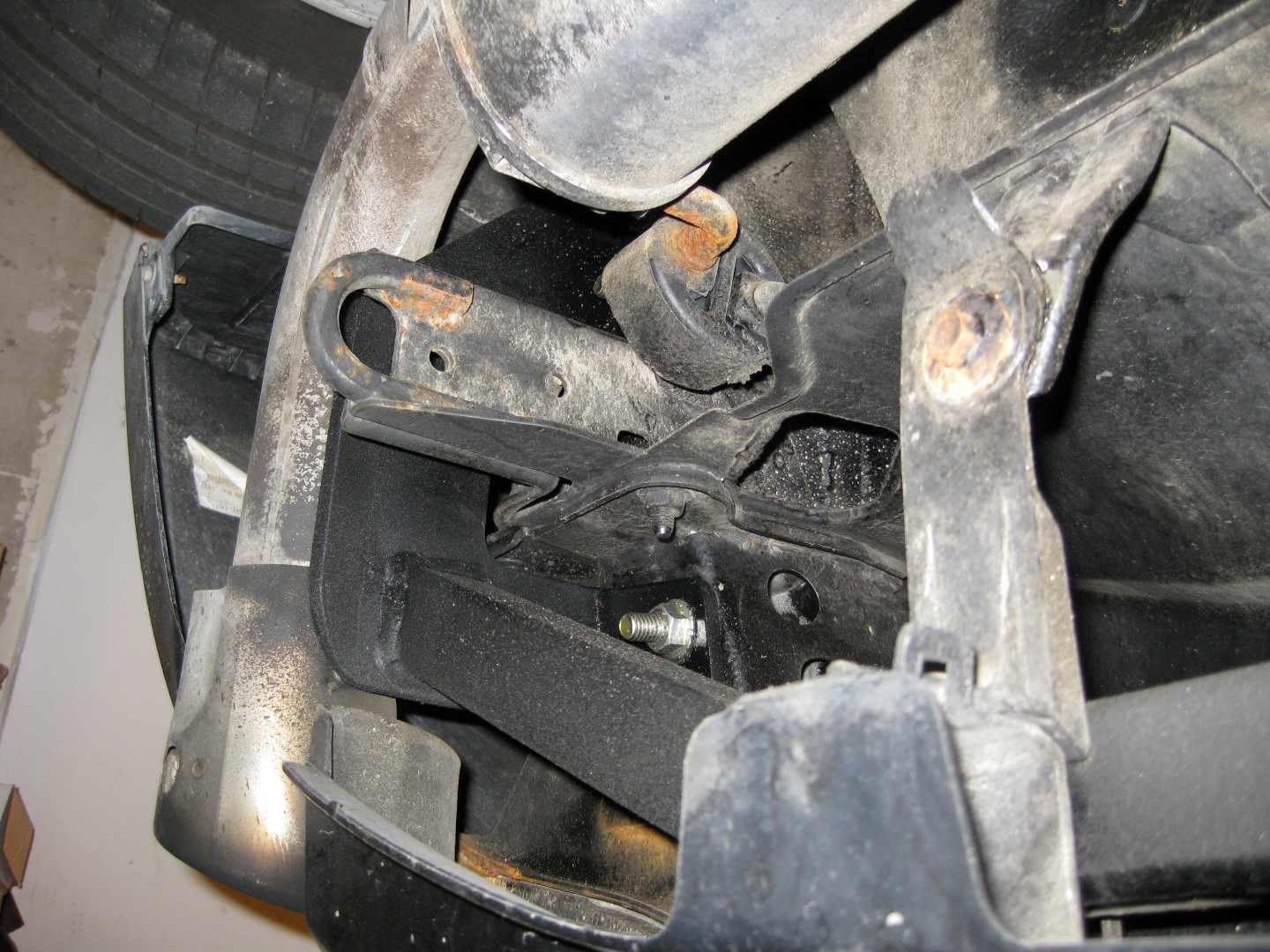

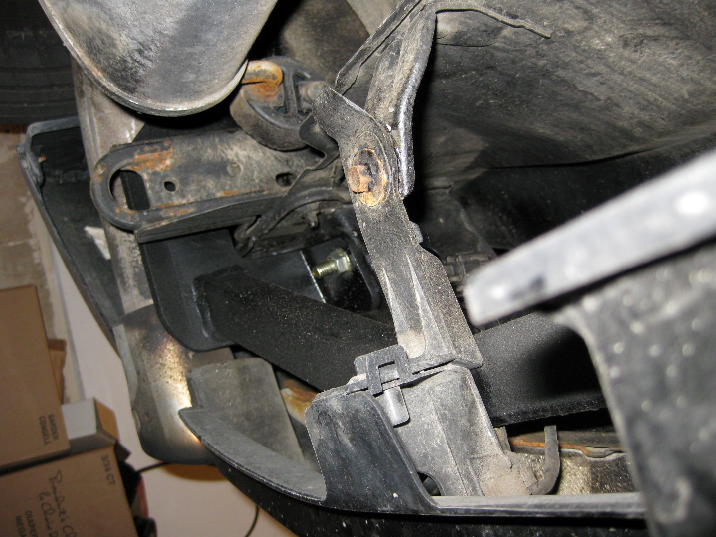

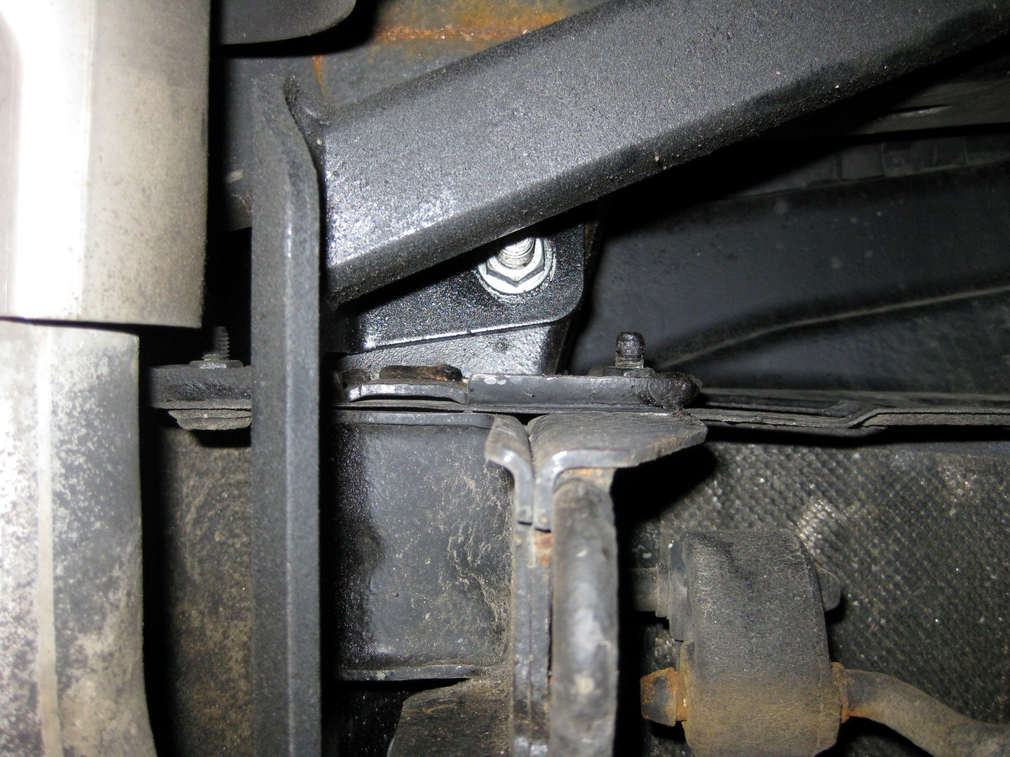

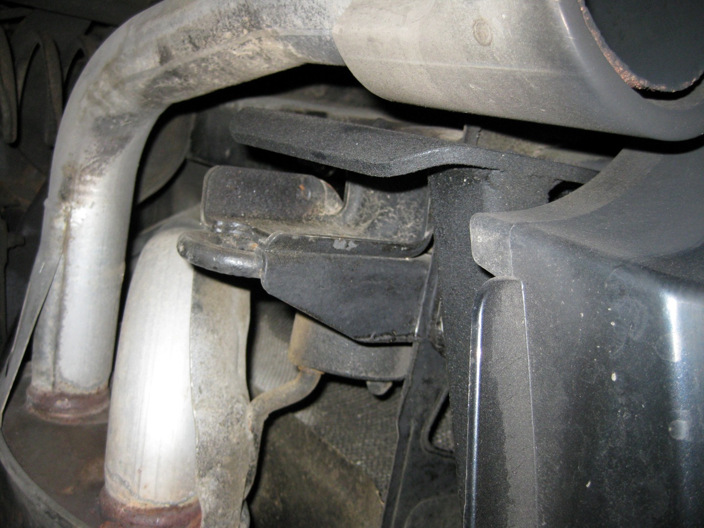

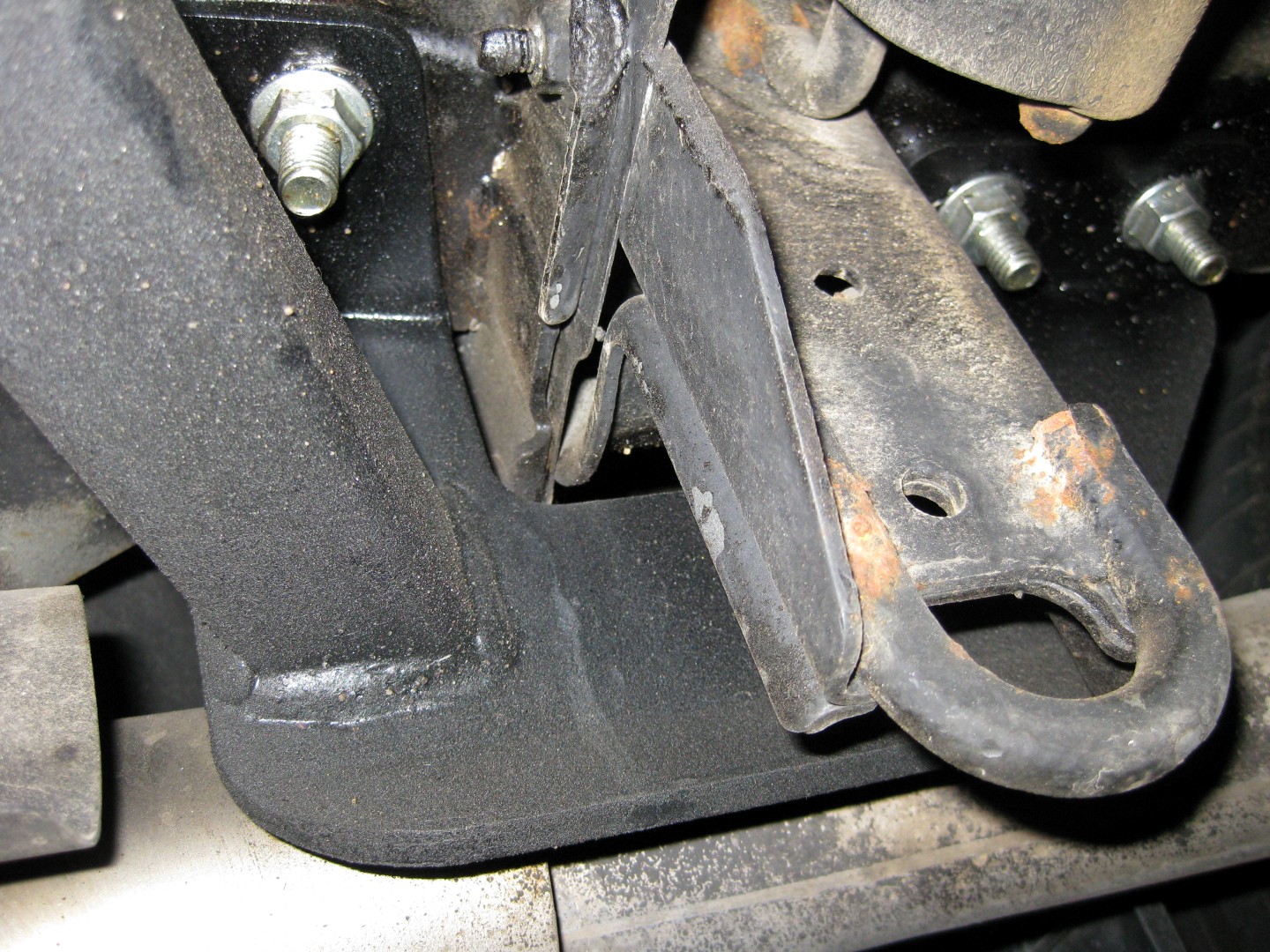

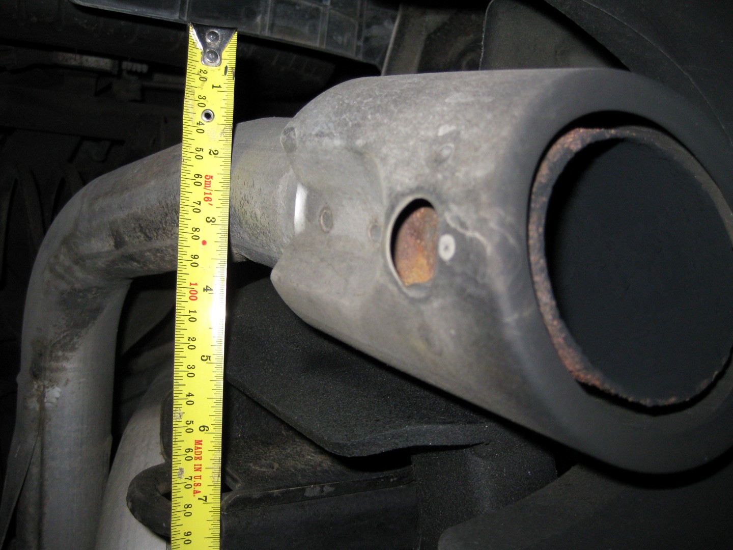

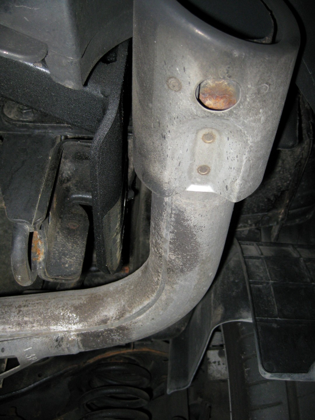

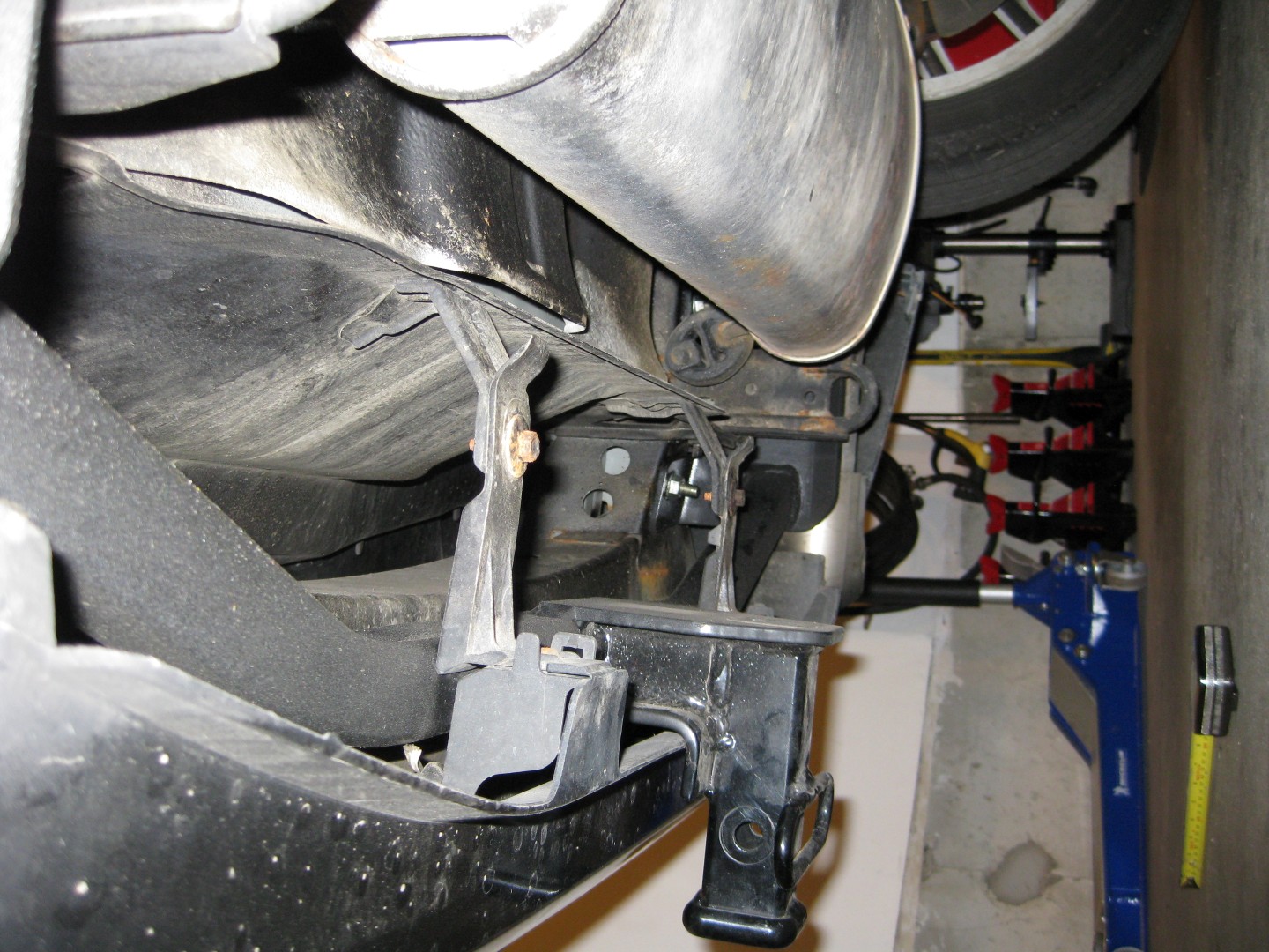

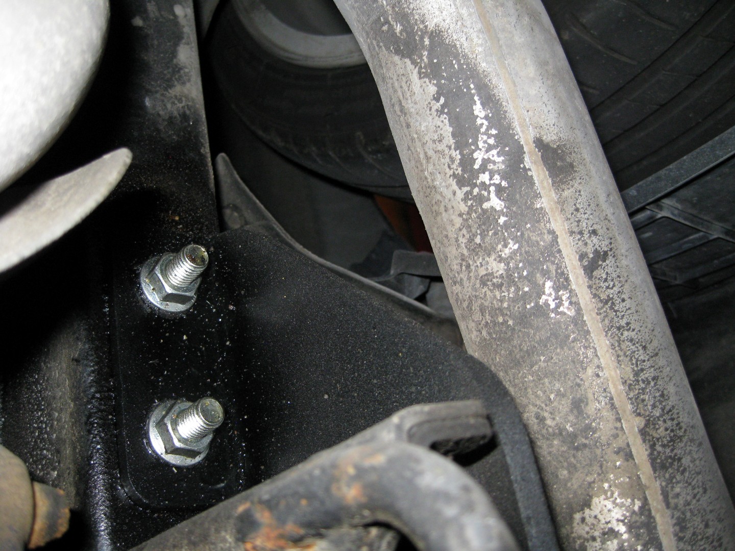

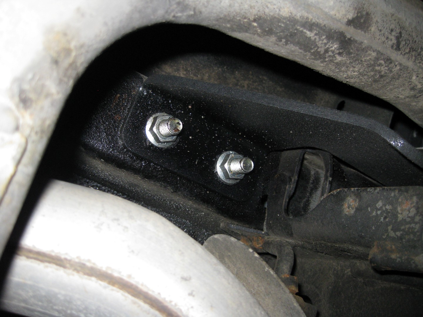

Bonus points if you can confirm fitment of this exhaust with a Curt 11383 hitch installed I'm on the hunt for a catback that will fit with my hitch.

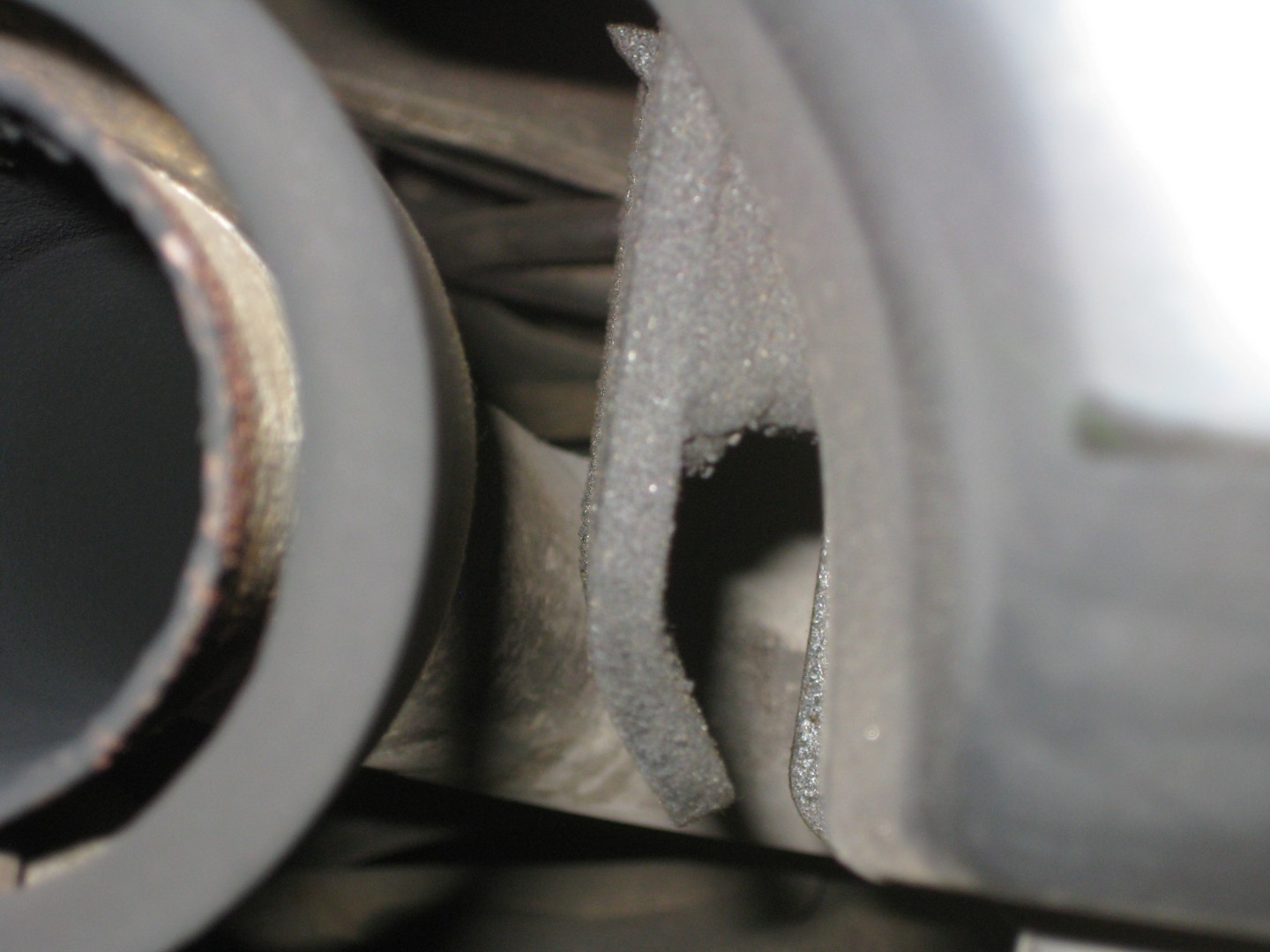

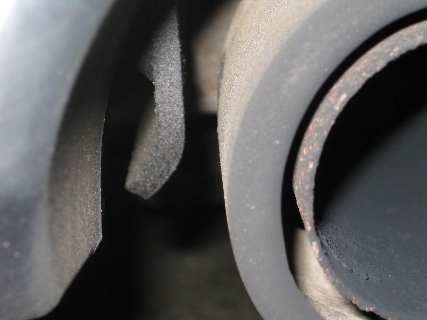

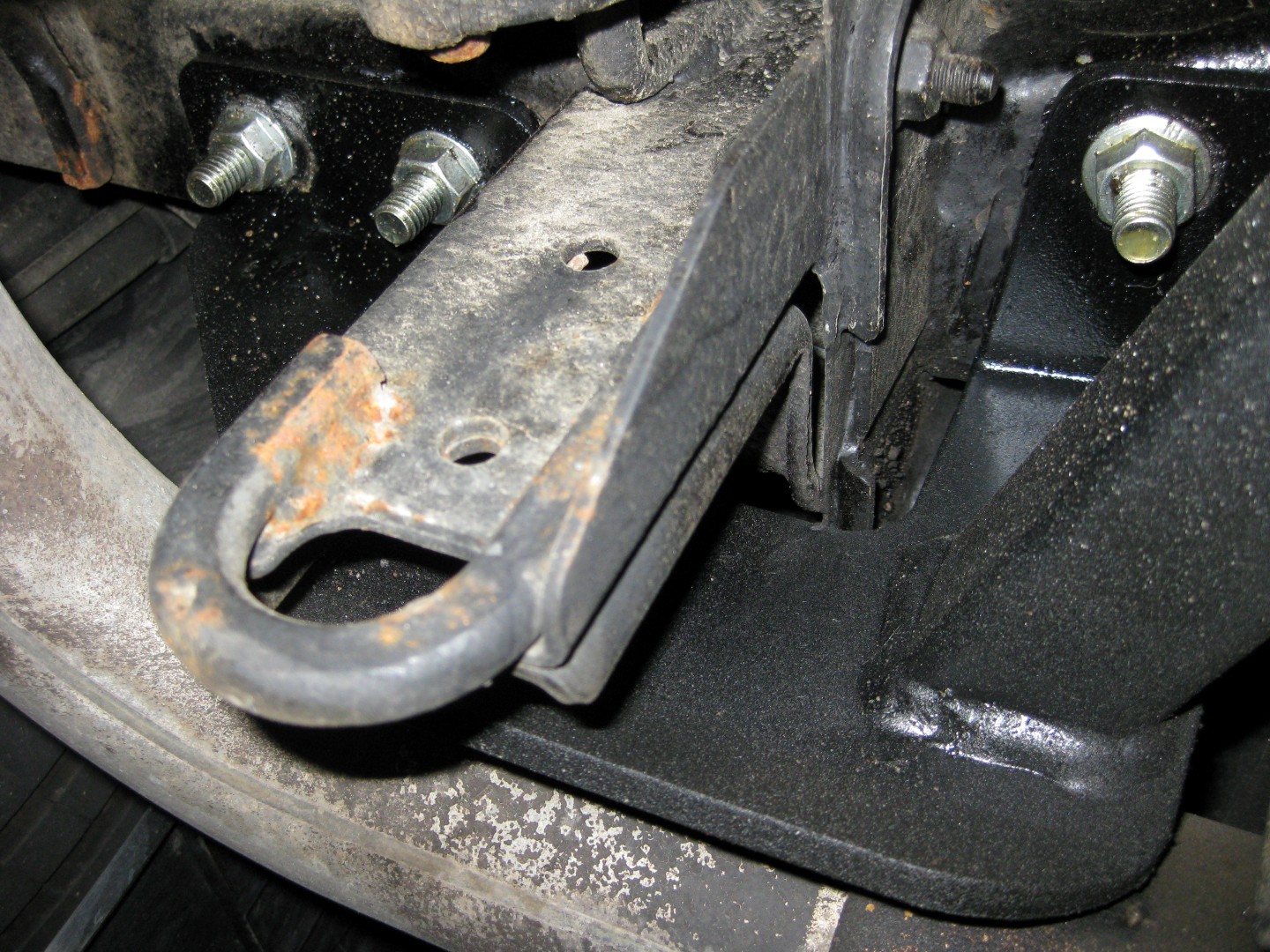

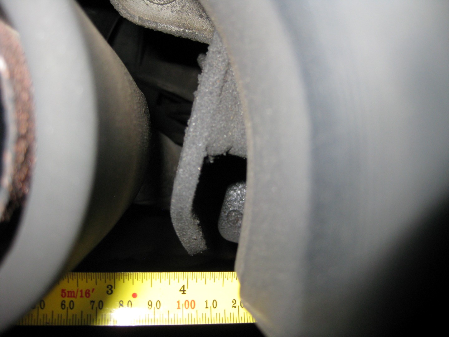

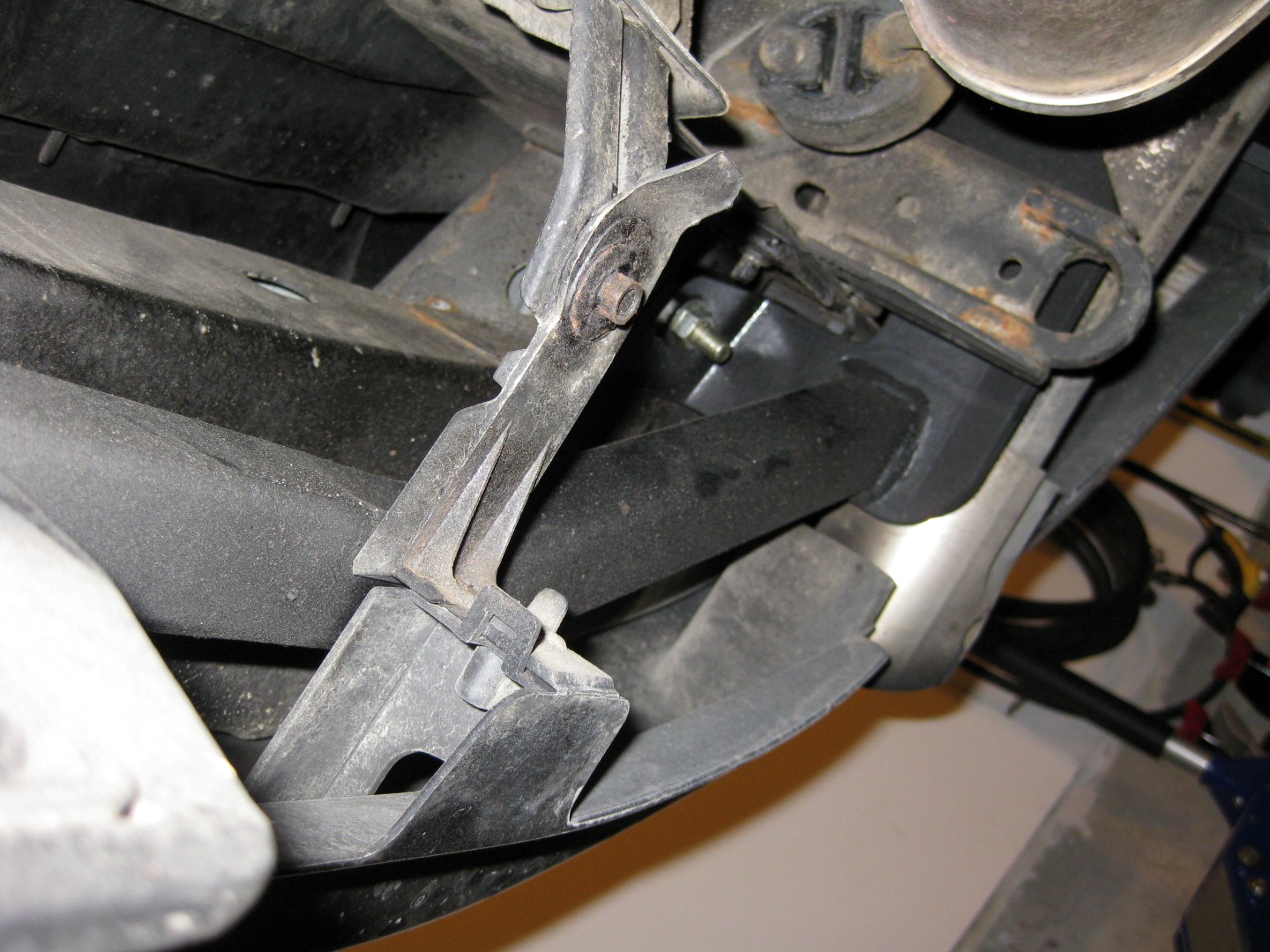

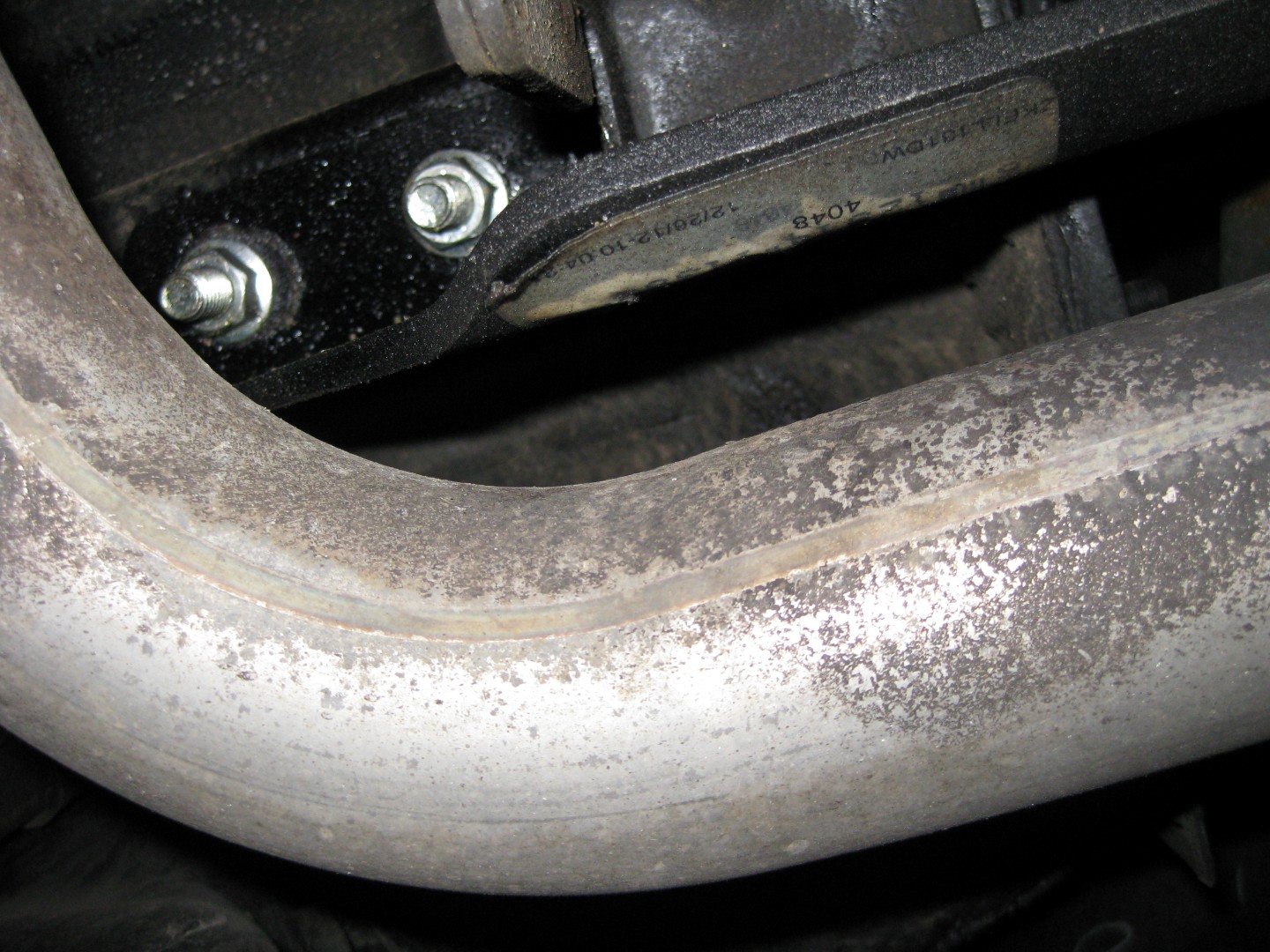

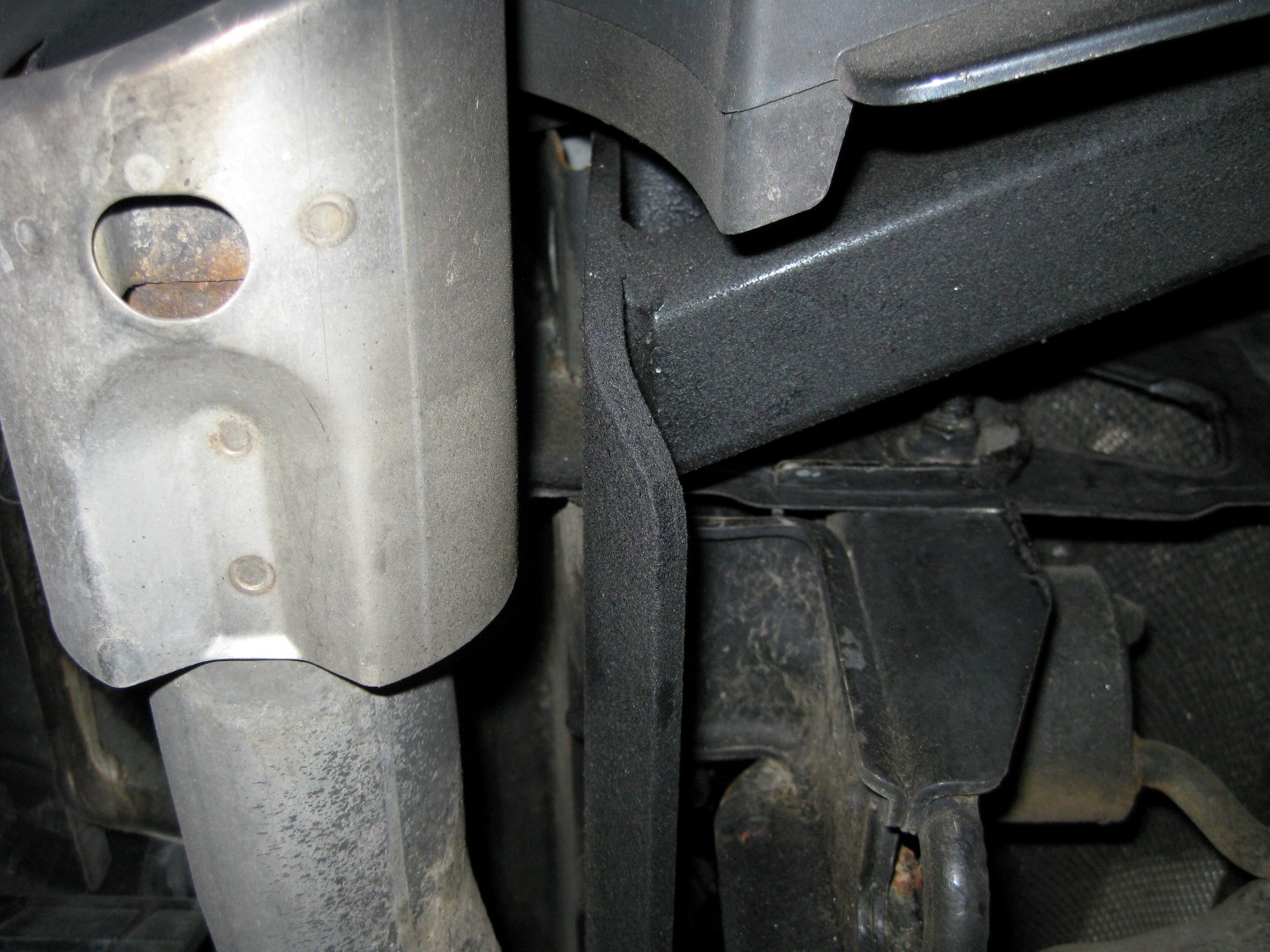

I did some digging around and was unable to come up with a solid answer. I basically was only able to get confirmation from Josh @ CP-E that their system is alot smaller than the factory exhaust so there should be more room to fit a tow hitch if that kit you have works with the factory system. I am sorry I don't have a guaranteed answer on this for you .
Tanner
Tanner
Tanner,
I was checking out the pictures and luckily yes the majority of it is smaller. I think the problem would be the tips though. I wonder since the cp-e tips are removal, if it would be possible to get ones that weren't so big? Here's some pics I had taken of clearance to the stock exhaust, the hitch metal is 1/4"

Tanner,
Let me get some measurements off of mine this week and maybe that will help with the comparison for clearance.

I just sent you over a PM with a bunch of images, hopefully we can figure out the fitment for you .

Does anyone have any tips for getting the studs out of the stock cat ?
Choke me, I like it.
frivolous_rob is offline   Reply With Quote
 Old 12-17-2019, 05:29 PM   #30
Db09ms3's Avatar
Join Date: Nov 2016
Location: AZ
Posts: 536   (View Stats)
Thanks: 550
Groans: 105
Heat it up!

 Old 12-17-2019, 11:55 PM   #31
frivolous_rob's Avatar
Location: Alamogordo, New Mexico
Posts: 1,374   (View Stats)
frivolous_rob is the leader of the worldfrivolous_rob is the leader of the worldfrivolous_rob is the leader of the worldfrivolous_rob is the leader of the worldfrivolous_rob is the leader of the worldfrivolous_rob is the leader of the worldfrivolous_rob is the leader of the worldfrivolous_rob is the leader of the worldfrivolous_rob is the leader of the worldfrivolous_rob is the leader of the worldfrivolous_rob is the leader of the world
Thanks: 681
Thanked 1,341 Times in 744 Posts
Groaned at 44 Times in 17 Posts
Heat it up!
I’ll give it a try and just double nut it yeh? I believe the nut on the back of the flange is welded ?
 Old 12-18-2019, 06:18 AM   #32
Jeff23spl's Avatar
Location: Quebec
Posts: 2,235   (View Stats)
Thanks: 161
double nut is the way to save thread yes or vise grip when it is a throw away stud
Db09ms3 likes this.
1993 Ford Probe KLZE 143dB
1989 GM 6.2 diesel pickup
Wife drive 2010 CX7
...Because French Canadian...
Jeff23spl is online now   Reply With Quote
 Old 12-18-2019, 08:26 AM   #33
Thanks: 681
It is throw away but just wouldn’t budge with vice grips
Update: in case this happens to anyone else, it took all of 10 min to remove the cat from the down pipe and heat up the studs with a propane torch. Studs came out clean and easy that way.

 Old 12-18-2019, 02:27 PM   #34
Jeff23spl's Avatar
Location: Quebec
Thanks: 161
you weren't able to heat them in place ?
A propane torch and if you need a little extra heat, the yellow can (Map-pro) saved me few times from the needs of a full torch set.
Db09ms3 likes this.

 Old 12-19-2019, 07:08 PM   #35
Thanks: 681
I used a propane torch but was on jack stands so didn’t want to lay under there upside with a torch
