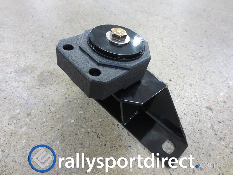

JBR - James Barone Racing Passenger Side Motor Mount (80A Duro.)
For more information on JBR products for your car, click here, or any of the images below!
JBR Passenger Side Motor Mount (80A Duro.) Mazdaspeed3 2007-2013
Part #: JBR MZ3MS3PMM80
Brand: James Barone Racing
Return Policy: Standard Return Policy
Mfgr. Warranty: Limited Lifetime WarranDescription
Color: Black
Durometer: 80A
Material: T6-6061 Aluminum
The JBR Passenger Mount is the only Vertically Oriented mount on the market. This mount can and will handle all the abuse you plan to throw at it. From street to strip it’s the only true 1 piece Passenger mount for the 07-13 MAZDASPEED 3. They’ve replaced the weak cast aluminum factory support which has been prone to cracking with a steel support. The actual mount itself is CNC milled from a solid 3 pound block of T6-6061 grade aluminum.Custom, Proven Poly Urethane bushings in your choice of 70 or 80 Durometer allow you to choose the amount of stiffness you want to run without sacrificing comfort.

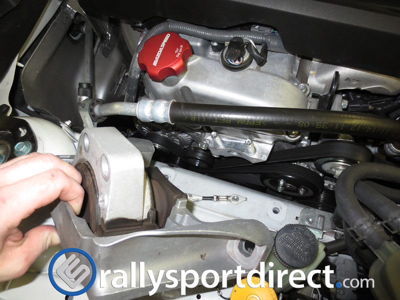

To begin, if you don't have access to a lift ensure you park on a flat leve surface with the e-brake engaged and toss some wheel chocks behind the rear tires.

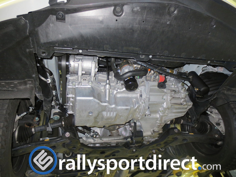

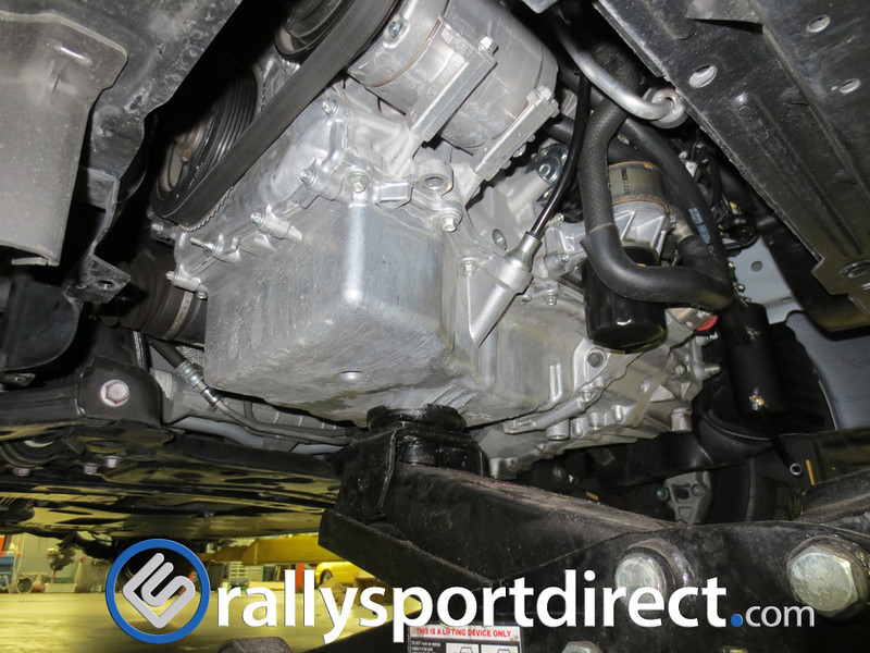

Remove the under tray so that you can support the motor with your floor jack before removing the motor mount.
**You do not want to apply a ton of force with the floor jack or you will break something. It is simply going to be used to take the load while you pull the motor mount and put the new one in**

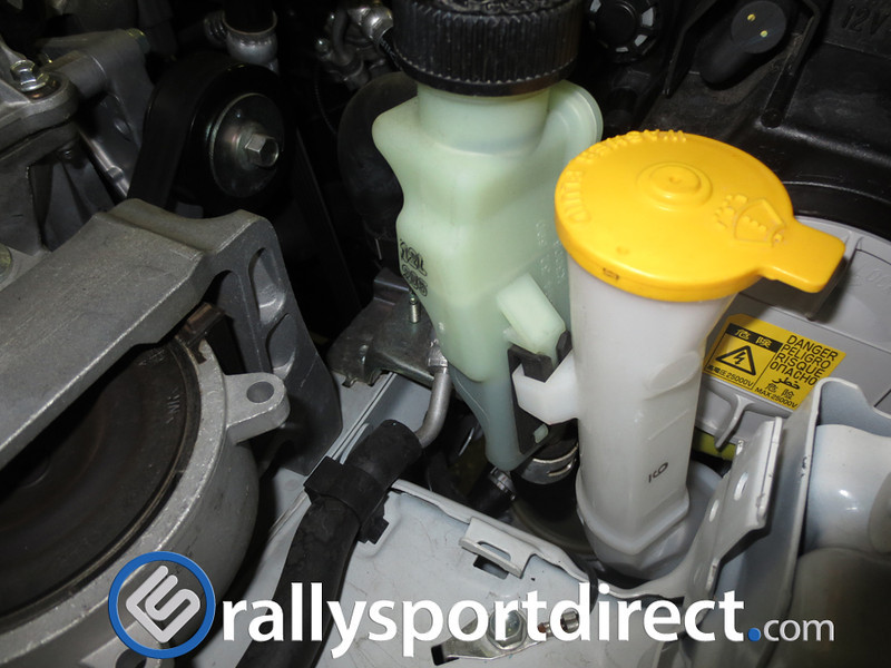

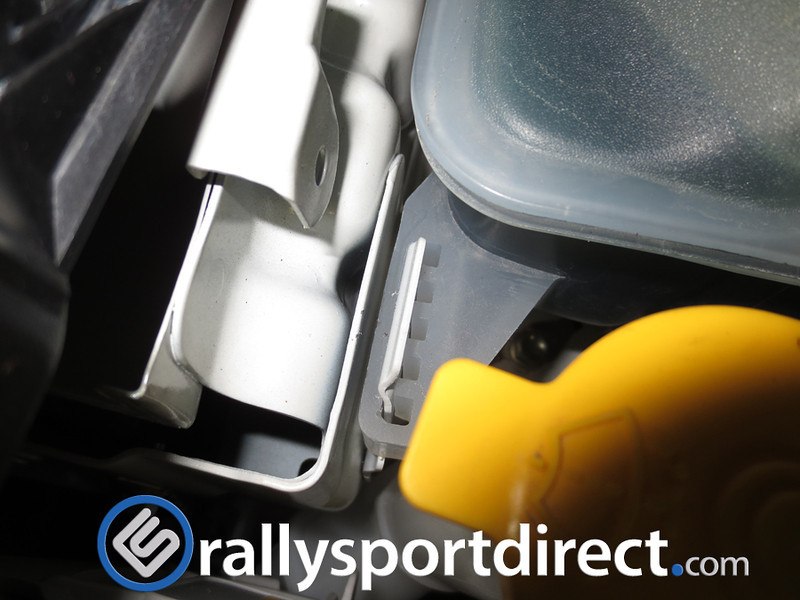

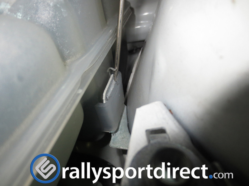

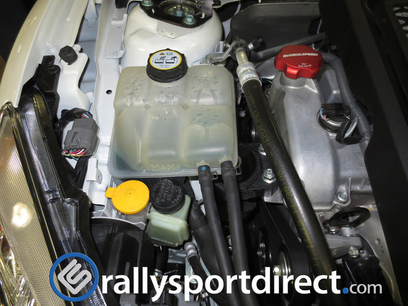

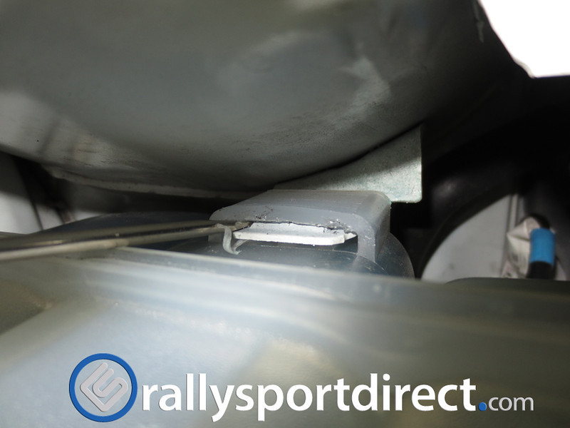

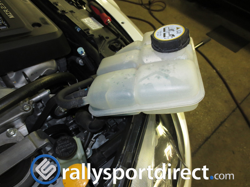

Remove the coolant and power steering reservoirs by inserting a flat head screw driver in to the tabs and pulling up. *NOTE* The reservoirs can be pivoted by their hoses towards the front of the vehicle.

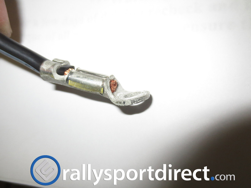

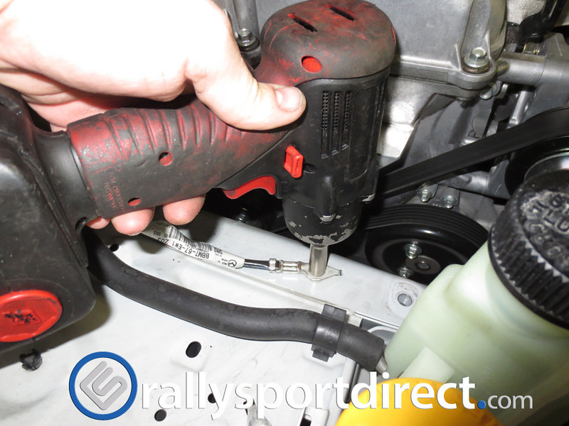

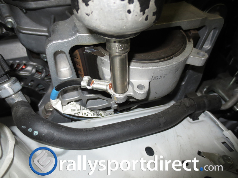

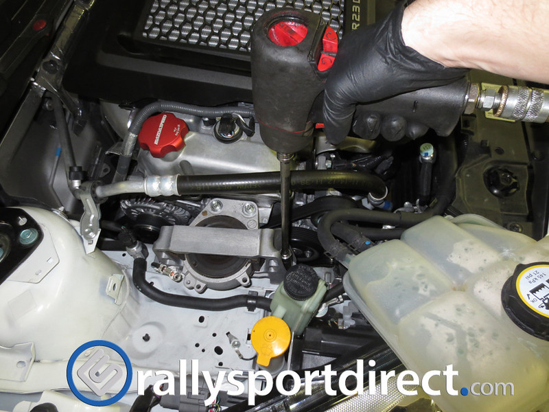

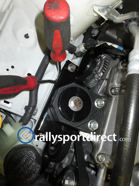

Remove 1 x 10mm bolt for the ground strap, 2 x 17mm nuts and 2 x 17mm bolts from the mount and remove the mount from the car.

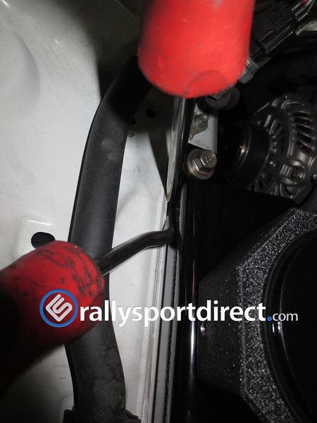

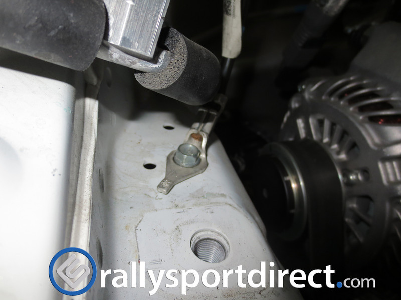

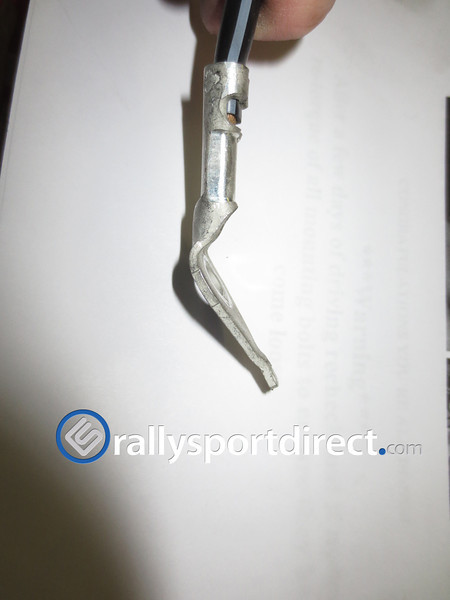

Remove 1 x 10mm bolt and remove the ground strap.

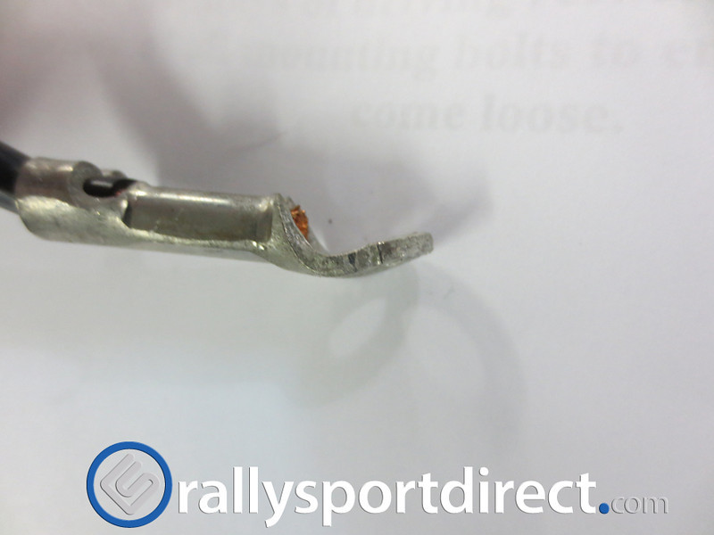

Bend the end of the ground strap previously bolted to the mount on a 45* angle.
Flatten the tab on the end of the ground strap previously bolted to the chassis.

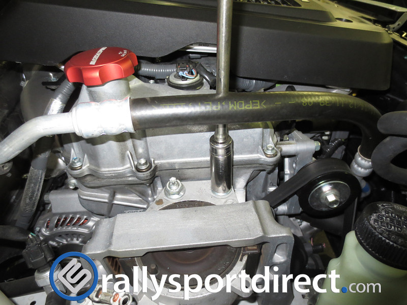

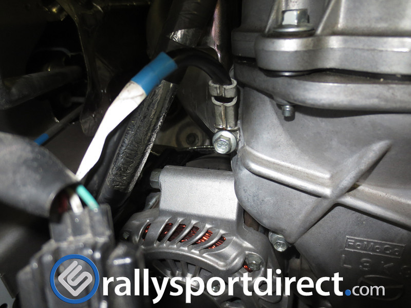

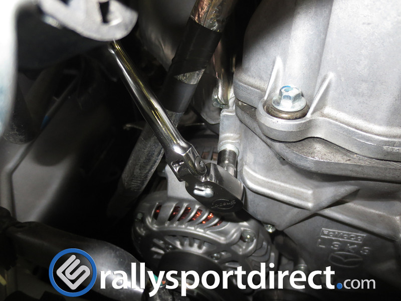

Remove the 8mm timing cover bolt located towards the rear of the vehicle above the alternator. Attach the end of the ground strap previously attached to the factory mount that you bent on a 45* degree angle in the step above and tighten. Attach the other end of the ground strap using the 10mm bolt removed in step 6 to the rear most pre-existing hole in the sub-frame located in front of the alternator.

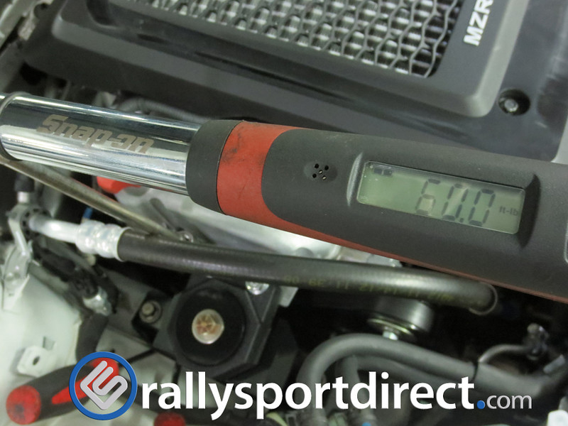

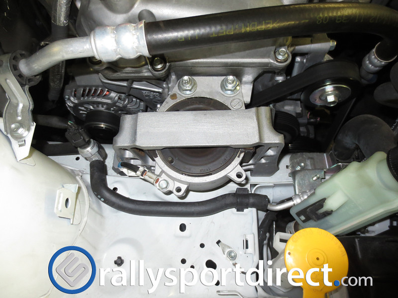

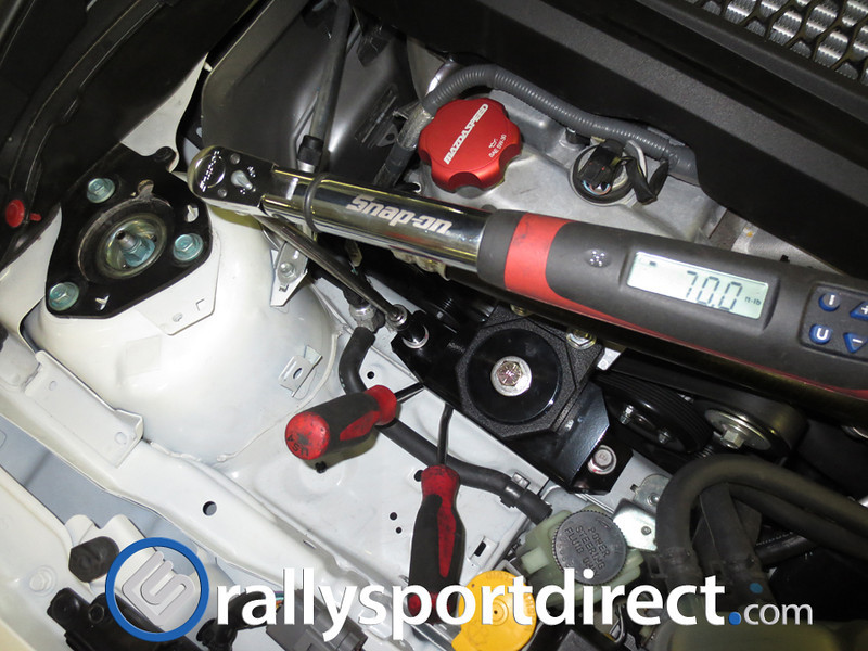

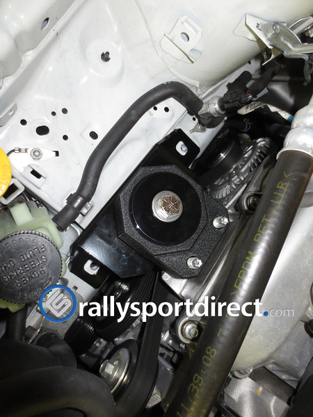

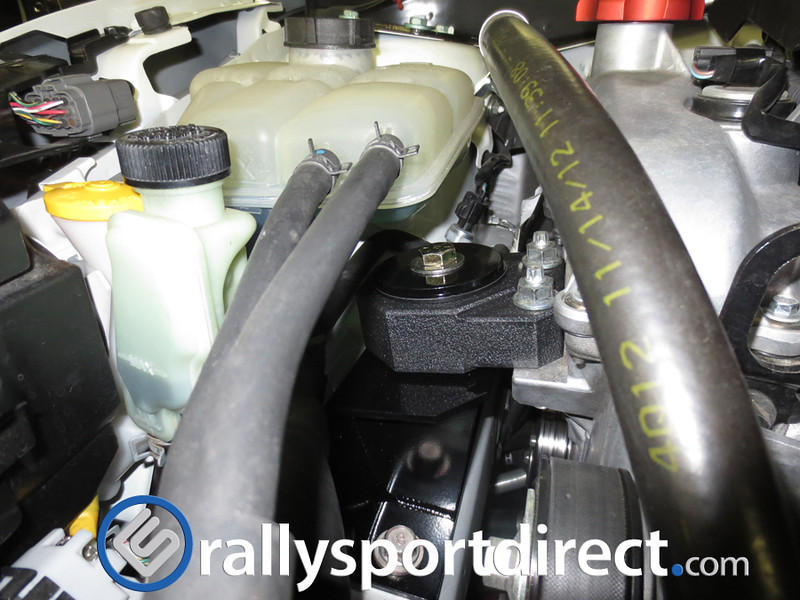

Place your new JBR Passenger Motor Mount in place and tighten to the proper torque: 60ft/lbs.
Next install the two 17mm bolts but do not torque them down yet. Ensure there is approximately a 3/16” gap between the chassis and the back of the motor mount. A flat head screw driver may be used to move the mount in to place while tightening. Never attempt to loosen the bushing bolt, doing so will void the warranty on the mount.
Torque the 17mm bolts down to the proper torque: 70ft/lbs.
Reinstall the coolant and power steering reservoirs and you are all done!

A couple notes from my experience:
- Some cars do not have a ground strap that needs to be relocated. If that's the case, becomes much simpler.
- Supporting the engine, throw a block of wood or hockey puck in the top of the jack so as to not deform your oil pan (helps spread out the weight from those nasty "teeth"). You can also get away with not removing the splash panel if you're lazy on some cars, it has enough flex that it can be moved (by hand even) to touch the oil pan...hence just another piece of plastic between the jack/oil pan.
- The coolant tank is a PITA sometimes, takes a good bit of pulling to get it to come even with the tabs pushed back.
