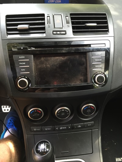

If you have a 2013 Speed3 with the technology package (which includes the touchscreen head unit), here’s how to remove it. It’s not hard, but it’s more involved than removing the regular Mazda3 radio. I hope the pictures help; photography is not my strong suit.

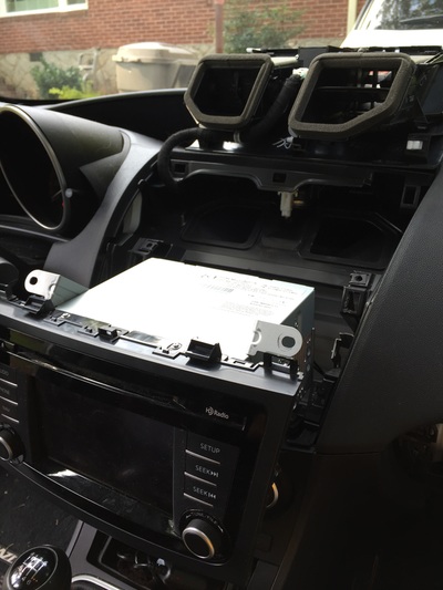

Step 1: Pull straight out on the vent panel above the radio. Don’t pull on the vent grilles. Instead, grip the top edge with your fingernails and the bottom of one of the vents. It comes out pretty easy.
Flip it up and either push it out of the way or remove the tweeter wiring harness to take it off completely.
Remove the two screws holding the top of the radio in place. Do not attempt to remove the radio at this point.
PLEASE NOTE: I took this picture when I was putting it back together; that's why the radio is pulled out.

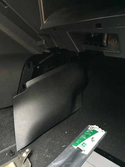

Step 3: Remove the passenger side lower trim piece by pulling out the one plastic fastener, pulling back the rubber seam, and popping it straight out.

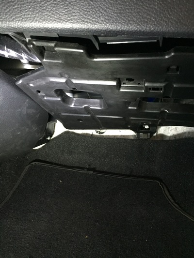

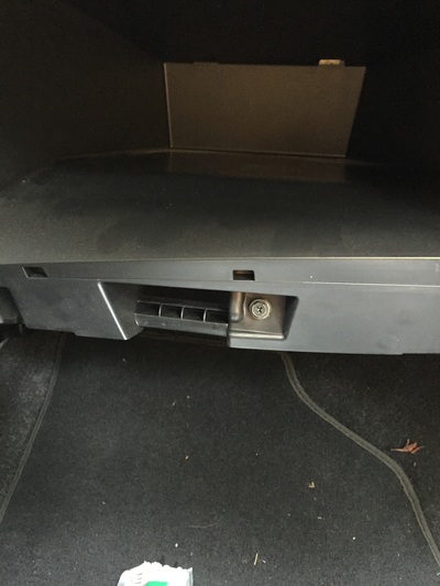

Step 4: Pull straight down on the dashboard undercover beneath the glove compartment. There are only two clips holding it on.

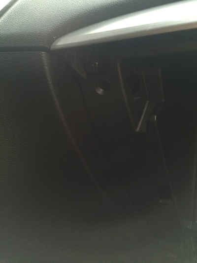

Step 5: Open the glove compartment. On the right side, you will see one guide (foreground) and just below it, the stay damper. Unclip the stay damper from the glove compartment door. Then, pull up on both the left and right guides so as you lower the glove compartment door, they will pull straight out.

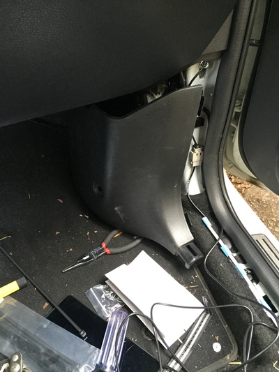

Step 6: Pull straight out on the passenger side lower left panel. It will just pop off.

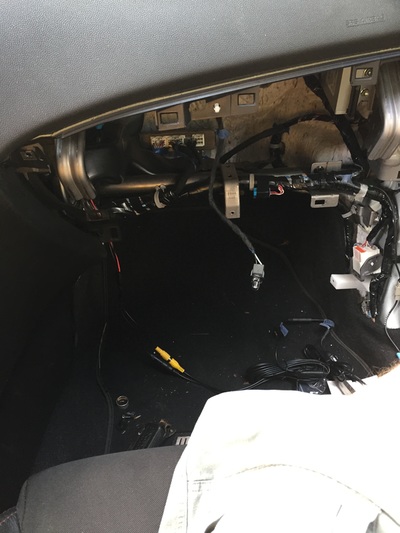

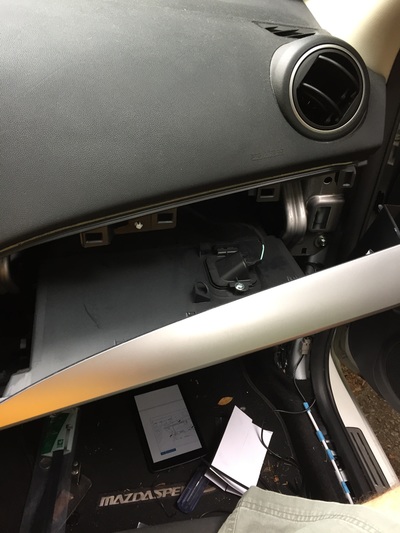

Step 7: Remove the glove compartment. Unscrew the upper and lower screws and pull straight out toward you. Remove the glove compartment light so you can set the whole assembly aside.

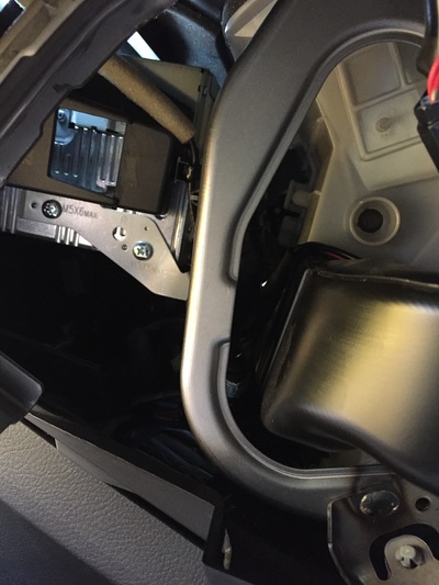

Step 8: Stick your head inside the gaping hole and look to your left. You will see two silver Phillips head screws connecting the radio to a bracket. Use a magnetized screwdriver to remove them. If they drop down, you’re going fishing.

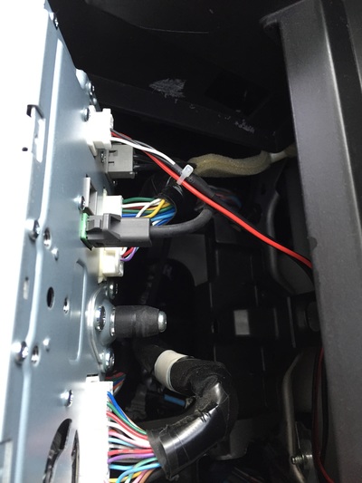

Step 9: In step 1, you removed the two screws at the top of the radio. Now that you have removed the bracket screws, you’re ready to pull the radio straight out toward you.
Once you get it out far enough, you can remove the wiring harnesses and antenna.
