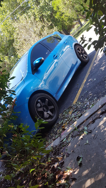

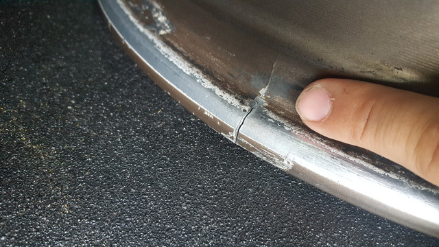

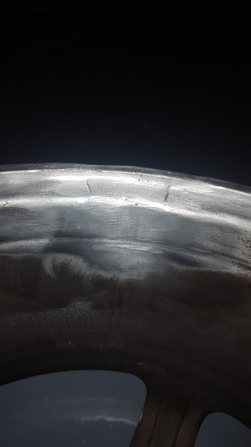

Ok so I picked up this dead set of Rota Grid wheels in Houston for a great price since 1 of the 4 wheels was cracked significantly, but it was repairable. A month later and they're finally on the car and back to life.

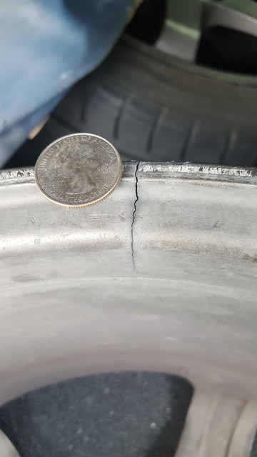

Crack was significant, but fortunately was on the inner lip of the wheel.

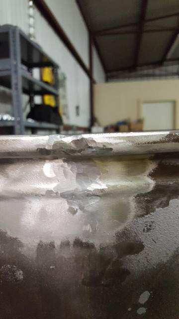

The crack was cut out from the edge of the wheel and filled by hand.

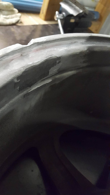

Post cut after a bunch of passes

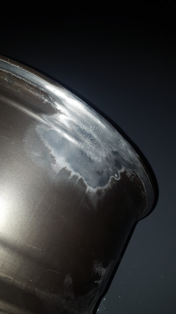

About halfway through

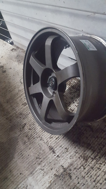

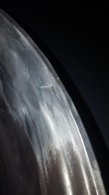

Finished...but unfinished. Since it was in the inner lip of the wheel I decided to leave it unfinished for now. But when I go to paint the wheels I might finish it off to look nice.

Update: 1 month later, daily driving, hit potholes hard enough to make my tmps lights blink angrily at me, still holding constant pressure though. I can't complain

What cracked that wheel? Hit a curb really hard or something?
2010 black mica speed3
Soon:built motor
 Old 10-20-2017, 02:48 PM   #8
Bexar's Avatar
Join Date: Mar 2017
Posts: 195   (View Stats)
Bexar is a splendid one to beholdBexar is a splendid one to beholdBexar is a splendid one to beholdBexar is a splendid one to beholdBexar is a splendid one to beholdBexar is a splendid one to beholdBexar is a splendid one to behold
Thanks: 61
Thanked 17 Times in 15 Posts
Groaned at 18 Times in 8 Posts
Hard to know.
Came from a guy who had em on his Ralleyart Lancer (however you spell it) so he must have been throwing the car around a little.
But odd because it is on the inside lip of the wheel.
