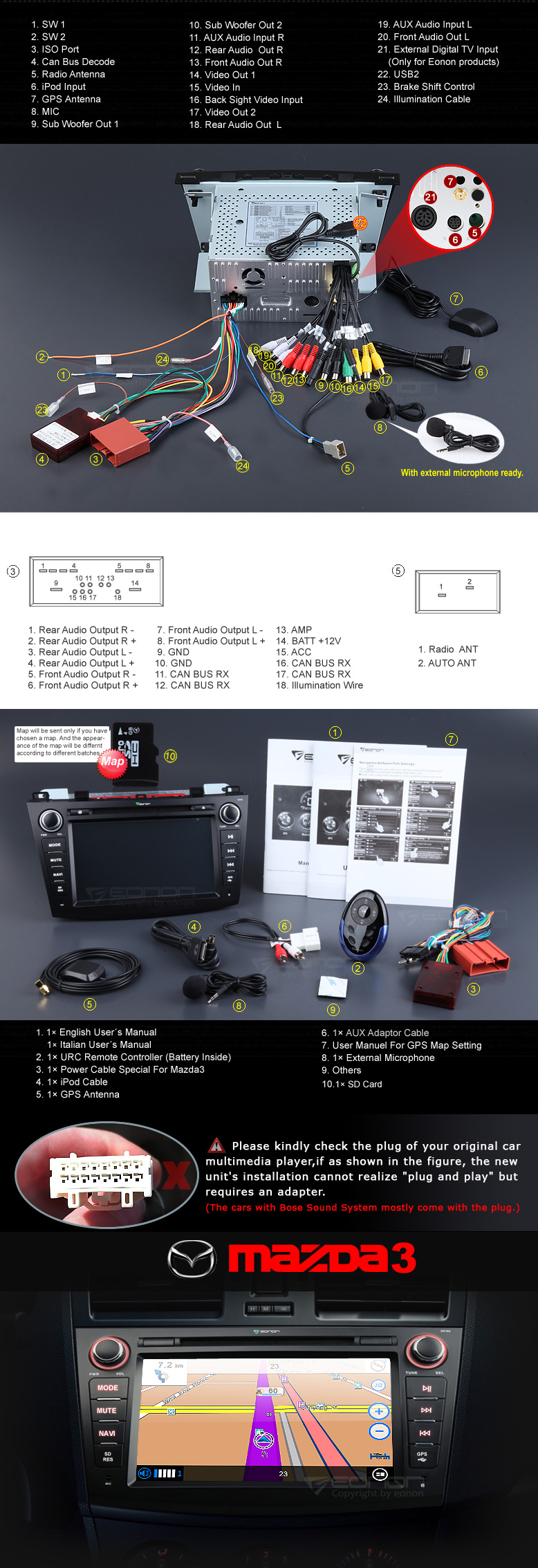

I know thats a month post but I have a little question about it. If it is solved, I appreciate it and will get one of this
1)which audio wires should I cut if I also get a bose system, I am sorry I am new to these wiring stuff, (from the following diagram)
http://www.eonon.com/UserFiles/image/D5163-06G.jpg
2)last question is the male RCA plugs a male to female one?
Thank you so much!
