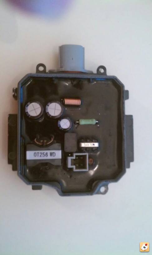

I just pulled my old ballast apart and I cannot see a way of repairing it with all that black rubber inside. I know there is a name for it, but I can't think of it at the moment. It's almost like a solidified silicone. I do see 1 small phillips screw that is nicely rusted.

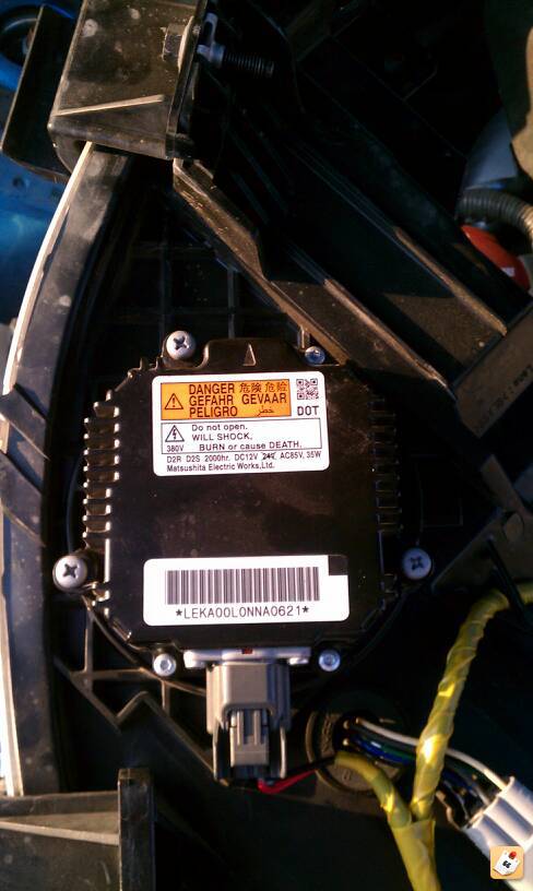

Here is a visual.
And under the cover.
I paid $65 for another one from eBay.

Sorry for the late response, but the Nissan ballasts are the same as ours.

Originally Posted by Phoenix View Post
The ballast that some Nissan Maximas is a direct replacement for ours. You can find them in ebay pretty cheap.
Thanks guys, I appreciate the help. Found out today that something else might be at play. Testing the alternator this weekend, reason for that is when I am sitting idle and throttle it, the voltage drops from 14.1 to mid 12's. Read that might..just might have something to do with the bumpy headlight. I'll definitely check out those links and see what I can find. But, i'm doing a lot of fixing this weekend, so we shall see. Thanks again.
