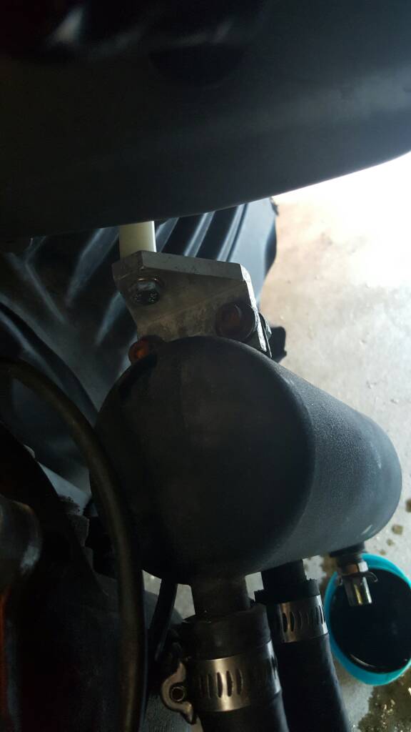

Just a FYI to everyone with old JBR Catch Cans. Make sure you either have some Zip ties holding the catch can onto your car or have your underbelly pan in place. I recently had my mount break off the can and the catch can fell and hit the asphalt as I was driving. Made nice scratches and a good hole in the bottom of it. Had to get some JB Weld and fix her up along with a new plug for the drain hole. Otherwise the can held up very well.
This is the old Model JBR Catch Can that had the pre-redesigned mount on it. I'm not paying to get a replacement so I just JBWelded the mount back on with Zip ties holding it to multiple points in case it snaps again(shouldn't)

My catch can bracket fail. I just made a better bracket at work until I can get a damond motorsports can.
it's a shit bracket, but he's not the only one that cuts corners when it comes to brackets. the best one i've seen to date is the corksport one that has 2 bolts into the can and uses 2 points of attachment on the frame.
If the original bracket design was thicker, it wouldn't be a problem.

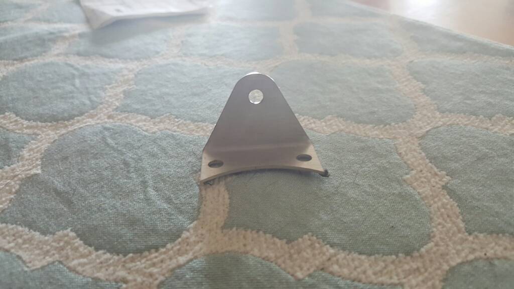

I am just going to give a shout out to Sabrina @JBR; handled the broken catch can bracket issue very professionally. I have a new piece being shipped to me under warranty. I simply provided my order number along with the proper picture showing what happened. Thank you!!

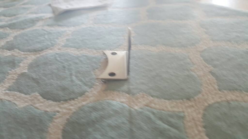

@kenny7821; would you take a pic of the bracket when you receive it?
I'm guessing it's either 304 or 316 stainless. 1/8" thick.
Thank you sir! It looks like i already have the same bracket!
