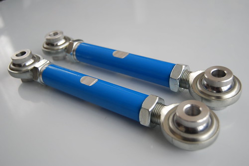

This is a go. I think I've finalized a design and now I'm looking for the correct ball joint to adapt to them. These will be more towards a racing/summer use, vice all season replacements. I'm considering using rod ends or bushings. I've not decided and it's easy to do either.
On thing to consider. My company consists of a staff of 3; Me, myself and I so it takes me a while longer to get things done. This item is at the top of the list with side motor mounts a close 2nd and round shift knobs in progress as well.

I am assuming you're saying they're a "summer" application because of salt eating at the bushings in the winter?
probably because of heim joints

you mean the ball joints? or rod end bearings?
Won't the ball joints have a boot?

yes I mean rod ends they don't do well in salt the ball joint should have a boot

sorry, but please point out where there are rod ends on a lower control arm?
I do not believe the steering rod ends are changed with a tubular LCA. They attach to the knuckle.
Where the LCA will attach to the frame of the car.

so instead of bushings there will be spherical bearings?
on both ends?
