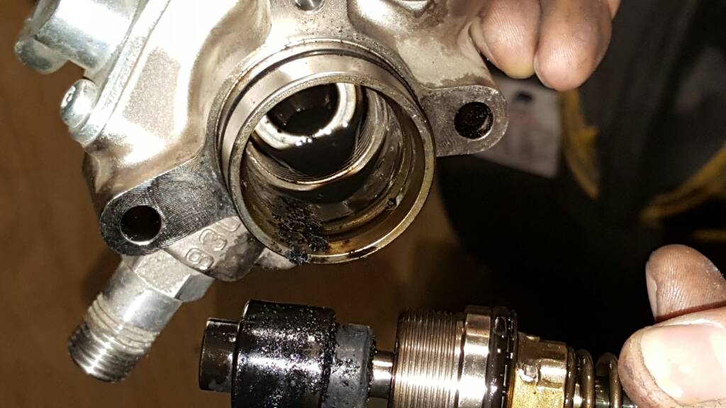

Um...I'm confused. We have a cam driven pump that needs to be upgraded not the one in the fuel tank.
If the shop doing the work suggested AEM capable fuel pump take your car and run.

Walboro 255 is an in-tank fuel pump. You don't need it.
It's your cam-driven, high pressure fuel pump internals that need to be upgraded...
FWIW: I think the shop is trying to sell you a Valve Cover/Ventilation kit. ( The final smoke at idle fix from Mazda TSB 01-002/11 dated 2/23/11 ) It was a "fix" for smoking turbos back when Mazda had their extended warranty in effect. That too, you don't need.
Stay away from this shop. Read the PM you received when you joined this site and start reading...

I did straighten out the issue with the HPFP vs the In tank and we are going to make sure that gets done as well.

Here's a pic of my stock hpfp they showed me as they removed it to install.the new cobb

looks like the shop is none-to-kind with your car.
WetzMS3 likes this.
Nice spot! That should be fun.
In what way does this picture you quoted tell you they are "none to kind" with my car? Or are you just another troll with nothing to input
Sent from my LG-H901 using Tapatalk
Monkey see monkey do...the negativity here is awesome...you must love your life
Stop acting like a bitch because your car is geting fucked up. You chose to listen to a shop who knew nothing about the engine they were building. You could have saved yourself a ton of trouble, getting local members to help diagnose and fix your car. People who are educated on this car much more than every person at that "performance shop" combined.
Get the shop to start listening to what people on here are saying. Or get it out of there, and get in contact with locals in your area who know what they are doing.
You need to tell them to take better care of your shit, unless you don't give a fuck about it either.

Maybe you should pay attention to what he outlined in red in that picture before you throw a bitch fit, yea?
I'm not a mechanic..I see the arrow but no explanation as to what the issue he is referring to.
Not a bitch fit..just some forums people are super elitist and want to talk shit instead of help

What's he saying with the arrow..there was no explanation.."hey the pic you guys sent me looks like your none to kind to my car"
Then they reply what do you mean....then I say nothing because I don't have direct feedback..

The shop rounded off part of your high pressure fuel pump when attempting to remove it. The red arrow points to a rounded off edge.
It may be hard to get that back in torqued to spec, it will definitely be hard to remove again if it does make it back into the hpfp housing.

Man, what was wrong with that fuel pump? I'm surprised it was still pushing fuel. Are those metal shavings? Carbon build-up?
I didn't read all the posts, but I would suggest you have someone familiar with the Speeds look at your engine. Might need more work....
I was wondering the same thing. Possible it was run off of corn at one point?
