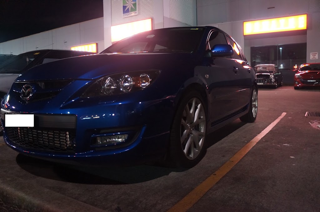

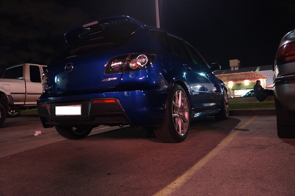

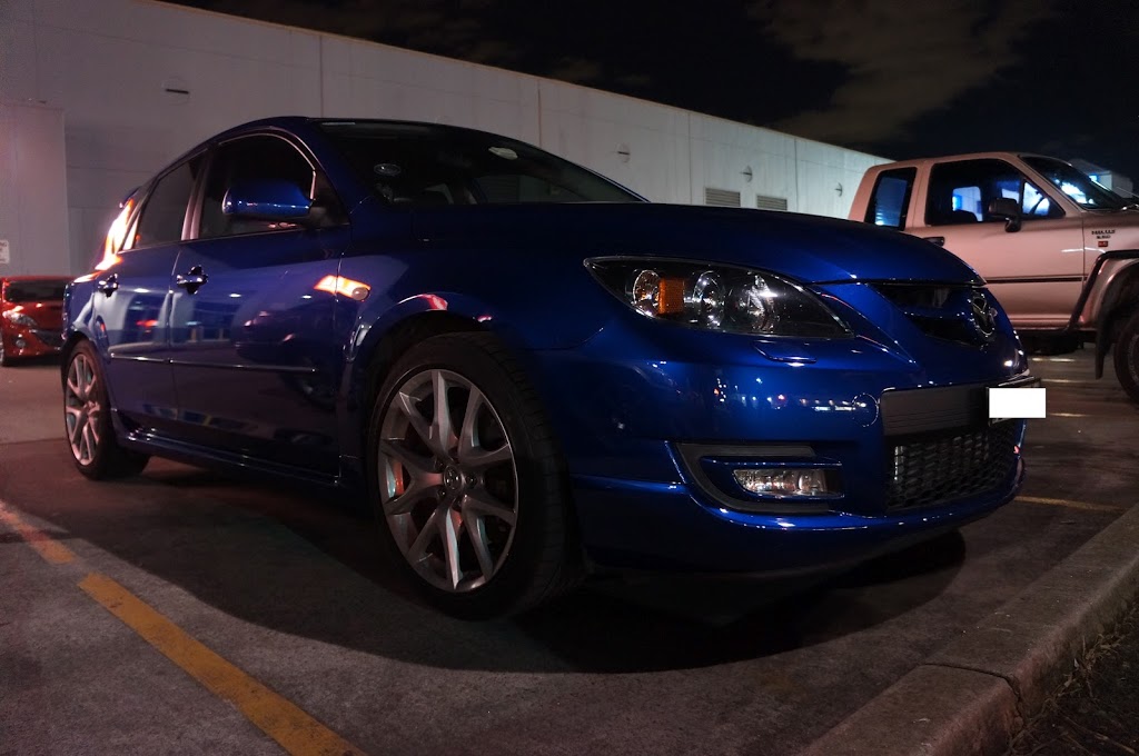

got chance to take photos:
(yes, i know, needs low)
tune going nice, got full spool at 3300 rpm
just need damn 3-bar installed, which happens next weekend!
