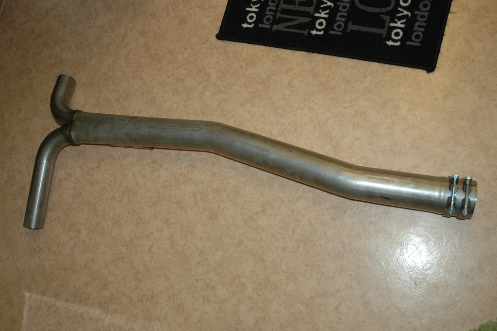

I run a common 3" cb...
I have the same catback and it's only 3" until it divides at the rear axles. Where they become like 2.1" each. See pic below. It also has a 2.5" flange to DP, unless you welded on a bigger one.
My plan is to replace the flange with a true 3" since my DP is 3". That will lessen turbulence and whatever small restriction it causes. Now that I have a forged engine and BT I will also consider a exhaust cutout somewhere between the DP and axleback just to see how big of a restriction our catback really is, but that won't happen until im fully tuned.
As a test you could always disconnect the catback from your DP to see how it reacts

I don't think that this reduction in diameter at the splitted end is that much of a restriction for the Ray/Simons cb, but I'm curious what you will find out...
