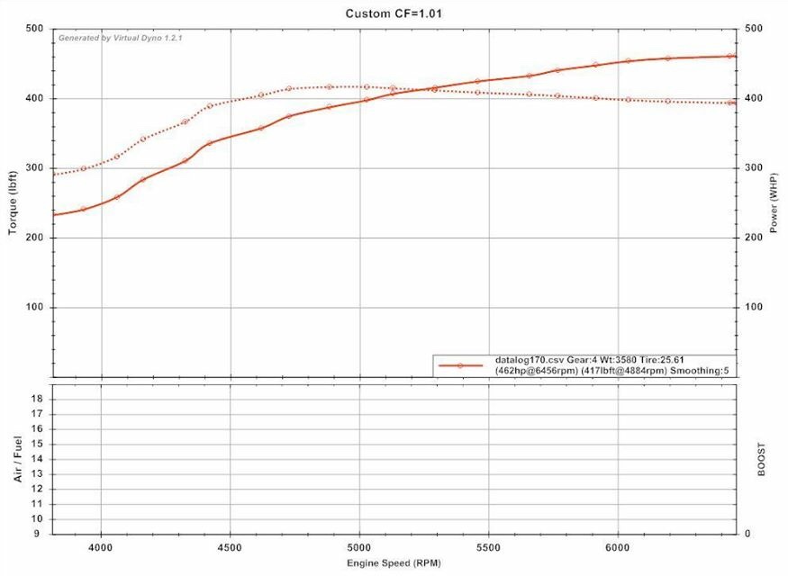

Bnr s4 is currently on my built car. Waiting for the dyno to finish up the tune. Its not a 500hp turbo (close though), and it will be even further away on awhp.
[SIZE="1"]07 MS3 GT..
GTX3076r --- 479/412
S4-460/400
Highest HP BNR S3
BNR-S3 424/397

The 475 has never been "verified"- just as a heads up..just vd plots. Once its on a dyno then we can confirm
May you post one of those "final" vd plots?
Mods: BNR S4, 3" Ray cb, CP-E catted dp, CS 3" intake, CP-E tmic, D06-wmi, itv22/NGK IX plugs, Forge bov, hpfp-upgrade, JBR ebcs, 3 bar map sensor, egr block off kit, ACT 6 pad clutch with SL flywheel, Wiseco oem compression pistons, Manley H-Beam connecting rods, reworked head, CP-E SafeSeal injector seals, no E85, Cosworth thermostat
EmPeEs6 is offline   Reply With Quote

The only one I have on my phone is the 460.

Hmmm...I would have expected that the torque plateau starts at least 500 rpm earlier (supposing that this turbo reaches 20 psi at 3700 as mentioned in another thread).
Sorry I should've noted that log was done when i was rolling at like 57mph and in 4th. So that puts right about 4k. So pretty instant.
Once I get home from work, I can run a few on my computer.
Whenever you can, do you mind posting that datalog170 file somewhere here?
