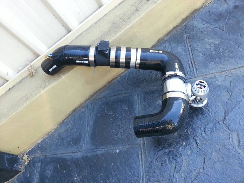

I have a cobb fmic and was running a blow thru setup for a few months using custom piping for the cold pipe. I originally was having part throttle problems with the cobb cold pipe and my custom blow thru fixed that but my WOT afr's weren't consistent enough so I have switched back. I'm planning on trying it again later using a different setup.
Here is how my cold pipe was setup
Let me know if you ever get it working reliably
